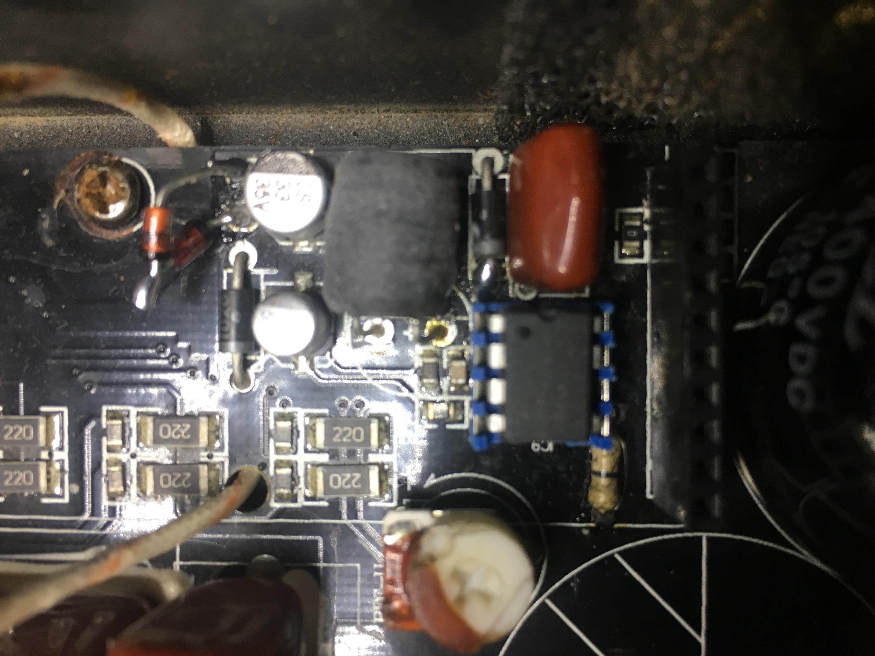

    I need schematics for this amplifier or just type of IC9 7 Pin IC and what voltage shoud be for the amplifier itself.

    Who knows since we don't have the set in front of us? We need to see pictures of the inside and the IC9 Part No.
      Re: Sinq digit 2k2
      The problem is that thic IC is blown and there is no top to read marking and there is a shorted diode ,seems to be zener,that I do not know value of.
      This amp is the same as KAM KXD3200 or KXD6000.
      At list if someone knows voltage for the ampifiers,
      I have menaged to find wich Ic could go as IC 9 ,it is LNK306 but

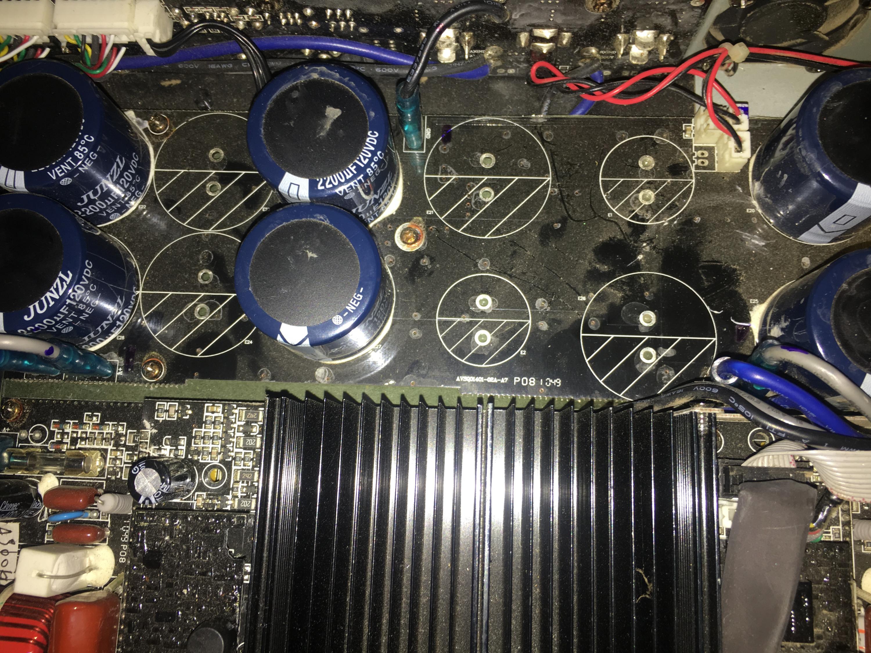

      I have +-110V at the amp ,and capacitors are rated 120V.Seems a bit to close.

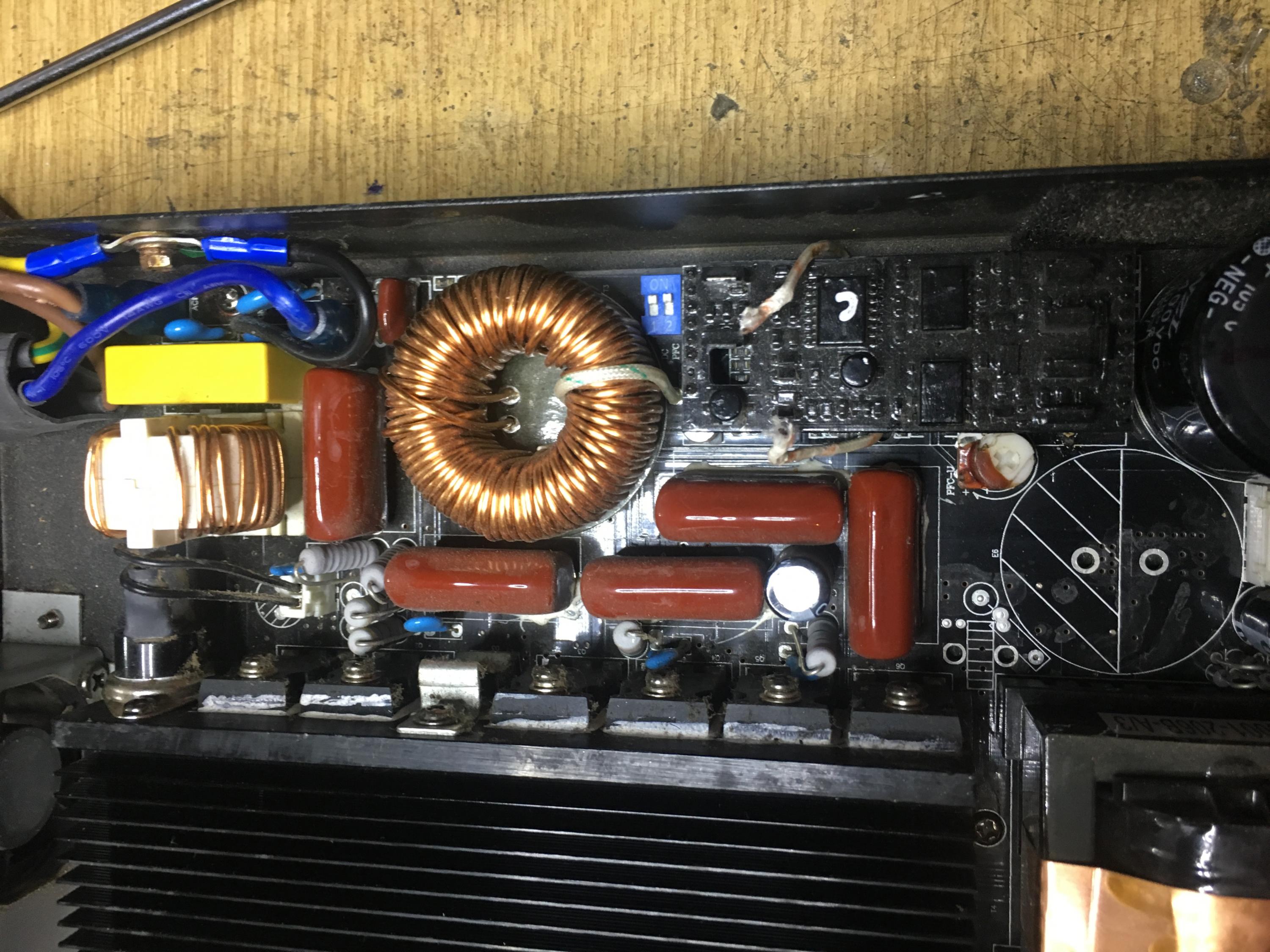

      Here are some pics:

        Sometimes the Part No. is written on the underside of these ICs. Remove it, since you have to take it out anyway, and look for a Part No. +/- 110Vdc wit 120Vdc caps seem close, I agree, but the original design use them so I won't worry about that yet.

          No marking underneath.
          I am worried that this voltage of 110V is big beacuse of that IC ,that IC is supply for smps that makes main voltages for amps.
          I guess I will have to wait for some kind of schematics or someone with same amp willing to check somethings for me.

            Can see the pictures of the whole unit?

                Problem solved.I wrote to Sinq and they sent me schematics.Bravo Sinq.
                The IC9 is DYI06 ,but looks like it is the same as LNK306.The voltages are correct.

                    Yes,smps IC ,zero ohm resistor and zener diode 20V
