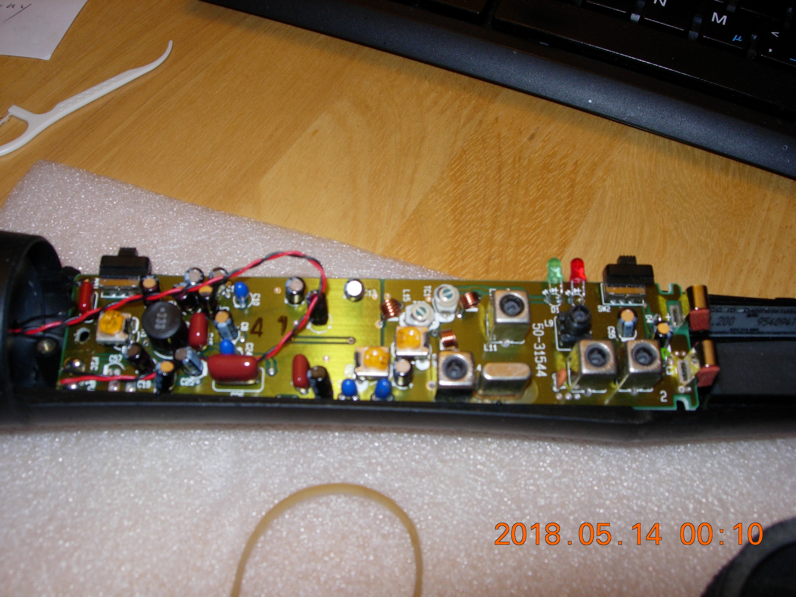

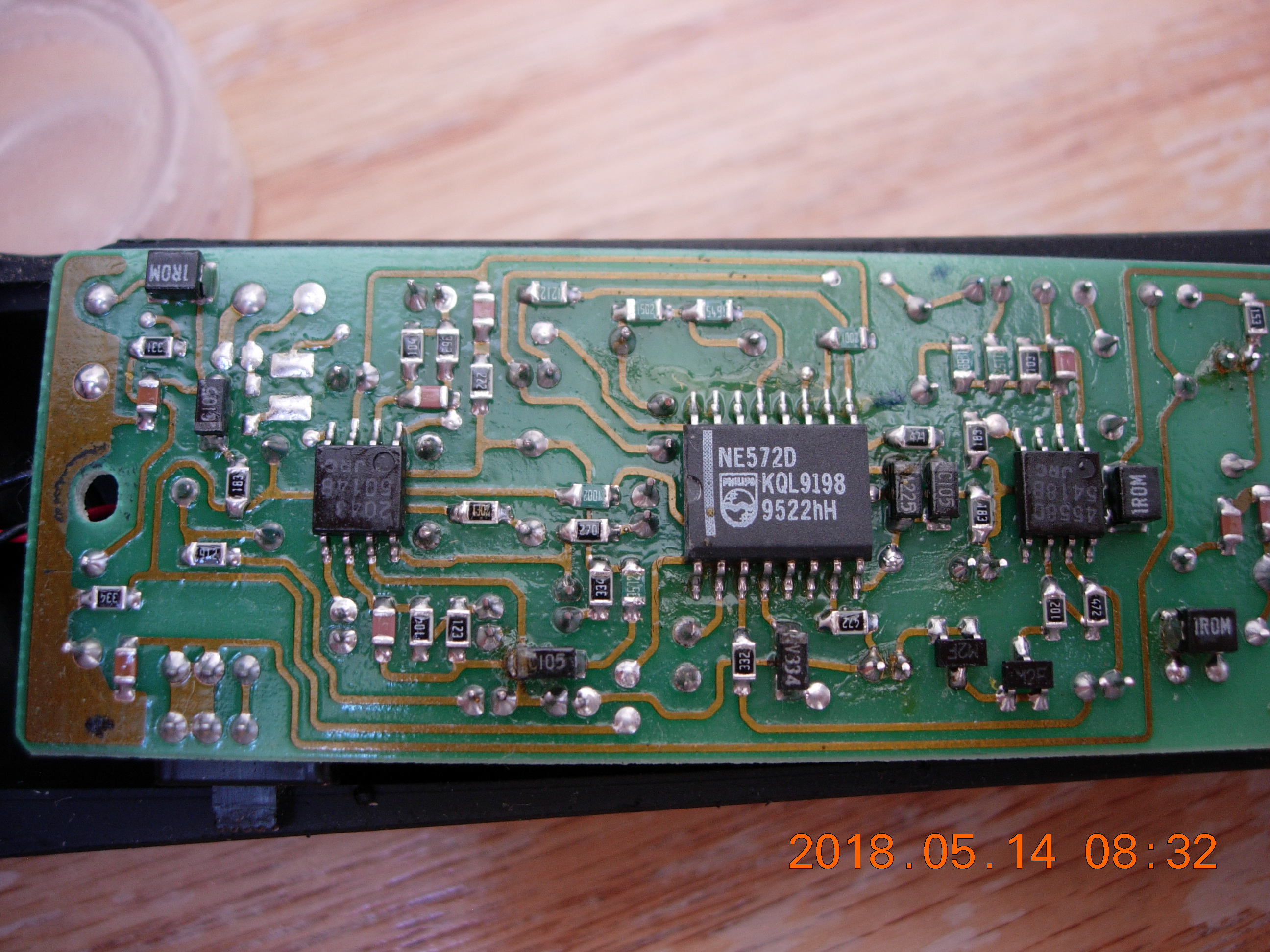

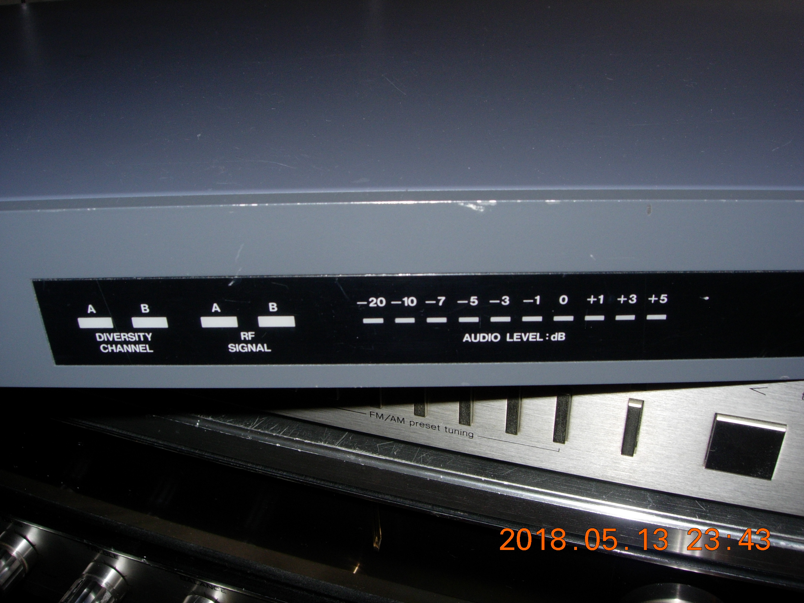

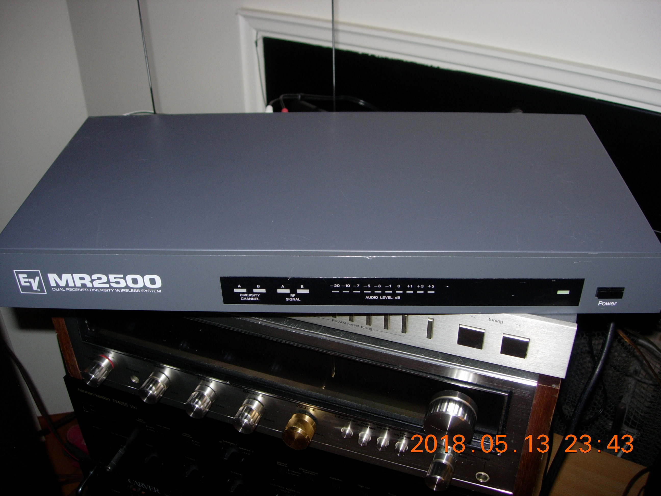

    Recently, I got the Electro Voice MT2500 Wireless Microphone system. It consists of a receiver and a microphone.
    According to the manual, there is a transmitter mic-level control on the microphone. And we should turn it up so that the audio level meter (consist of 10 leds) with 8 leds light up. I found that I only got 1 or 2 leds light up. Also, I have to turn the volume of the amplifier higher than normal to have enough audio output from the speakers. Therefore, I tried to turn up the mic-level control but I found that it is already on the maximum level. So I think that there may be something wrong with the microphone.

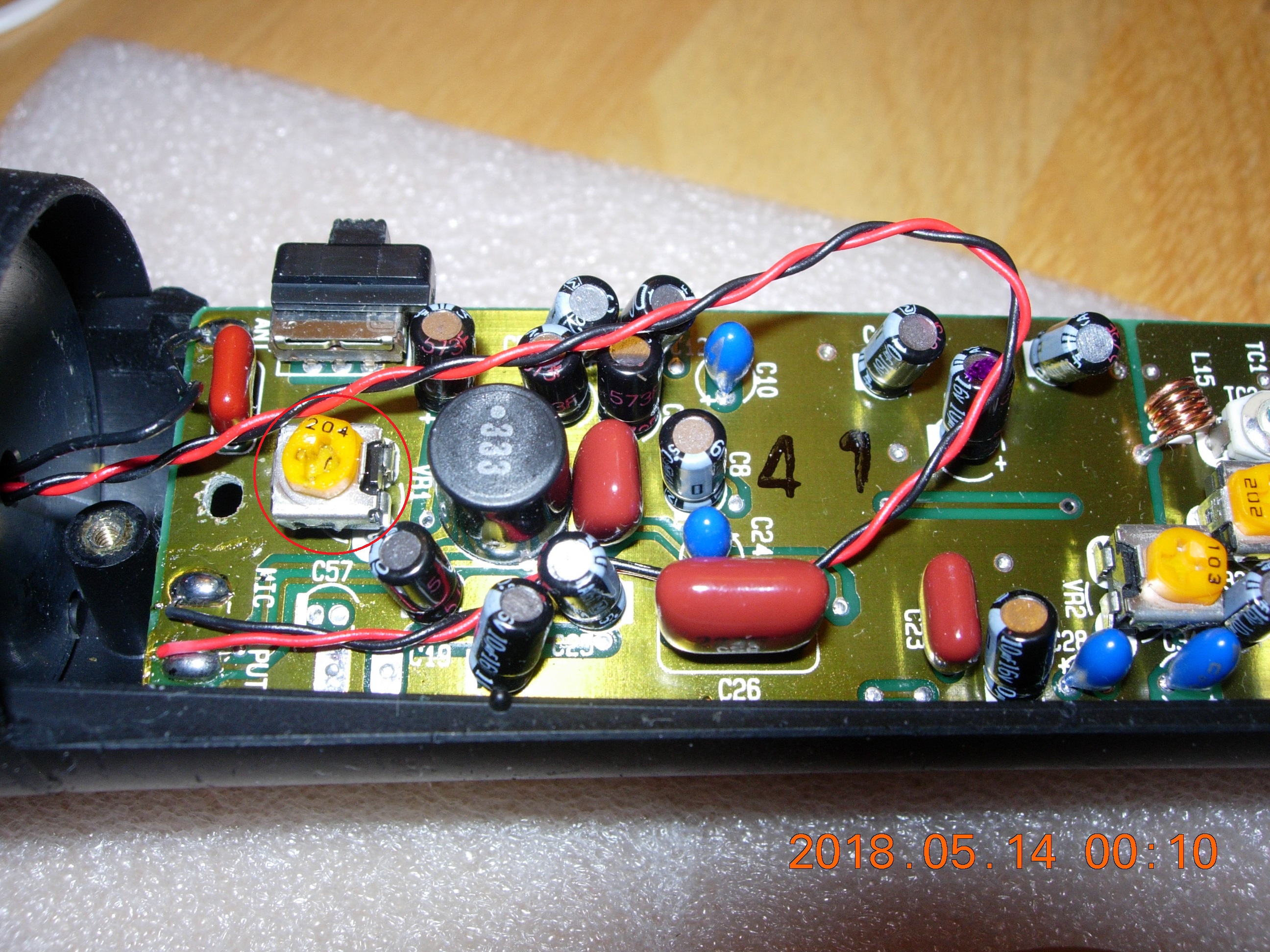

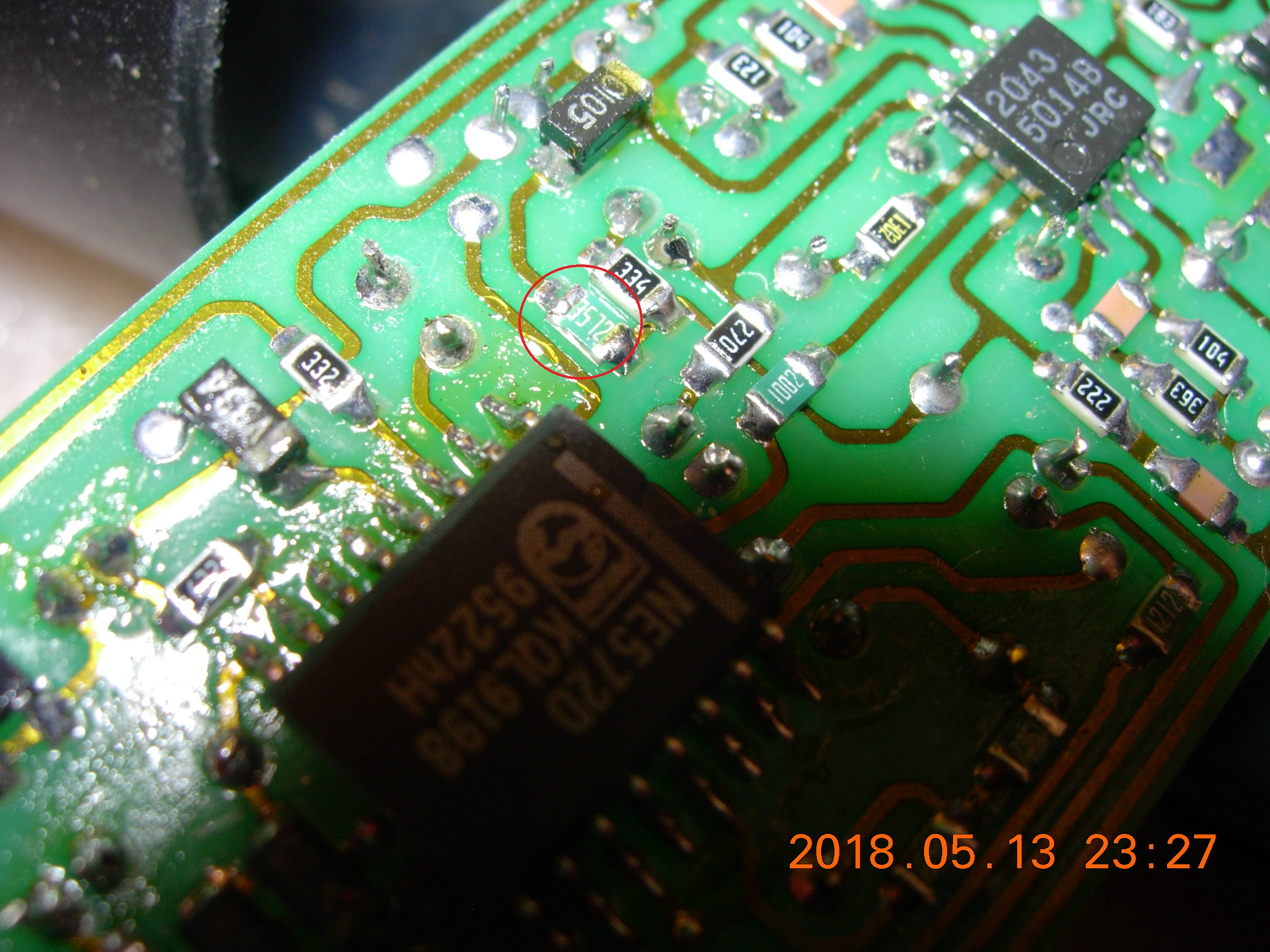

    I opened up the microphone. I sprayed the mic-level control with contact cleaner but that does not change anything. I looked at the bottom of the pcb and found that it seems a smt component is missing.
    Attached please find the photos. One of them is with a red circle showing the suspected area with missing component.
    Is it really a component had fallen off or just left open? Will that affect the microphone output? What else will cause the low microphone output?
    ps: I could not find the circuit from the internet.
    Is there a component missing or just leave open?
    the red circled component is the mic-level control

    Can you post a better picture of that mic board, where we can see everything?
    That JRC 2043 is a dual low noise pre-amp. So depending on where these pins connect to and from that IC, it is very well possible that this missing resistor has something to do with not having enough gain.

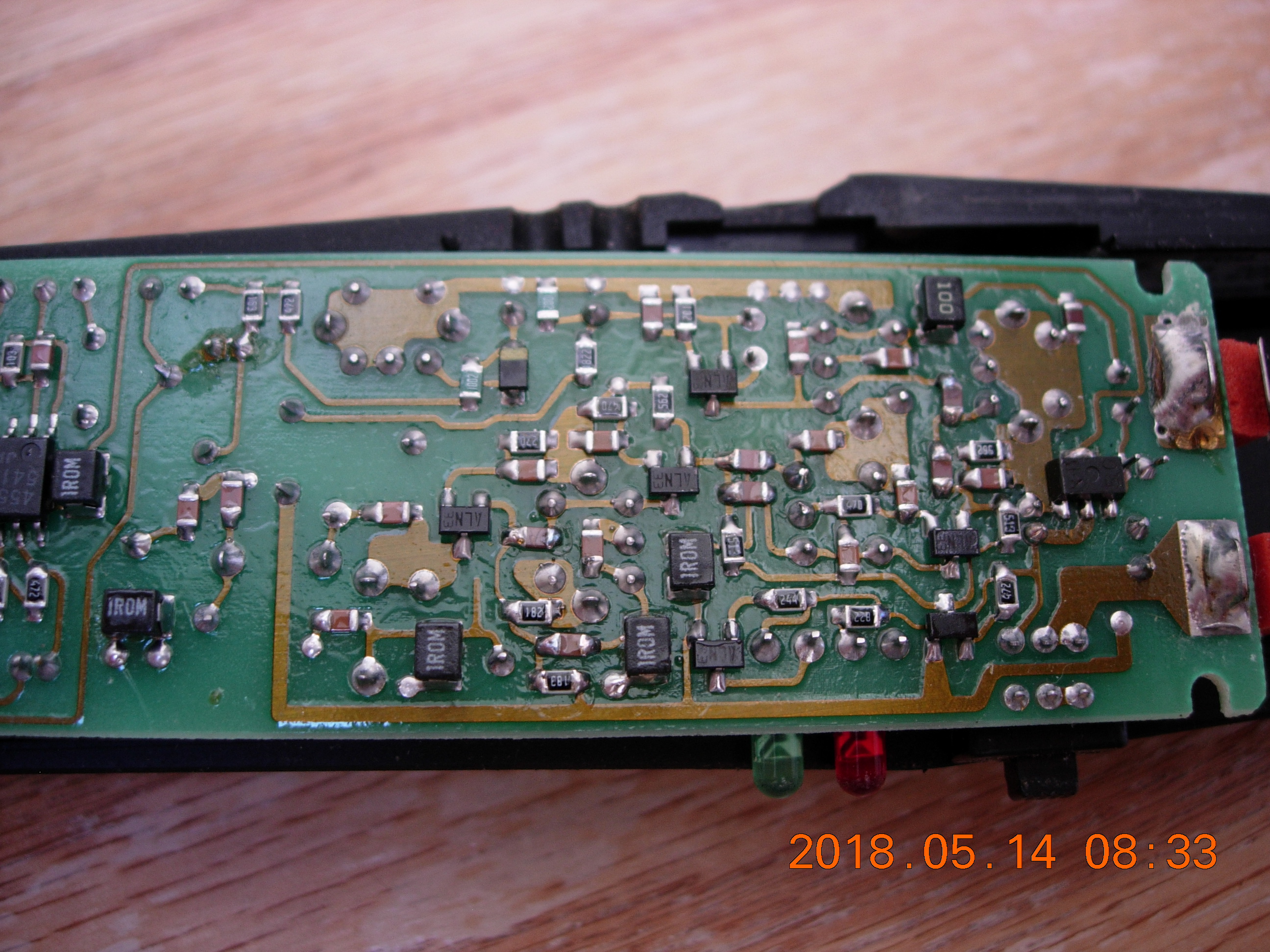

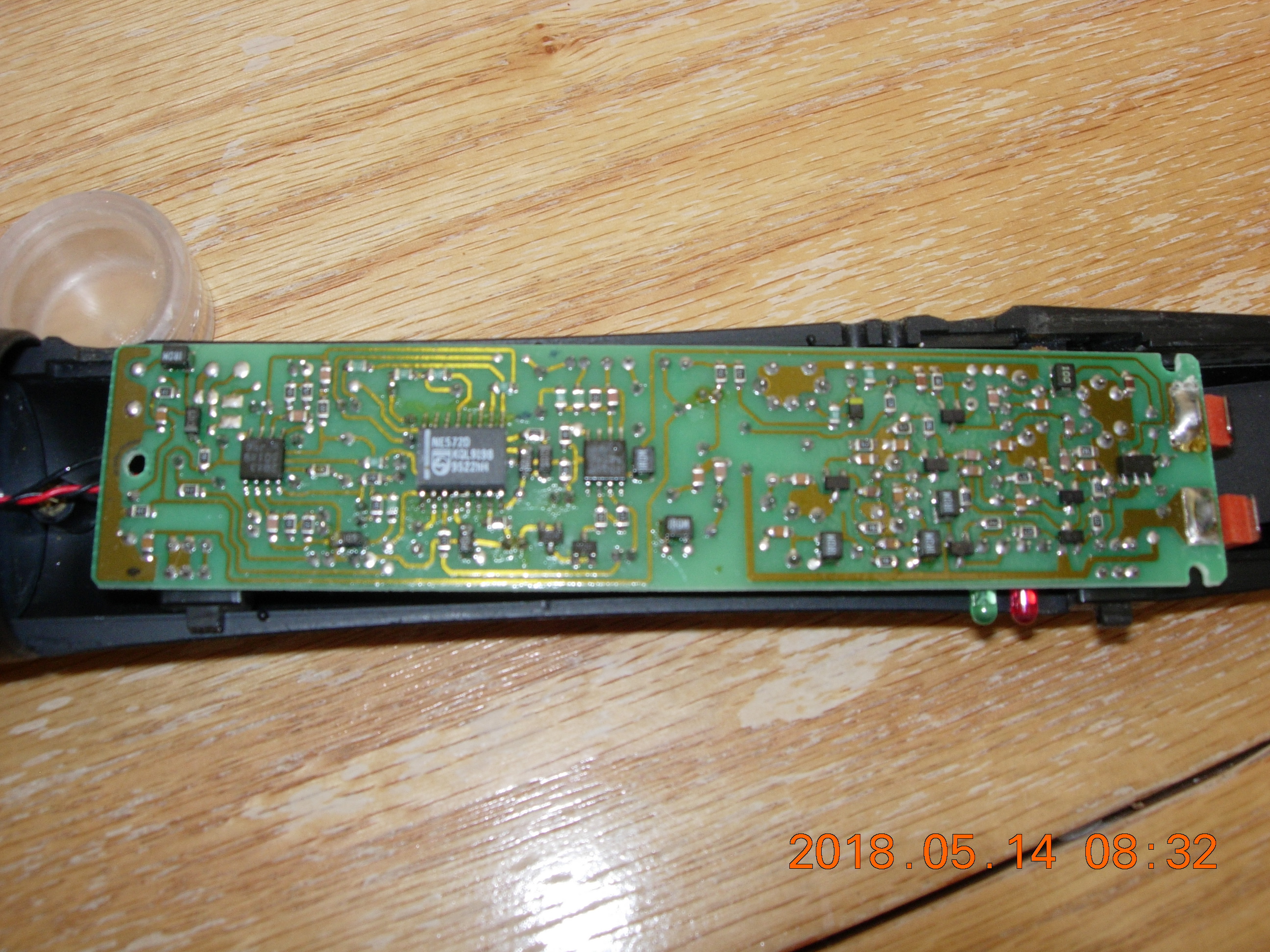

      Thanks for your reply.
      Attached please find some more photos on the board.

        Are you sure the component is actually missing? it sure looks similar to the other green components in the circuit and 3572 would be its value. Could be 35.7K, measure it, they seem to be 1% resistors

          I am not sure if a component is missing there. I do not know what 3572 represents. Also, I do not find any component left in the housing which might be from that location.

            35.7k precision resistor.
            and it's there.
            maybe you have low gain in the reciever.

              Yes, when I look at that again, the red circle area is already with a green component with the marking of 3572. It is quite thin that made me thought that a component is missing and also thought that the marking 3572 is on the pcb.

                Yes, you are right. Nothing missing.

                    I agree, nothing missing. Right about now and oscilloscope would come in handy to check for gain at the various stages. Do you have a second identical mic?

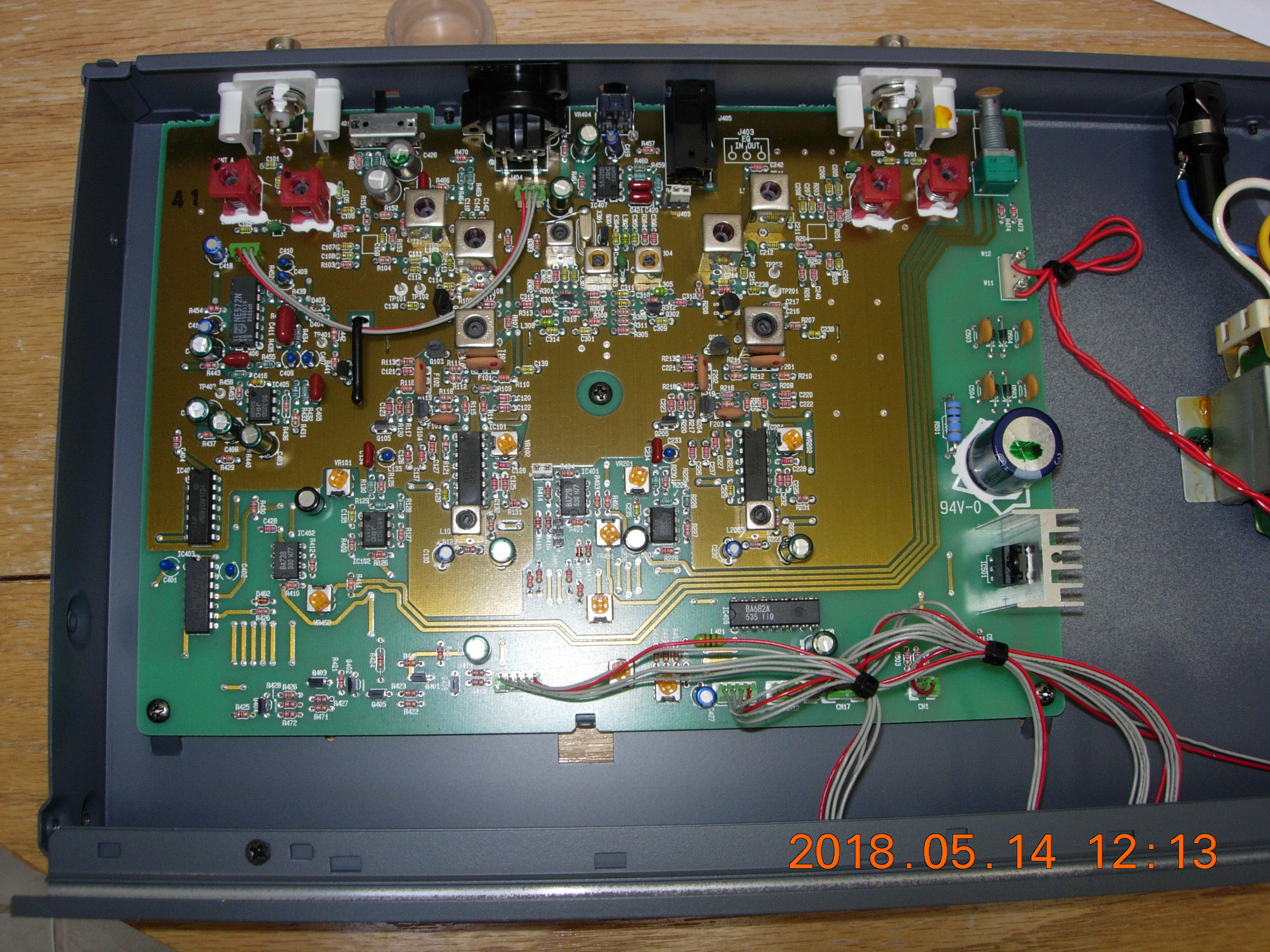

                        There are a "audio adjust" and a "squelch adjust" at the back of the back of the receiver. I have tried adjusting them and they could not help.
                        I open up the receiver. There are several "controls" for adjustment. Will there be one can help on this?
                        (I have a multimeter and know how to use it to measure voltage and current.)

                          Since this is an FM mic and receiver, the deviation and or frequency could be off on either side or even both. That would lower your "volume" as such too. Another thing that does come to my mind is if an IF gain amp is bad.
                          To check the mic properly, I'd get a hold of some tech in your radio club that has a service monitor or something that can measure the deviation of the mic rf output. If you get at least 3.5khz deviation out of it, it's fine.
