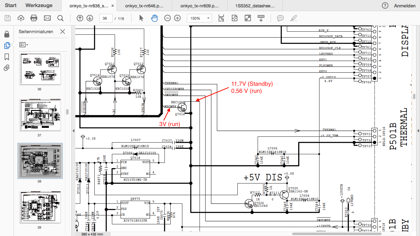

          Another last question before i will check everything is ...
          What voltage should i have at PIN 1 on the HDMI Board connector P901? The SM from the 646 says 3V. But I only measure a voltage of 0,3 .. 0,6v. Is there something wrong?

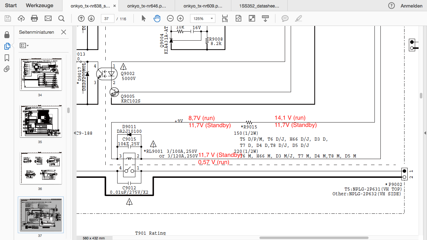

            So! I'm back again with some more informations. I checked a working TX Nr609 from a friend to be sure which voltage is normal for MPOWER. After Powering on the 609 i measured a voltage of 3,1V on PIN 1 of connector 901. Also like the SM for the TX NR646.
            But if i'm measuring the Pin 1 of my 838, there is only 0,5..V during run. This is not normal or what do you think?
            I checked Q7016 and changed this too with a working one but it's the same. MPOWER on Q7016 is 3,1V during run and that seems ok i think.
            Later i checked the Power PCB for errors and measured 11,7 V at MPOWERD during Standby. After run MPOWERD go down to 0,5..V but MPOWER which comes from Q7009 is Ok with 3,1V.
            Is this a normal process or could there be a problem in the Power PCB?
            I also changed D9011 and C9015 beside the Relais on the Power PCB but that changes nothing. Is it possible that the relay RL9001 don't work like it should?
            Regards, Mike
              #46
              Re: Help with Onkyo TX NR 838
              Well, take out of the board RL9001 and test it.. it looks like it is drawing too much power or the power supply is too weak.

                I think this was not the problem. I changed the old Relais from my 609 with this one inside my 838 and measured 330ohms on the old one (838) and 550ohms (609). The Voltage is now changed from 8,7v to 9,2v but everything was working like before.
                I'm not sure if this is ok but at the moment it works. The relays in the 609 though is not the same but both have 9V Coil voltage and are switching 120A,250V. I don't know the exact difference between both relays.
                Otherwise MPOWERD has now 0,52V instead of 0,37V and that means the state for low input on Q7016 is working. Also with 0,37V the receiver works well.
