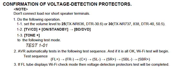

                                  Even if one channel of voltage-detection protector check is NG, Wi-Fi connection check doesn't begin... .AVR automatically tests in the following test sequence. And if it is all OK, Wi-Fi test will begin.
                                  Test sequence
                                  (FL+) → (FR-) → (C+) → (SL-) → (SR+) → (SBL-) → (SBR+)
                                  3. If FL tube displays Wi-Fi check mode then voltage-detection protectors test will be completed.
                                  So it looks like it does not pass the voltage-detection protectors test.

                                    Yes! I saw these lines in the SM too but that don't help me. In this test mode the receiver switches all channels through (The relays were clicking) and after the last channel, I think SBR+, it shows Video detection OK and after that comes NG.
                                    No WIFi test is starting and the test mode stays in loop. the clock is running but nothing happens.
                                    There is also no Voltage error in the debug window so why should there a voltage protection. The receiver runs good all he time and show no errors.

                                          Re: Help with Onkyo TX NR 838
                                          Originally posted by madan1
                                          If you can not cover the values specified in both steps, then just use step 2.
                                          By the way, have you done a factory reset after the repair?
                                          p.s. Just checked the SM, use 9-11mV for all channels after 10 minute warm-up run without input signal and speakers attached. This should be good enough.
                                          Do you mean pressing CBL/SAT + ON/Standby and then Clear appears on the screen? Yes! Thats what i did.
                                          It's possible for me to adjust the pots after warm up to 9-11 mV. I will try this next time. Otherwise i think there is another problem with the main Receiver. Today i removes the Pre AMP Board and turn on the Receiver to start the test modes again.
                                          And whats happened? The same behaviour than with the Pre AMP Board installed. I tried to ran the idling test (Test 1-01) and the same error occurs on the display.
                                          That means there is no problem with the Pre AMP Board but also with other parts within the receiver.
                                          Today i also measured the voltages and find out that the VOLH Voltage is normally between 0,47 and 0,5 V. But in the SM the graphic shows a voltage near 3,3V during normal run. Could this be a problem?
                                          Otherwise i don't have 64V but only 62V. But i think this is no problem at all.
                                          How i can check that my HDMI Board is running well? I'm not sure that there is problem and i want to exclude it.
                                          Regards, Mogli
