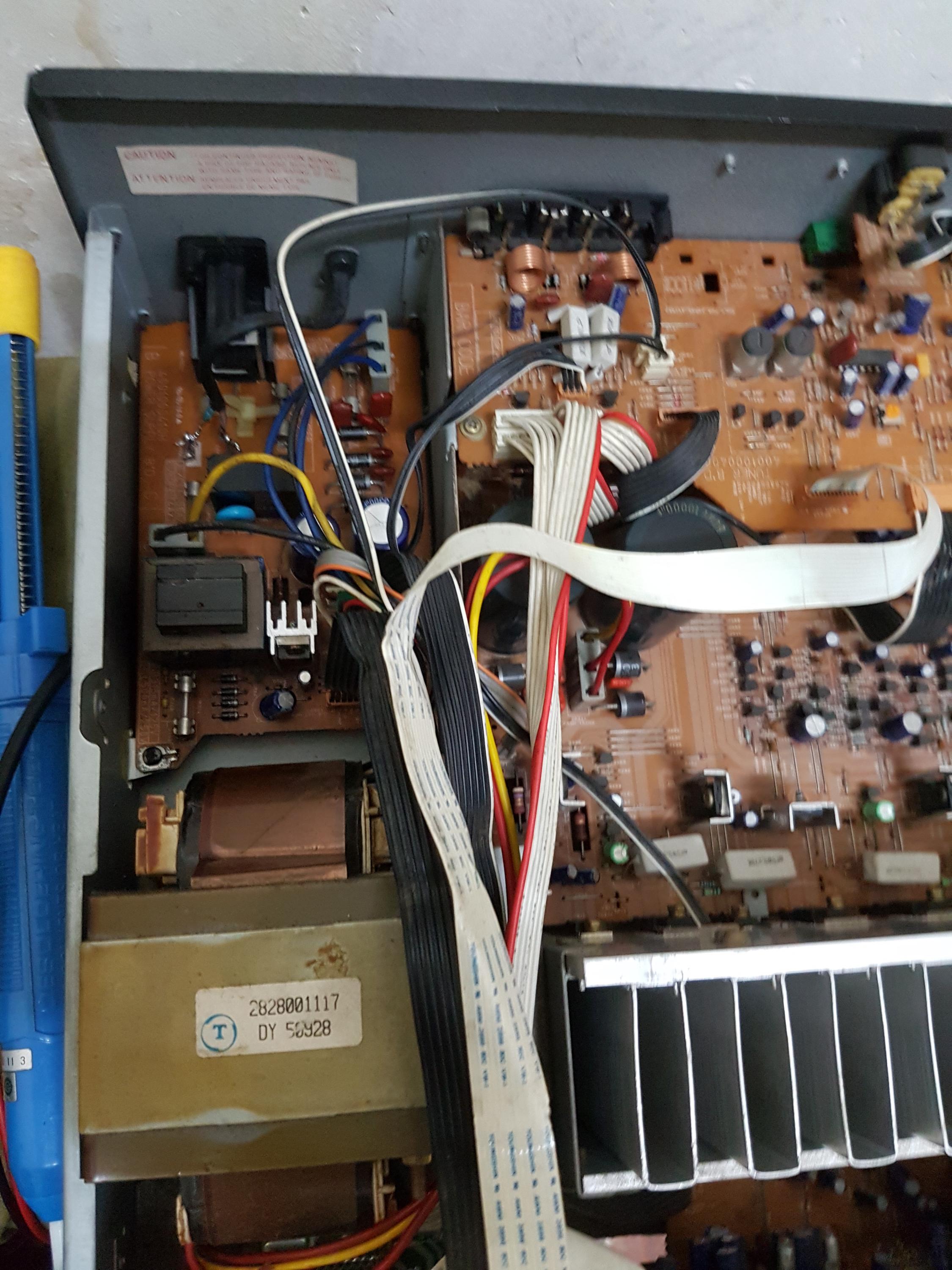

    Guys, anyone had this issue before? When the amp is cold and newly plugged in to power and when press the standby button, the power relay goes ticking on n off pretty fast, then when it gets a bit warmer, the relay ticking goes slower and slower and then no more ticking. But it DOES goes on protection mode there after as it goes back to standby mode when press the power button.
    Its a Harman Kardon AVR 25II. I have already resoldered all the cold joints. Checked all the output transistors. All good.
    Looks more like some capacitors are gone or maybe the voltage regulators dying. Any suggestions?

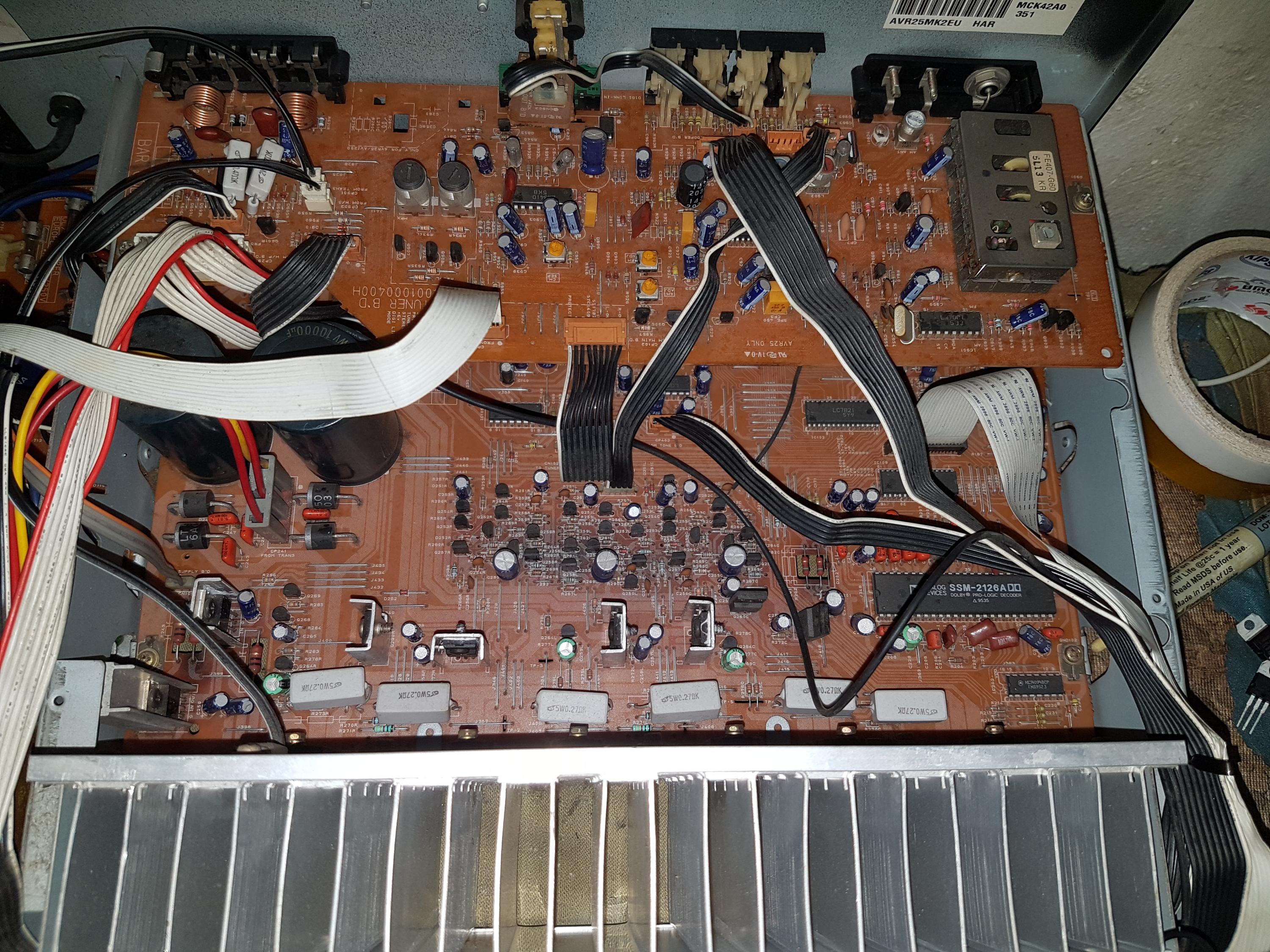

      Manage to fix the relay ticking problem. Theres about 8 small electro caps gone bad on the power board and the main board power section. But it still goes to protection mode after few seconds turning on.
      1 problem solved. Now the protection part. If i pull the flex cable that connects from the main to display panel, it stays on. I believe the protection is in that circuit.

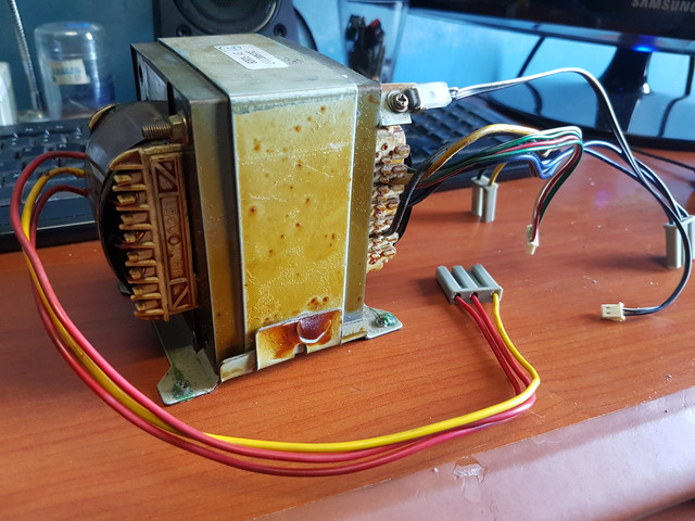

                  The transformer as you can see in the picture, the red cables both has 40v supply and the yellow has none, zero. Is that correct? The red red yellow cable is the supply for the filter caps. Because i see only 1 filter cap is powered and the other has zero voltages.

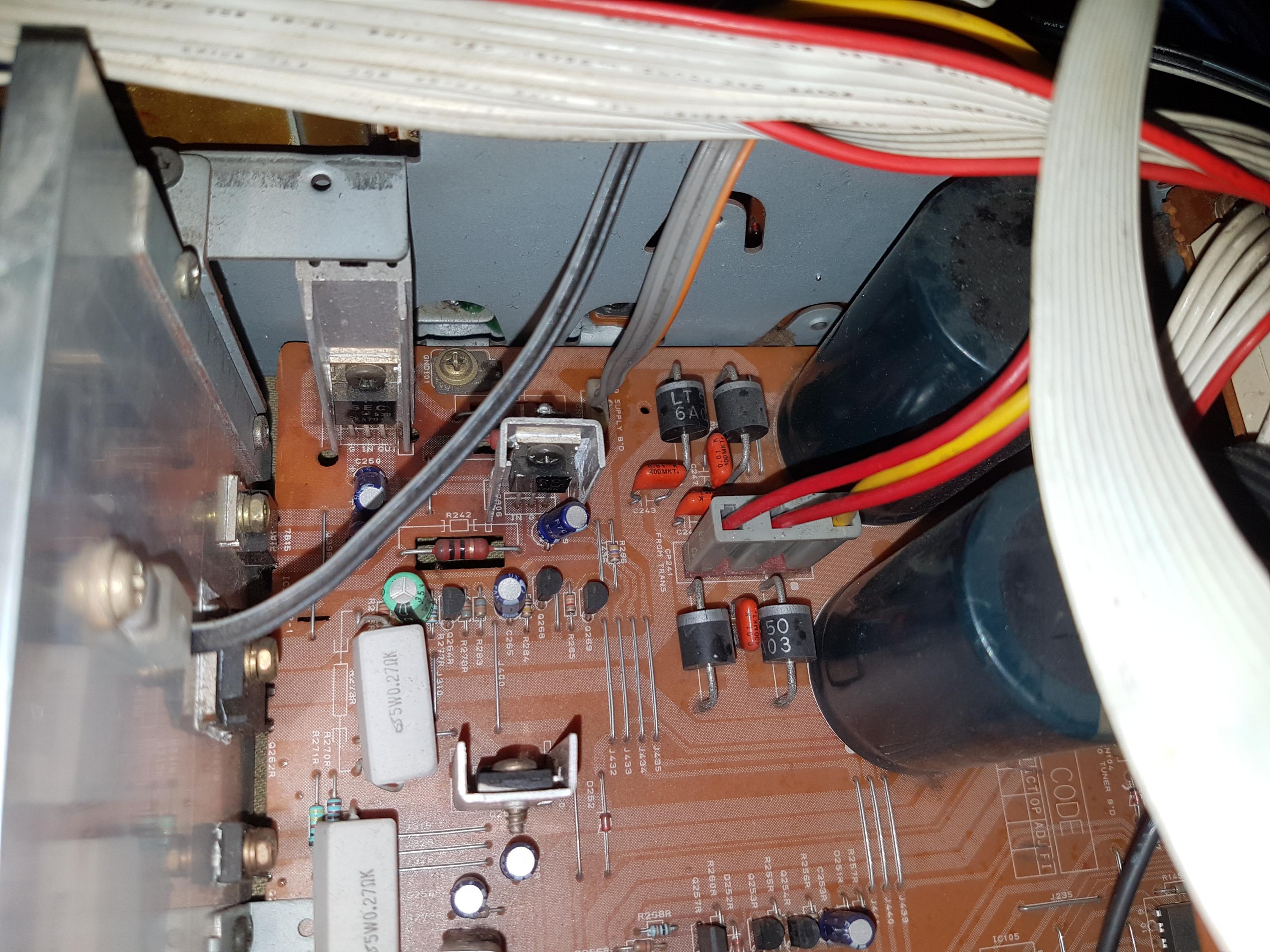

                    Now i spot 2 problems. The 2 middle transistors receiving high voltage on the resistor legs. And some of the channels not receiving voltage due to one of the filter caps is not receiving any voltage.

                      The transformer is center taped. Red - yellow - Red
                      If there was a problem with the transformer HOW do you explain the fact that the other channels are working??????????
                      SEE POST #3
                      Look at page 46 of the manual, that CP241 should be the plug. Red to one side of bridge rectifier. yellow (goes to ground) Red goes to other side of bridge rectifier.
