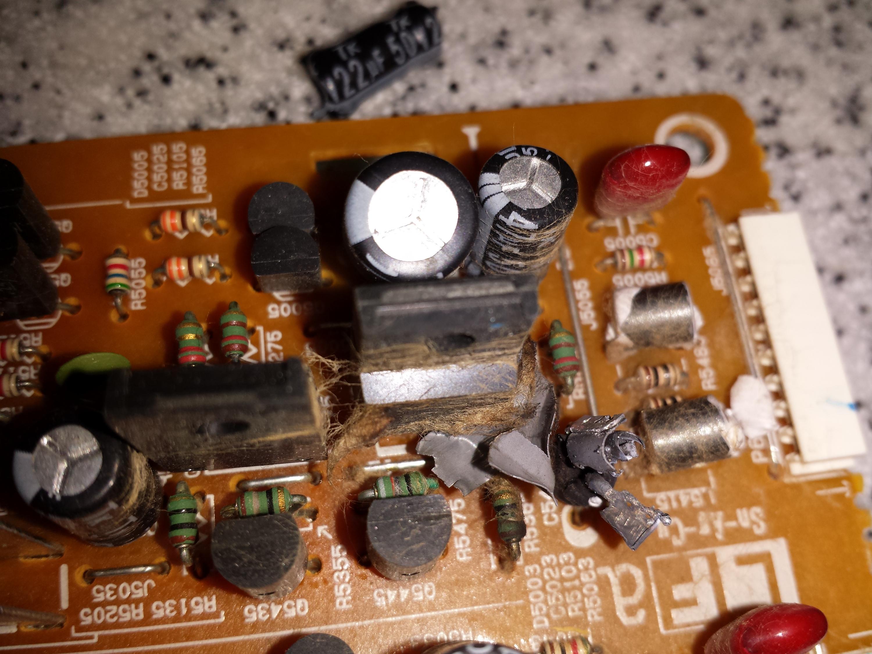

    The SBL channel on the driver board and associated output
    transistors have gone to meet their maker. A 22uf cap on the driver
    board (C5445) blew with enough force to wrap metal shrapnel around a
    nearby power transistor, and the power transistor (Q6065) has a crater
    in it.

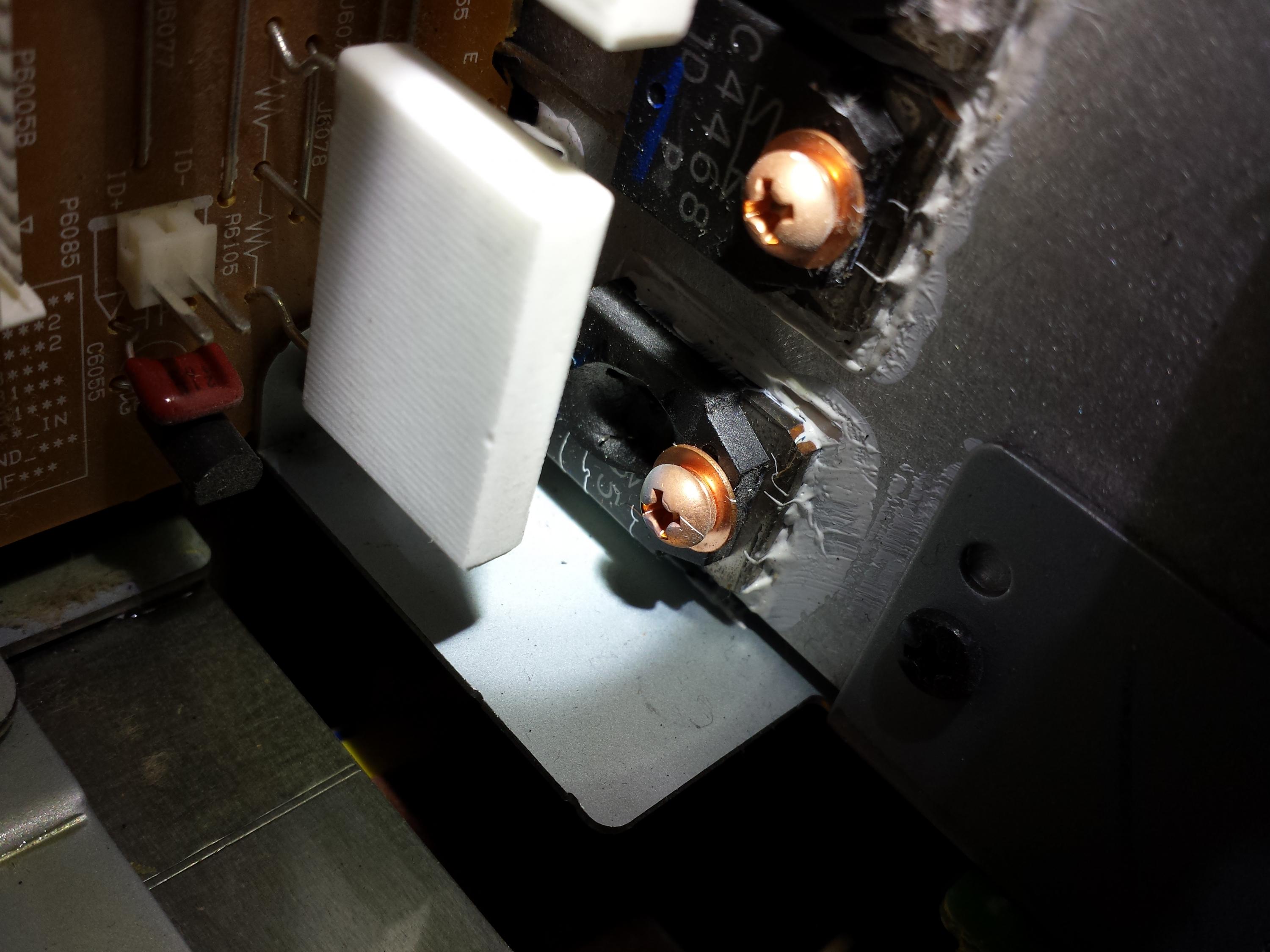

    As to the "why" I dunno but not totally out of the norm for an amp to blow a channel occasionally and take a few good parts with it. It has been noted by myself and others that the finals don't seem snugged up to the heatsink on some models so there's a possible thermal issue there. Wouldn't hurt to have a look.

      I have repaired quite a few Onkyos already and on all of them, all the finals were just snug. This is my theory, that they are not tightened properly and the heat is not transferred properly.
      Most likely, that big white .22 Ohm ceramic resistor, is open as well. Not to easy to find one in 5W.
      Usually, I find the two final transistors blown, that .22 resistor and maybe one or two very low resistance resistors are blown.
      The biggest damage, is on that pre-amp board. Most likely, you have at the bottom some SMD transistors blown, the pre-final one(maybe both), capacitor, some 2.2, 33, 120 maybe 10 Ohm resistors.
      You should check everything, at that channel.
      When is all replaced and checked, at least on the models that I have worked on, 636 and newer, I had to use, a 100 Ohm resistor on each lead going to the DMM, when measuring idle current. You will have an initial measurement and then a burn in measurement after like 5-6 minutes. You should have a variable resistor, at each channel and you should adjust it accordingly to the SM.
      If the values are rising way to fast, you still have a problem.
        I reckon that most of the problems like this, is caused by fricking pre-amp which runs very hot, even when idle.Next time, take a really close look at the solder joints of the faulty channel.
        In case like this, I always check that small transistor near the finals, it's Q6005 in SBL channel.
