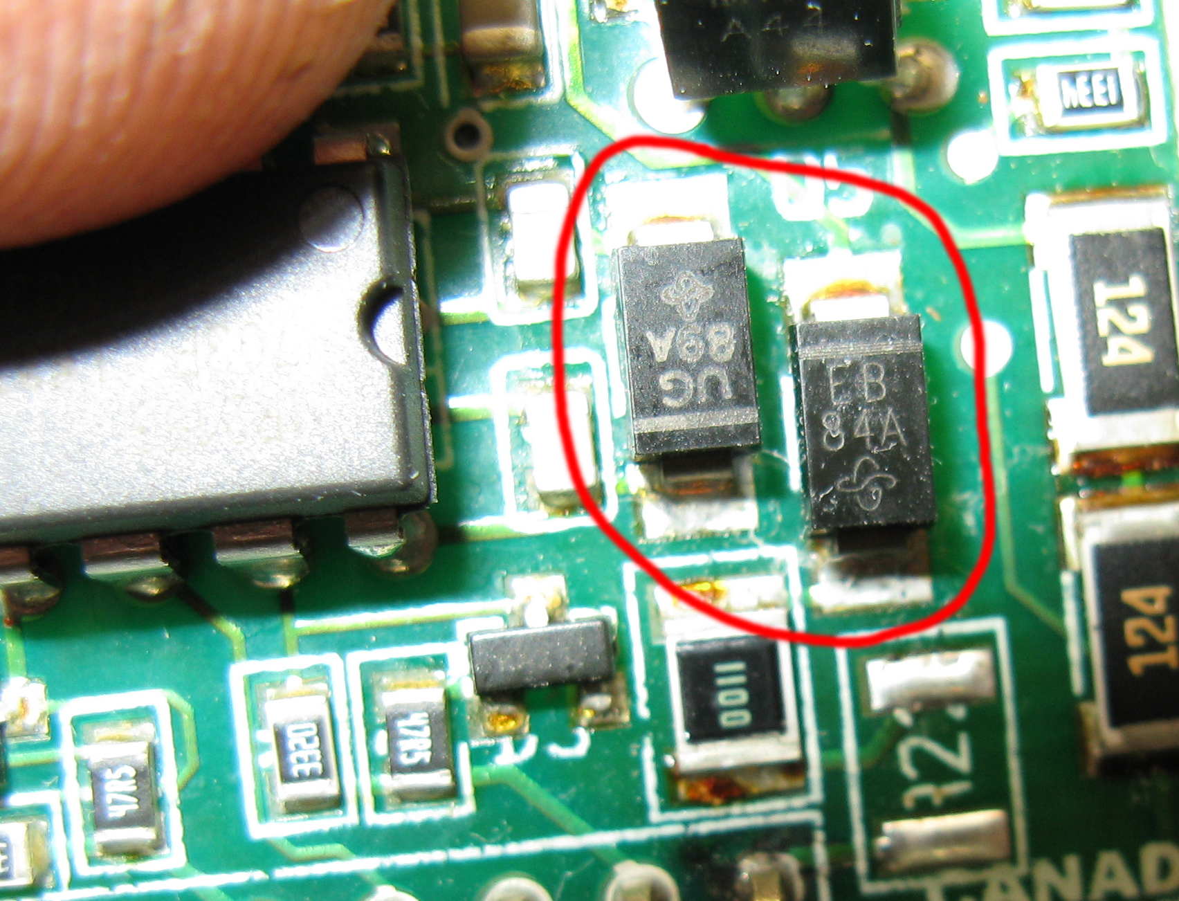

    Good morning folks,
    i need help identifying 2 diodes on on a Klipsch SW.112 PDC board.
    Can anyone please point me into the right direction

    Re: Need help to determine diode type
    Maybe this can help a bit ..
    The diode on the right side is manufactured by (SG) or General Semiconductor (acquired by vishay in 2001 ), from the logo on it .
      This should also help
      EB = ES1B
      UG = US1G
