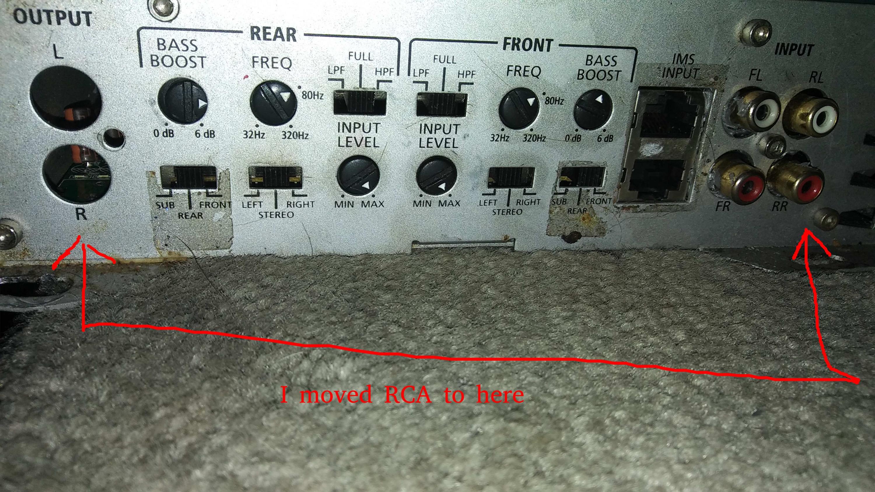

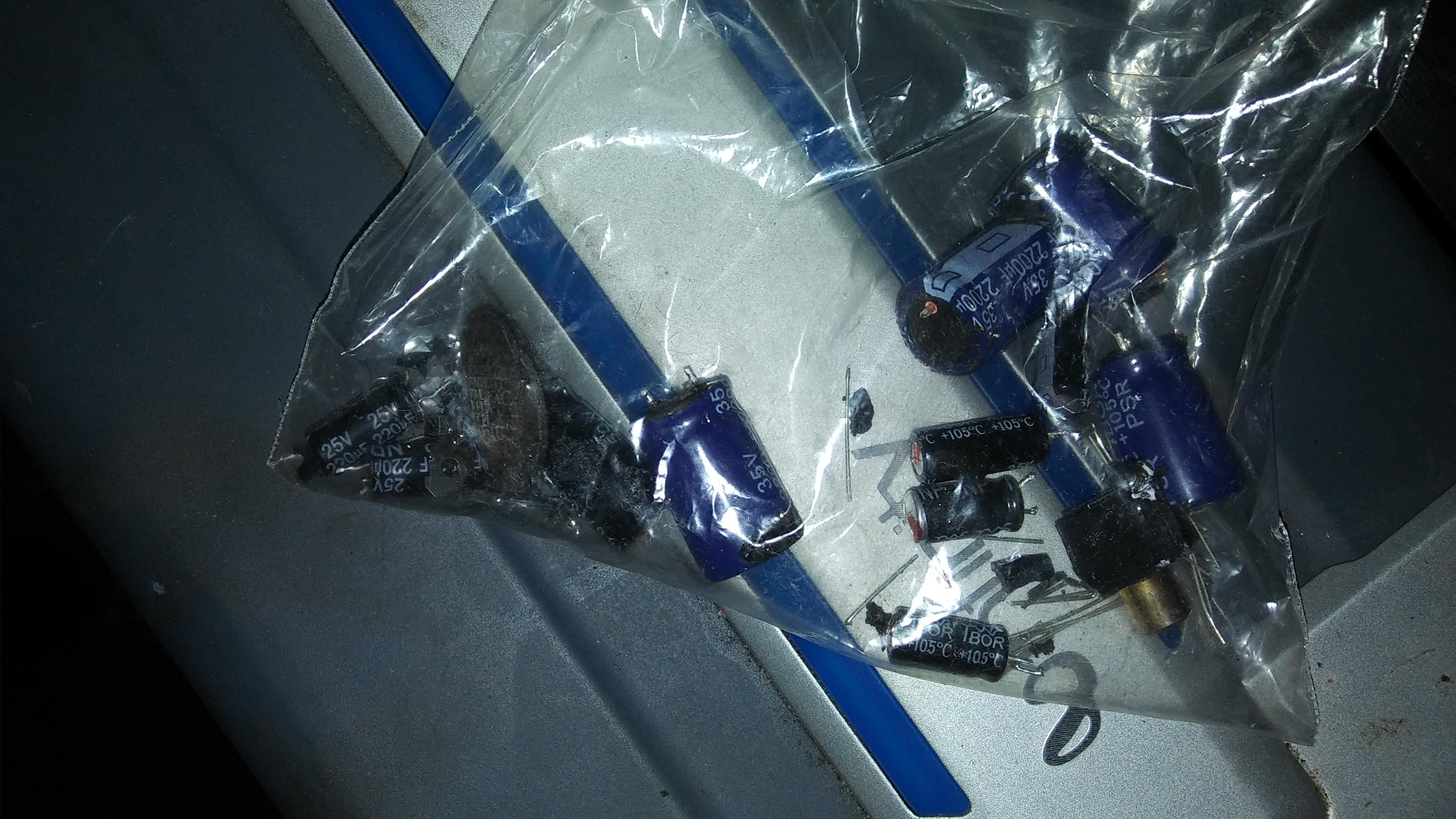

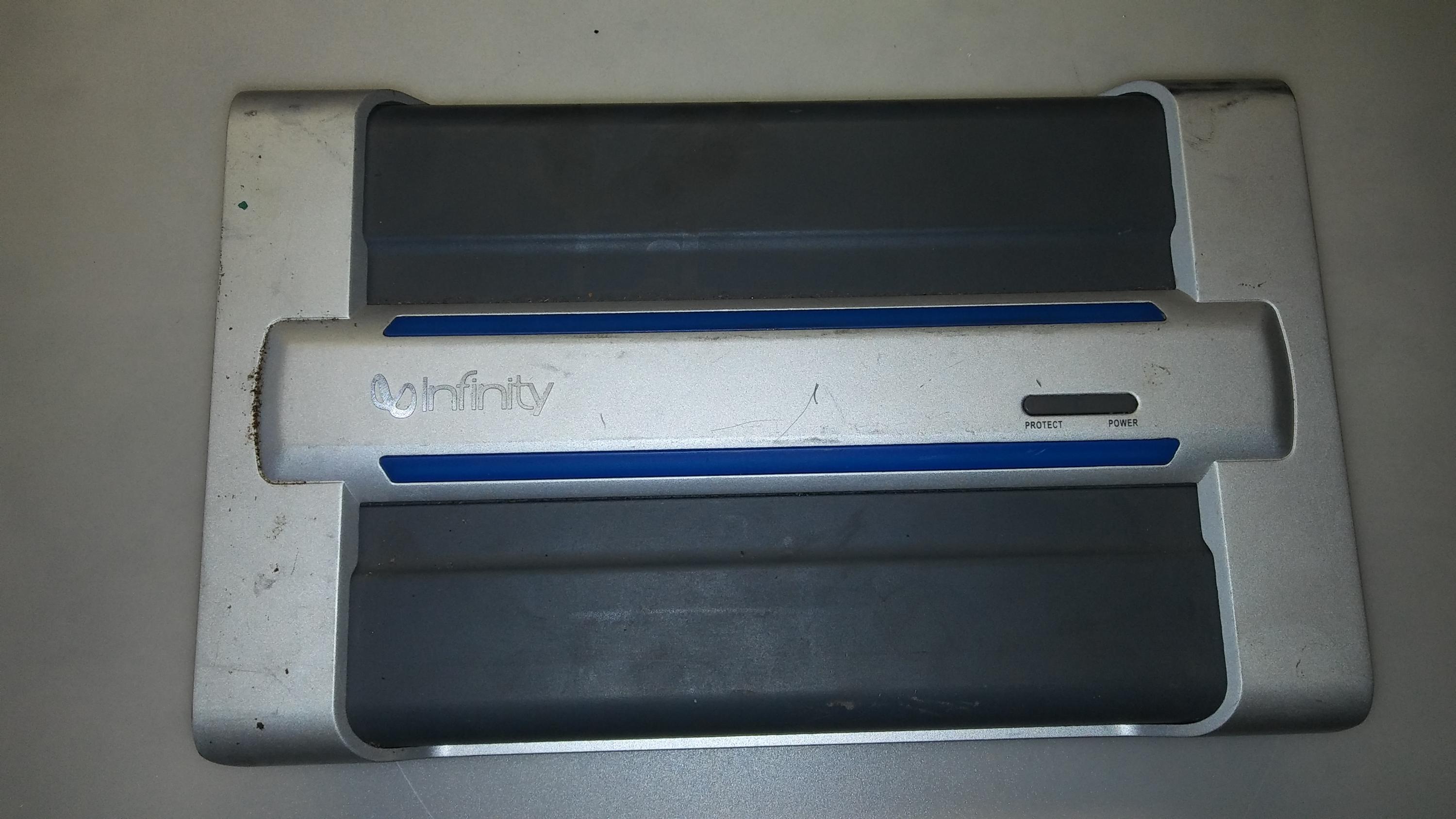

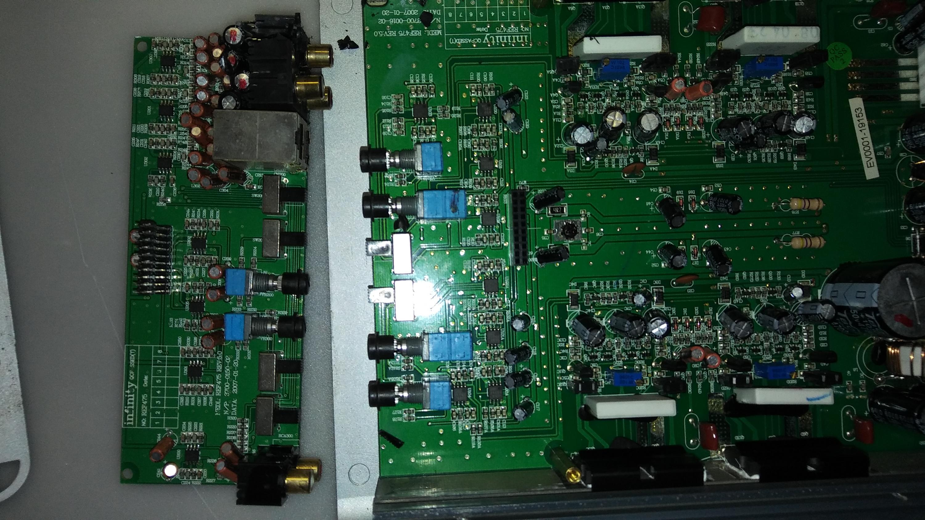

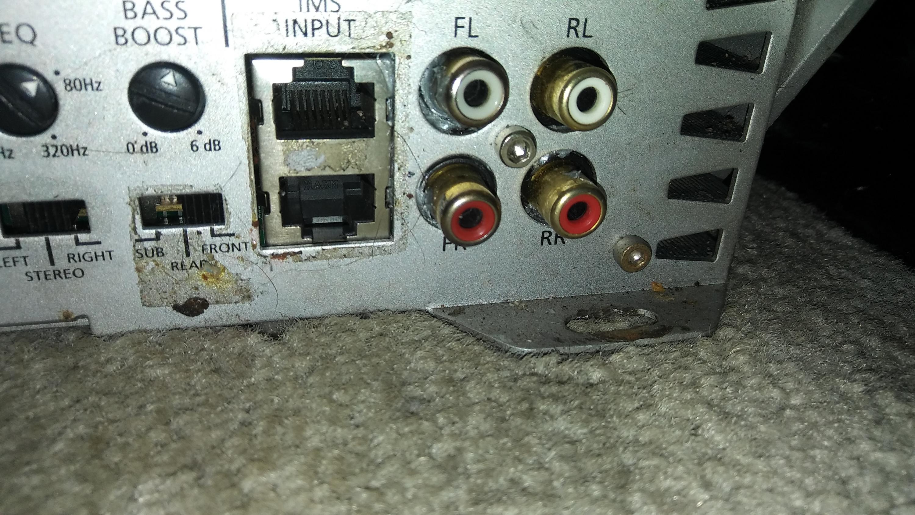

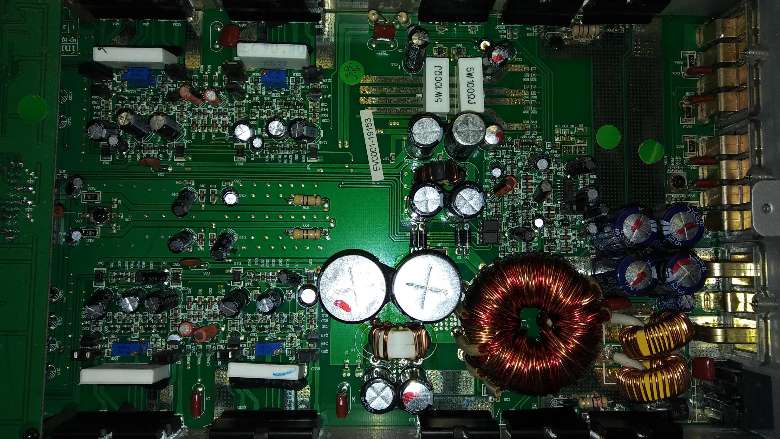

    Infinity Reference 475a, 4-channel car amplifier, 75 watts RMS x 4, Badcaps everywhere on this car amp, complain is 2 channels not work, change caps and see what's happening.

    PS: Badcaps also happened on car amp, after change all the Badcaps, all four channels working good.......

      Did you use low-ESR units at the outputs of the DC-DC converter?

        "low-ESR units at the outputs of the DC-DC converter?" YES, I use TV's low-ESR 105c capacitors.
