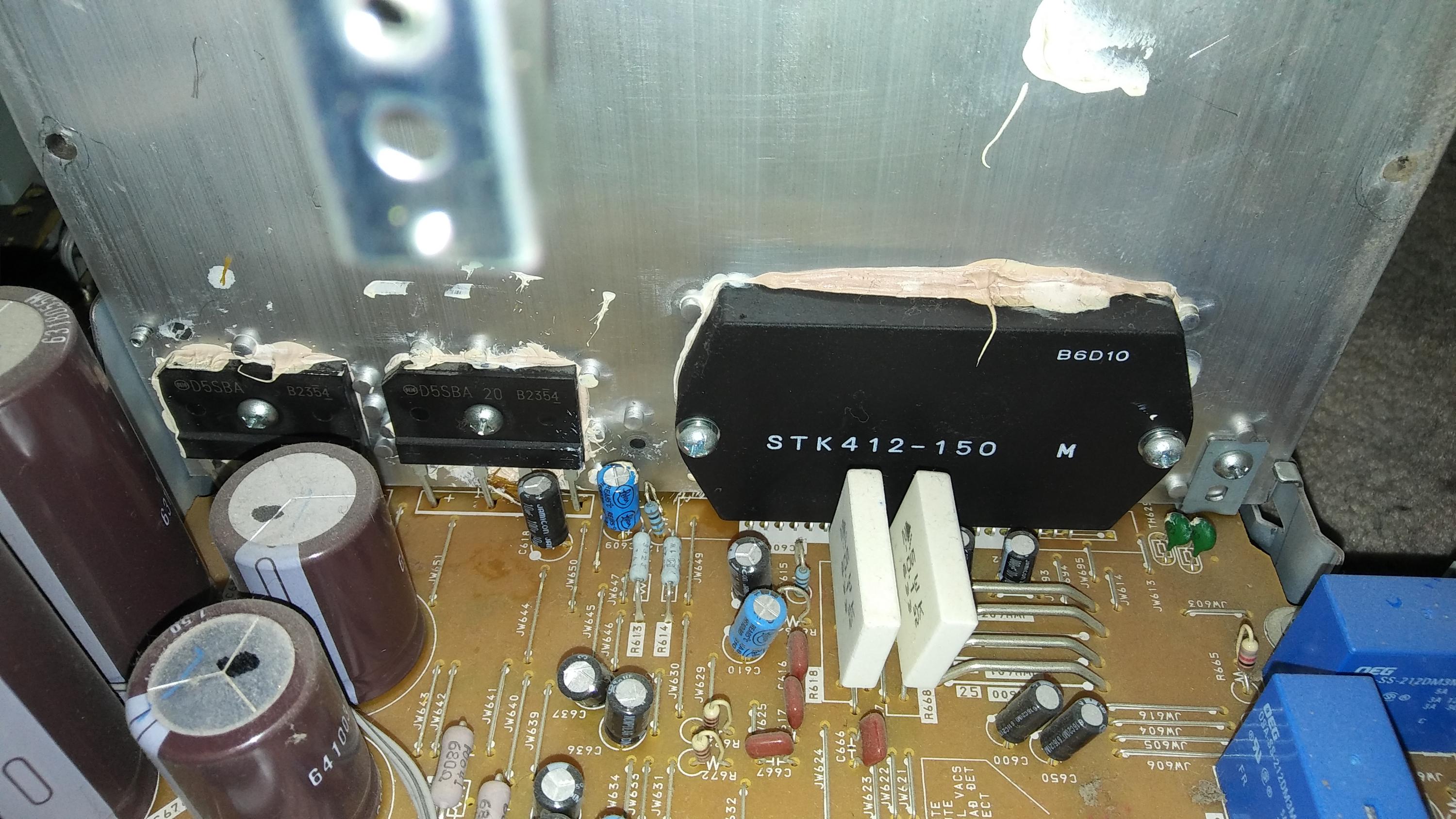

    Sony MHC-LX10000 - Mini system

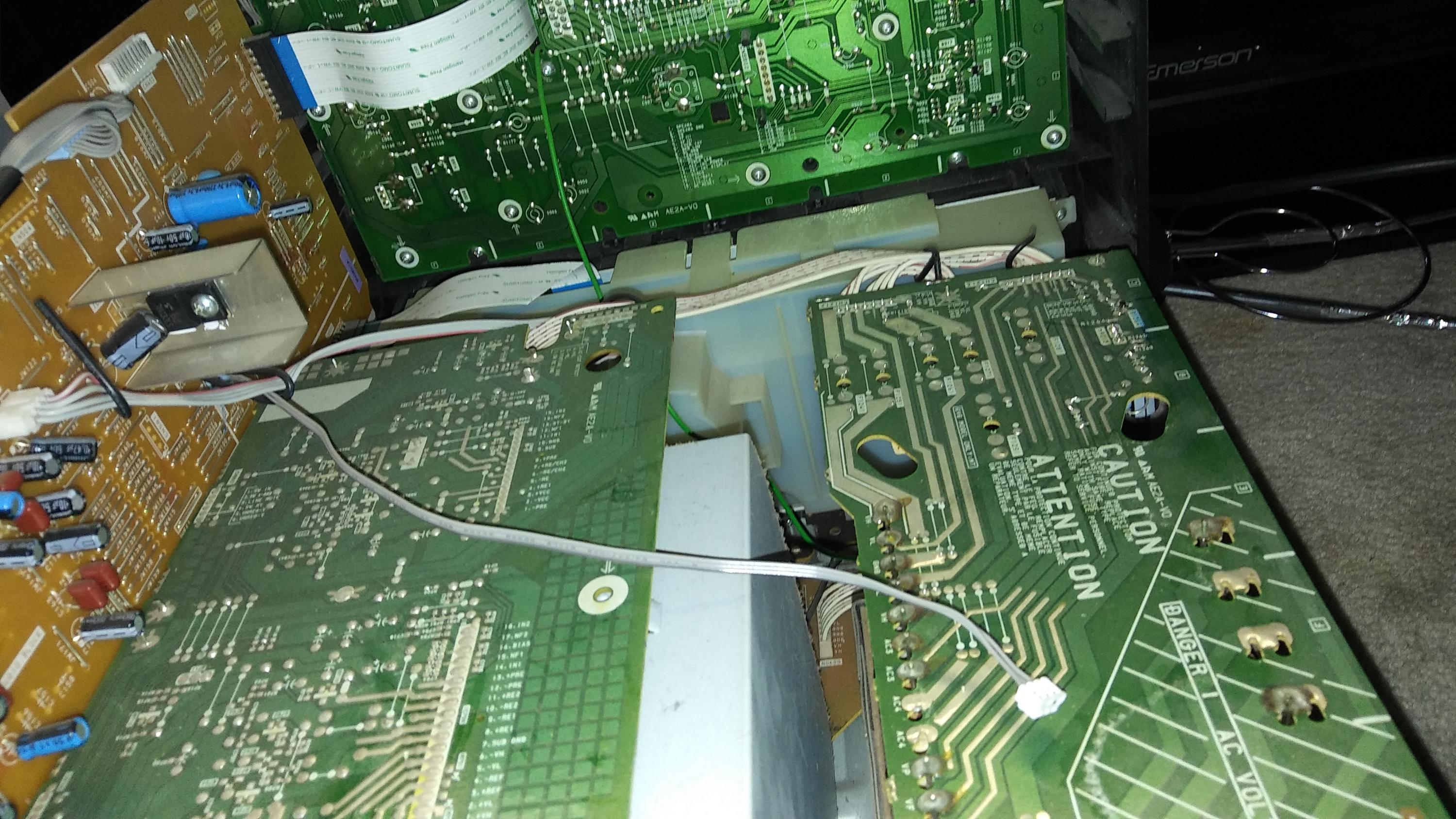

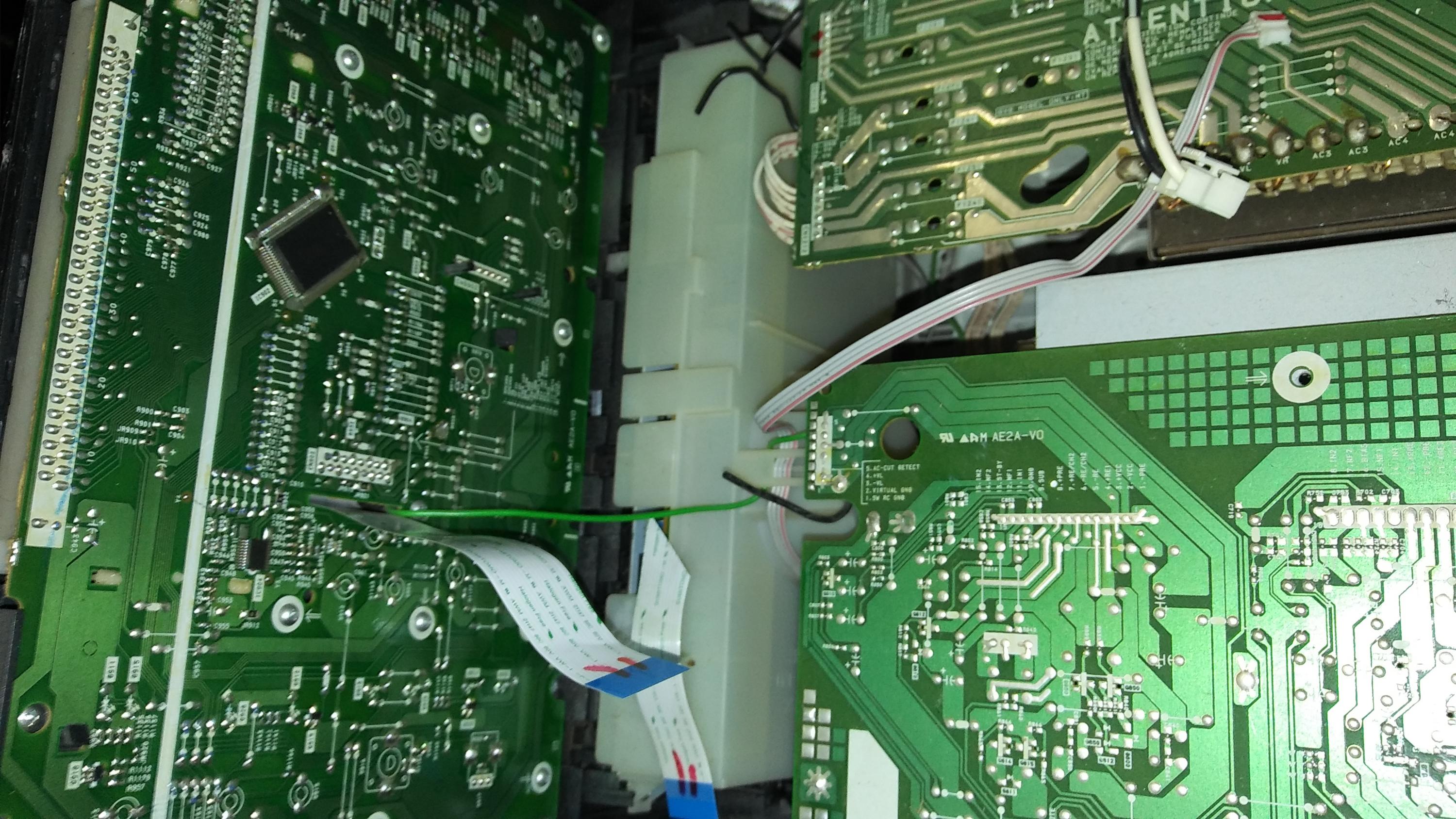

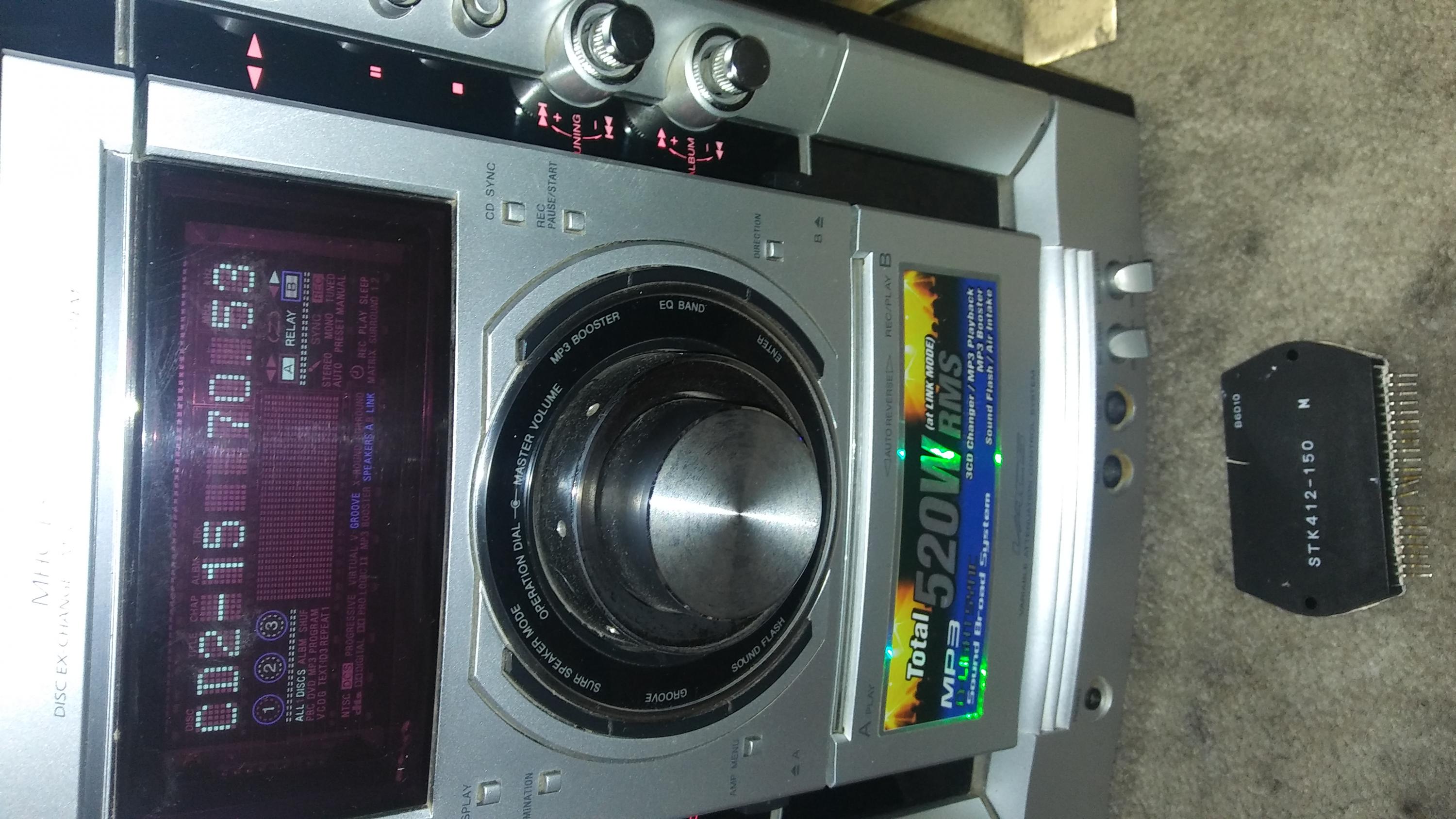

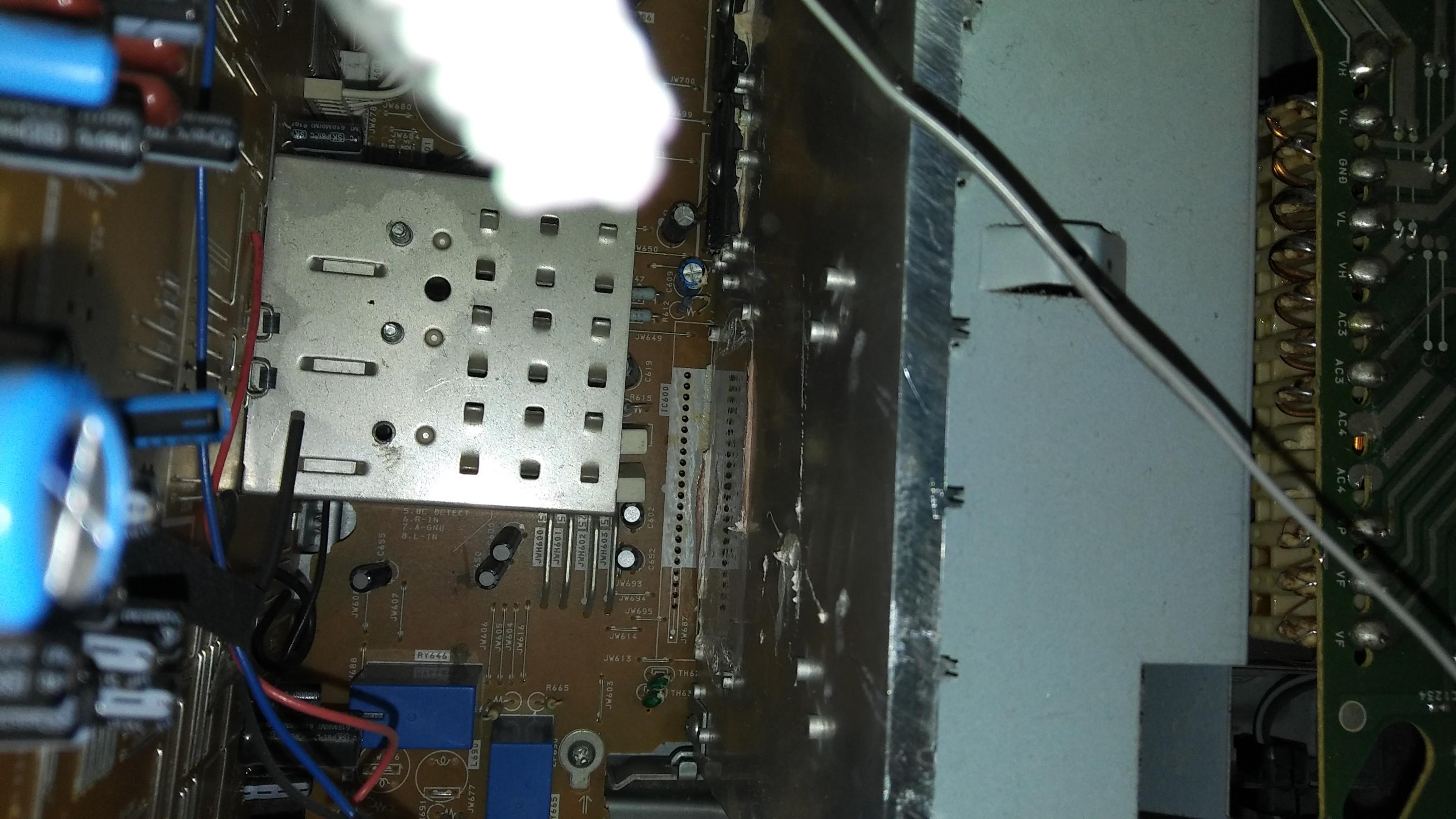

    Sony MHC-LX10000 - Mini stereo system power on then shuts off. take out IC600 STK412-150 system works, no more shots off,common problem on sony stereo.
  • capwizard
    • Jun 2016
    • 1991
    Re: Sony MHC-LX10000 - Mini system
    Update: After change new IC600 STK412-150 system works, no resistors burned and no fuse opened.....

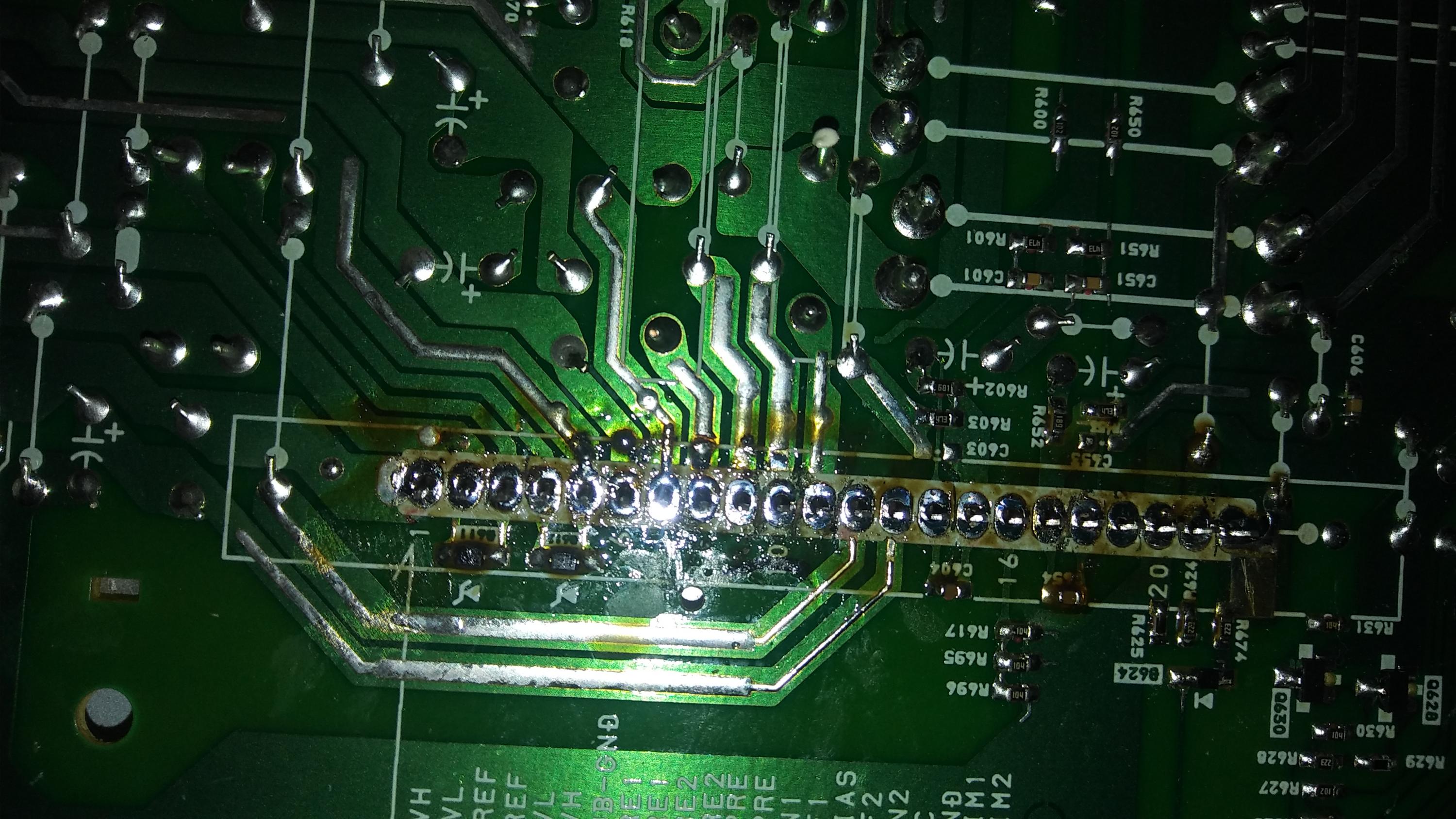

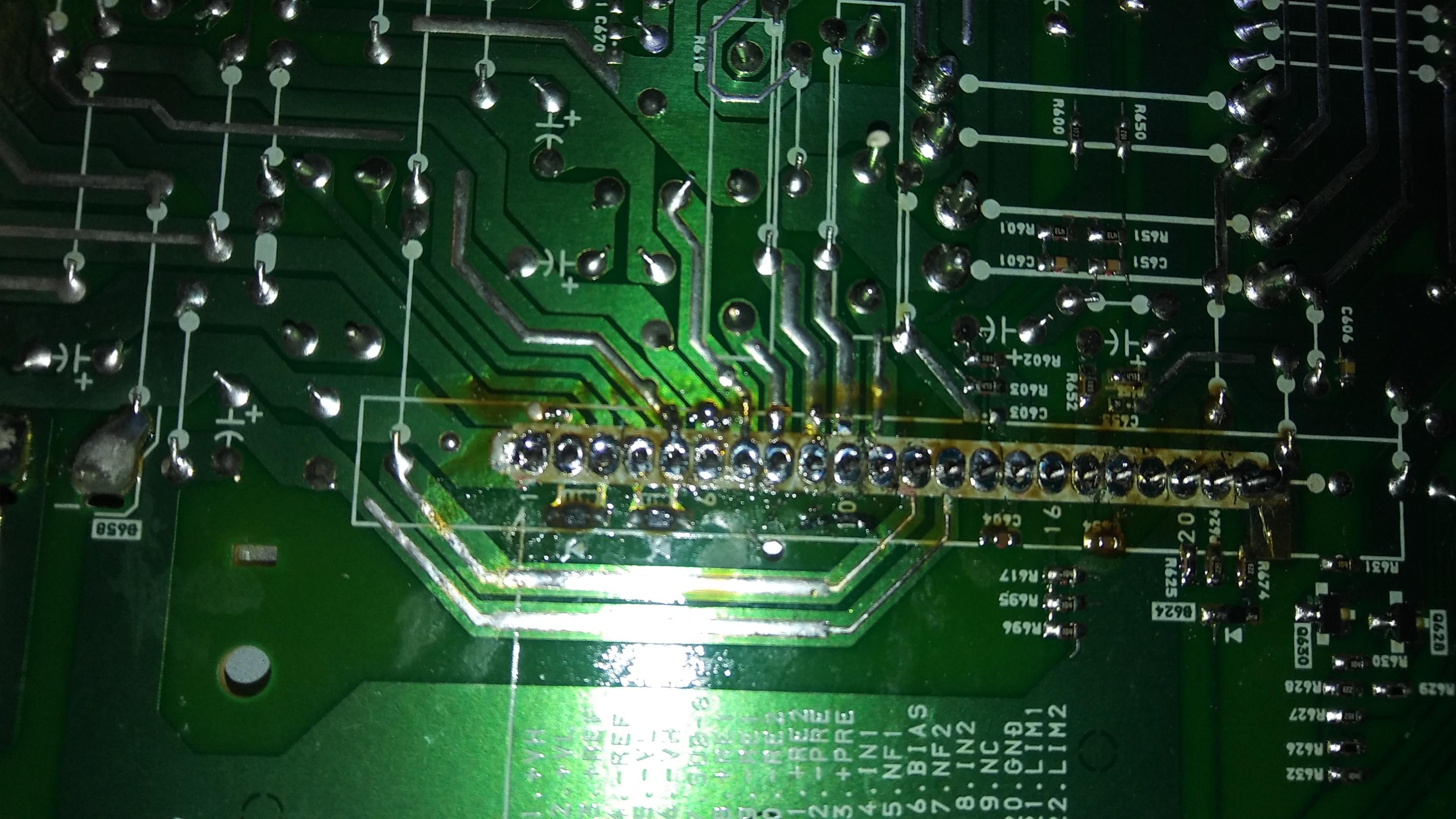

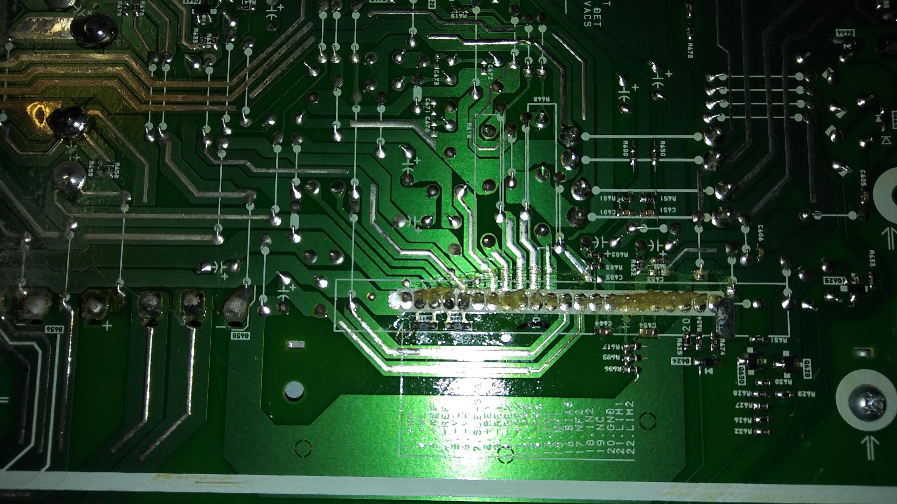

      I would clean off those flux and bunch of solder balls splatters.
        Both of the pictures was the IC I took out, after I test was working i forgot take a picture of the new one I put in.
