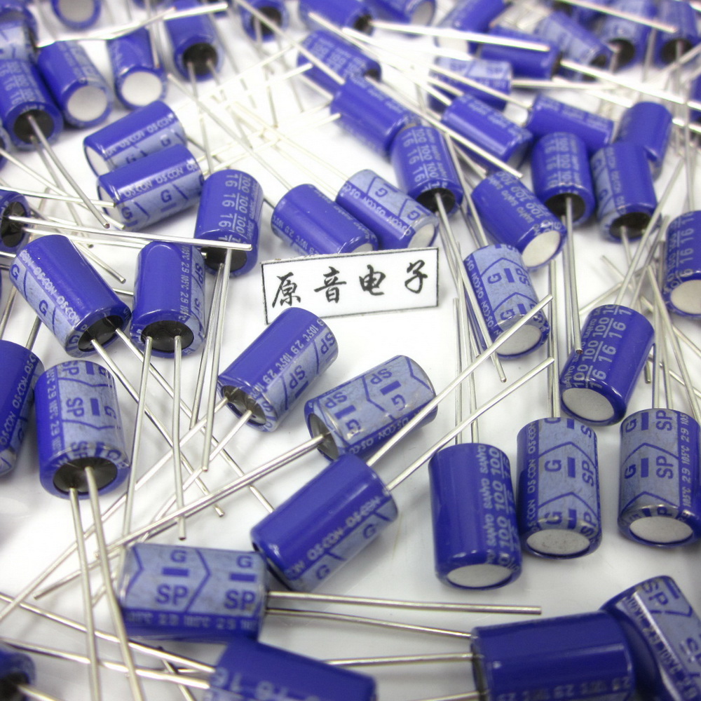

    Well, I replaced C201 capacitor on audio I/O board with a new Sanyo OS-CON 100μF 16V, the volume of left channel in earphone which plugged into earphone jacket on control POD are normal now.
    But still, no sound come out from any speaker.

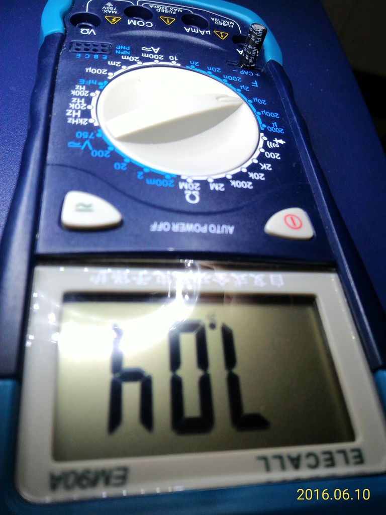

        and found that capacity reading of one 4.4μF/40V capacitor is 6.9μF and the value will become larger if power on for several hours then power off to measure.

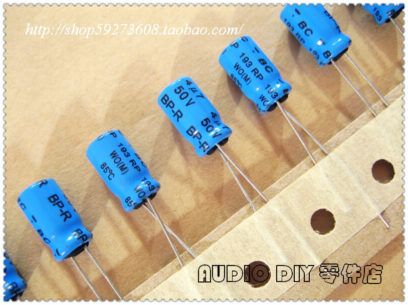

        Anyway, I'm going to order 40 4.7μF non-polarized electrolytic capacitors, maybe Philips BC 193RP or Nichicon VP . Hopefully, it will fixed the speaker.

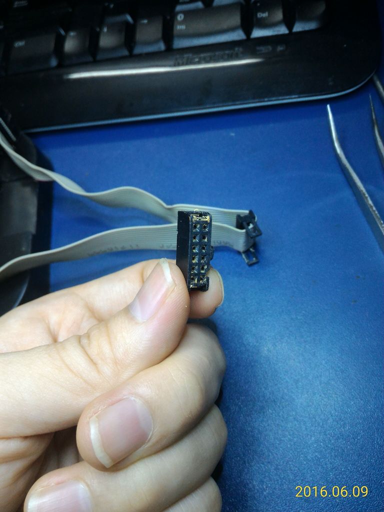

          Even changed all electrolytic capacitors, and even disassembled the connector of audio cable which connected audio I/O board & power amplifier boards to clean glues , still no sound / distort sound on Center & Subwoofer & Side Left & Side Right channels.
          I don't see visible damages or clear degraded glues on power amplifier boards, so now I'm lost ...

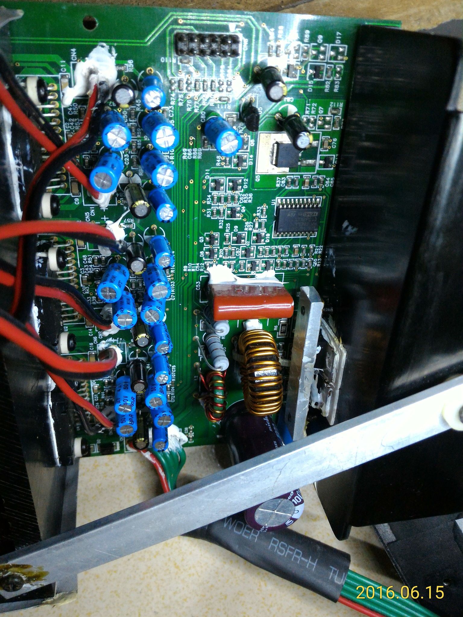

          This is what the power amplifier board 2 looks now:
          Last edited by moontide; 06-15-2016, 12:05 PM. Reason: add photo of disassemble cable connector

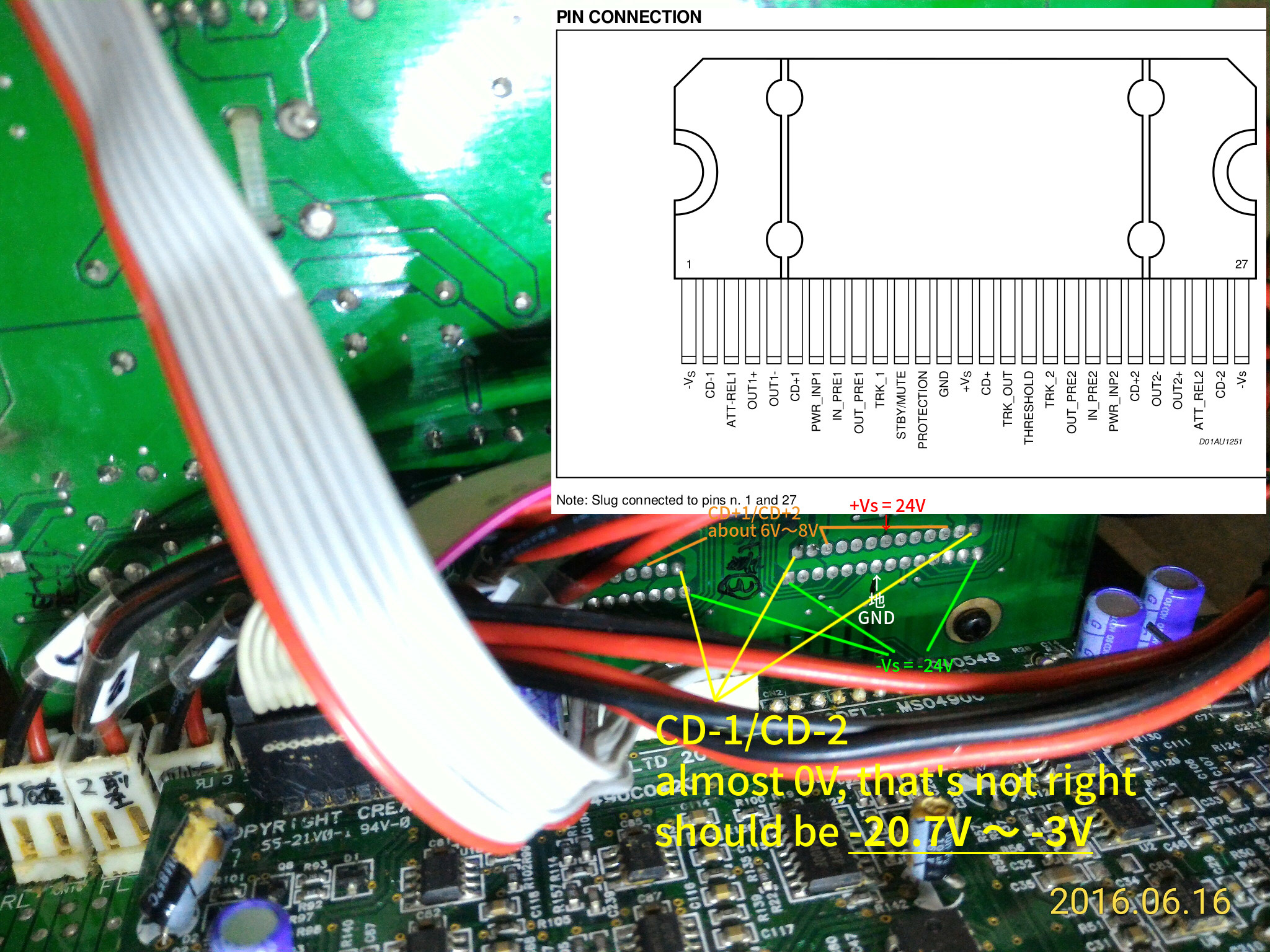

            I measured +Vs -Vs CD+1 CD-1 CD+1 CD-2 of one STA575 chip, found that voltage input of CD-1 and CD-2 is almost 0V, that's not right. According the datasheet of STA575, it's operating range should be between -20.7V to -3V.
            Since there's not schematics of power amplifier board, I think I need to trace the line on PCB board, that's could take me long time to do that ...

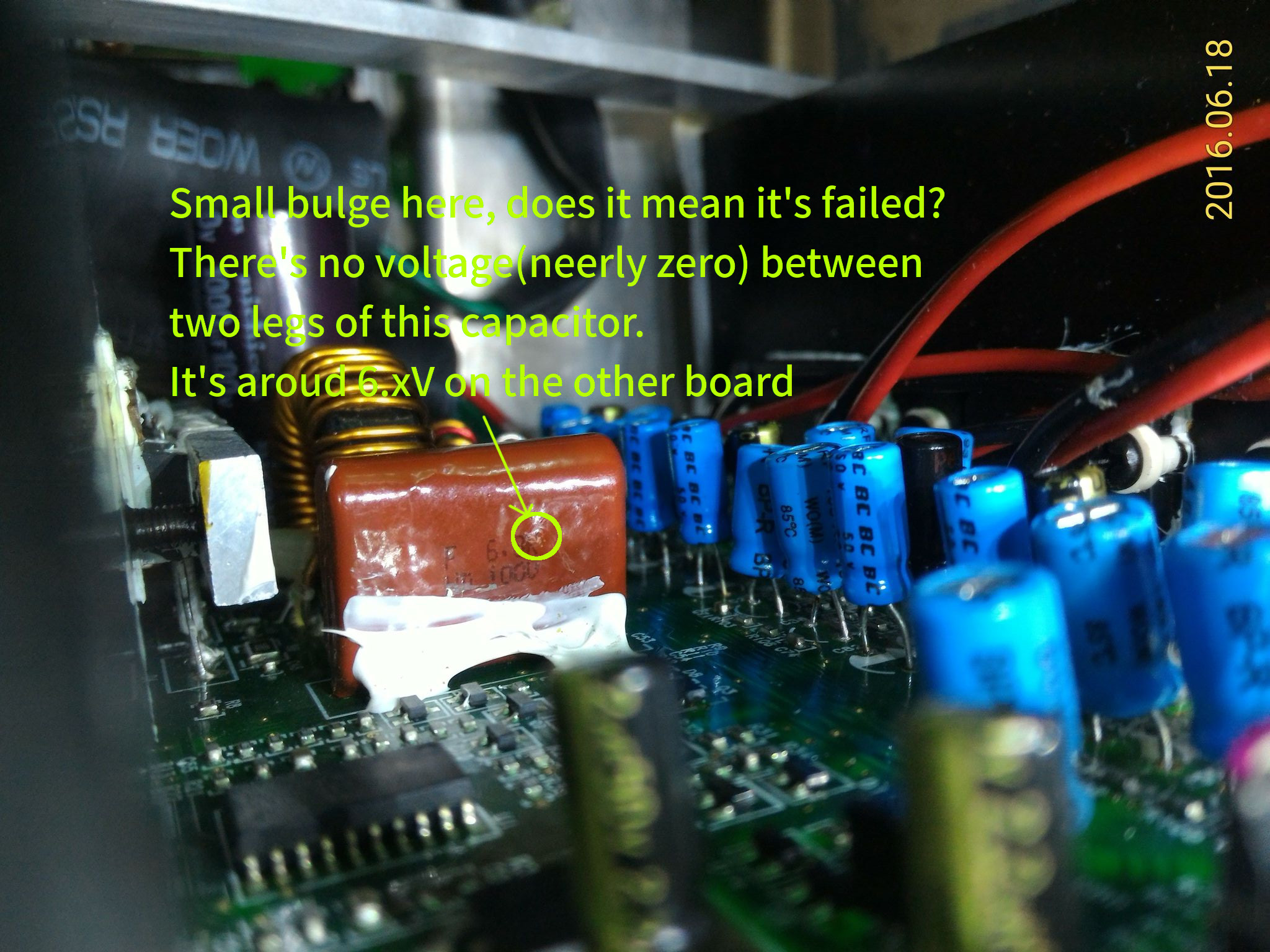

              Found a small bulge on the brown capacitor, could it be failed? There's no voltage (neerly zero) between two legs of this capacitor, while on the other board, it's around 6V

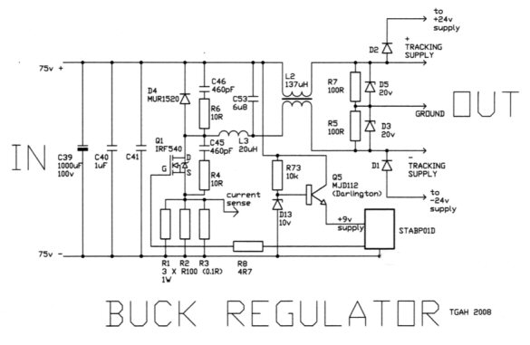

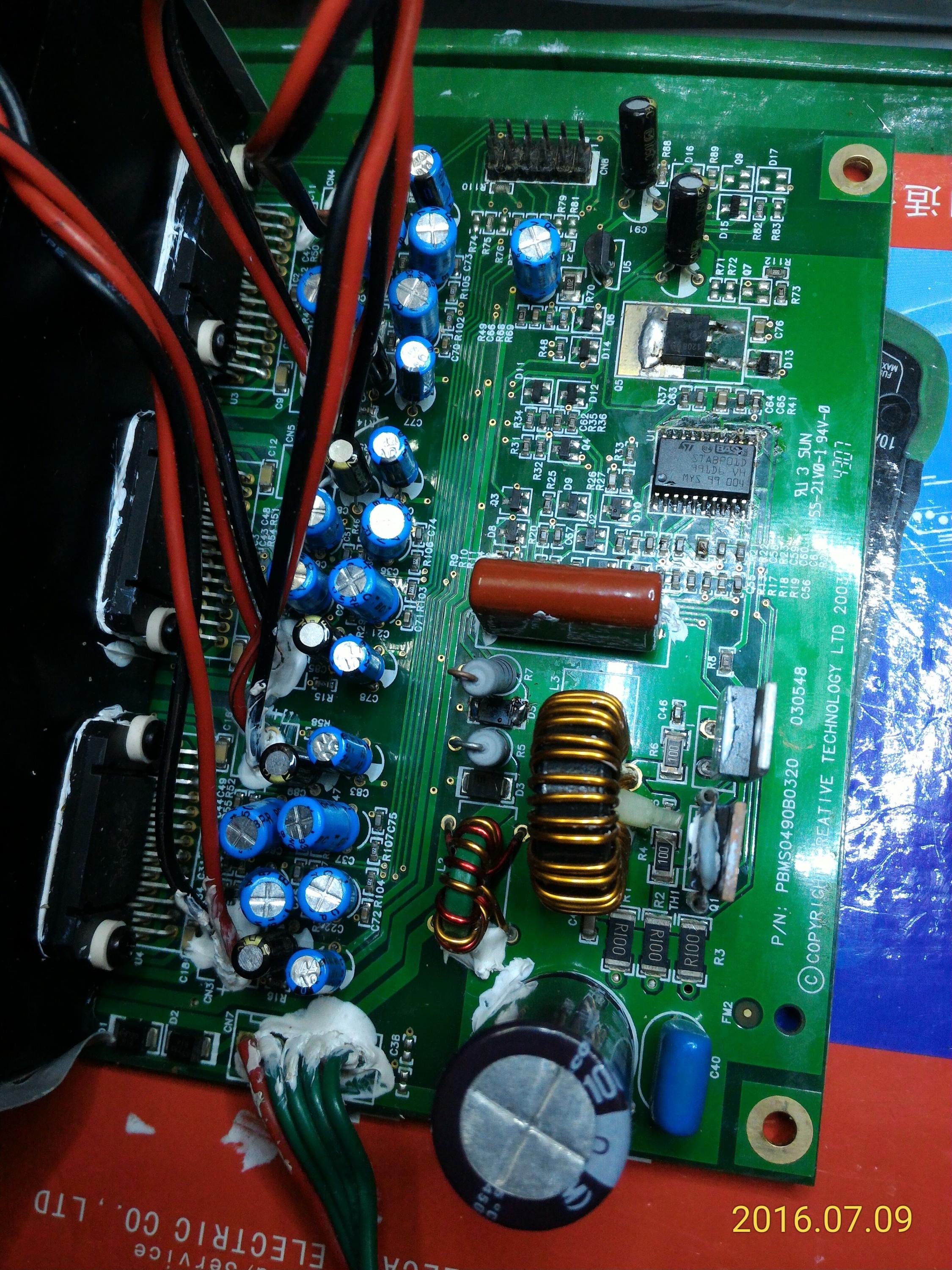

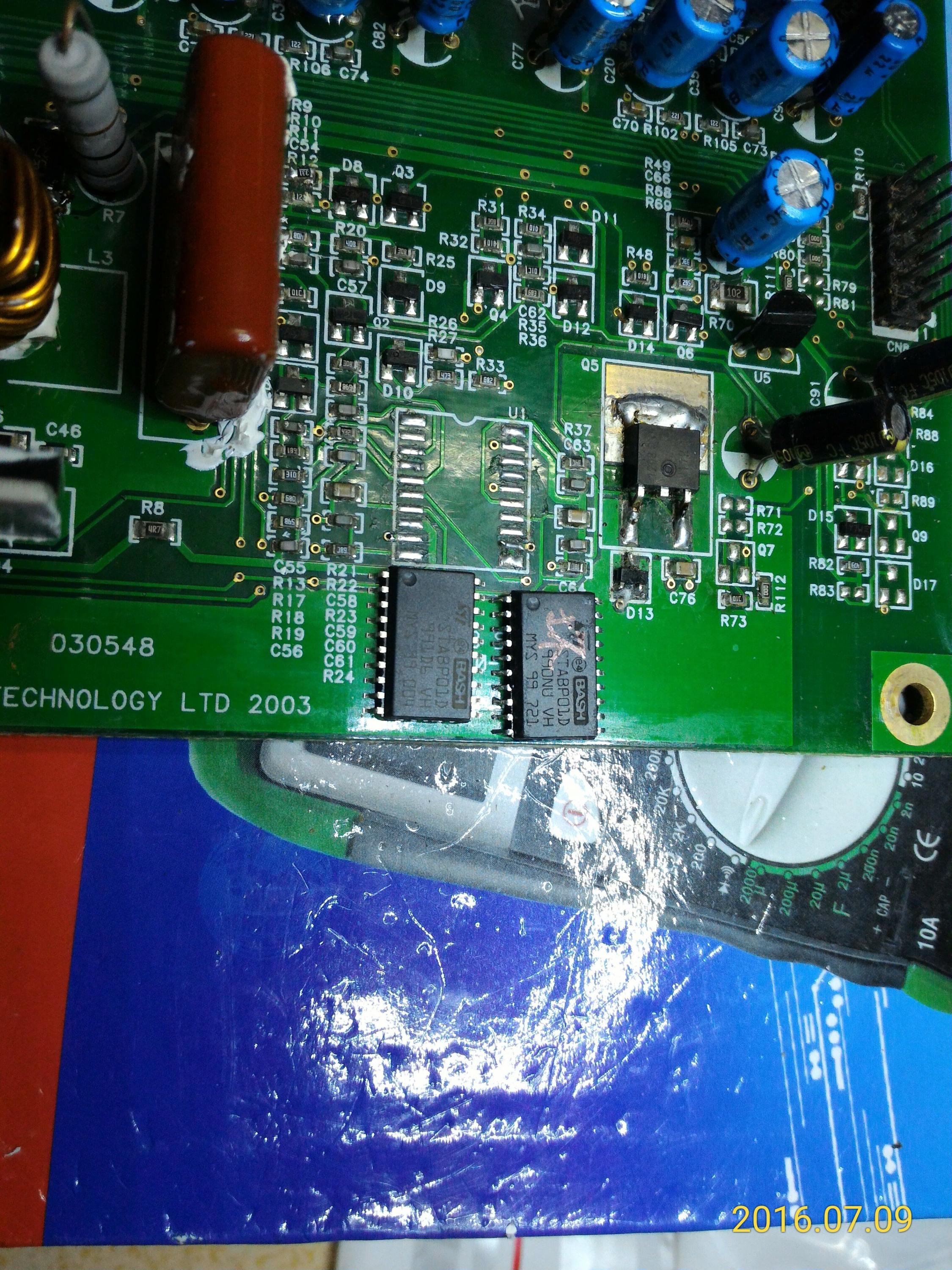

                Good news, after long time fixing (or perhaps damaging), I had fixed my speaker issue.
                Long story in short, I replaced U1 (STABP01D, the 20 pins chip) and/or Q5 (near U1).
                Two STABP01D chips, one good, one bad (right one).
                The voltage output between #8 pin (MAIN OUTPUT to Q1 gate pin) to #9 pin (GND or actually 70V-) is very low, not enough to open the gate of Q1.
                And the resistance between the two legs is around 30 ohm, which makes the multimeter beeping.
                STABP01D been replaced
                I got part of the schematic of power amplifier board from http://www.tgahinfo.homecall.co.uk/S...heets/Buck.jpg, it's only include the buck regulator.
