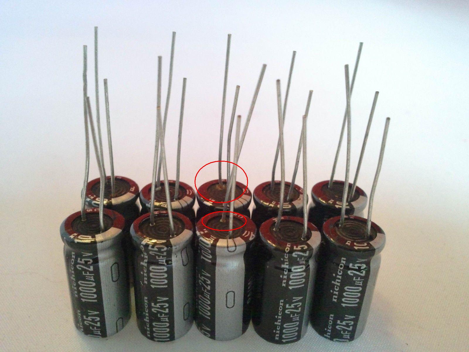

    Hello! After reading all about it here, I replaced the infamous 2 Bad Caps in my Emu 1820m soundcard, which was working okay before the cap replacement. Now it does not show ANY power signs at all. Could the new caps be the wrong kind, bad or is it my crappy ugly soldering?
    I replaced the exact two caps everyone else does with success. As seen in the picture here:
    http://productionforums.com/viewtopic.php?t=13240
    They WERE BULGING, but still working, with static. The bad caps I pulled were G-Luxon, 10Vdc 680uF, 105c, LZ. To replace them, I installed Nichicon -- 1000UF 1000mfd 25V Electrolytic Capacitor 105c.
    http://www.ebay.com/itm/271408068601...%3AMEBIDX%3AIT
    Shouldn't they work in theory? I followed ALL the advice. Everyone says it's okay to up the UF a little and volts a little, but not over 25v. Before I yank and jiggle and pray, any advice is GREATLY appreciated! Thank you very much!

    I just realized I had disabled the device in Win7 Device Manager. Once re-enabled, the lights and power are ON! Now...I presume it will work at full function. I'll post an update, but I think the 'ol replace the 2 bulging caps is once again a viable wonderful way to keep these babies, which can't be replaced for under 700.00, going for another 10 years :-) Thank you all!

        The items in the ebay listing you posted, clearly show FAKE parts. You should never, ever buy parts from ebay

          Yeah you have brought FAKE nichicons

              It looks like the ones in the picture from that seller are already leaking

                The one reliable source of genuine japanese electrolytics on eBay would be the user egekecu I had seen him recommended around here before, and i've ordered stuff 2-3 times from him in the past few years. Surprisingly fast shipping, might i add
                  Well, I looked at his ratings and he has sold thousands and still has a near 100% feedback. I figured, how could these be bad parts? They work..but...are you sure they are fakes? And what is the consequence of that do you think? Will my audio quality or recordings suffer? I had only a few dollars to spend on a gift card.
                  Somethings, are faked very well...digital watches for instance. So could it be that this kind of product is so basic or well known or machined easily to spec, that their is no real down side in this particular instance?
                  Someone said that these caps are more responsible for POWER and do not effect sound at all, compared to the other caps which are less about power and more related to sonic quality? Apparently people cheap caps here and more hi-fi in other places?
                  But, you guys are the experts! To what horrid fate have I just foolishly consigned myself?

                      Did some checking: the caps I received appear to be this exact type:
                      http://www.mouser.com/ProductDetail/...nuHpeEog%3d%3d
                      And this is an authorized dealer selling them for .67 cents each. The Ebay price is similar. What makes you so sure they are fakes? And would those obtained from the mouser site likely be authentic?

                        Yes, Mouser is fine. The rubber bungs shows they are fakes. At best, you will loose audio quality, at worst, ripple will kill other components.

                          And you should not just use any cap. Find specs of old one and match spes with a new QUALITY one.

                                I would have loved to have purchased Hi-Fi, but was limited to the modest sum on a gift card. Besides, many have said in other threads that THESE TWO CAPS do not impact sound. Other caps on this PCB are the major players for sound quality. One consensus says upgrade other caps with hi-fi, but these just need to work, nothing more or less and that they were not candidates for upgrade so get the cheapest working replacement.
                                I never cheap out on stuff like this, but in this case, I didn't have any extra to spend and, if the stuff I read was correct, buying higher quality would be money wasted, save for any longevity issues.
                                The rubber bunge is the black bottom enclosure face? That's what makes them fakes? I hope they last: without a solder sucker, the whole process was rather time consuming, with my fastest being the last: 1.3 hours. Pulling them was hard, cleaning the holes was hard, but putting them in was painless. I've become an expert at soldering safety pins into the holes trying to clean them :-)

                                    Just look them up on the Nichicon website if you are in doubt, the ones I had were green in colour and the range was not even listed on the nichicon site.a sure sign of a fake.

                                      I did :-) They have the exact same name, range and appearance as Nichicons listed on Mouser. You may be right about them being fakes. You would know better than I. I'll try to post back with how long and well these work. Thank you very much for your kind help! Love:
