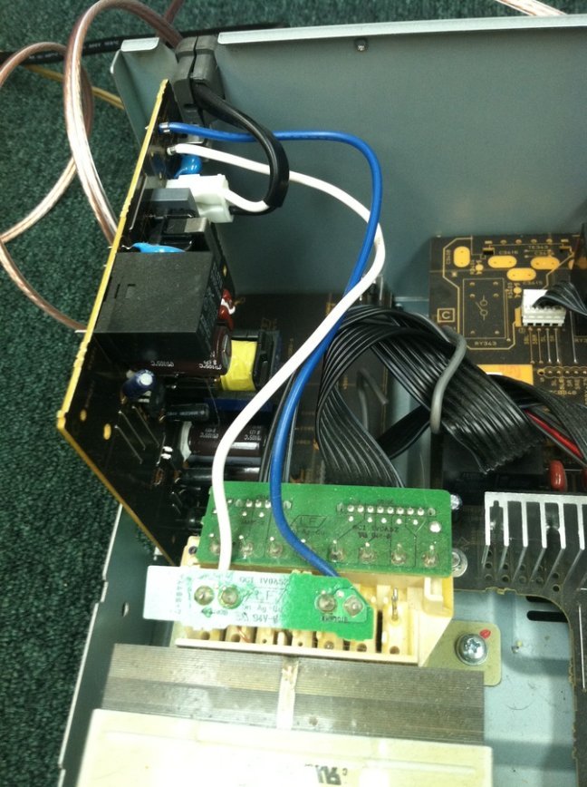

      I have exactly the same amp and issue! Read somewhere about a Thermal Fuse in the power supply but the model in the U tube video I reviewed is different they have a grey and blue wires my amp has a blue and white wire that comes from the input board to the power supply to a small board on the power supply. My question is how to bypass the original thermal fuse and install the new replacement???
        Re: Yamaha RX-V*7* series protection circuits
        The question is, is the Thermal fuse open circuit? It is wrapped under the insulation tape on the Primary winding of the transformer. So did you check resistance of the primary winding of that main power transformer?
        Did you verify that you do have MAIN AC between the White and Blue wires soldered to the PCB on the transformer?
        • honda191
          • Nov 2016
          • 12
          I did not check power I will tonight but I did check resistance and there was none between the white and blue wire at the board.
            If it shows open circuit then you do have open primary circuit, so the thermal fuse may have blown open circuit dues to fault in the transformer. You need to remove the transformer to the fuse under the wrapping.
            • honda191
              • Nov 2016
              • 12
              The small board that had the blue and white wires connected to the power supply had a bad trace. Removed the board wired directly to the leads to the supply and now I can get the amp to power up in sleep mode. I disconnected all speaker wires and tried to power up normally but shuts down.

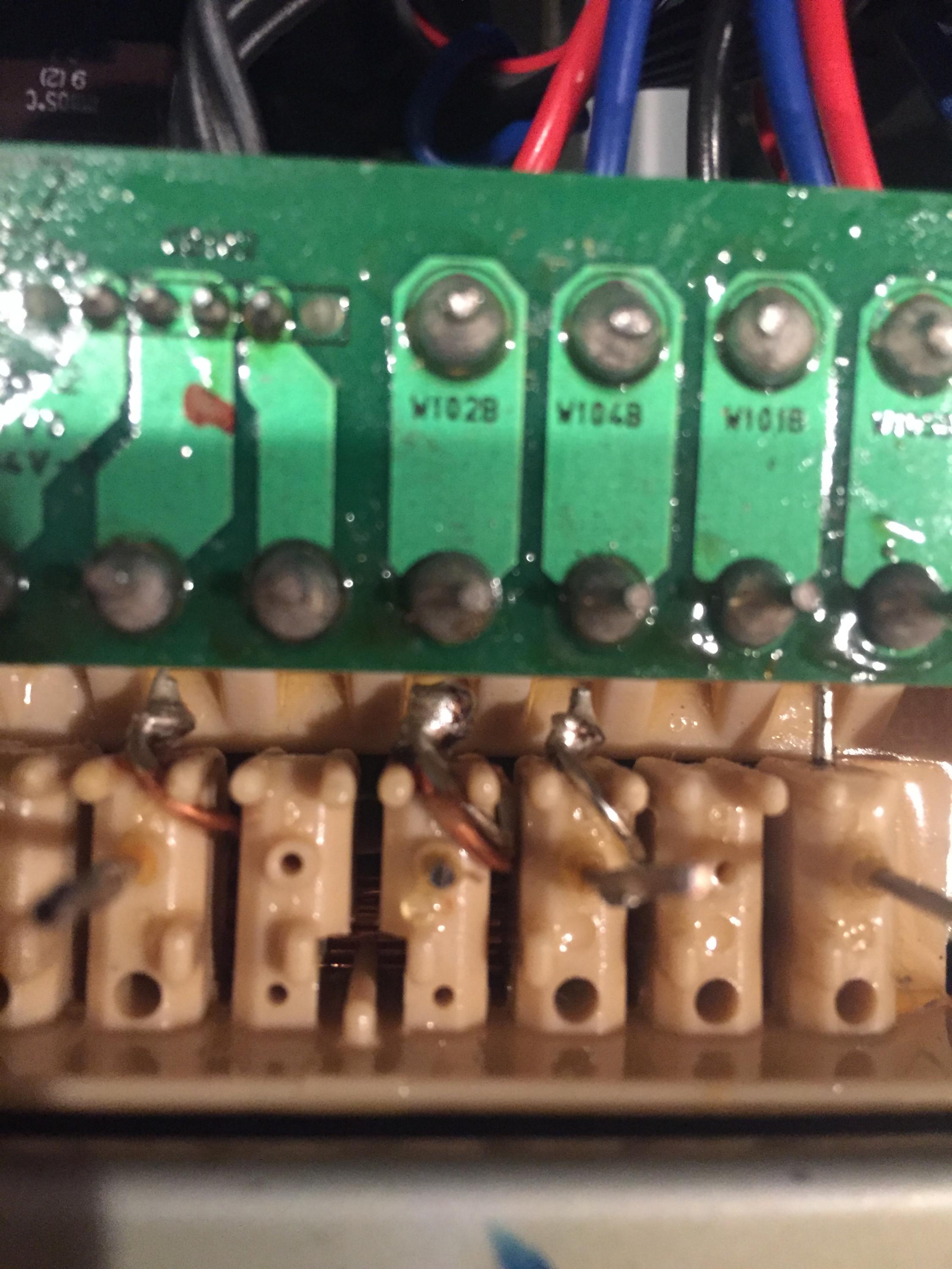

                Here is a picture of input connections on the Power Supply hoping you can see the 2 small silver wires connecting to the main is solder junction is this the connection of the Thermal Fuse?? I checked resistance and it is open. I need a little help on where to cut and re solder in the new one.
                  Can I see the whole transformer top side?
                  They usually have the thermal fuse on the primary, your pictures look like the secondary side?
                  But I though you fixed the connection on the primary side and able to get the resistance reading on the primary winding.
                  BTW, what is the full model number?
