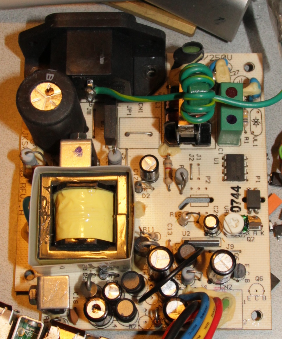

    Hey, this thing's supplied from a totally isolated winding on one of the two "secondary" transformers. Hmm... Multimeter, diode test: the rectifier schottky, forward-biased, checks out fine (0.16v, for a 2A 40v diode - seems legit); reverse-biased, not so fine - around about 1v. That can't be right.
    Unsoldered the diode, red lead on where its positive end was, black lead on the ground-lead of the associated cap - still 1v. Something's definitely fishy here...
    Just for the hell of it, i started desoldering the pins on one side of the 34063, starting with CMP, simply 'cause it was the left-most one, on the side facing me. Second pin lifted was the VCC. Measured again, 1.4v - HELLO... Lifted the next two pins as well (ISNS and DRC), measured again - voltage drop rose above 2v in less than a second, and then OL - GOTCHA!
    As a sanity-check, with the other 4 pins still untouched (including the GND pin), i measured the 4 pins i had lifted. VCC-GND shows roughly 0.96v, and ISNS-GND is around 1.4, neither of which, i'm quite certain, should be anywhere near that.

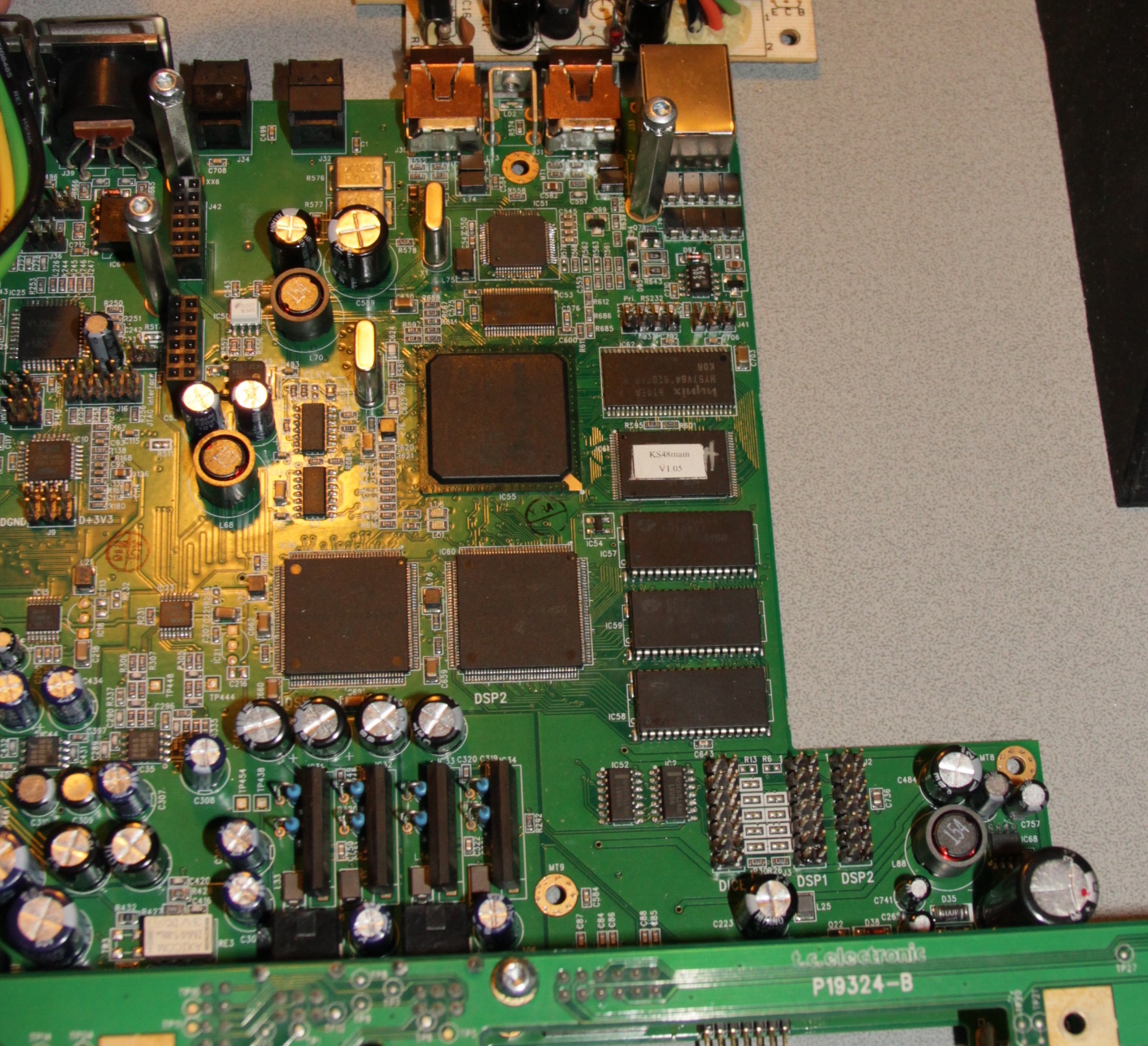

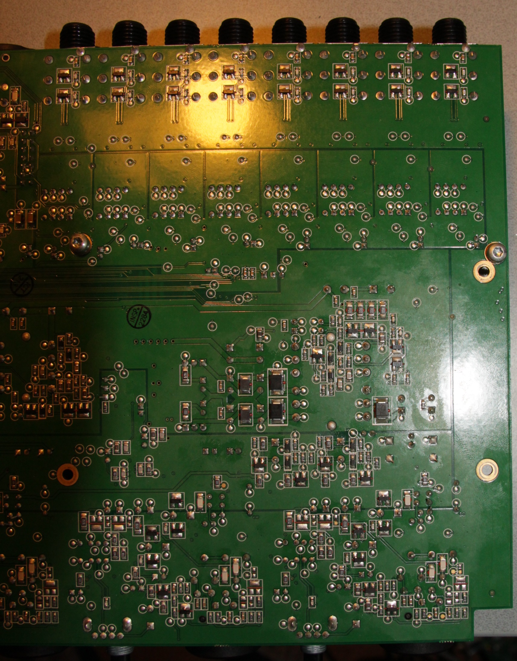

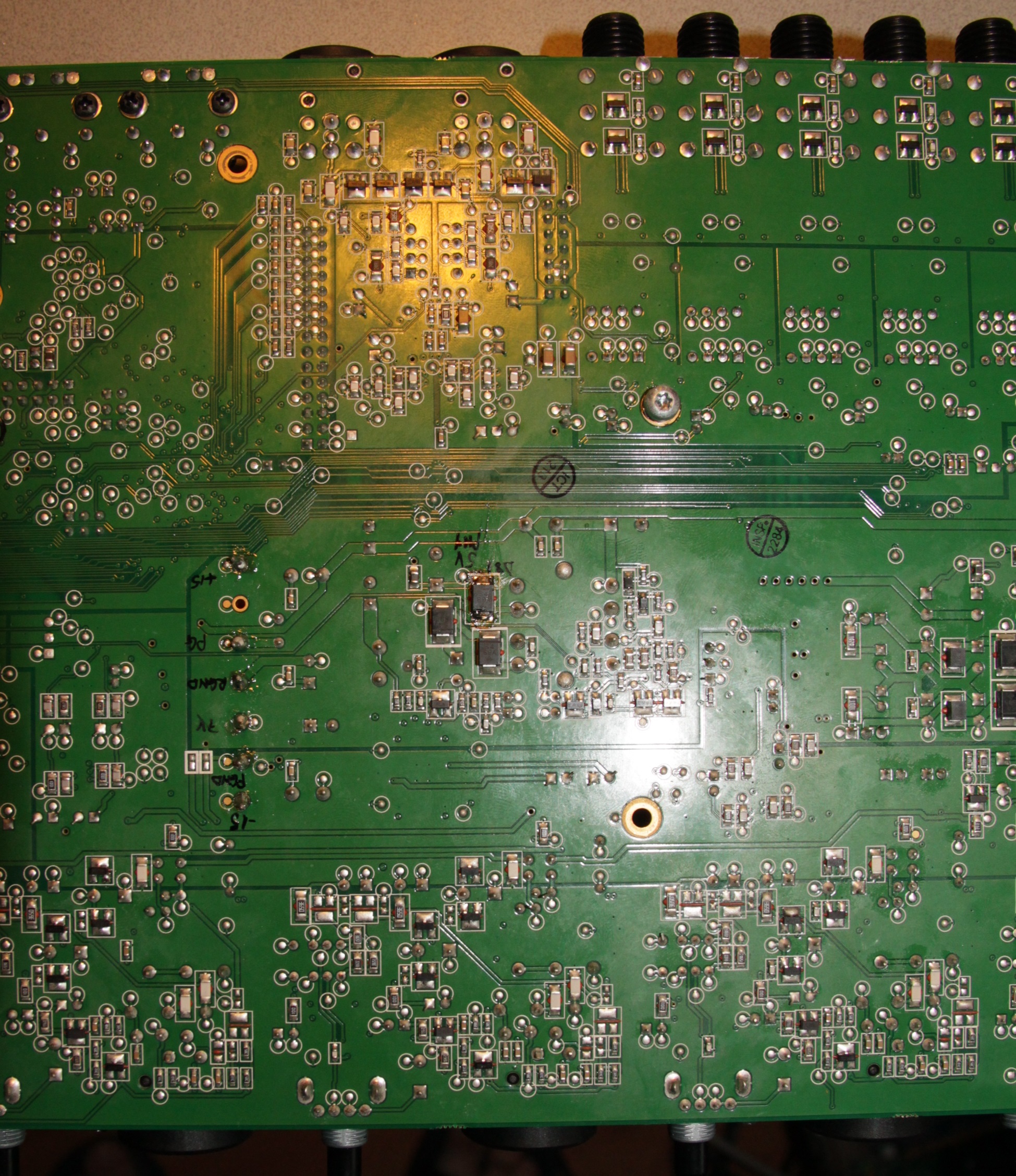

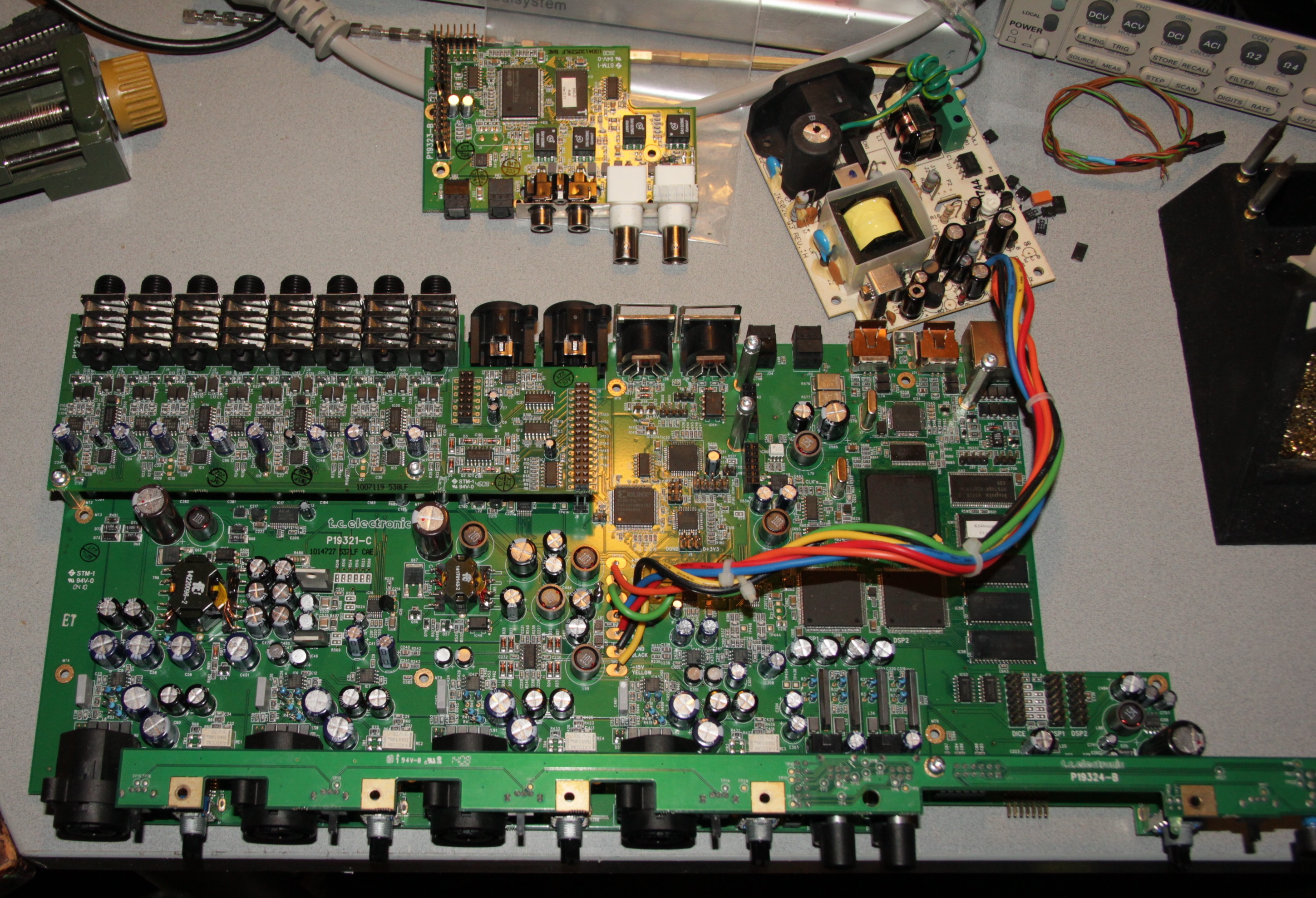

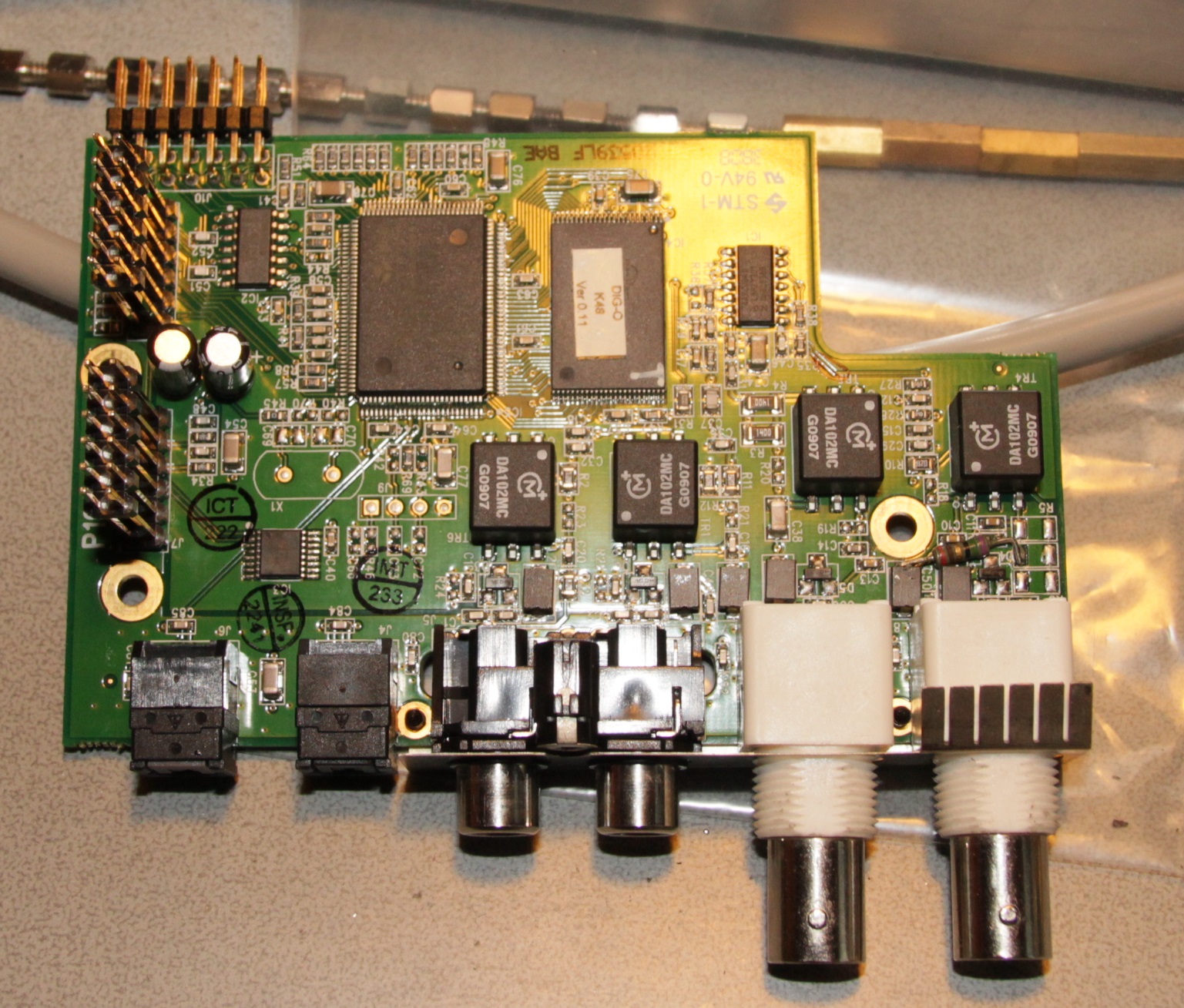

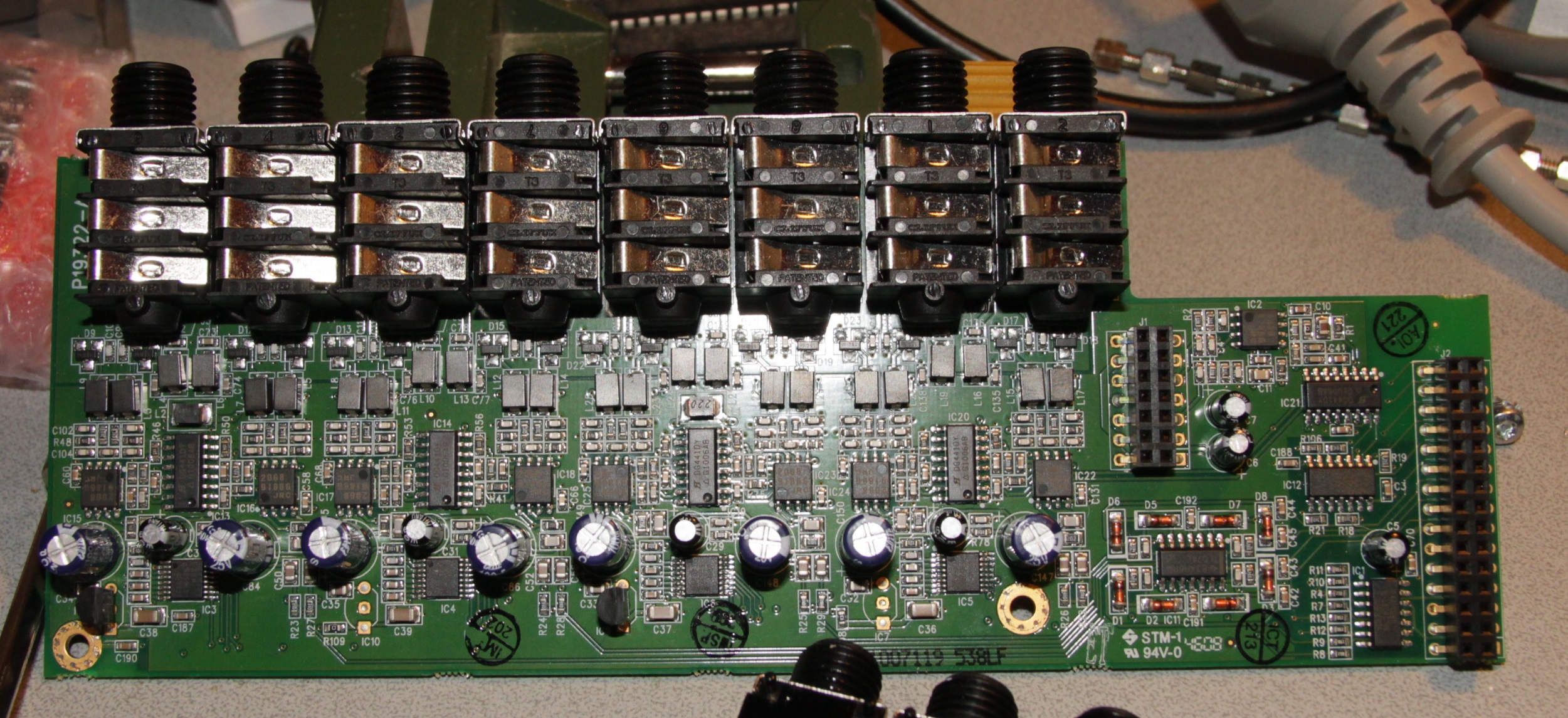

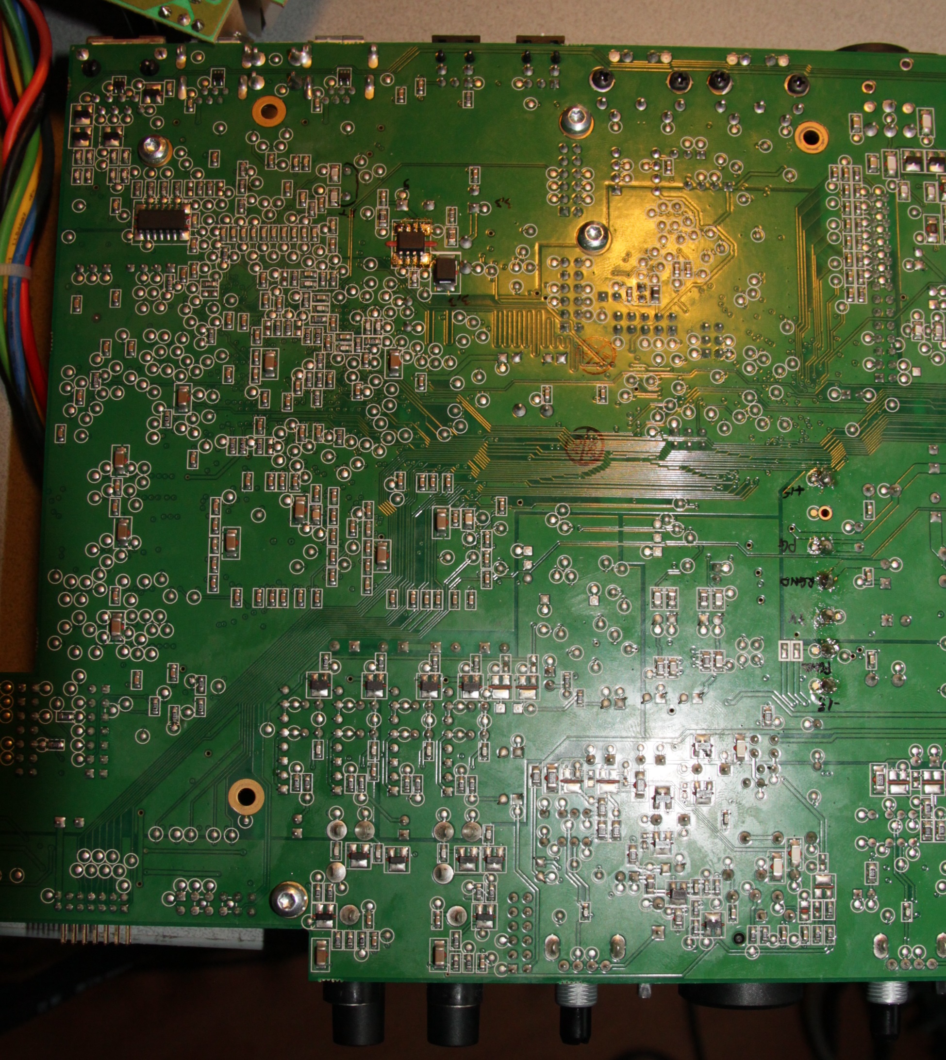

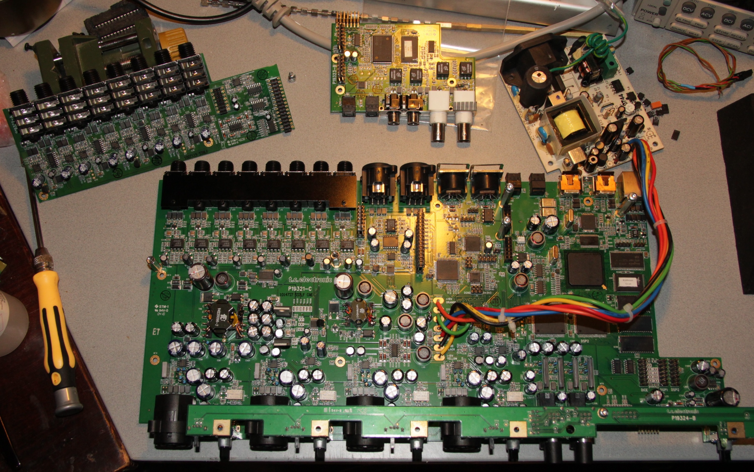

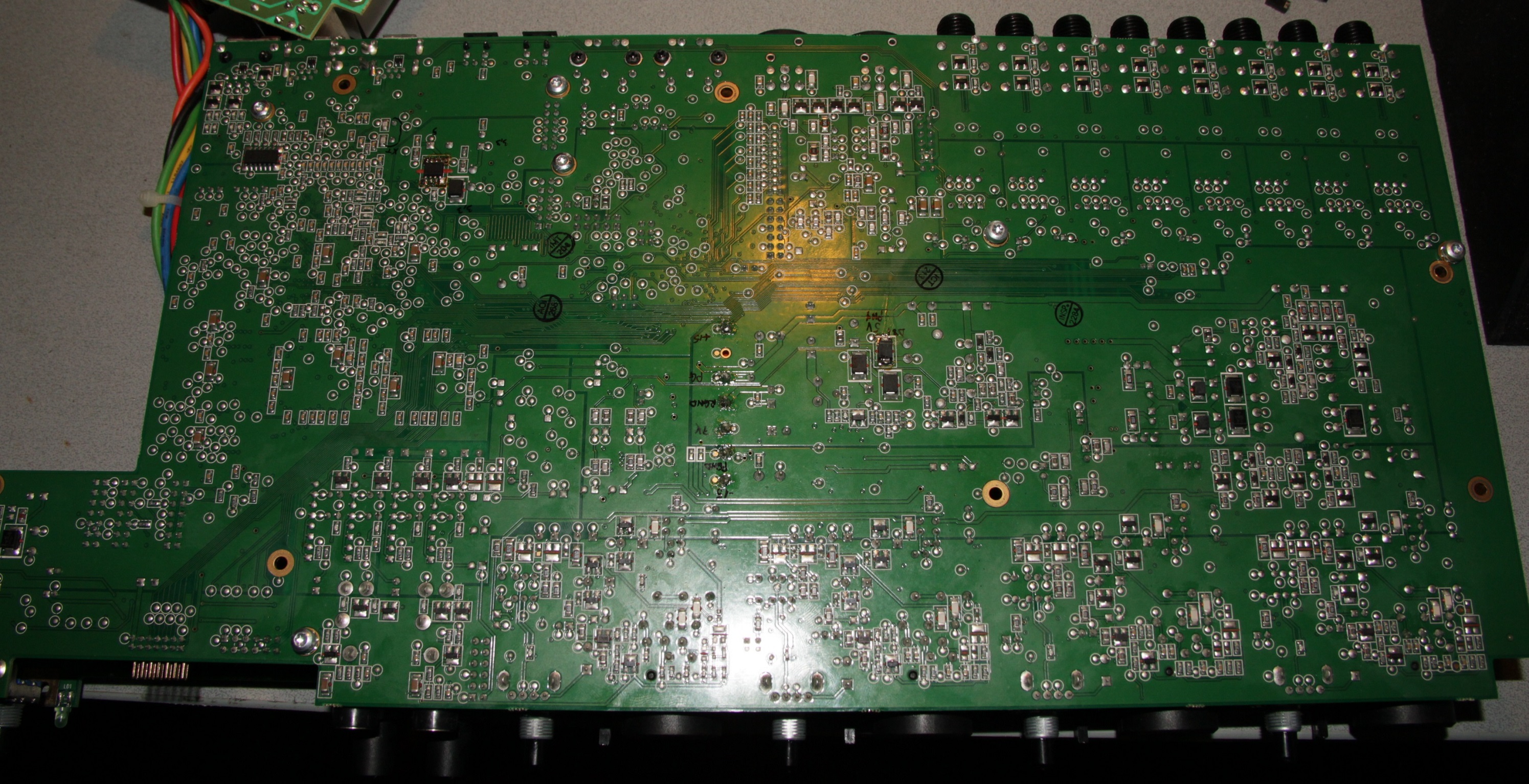

    And, as promised, "pics or it didn't happen"
    In the last two photos, you can see that small SOIC8 package in the top-left-ish area - that's the (most likely) culprit, the 34063.
    Either way, like i said - chock full of stuff, top AND bottom

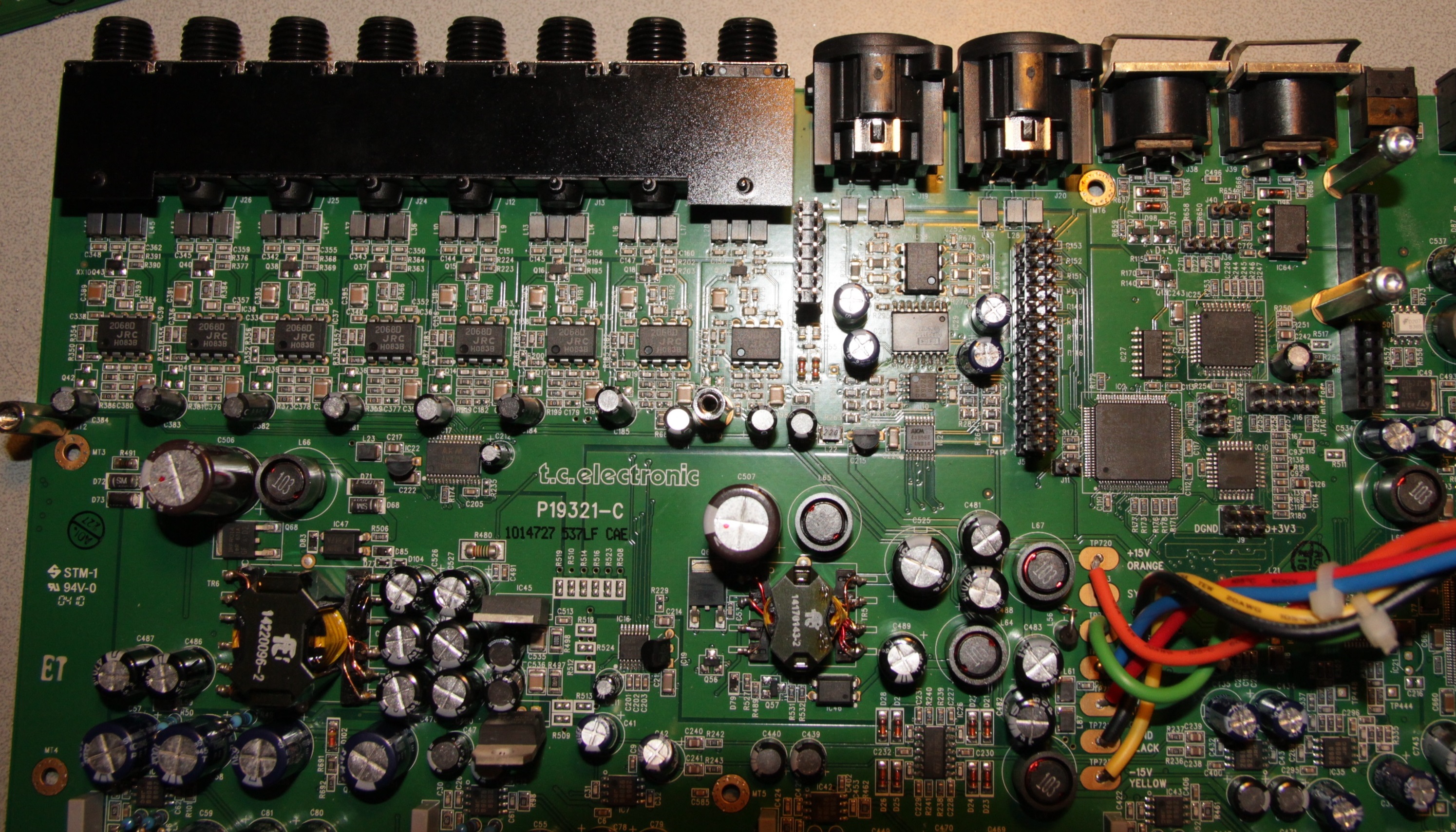

                Just for illustration purposes, here's a snapshot from inside a Mackie Onyx Satellite. On the left there's its stock TSB, as installed from the factory, and on the right, it's one of the two chips i had. The markings look nothing alike. Yeah, i know, TI may well have more than one fab, but surely they would've at least "standardized" their marking layout, i'd reckon...

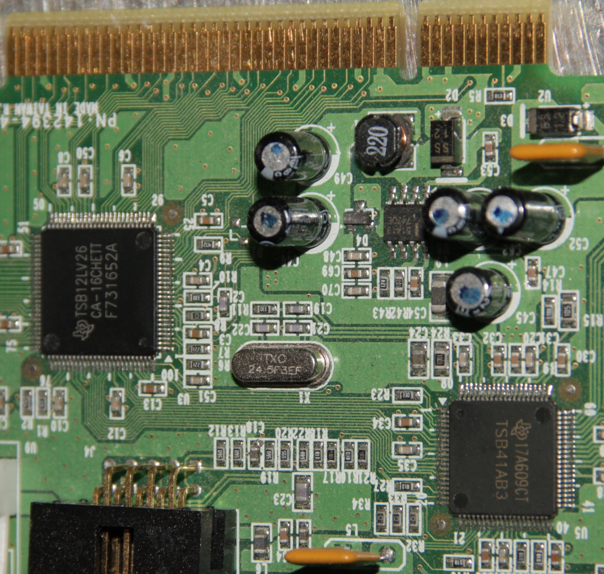

                    Does it? I got'em from a british seller on ebay.co.uk, "swle2000".
                    And for what it's worth, i've got a pci FW card (has some Compaq label on the back), and both TI chips have markings that resemble the chip on the left, which would lead me to think there are (far) greater odds of them being legit.
                    Either way, i just paid for that Farnell order, and the site said they had 124 chips in UK stock, so... Hopefully, by the weekend, or early next week, we'll see exactly what's what

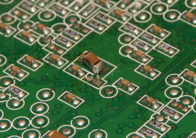

                            Step three: replace 34063 - here's where things got a bit... ehrm... "hairy", let's say.
                            Due to apparently forgetting the old adage, "haste makes waste", i proceeded to use a small flathead screwdriver to pry off the old chip, off of the strip of epoxy(?) glue that was holding it to the board. And wouldn't you know it, good ol' Mr. Murphy never sleeps - as the chip suddenly popped off the board, the screwdriver slipped and pretty much "shaved" off two ceramics from underneith the main Dice II chip - wonderful
                            An 0603 100n (one end-cap came off) and a 1206 10u. The small one wasn't a big deal, the end-cap on the ground side just popped off, and the 3v3-side pad partially came off the board, but was still attached to the trace leading to it.
                            The bigger cap was more "interesting" - ground side ok, but the 3v3 side went straight to a via right next to the pad. The pad had totally come off the board, together with about half the circumference of the via. With some patience, and the careful maneuvering of the tip of a box-cutter knife, i managed to scrape off the silkscreen and soldermask off of the part of the via pad that was still left on the board, and by some "miracle" (and a bunch of flux) managed to stick some solder onto it. Set the big cap a bit crooked compared to its original position, but the solder blob on the end reached the via and seems to hold
                            After all this, "finally" got around to sticking on the new 34063. After scraping off some of the glue still left on the board, all went smoothly. A quick TSB-less power test showed it outputting 3.24v - i can live with that, and well within the spec for the TSB (3.0v min ).

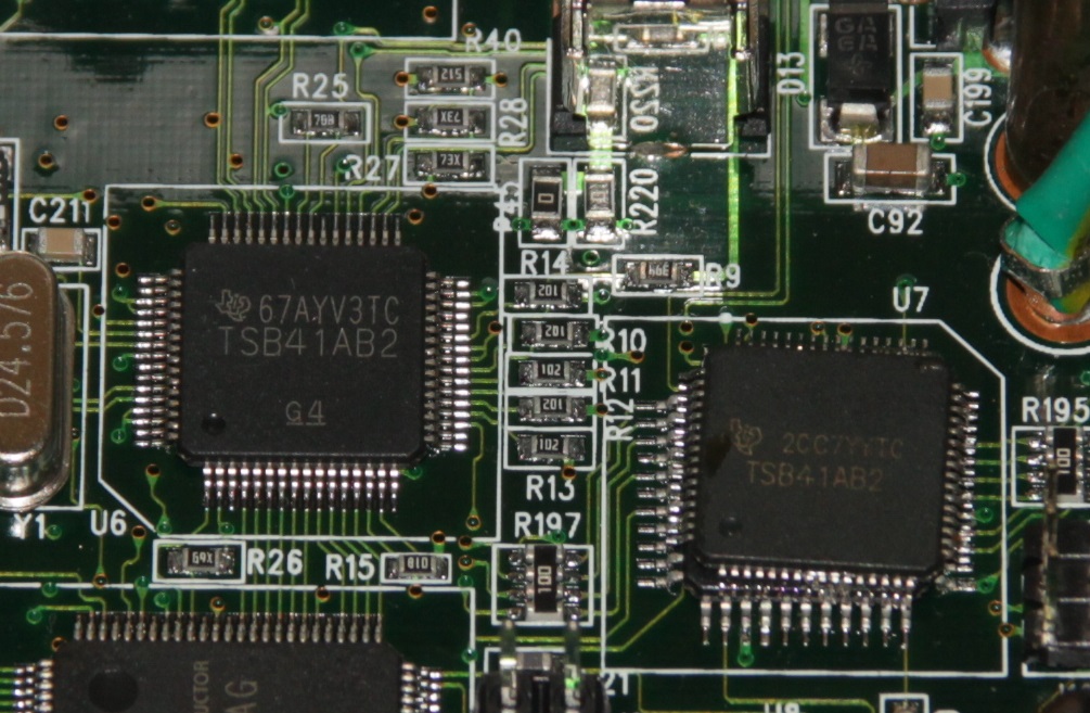

                            Step four: install fresh TSB chip
                            Stubbornly, i chose to install it just like before, "manually", with buckets of flux and a 0.3mm conical tip on the soldering iron. A few wicked-off solder-bridges later, all looked good enough for a test-run.
                            Powered on, boot logo looked fine, no firewire led at all - fair enough, i hadn't plugged the cable in yet. Powered off, stuck FW cable in, powered on - new hardware found TC Near device etc.
                            Oh yeah... Oh yeah... OH YEAH!..
                            TC Near Control Panel works fine, "feels" the master volume control (animated slider)... Happy camper over here

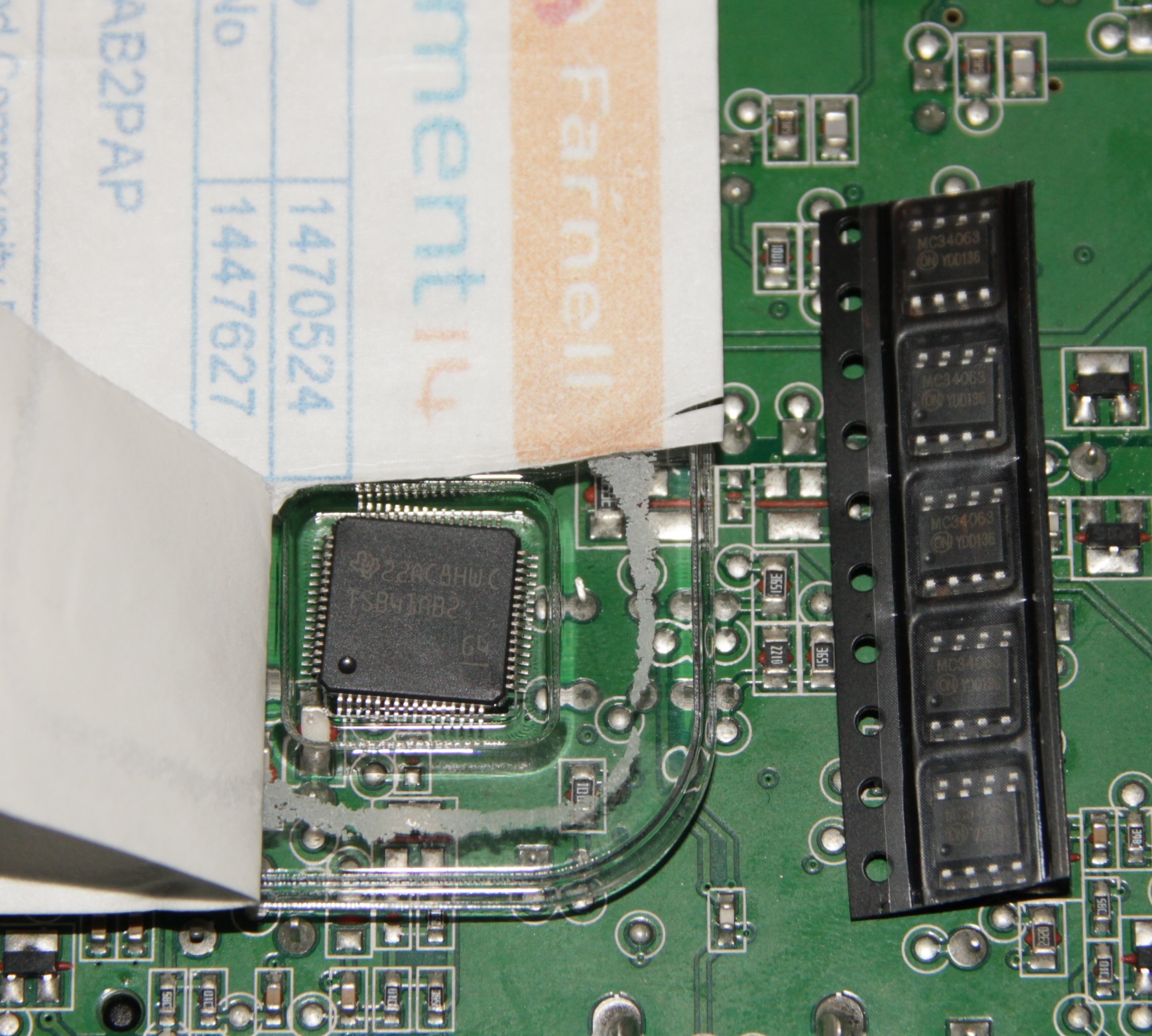

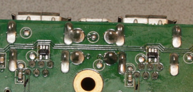

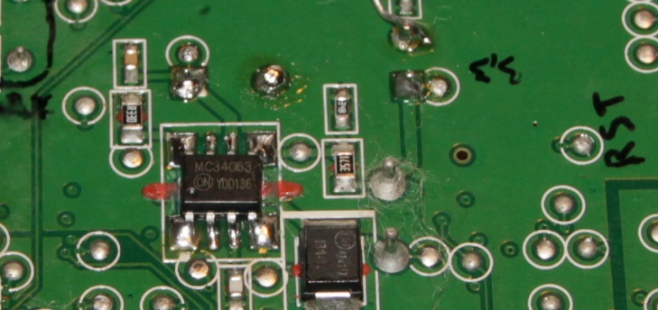

                              Photo 1: Brand new chips Note the style of the markings on the TSB chip. Font is indeed more "blocky", but the style resembles the ones on the boards "demonstrated" a few posts earlier closer than the ones on the chips from eBay, imho...
                              Photo 2: The 1206 10u ceramic after re-bodge. Note the missing pad from the near end (as described in the previous post), as well as the "funnel" of solder leading down to the via it used to be connected to, via copper.
                              Photo 3: new 34063 in its new home.
                              Photo 4: the two (former) TVS's, with legs cut off and pads wicked.
                              Before i'll reinstall the board into the case, i WILL "drown" the two "hurt" caps in some cyanoacrylate, so they won't move or anything. That is, unless cyanoacrylate is known to react unfavourably with solder or something... Opinions?
