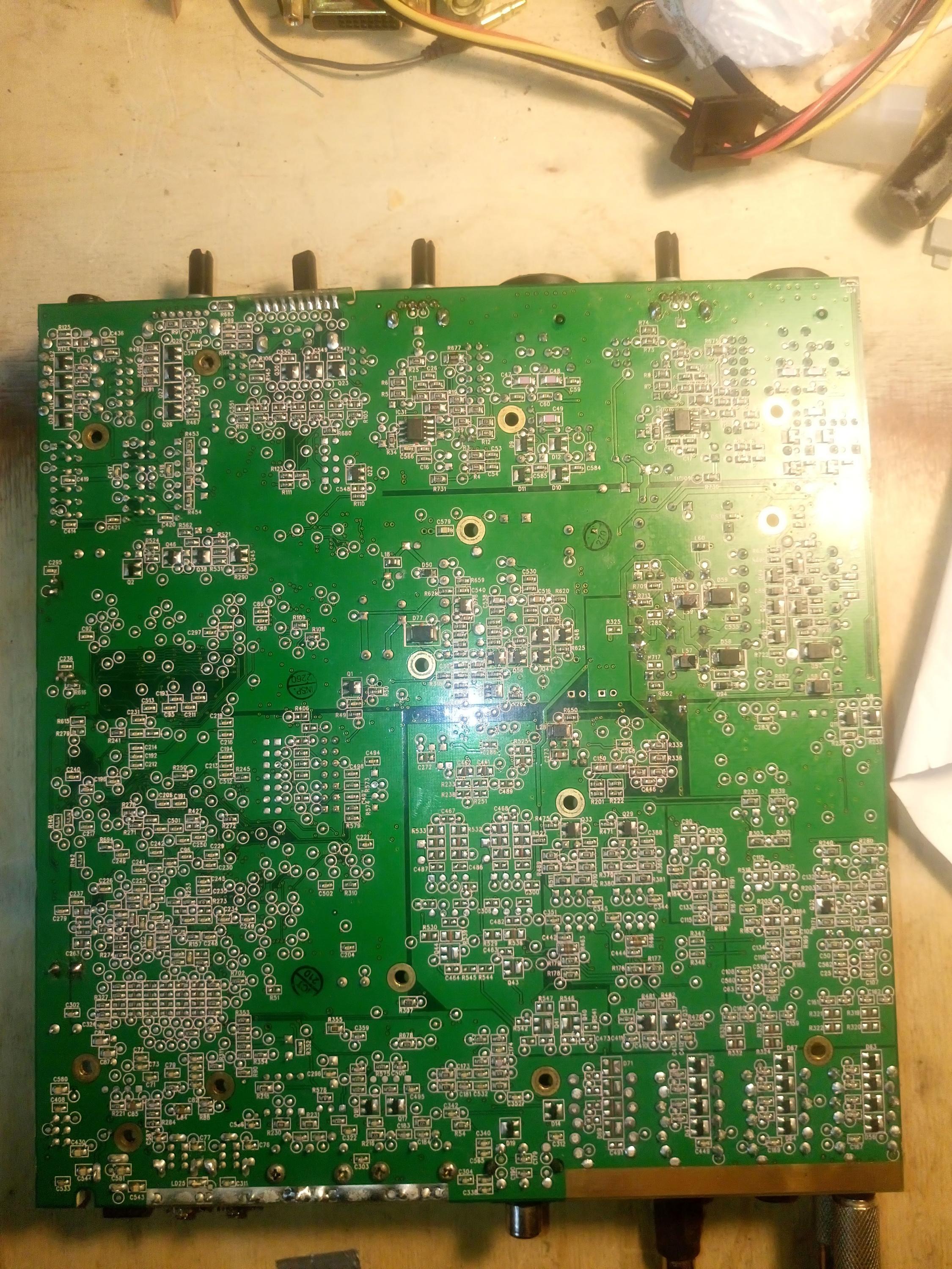

      Well, if the Dice is getting hot, and dragging down the 3.3v rail, i'm afraid the diagnosis is unfortunately pretty clear
      Originally posted by solozabal
      this is my second attempt to repair Konnekt 48. For several years now, the sound card has been out of order because I didn't have time to dedicate to the repair. And now at the time of the corona-virus there was a little more free time so I decided to try to fix it again.
      Since there is obviously a problem on my Konnekt 48 with the 3.3V rail, I tried using a power supply to insert that voltage after removing the L65 and L64, in between which the TR5 is located. The board pulled the maximum limited current from the power supply so that apparently something was shorted on that rail.
      I tested all the capacitors in the first section before the 1.8V rail and everything is fine. The only thing that heats up on the whole board when 3.3V is on, is the Dice II chip which heats up in a very short time to a very high temperature. In addition, all capacitors near the chip are short-circuited when measured using a continuity test directly on the board.
      Is there any other way to test Dice II before I declare him dead?

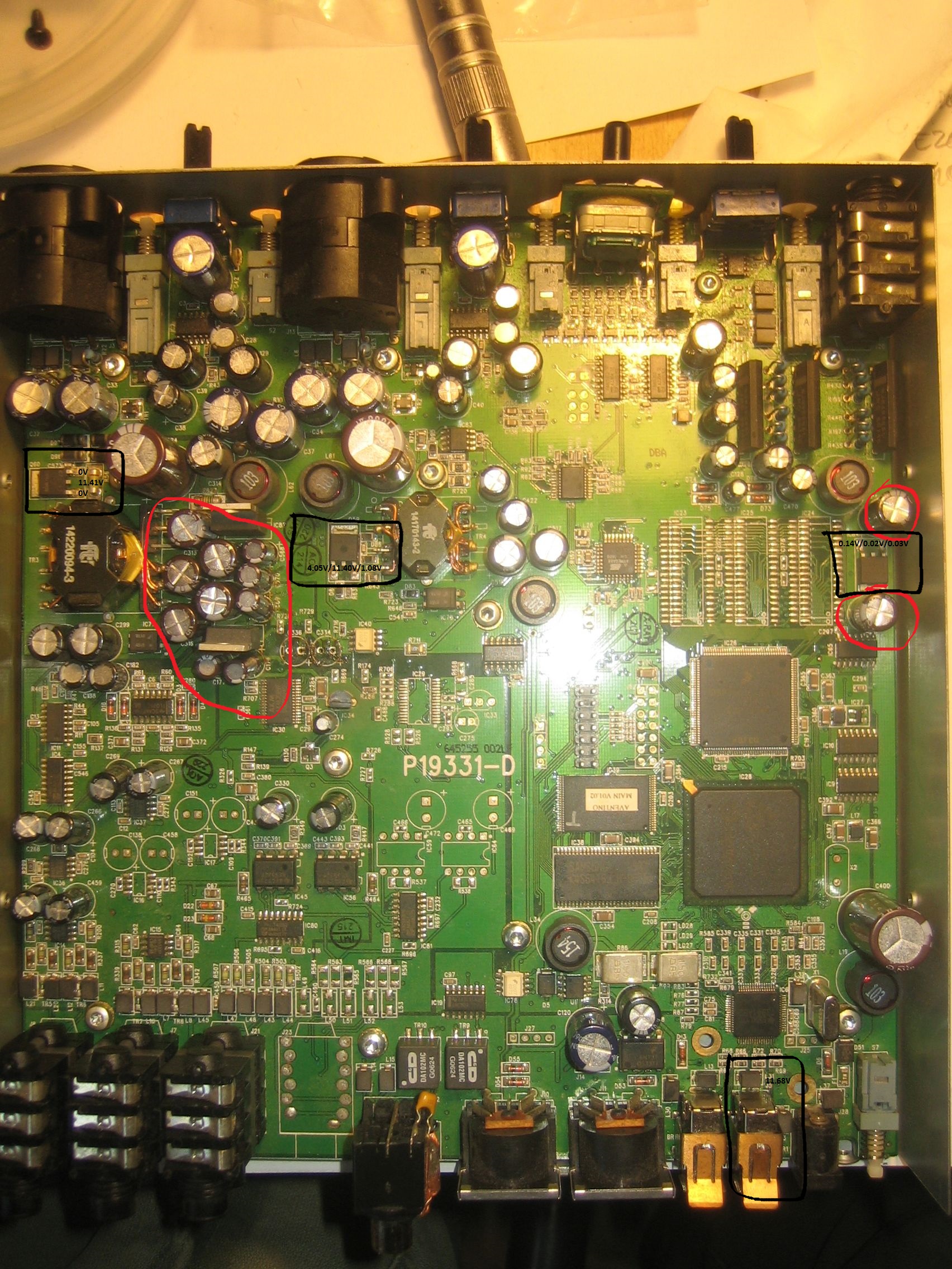

              Thanks for great topic but I'm strugling with my Konnekt 8 - have replaced all caps in +/-15V power supply, phantom one and C575/576 (marked in red), still no luck, it doesn't powers up, and there is no 12V on that +/- convertor input, altho there is no shorts or bad fuses either, LD25 near firewire connectors lights up. Where to look next?

                Going by those voltage readings on the MOSFETs, looks like the digital supply is indeed switching, but the analog one isn't. They're some sort of simple self-oscillating designs (pretty sure they're identical to the ones inside the K48, just with different component designators).
                The regulator over on the right edge of the board is the 1.8V one supplying the DICE core voltage - that seems to not be getting any input? That should be coming from the 3.3V rail - is yours functioning correctly? If anything, that's the "heart" of this design. It supplies almost all of the digital / logic circuitry, the DICE core voltage is derived from it, etc.
                As in the case of at least two other K48's that passed through my hands (which were nearly instantly revived by replacing ONE capacitor), you might want to (also) check the two capacitors on the 3.3V rail, ie. C157 & C158.

                  Then, if I understand correctly, there is only 3.3V and 1.8V supplies for digital and no 5V? And center one is 3.3 right? Because it seems that for K48 there is different silkprint on board than on K8/K24 as I can't find those C157 & C158 on mine.
                  Edit: replaced those near Q59 - C517, C518, C422, C425 but still nothing, I suspect that most likely I damaged some hole metallization trying to unsolder old ones as that was very hard even with temperature boost on my crappy chinese station.

                    Whoops, slight typo / brainfart, i looked at the designators upside down - i meant C517 and C518.
