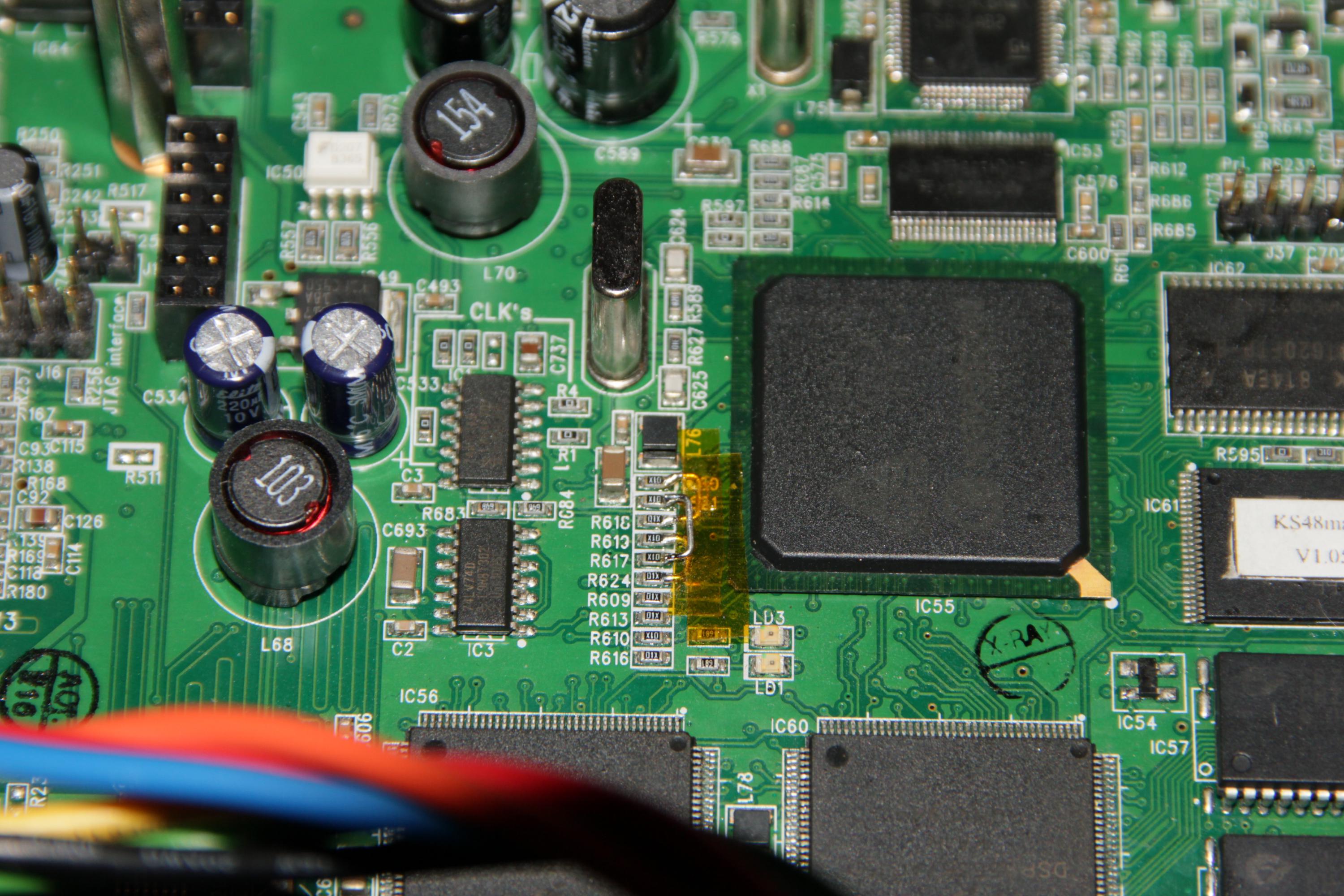

        Well, i "finally" swapped my Saffire out for the Konnekt last night, after the bodg... *ahem* repair, fiddled with the bass management, but... No sound out of my subwoofer, despite the meters in its control panel being active, and the sub being fine.
        Today, took the case off again, and went straight for the clocks for the 8ch DAC that handles line outputs 5-12, and wouldn't you know it... MCLK and BCLK missing >_<
        Resistance to ground for those signals, on the chip side, about 2.7 and 1.2 ohms, respectively. Scrape / cut / kapton / resistor-leg time again...

          Nothing a few bodge-wires can't fix...
          Lowest / "bottom layer" one was the LRCK from last night; the other two are the MCLK and the BCLK
          After this, i re-scoped ALL the clock signals going to ALL the converters - all fine, and what one would expect

            The "bodge-wires" look pretty good, much better than I can do.

                      Hi all, i see there are specialists of the SK48 here! Would you accept to help me with my dead interface? It does not boot :-(
                      The main power supply seems to works fine (+14v, -14v, +7v OK) but i noticed a problem on the 3,3v: it shows 1,6v (but sometimes increases slowly few minutes after powering the board, up to 3,2v but no boot).
                      1,8v is provided using the 3,3v via a 1117-18 regulator (witch works well, tested)
                      I tested the board using external 3,3v power supply (800mAh required) and it started correctly and i could connect it to my computer without toubles.
                      I looked carefully at the motherboard and the shematics, but i am not able to find how is this 3,3v provided? I found no 3,3v regulator.
                      Thanks!

                        The 3.3v rail comes straight out of one of the transformers, it's the regulated rail (where the feedback is taken from).
                        A few months after reviving this one, i grabbed another faulty one off ebay, and the exact and only issue it had was a crapped-out main filter cap, precisely on the 3.3v rail. Stuck a 1000u/6.3v Rubycon YXG in there, and she started right up
                        You'll want to look on page 20 in the service manual, right at the top edge - it's VERY likely C489 kicked the bucket (crappy Hitano :puke: ).

                          I changed both C489 and C488, and it works!! Thank you very much Khron!! Now i feel a bit stupid, it was easy...^^

                                Today i had time to spend on my second faulty SK48.
                                I checked the 3,3v rail again, but this time i set my multimeter before starting the board.
                                And guess what?^^ 1,7v during the first few second, then 3,29v!
                                I changed C489 and C488 and here we go, "TC" logo
                                I guess the 3,3v was too long to come and it prevented the board from booting normally. Or maybe the faulty capacitors were draining too much current to the GND.
                                It was quite vicious because only few seconds after powering the board the 3,3v rail was looking good...
                                I cant believe this fu...ing caps were faulty on this second SK48 as well. They had no visual marks of swelling, they just looked as new!
                                Everything works great now, i am sooo happy!

                                    Finally I found someone on internet with same problem... My SK48 don't won't to boot up, no TC logo, and no fw connection.
                                    I had problems with TC from the start when I bought it, for example, problem with first time booting, but it would always boot correctly after second boot, so I did not bother...
                                    Current status is that it won't boot properly, maybe after 10-15 tries, than after 20min it lose fw connection.
                                    So I decided to opened it and found out that this guy C489 is hot like hell... so I put another one 1000u 10V from some old MB.
                                    Turn on, nothing..., than second time, it boot up with TC logo, connect to fw but for not long.. it loses connection after few seconds. So current situation;
                                    power supply is ok I suppose?! +14V -14.5V +8.5V and +2.6V, and when it's turned off everything is same just no voltage on green wire (+2.6V).
                                    Any ideas what will be my next step, maybe C488, I don't know..

                                      ..tested voltage on C489 and C488, it's 2,7v, needs to be 3,3.. is that problem or Im just focusing on wrong thing?
                                      Q1 with heat sink on power supply board near 220V input is so hot, I can't even touch it, is this normal?
                                      What bother me most is that when it boots up properly (1:30 times) it WORKS, and than after half an hour of playing music lose FW connection without any reason...

                                        You are right, you should get 3,3V here. Replace both C488 and C489.

                                          The whole unit works quite warm (if not even hot), under normal circumstances.
                                          But yes, if you're getting anything less than around 3.2v on the 3.3v rail, THAT is where you should focus your attention. That supplies ALL the digital chips, so if that's not right, "of course" it won't boot or anything
                                          PS: In switchmode power supplies, NOT any random caps will work - especially some unknown ones from old mainboards. HINT: look at the photos on the main www.badcaps.net page Yep, you guessed it, old mainboards...
                                          EDIT: On second thought, i just checked, and the green wire is "just" the "power good" from the mains-powered power supply. It's a bit low, but... Well, as a first step, just make sure the "main" 3.3v rail (which is on the SECONDARY of transformer TR5) is ok. You should be able to easily measure that on pin 1 of IC46 (optocoupler, square pad, white dot next to it), right next to TR5.
