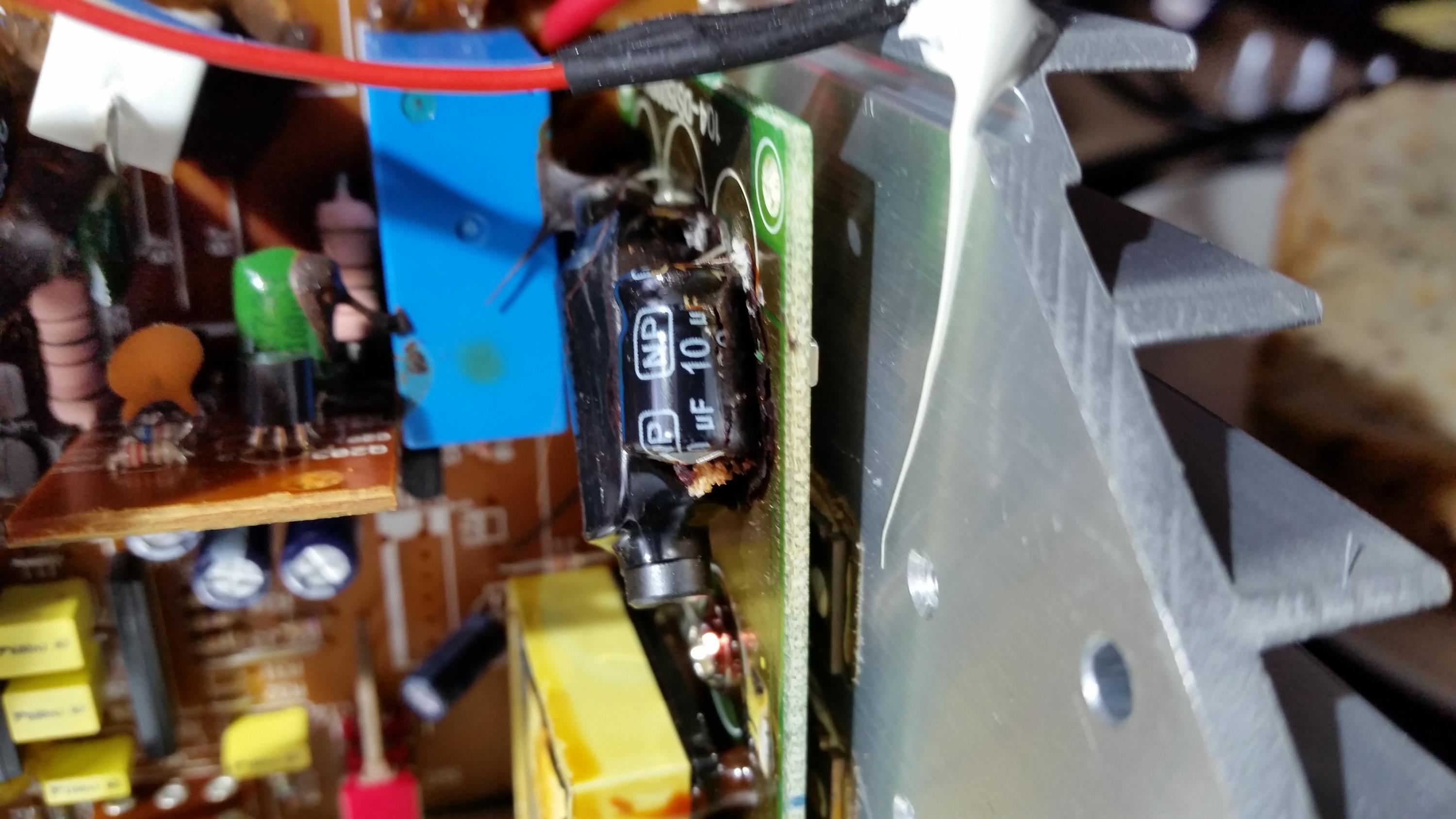

    Got given the above because it "works sometimes and not others".
    Connected it up and it works for a short period then sound breaks up even at low volume.
    Opening it up I see lots of brown glue that has gone off and two 10uf 100v bipolar electrolytic caps that have bulged and leaked.
    Removing the caps was relatively easy after unscrewing the large aluminium heatsink - refitting looks as though it will be difficult given the proximity of the blue filter cap. surprisingly 10uf NP caps are difficult to find in the UK, HiFi collective turned out to be the most affordable even with the £4 postage for the two caps!
    Will post back results when they arrive and are fitted.

    very impressive, someone did their homework! but did you check for bad solder joints aswell?

      Let me guess - those 10uF NP caps are part of the output filter in a Class-D amp? Can't see much point for the huge coils over there otherwise.

        It does appear to be a digital amplifier and the caps have arrived and been fitted - but in the process the 2sc1845 screwed to the heatsink and attached to the circuit board by an 8 inch flying lead lost it's legs so waiting for a replacement for that ;-(

        I examined as much of the board as possible for bad joints and found none.

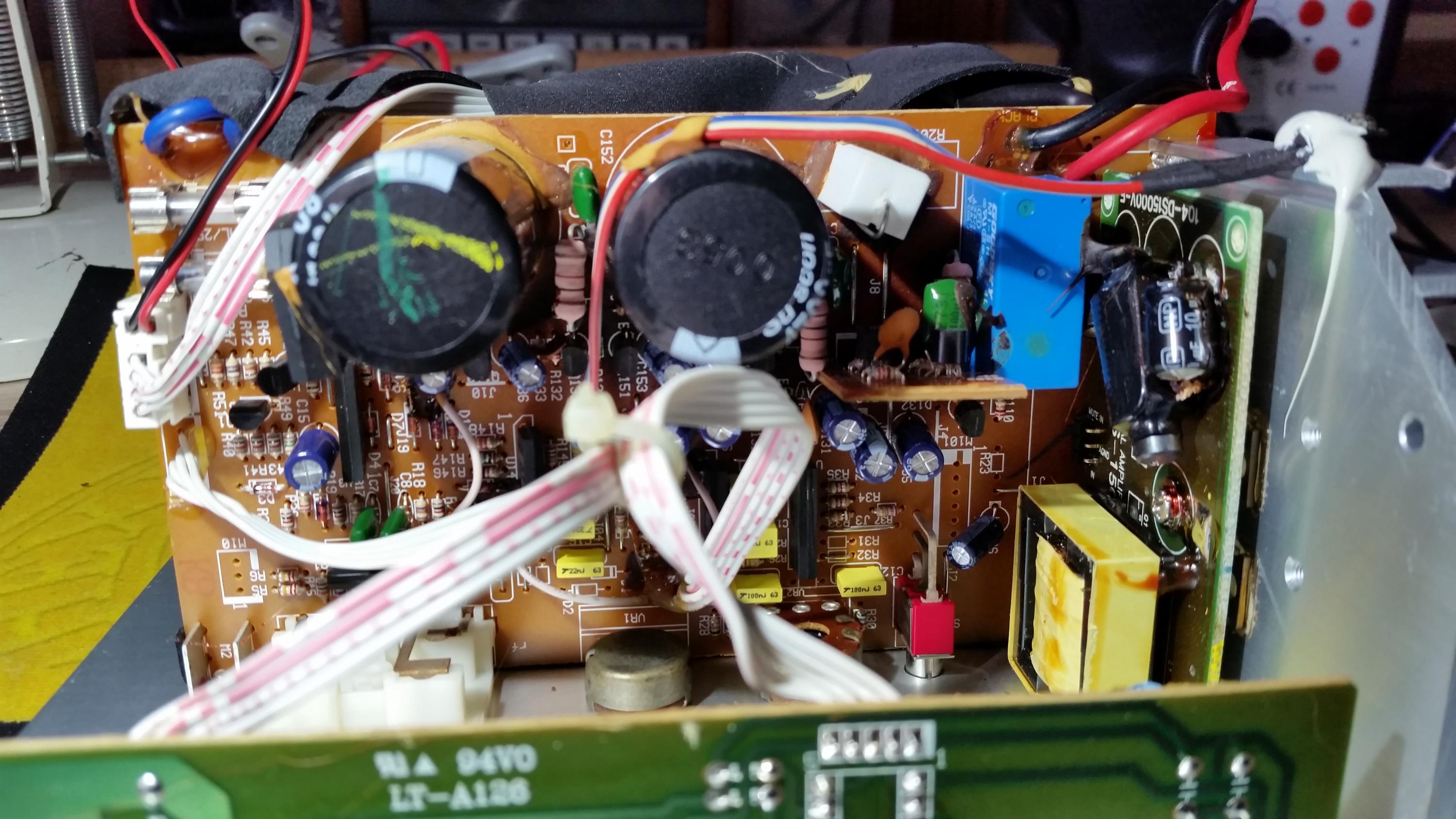

          Got the replacement 2sc1815 and fitted it. re-assembled sub and it works - for about 2 minutes then back to what it was doing before:-(
          Any ideas?

            Going to try some new output transistors pick em up from rs on Tuesday.
            Seen other reports of the two caps already replaced being associated with damaged output transistors.

              Output transistors replaced - still doesn't work.
              Measured voltage on large filter caps as +62 and -62v - stuck now.
