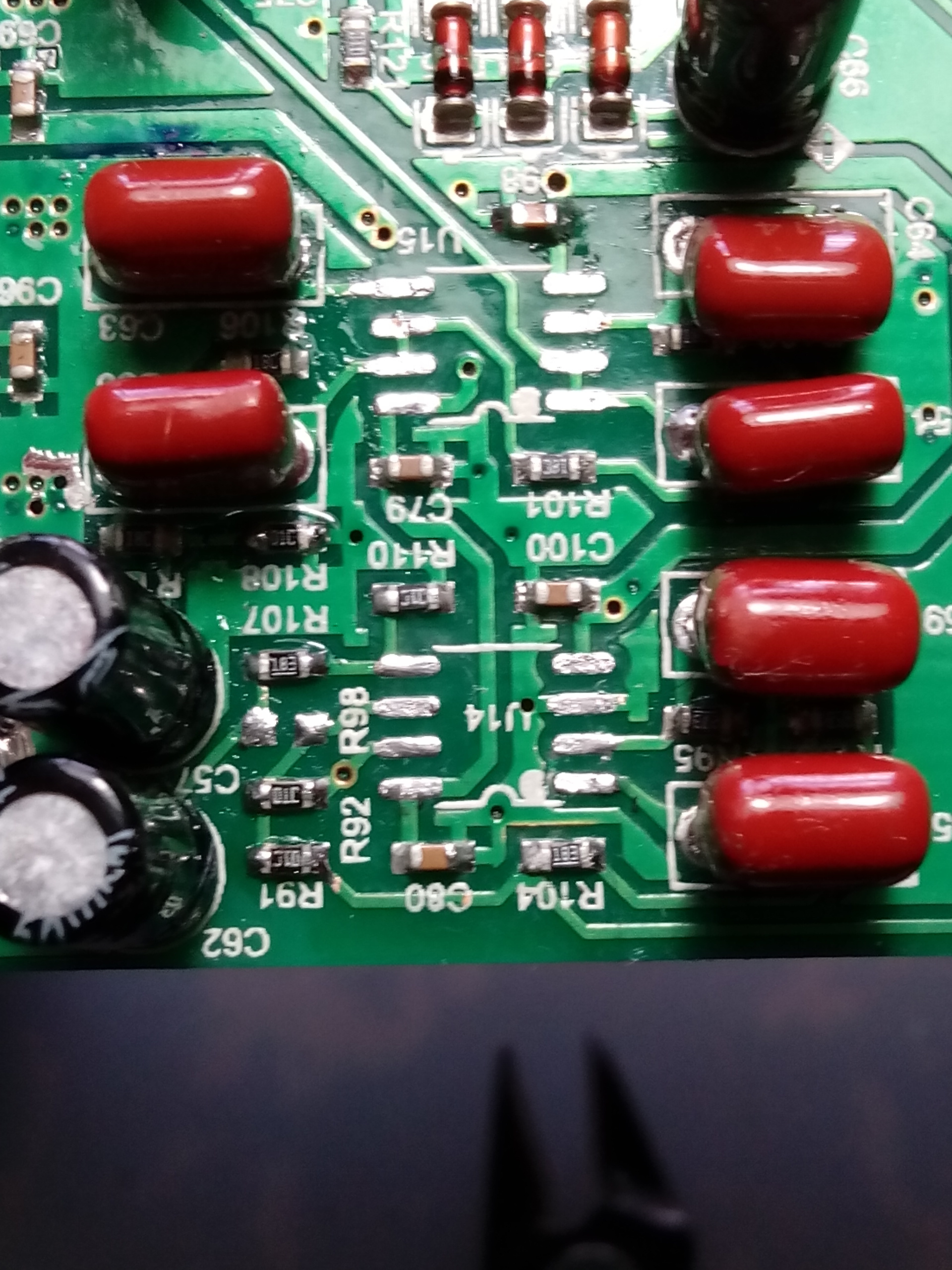

    Hello Everyone.
    The issue with this audio device was a very low bass level ; tracking the bass signal path on the preamp module i discovered a missing component (resistor R98) on the inverting input of op. amp U14 (allegedly active low pass filter) (see picture).
    I put a 1k resistor but now R/L passive speakers sound level is too low compared with bass level ; i guess resistor value is wrong
    Can someone tells me what's the correct value of R98 on preamp pcb
    or
    can someone provide me with schematics / service manual
    pierre
