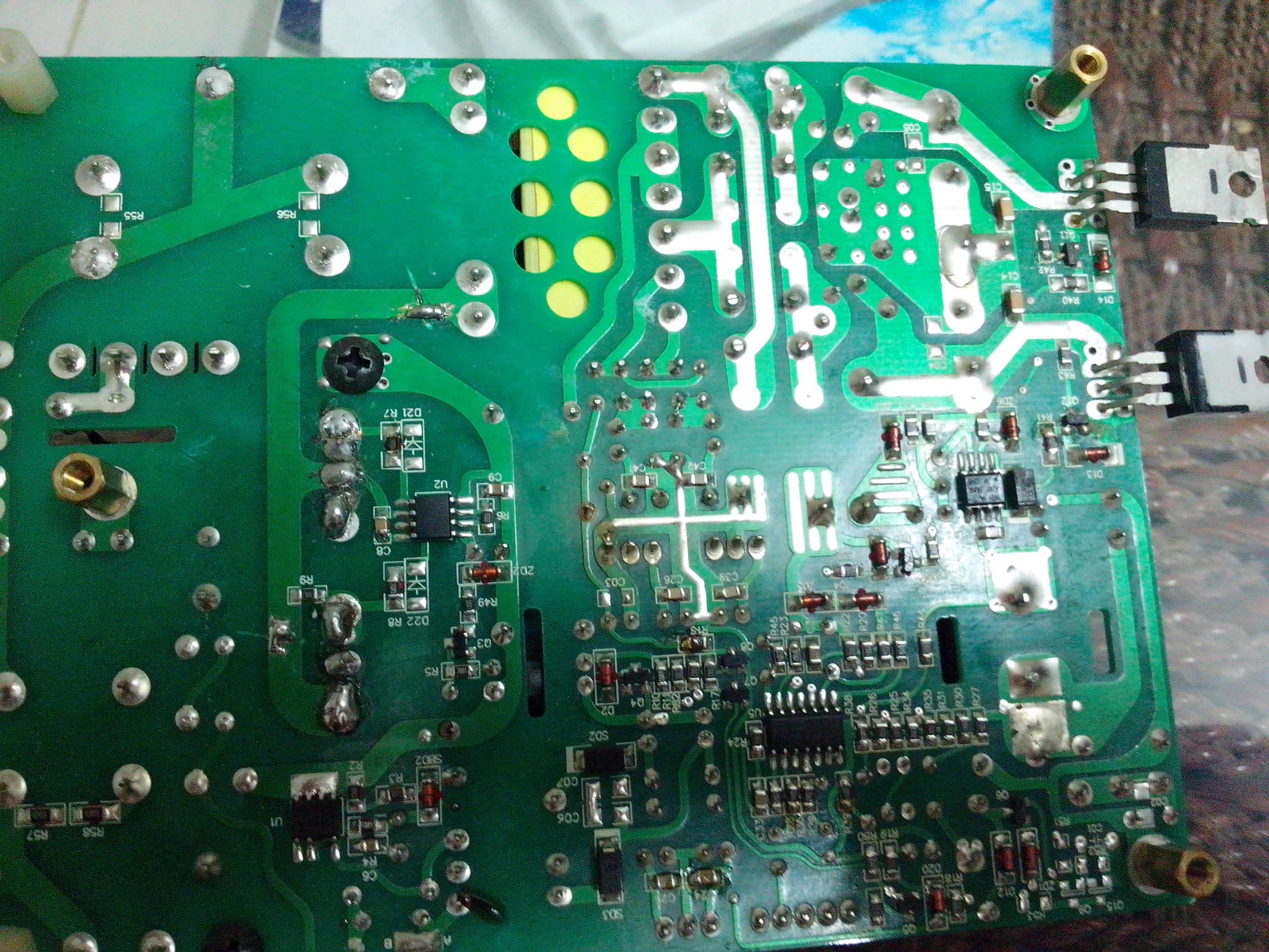

    Good morning Dear,
    Finally after a long time I have removed glues from the PCB, but still having same problem, is it possible to replace PWM IC?
    Kind Regards,
    Nissam.
      Re: Jamo A-101 Sub Amp
      So can you read the P/N as printed for that Gate driver IC U2?
        There is no number..
          Don't you just love it when they do that?
          If you can draw up a schematic of what pins of the IC connect to what, maybe someone can figure out what it might be. They're probably using a fairly well-known part.

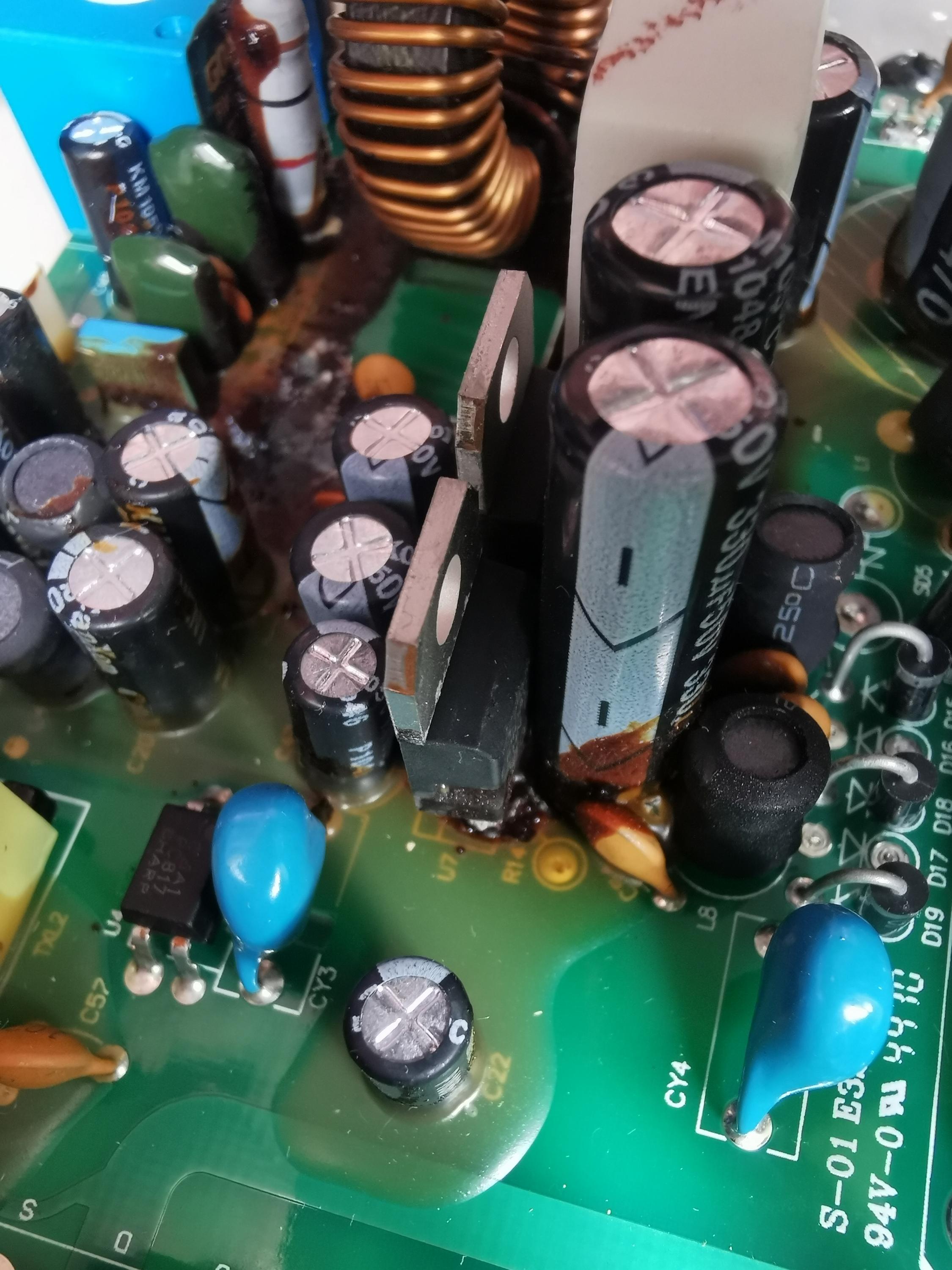

            Originally posted by japlytic
            I have handled a Jamo SUB250 unit and it has a variation of an "old school" computer power supply circuit (self oscillating) - the A-101 should be of the same variant mentioned thereof.
            I just opened up a Jamo SUB250 also. I can confirm that the SMPS really is a self oscillating half bridge using a pair of IRF730 MOSFETs which were shorted.
            I sent Jamo a message via their Facebook page expressing my annoyance that their products are failing prematurely because of the yellow glue.
              Originally posted by nissam72
              Good morning Dear,
              Kind Regards,
              Nissam.
              U2 looks like it has built in high/low side drive. It might be a type of control IC that is normally found in something like the inverter in a CCFL lamp.

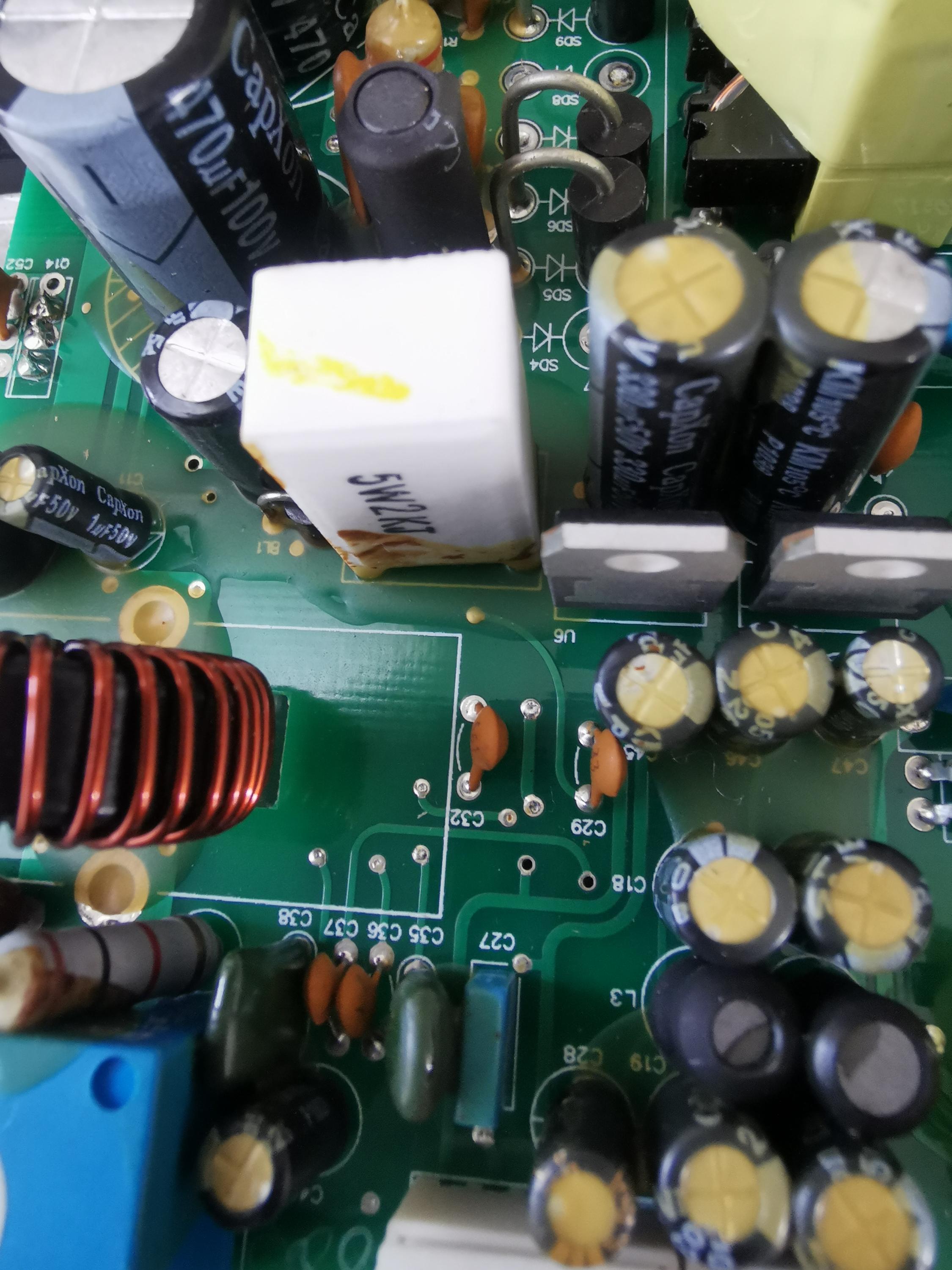

                    I have a jamo a101 sub that stopped working.i need to know the MOSFETs details in frond of the 100V 470 uf cap side
                      What is the P/N as printed on the body?

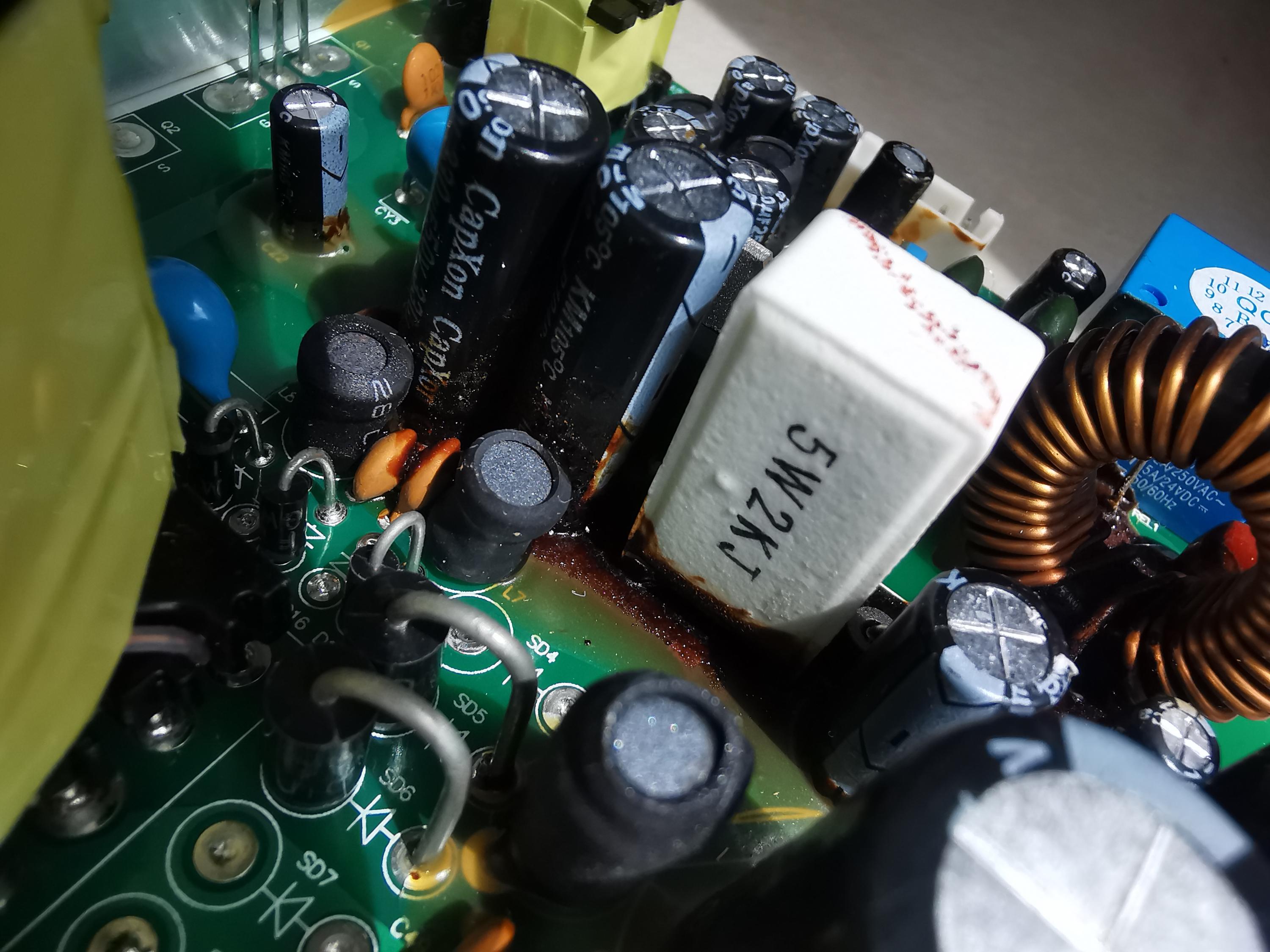

                            Bonjour,
                            Je suis dans le cas #2 ou les traces de coulures sont sur ma pcb. Il y a des traces de surchauffe au niveau des transistors, comme sur la photo.
                            Est-il possible d'avoir les valeurs des condensateurs et des transistors concernés ?

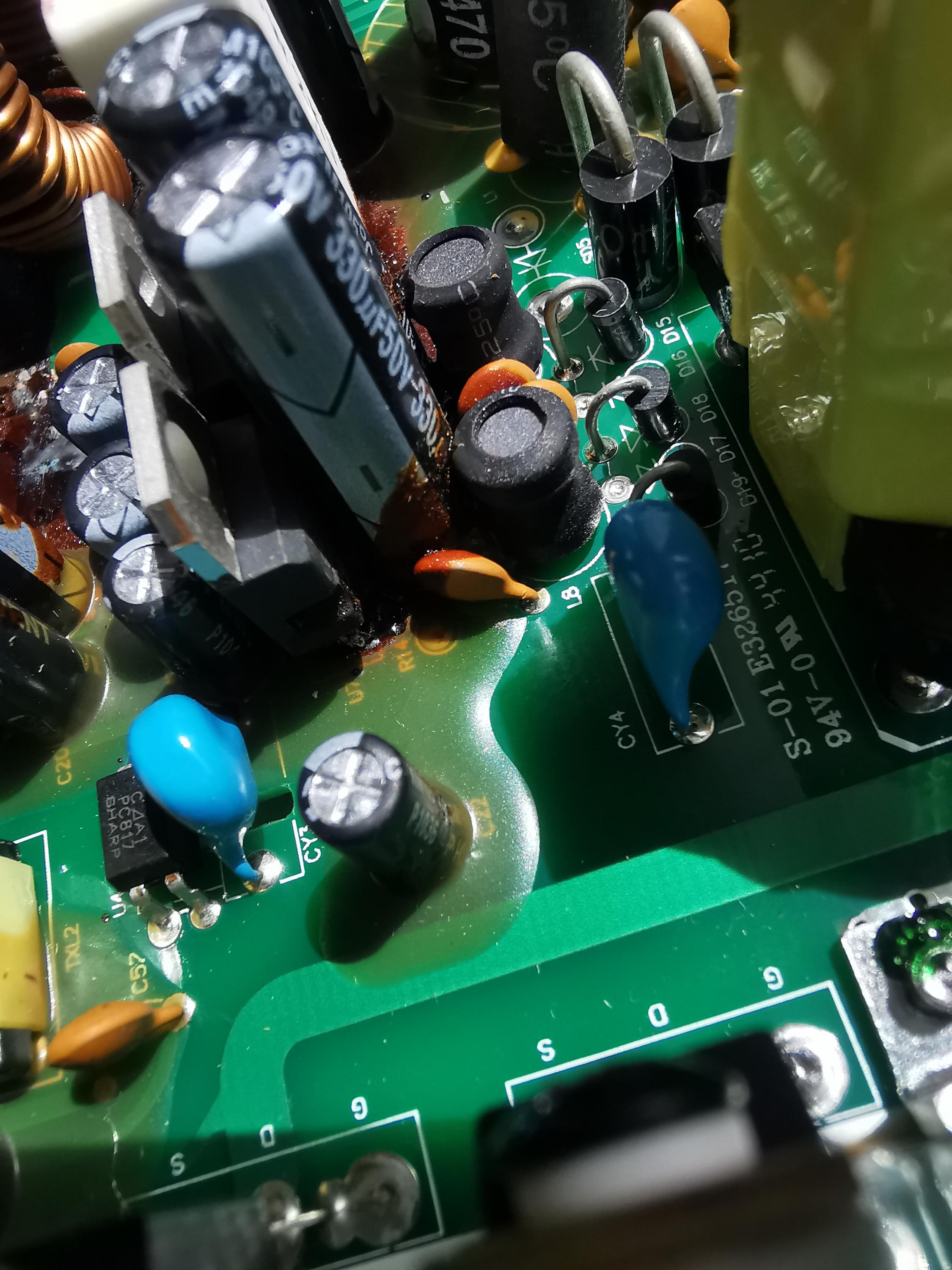

                              #34
                              Today I recieved a Jamo A101 subwoofer.
                              The problem was it did not work at all. The switched power supply did not start oscillating. After measuring I noticed the feedback optocoupler was not switching. After checking some caps I finally found a defective Schottky diode. This one was fully shorted.
                              See backside of PCB here below. I have marked de culpritt diode in red. It is a SS16 diode. After replacing it, the subwoofer works well again.
