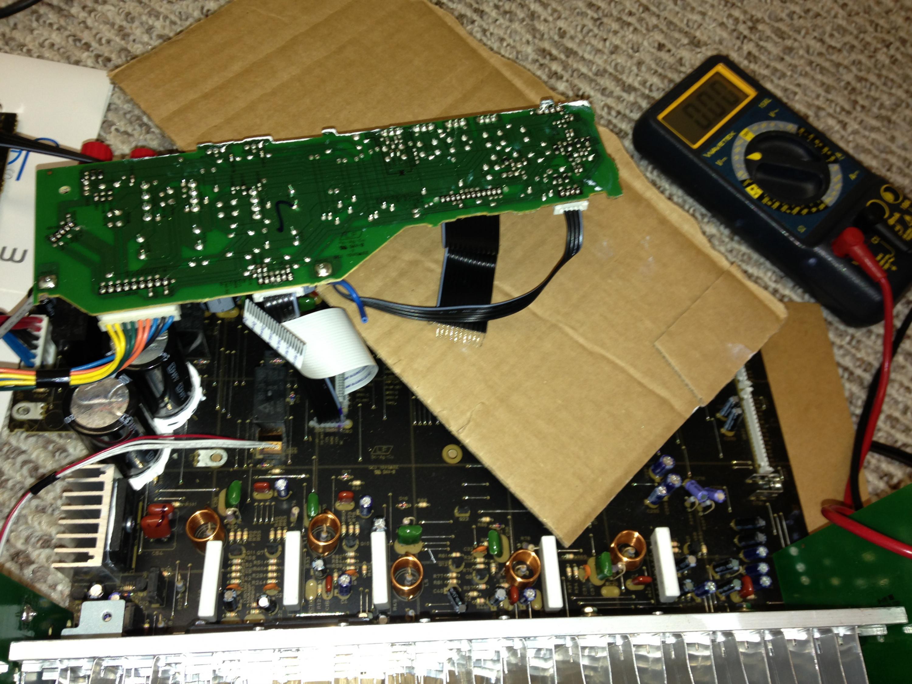

    I got this unit from a friend and been trying to fix it. I have made sure it was not in protected mode and as you can see comes on and then off after a certain amount of time. I can not keep it on long enough to check voltages. I would love a schematic and/or some help. I want to try to get it working. I have pulled the transformer and measured ohms across it and get 2.5 ohms. I would expect the transformer to show higher ohms. Any help is appreciated.
    I then found this video which states the ohms should be bigger. http://www.youtube.com/watch?v=1xIlqe-P1CM

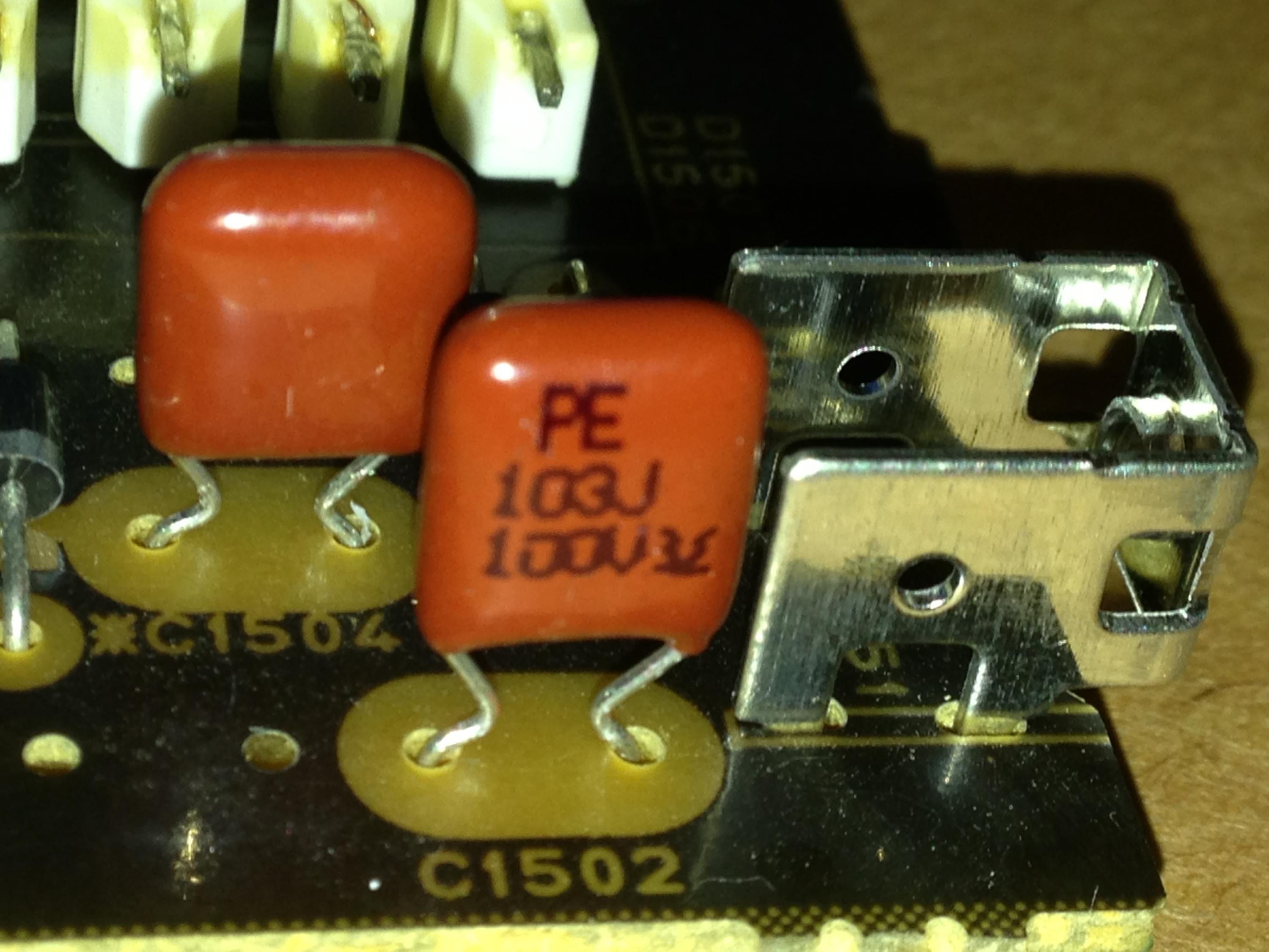

    i did unplug transformer and some of the other leads and found on c1504 5 volts on one leg which i would think it normal and then c1502 i did not find any voltage on any leg ????
    Also if you just hit the power button nothing happen at all. No relay click or anything.
    Here is the video of what is going on
    http://www.youtube.com/watch?v=67GEcKIbqs8
    i have the service manual and thinking a bad cap or something as I do not see some voltages.

        ESR meter cannot test the cap shown in video. Only for electrolytic caps.
          Re: Yamaha rx v373 - no power

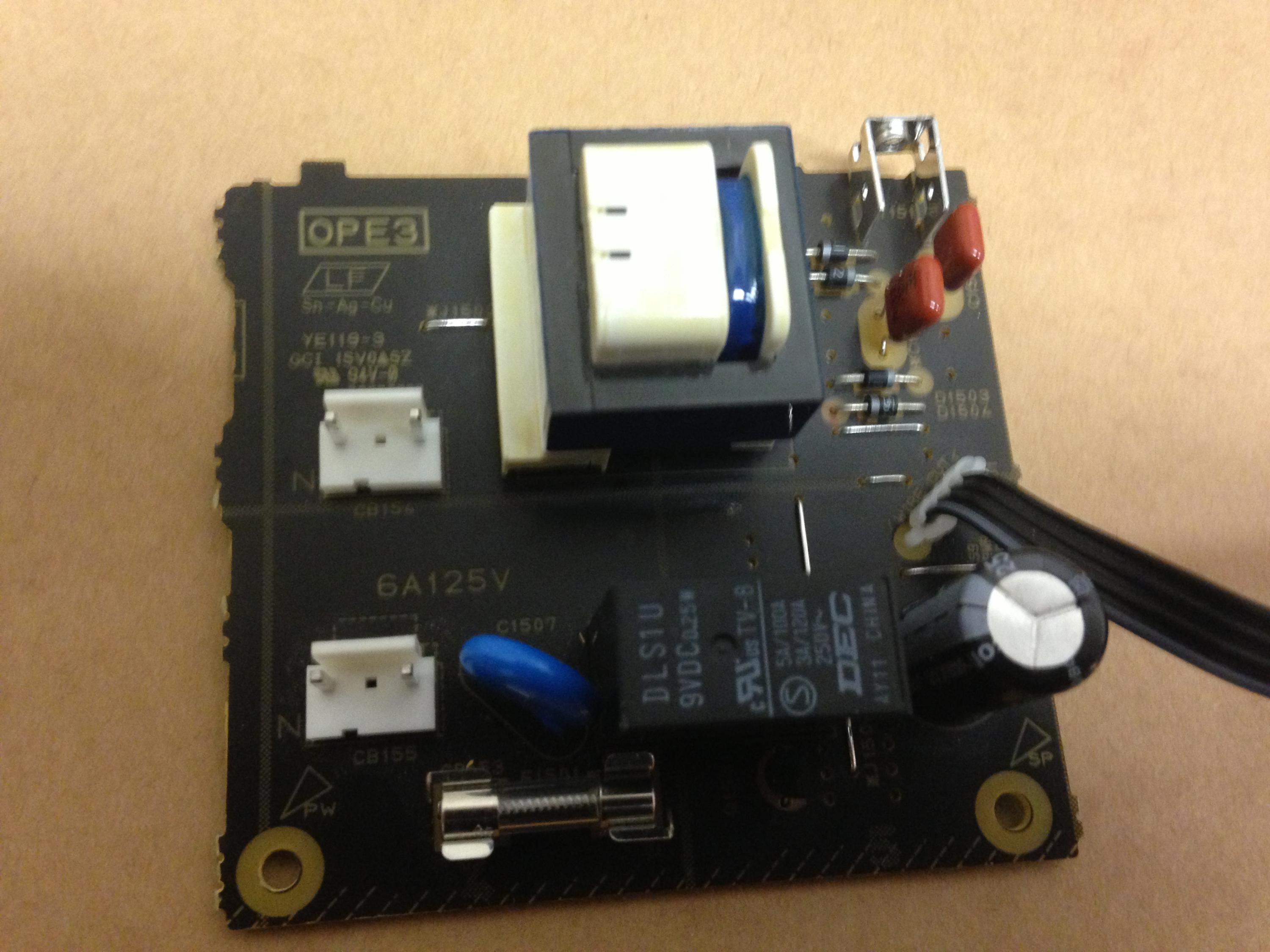

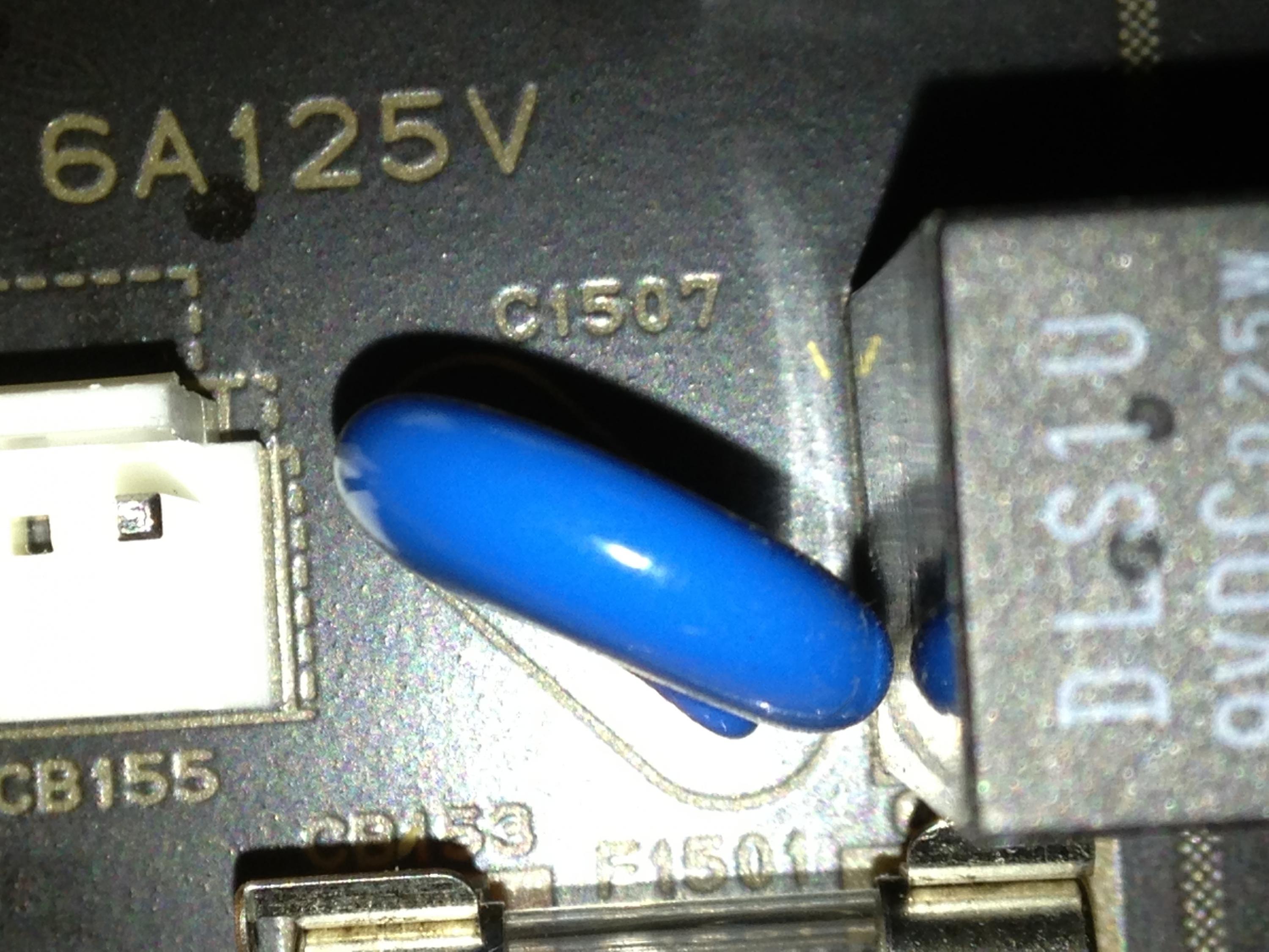

          Wow i did not know that. You saved me some money. I tried to ohm them out in circuit and some read 980 ohms and others where open or showed 1 on multimeter. Then i just ran a continuous check with tone and only one cap actually beeped. I think i am going to replace them all but unsure. I do not know how to test the caps in circuit. But if i am replacing one might as well do all small ones. I have attached the board and the caps i will replace unless you do not think so.

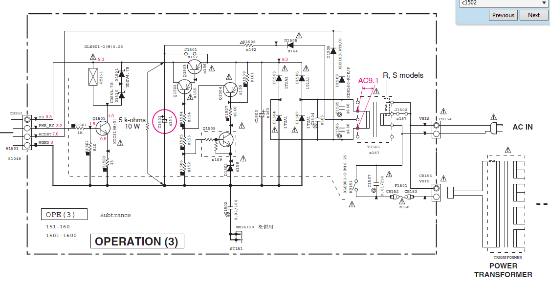

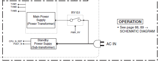

                  It appears to have a standby via the schematics. Here are some shots. the only cap i see in standby is c1507. I take some tests points and do not see the 9.3 at all. I see around 11 volts. So i assume the relay is not kicking on. I also assume it is because it is in standby. I know i could be totally off but that is my thinking. Your thoughts ?
                  c1507 is the blue cap in the previous pictures.
                  i can provide full schematic if needed for anyone.

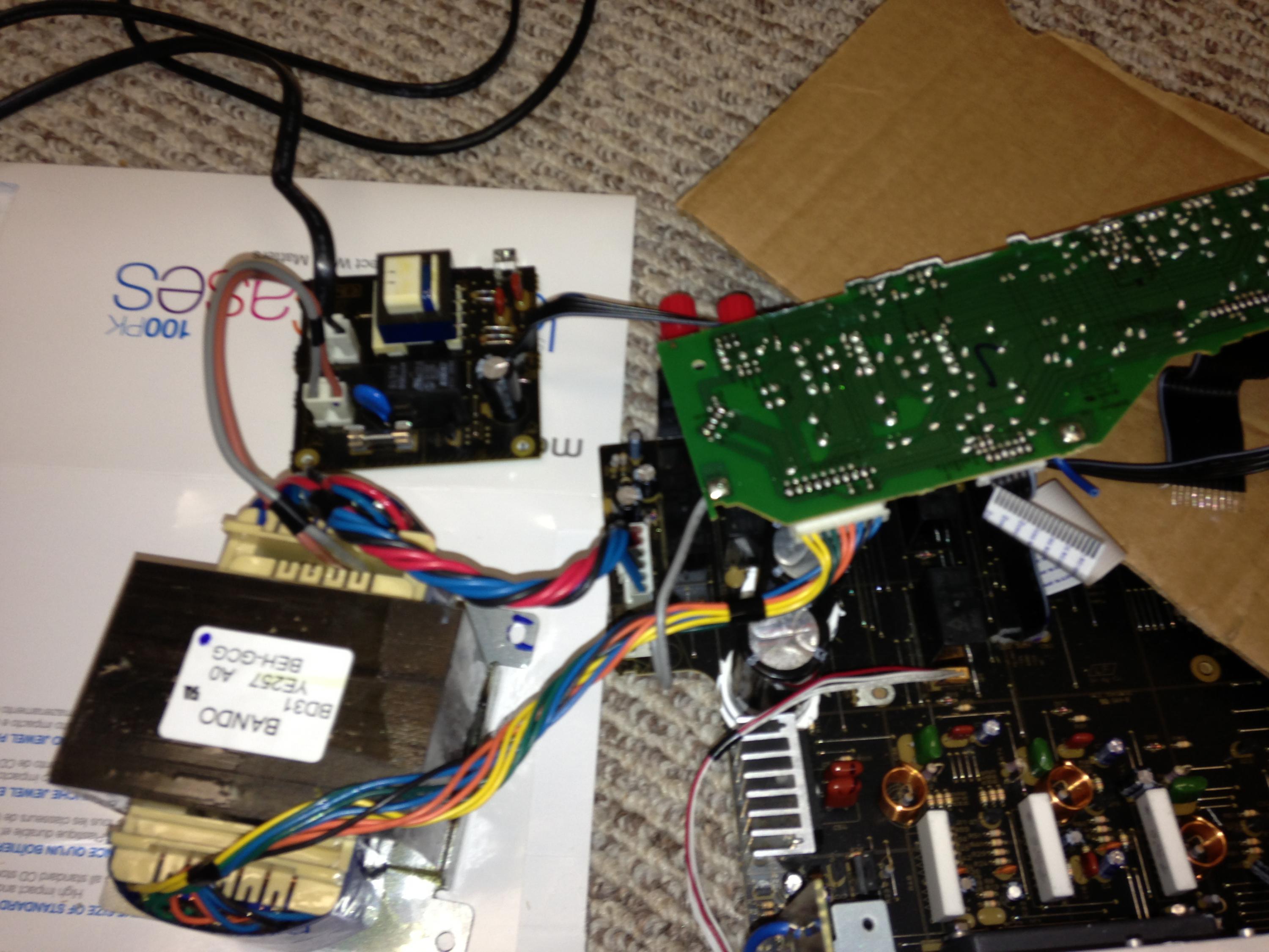

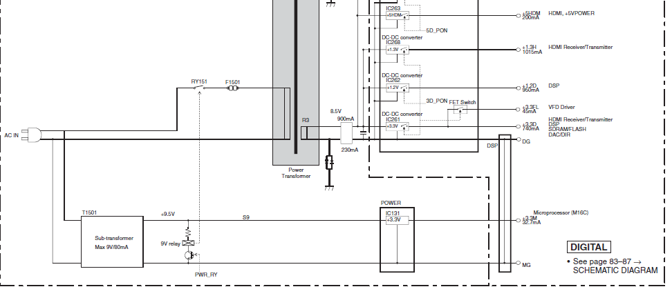

                    Here is another shot where it shows it is going straight into the the standby it appears. But also hits the transformer.
                    I did an ohm test on the transformer and it showed 2.6 I figured it would show higher out of circuit.
                      So at S9, you are getting about 11vdc? What do you get at PWR_RY?

                          Budm - I have 13.54 at S9 and at PWR_RY I have nothing.

                            The fact that you're seeing good standby voltage (variations are expected; that voltage is given when the amplifier has powered on fully and is producing audio) but no POW RY indicates the main board is somehow not sending the right signal. There will be a regulator on one of the boards somewhere knocking the 11V down to 5V or 3.3V; test that.
                              You need that 3V to turn the transistor which drive the power relay to supply the voltage to the transformer. So main board is not doing its job. BTW, the the transformer DC resistance will be very low, but at 60 Hz, the impedance will be a lot higher.
