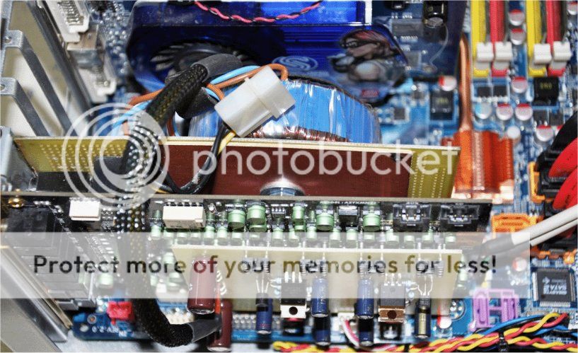

                        Ok, 2 questions now!
                        -And the caps for the line level of rear channels, anyone knows who they are?
                        I mean which caps, because i asked the power ones and someone identify them (thanks)
                        -and for this:
                        -What are the beneficts in audio using film caps instead of electrolitcs? For that they removed the front ones, right? or they are in paralell?
                        Sorry if my ask is noob but i am learning!

                          Re: What is the POWER cap for the CT4830 Sound Blaster LIVE!
                          Are you serious?!!!
                          The leads of those capacitors catch so more EMI noise and interferences from inside the computer that they completely nullify any benefit they would bring compared to electrolytic capacitors.
                          Loooks like an audiophool had nothing better to do.
                          Ridiculous.
                          Dude, you have a crappy sound card with crappy DACs/opamps... you're just polishing a turd. Yeah, it was a decent soundcard compared to alternative soundcards AT THE TIME IT WAS POPULAR. Nowadays even newest onboard sounds have better quality than that sound card.

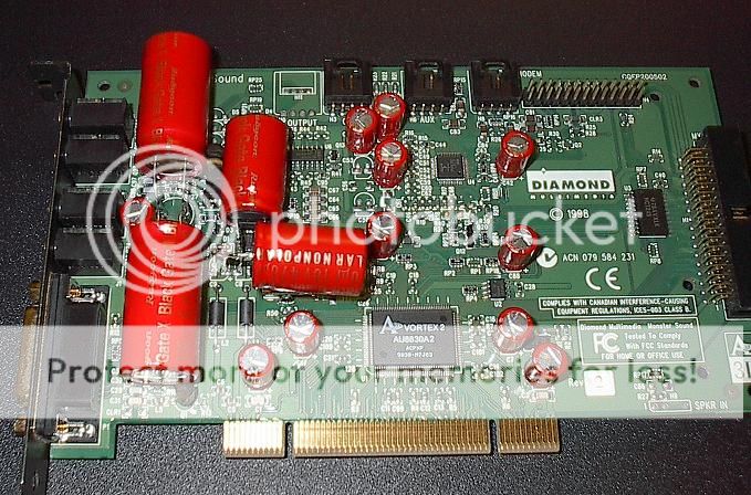

                            By the way neither of this photos is mine:
                            Read the pic above... it says xonar.... and it is for showing the film caps. Can you answer what i wasked?
                            and the process here is learning... can provide what line level caps are on this board or not?
                            Then after i do this to this board i can do to a more serious one!
                            Peace!

                            Originally posted by mariushm
                            Are you serious?!!!
                            Ridiculous.

                            • mariushm
                              • May 2011
                              • 3799
                              I didn't even look carefully to see if it says xonar or Creative, because that mod is a stupid thing. You don't need 250v rated film capacitors to do dc decoupling on speakers (or whatever they do).
                              As for the other sound cards... it's all about how you fool yourself into thinking a particular sound card sounds better.
                              It's enough to check the datasheets of some of those capacitors to burst out laughing.
                              Here, let me give you a few examples :
