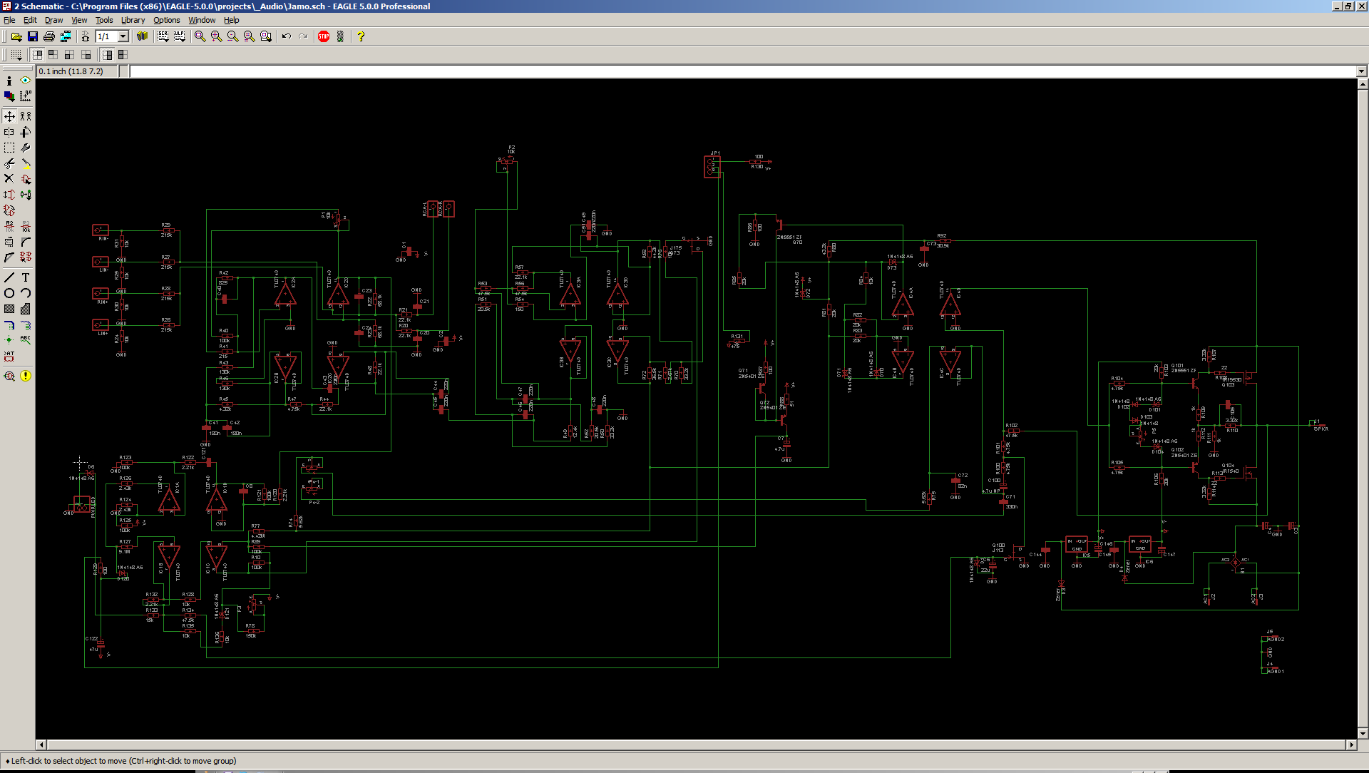

    My friends,i need a schematic of that subwoofer.

    I got one of these, faulty, a couple weeks ago, and i'm in the process of "deducing" the schematic from the board, but it might be a while before i'm done with that...

        Well, i think / hope i'm done lifting the schematic.
        I'm attaching a screenshot of the current state - i laid out parts as close as i could to how they're laid out on the board, to try to have a 1:1 or WYSIWYG sort of thing, to ease my labor
        Next step is to rearrange the parts so they make more sense topology-wise.
        I renamed all the parts with their corresponding silkscreen names, and i filled in the resistor values. I didn't really bother with the caps (especially since the ceramics aren't labeled in any way).

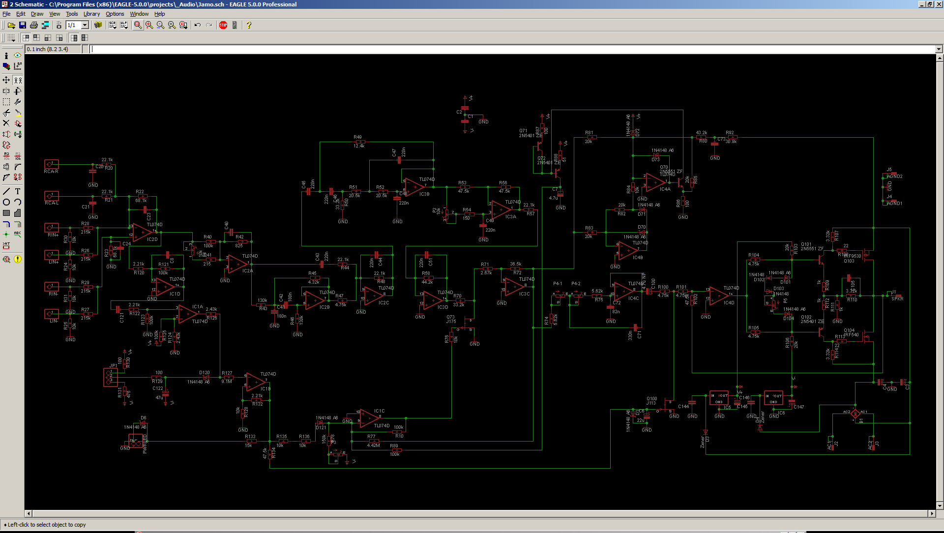

          Well, this is as far as i got. I *can* recognize some of the "building blocks", but some look a bit odd.
          There *might* be a couple small errors (i can't guarantee the accuracy of the IC1B-IC1C region on the bottom, it looks a bit fishy), but at least for now, i've had enough of schematic-lifting
          Hope it helps, though
          Now i just gotta hook it up to a signal generator and try to follow the signal path with my scope. Hope i can pinpoint the issue soon/easily - the sub works, but only at a veeeeeeeeeeery low volume

              For what it's worth, the issue in mine proved to be the (cheap) pots...
              No matter, i just used a couple wire jumpers to "skip over" the volume pot (so it runs basically at full-blast) and the frequency pot (so it's crossed over as high as it'll go)
              Neither of those concern me, 'cause i'm doing the filtering / processing "in the box" (computer) anyway
