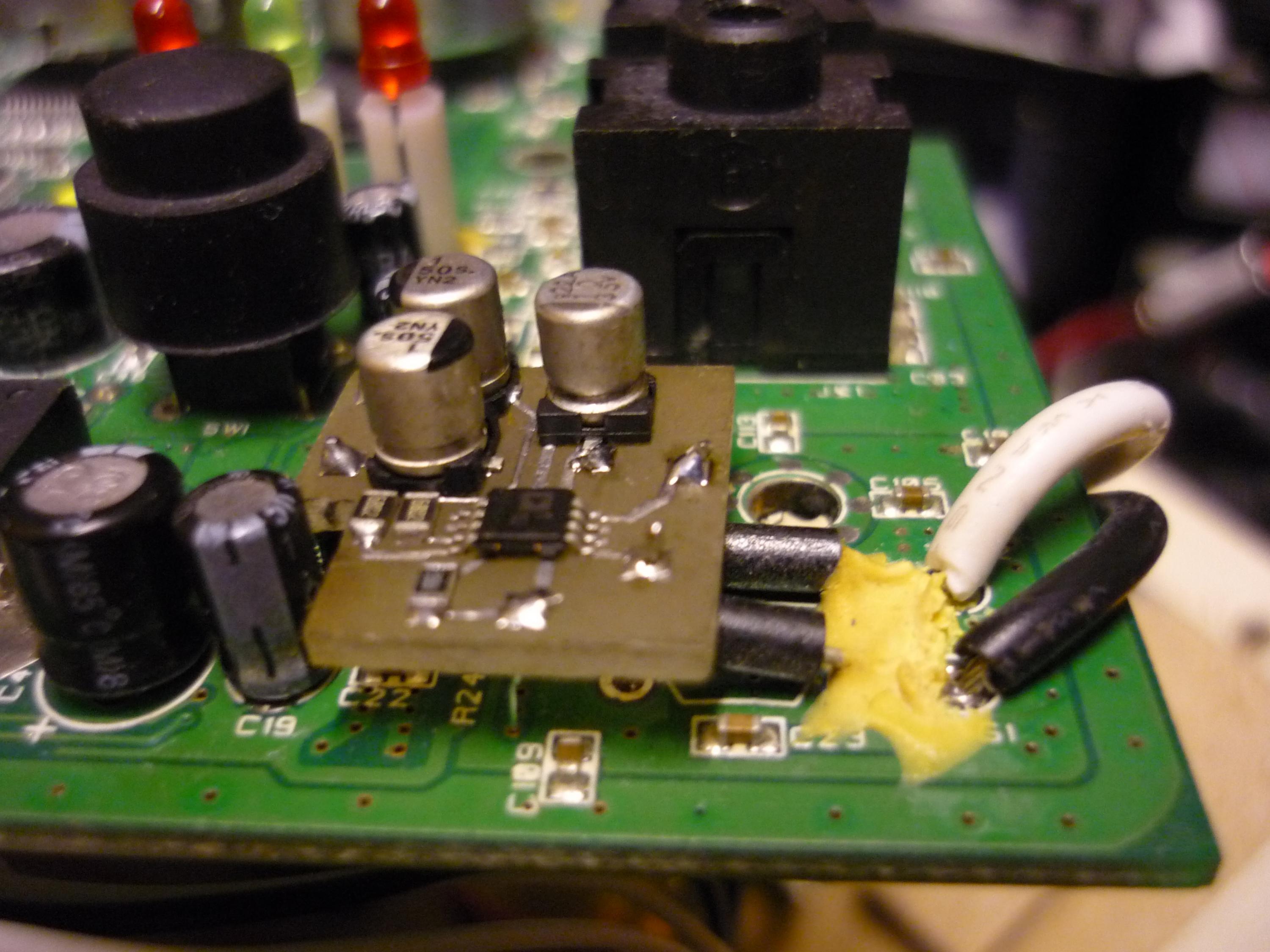

                            OK, at long last I have produced the daughter board. Making the printed circuit has been a very long process but that's another story.
                            I've attached a picture of the board and am testing it at present as I only finished it this afternoon. This is the 2nd attempt as the chip had too much gain so I had to redraw and etch new boards to hold the extra components.
                            One slight snag so far, there is a cap across the chip power rails and I've found the ESR of it isn't low enough which causes break up at max volume. Other than that it appears to work fine.
                            The plan was to have a board that would replace the original o/p chip without having to desolder it and not to have to modify the board by drilling holes, also not needing any special tools to accomplish it.
                            All it takes is the removal of the two electrolytics C17/18 and lifting the speaker connections off the old board and adding the power rails via holes that are already in the main board.
                            Hopefully all I need now is to find some lower ESR 10uF caps and I think it's finished.

                              Hello Bob , I would be really interested in one of your 'daughter boards' . What was the chip you eventually used ? did you originally use the TPA 2034 and did the gain on that seem OK . What gain is your daughter board chip rated at ? I hope it has been successful for you , I am impressed . Would you be interested in selling an example or selling the wiring spec. ? I would really like to get my amp going ,( I have one that works fully and its very good ). I did message you several months ago and thanks for your replies , Mic .

                                I've made a number of boards up but I need to get hold of some low ESR caps as mentioned. I'm looking at Panasonic FP series and it appears Farnell is the only place that stocks them. Trouble is with minimum orders and postage it makes them really expensive so I'm having to wait until I need some other bits.
                                The chip used is the SSM2305 which has a gain of 18dB over 12dB of the original which is why I had to add some gain reduction with resistors. As it's an 8 pin MSOP package it's really easy to replace if it ever blows.

                                    The Panasonic FP series I eventually found at Radiospares and these have proved to be a perfect replacement as their ESR is rated at 0.85ohms.
                                    Just waiting now for reports to come back from a volunteer who is going to install one to confirm they are as easy to fit as planned.

                                      NOW WORKING !!! Thanks Midibob for those daughter boards for the Vox Mini 3 amp . I have now fitted them to the two amps I have .( both had that microscopic and blown amp chip ! ) What a great way to bypass that original chip with a minimum of fuss .They were really well made by you and your instructions to install them very clear and easy to follow . It was only my clumsy soldering that caused me a problem !. They now sound identical to the original working model I had and have the same max. volume . BRILLIANT ! So much better to be able to fix such things which may have once been scraped . Many thanks , I will be in touch , Mic . Nice little amps .
