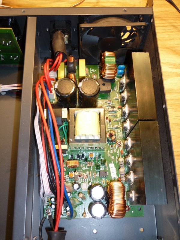

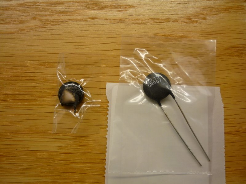

    Got this one thrown my way because it was dead. The fuse was good but there were absolutely no signs of life. I cracked it open not knowing what to expect. At first glance there was nothing grossly wrong looking. I partially removed the power supply and started probing around on the primary side. It didn't take long until I located a disc shaped component that looked a little toasty. It turned out to be directly in series with all the input filters. However there was no continuity across it. Handily, the manufacturer printed the part number on the silkscreen.

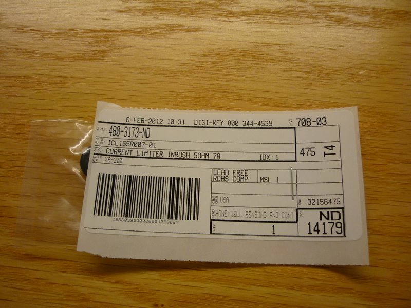

    It turns out to be a 7A current inrush limiter/thermistor. Digikey to the rescue! Three days later the part is installed and the amp came back to life.

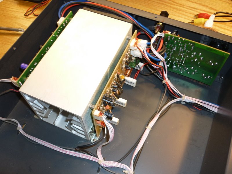

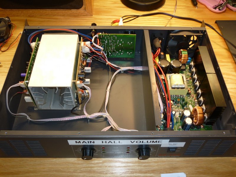

    The pics show the old and new parts as well as the internals. Although not visible, the part in question is near the back of the chassis between the right filter capacitor and the yellow capacitor seen just above it.

            Re: Nady XA-300 Amplifier
            I am surprised that they did not use the relay to bypass that in-rush limiter a few AC cycle after the caps are charged up, that way the Inrush limiter will be used only during turn on, this will also reduce current limit compression, otherwise it will get pretty hot, I never design inrush protection circuits without the relay, may be they try to safe money, I also wonder what the resistance value is when the Thermistor cold and warm.
              This particular one was 50 ohms cold and according to the datasheet it approaches zero when warmed up. I agree it seems like a poor design, but then again this was not exactly a high end amp. Your sentiments about cost cutting probably play into the design.
                You mean 5 Ohms, so worst case max current at start-up will be about 120V/5 Ohms = 24Amps.
