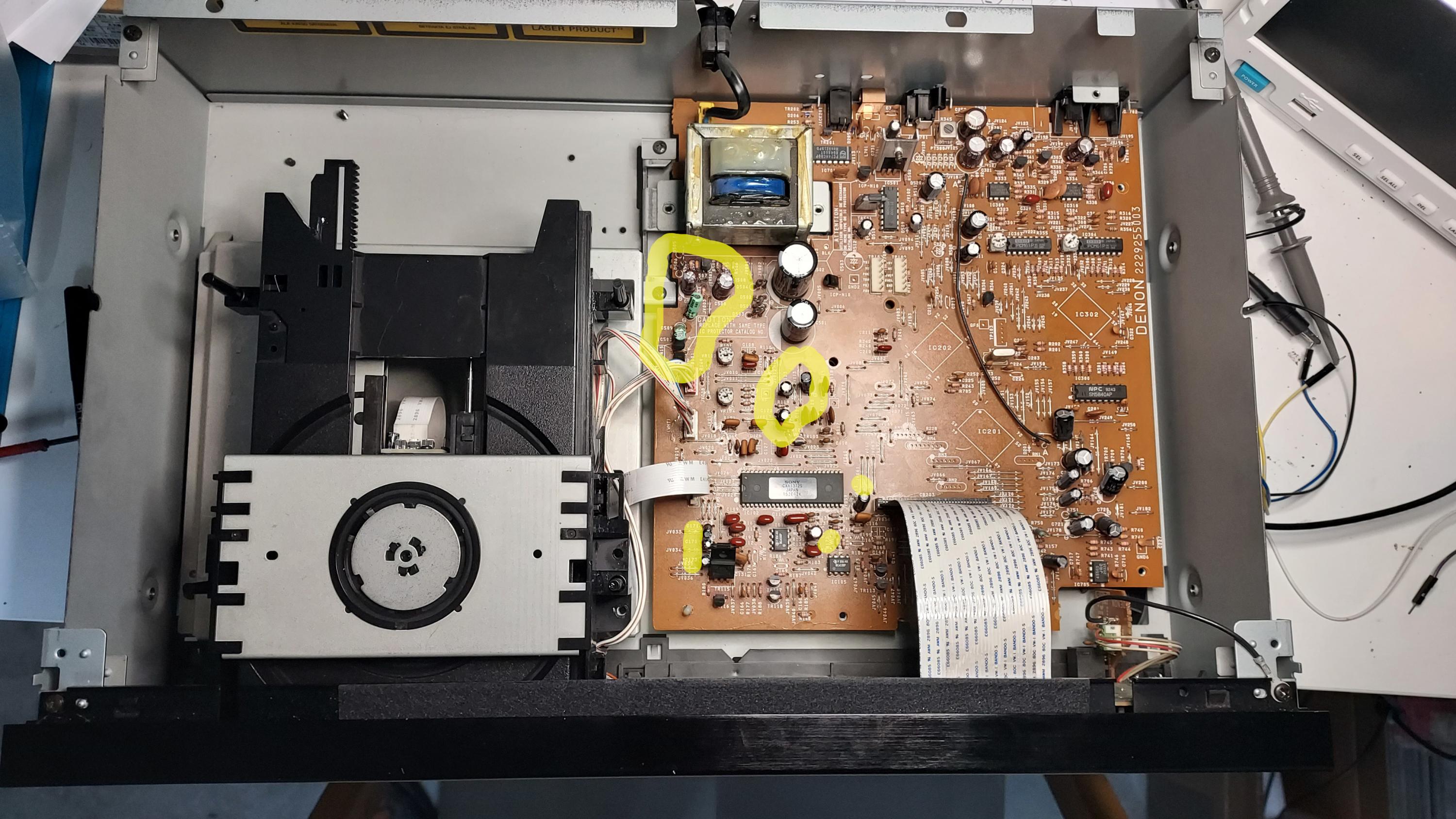

            Re: DENON DCD-890 trying to repair it
            In the meantime I've performed the following:
            1. I've changed some capacitors from PCB
            2. I've replaced the lens just in case
            3. I've checked the flat 12 pin ribbon
            4. I've played some time with the potenciometers, both the ones from PCB and the ones from the lens........with no major improvement.
            However, the CD player doesn't perform correctly. It reads the tracks when you insert a CD, but when playing the different tracks it "jumps" or it gets hard to read them.
            It has something........but not sure how to proceed.
            Any idea about how to proceed? I am listening.....

              • UNITRAX
                • Jan 2023
                • 64
                • POLAND
                Re: DENON DCD-890 service manual?
                I checked the link and indeed it's just a user manual without schematics. Look for diagrams of related models, often the blocks are almost identical.
                It's probably not good that you played with potentiometers for positioning the lens and laser.
                Shooting "whatever" in most cases ends with damage to the laser, or complete deregulation of the control electronics - without equipment and service procedures, the original state cannot be restored.
                The fact that a laser "shines" is not an indication of its efficiency.
                Try to carefully observe the behavior of the player - especially the comparison with its normal operation, and the symptoms of damage are helpful in locating the fault.
                The disc is read, but there are gaps in the recording, the recording skips forward or backward for a few seconds. If it occurs even on perfectly smooth plates - check the carriage movement motor, its rack (it likes to break sometimes) and the cleanliness of the sled - with the power off, you should be able to move the sled with the laser easily by turning the rack by hand. No jamming can be felt! Movement should be smooth.
                At least check the condition of the "spindle" motor (rotating the disc) especially pay attention to the looseness of the motor axis.

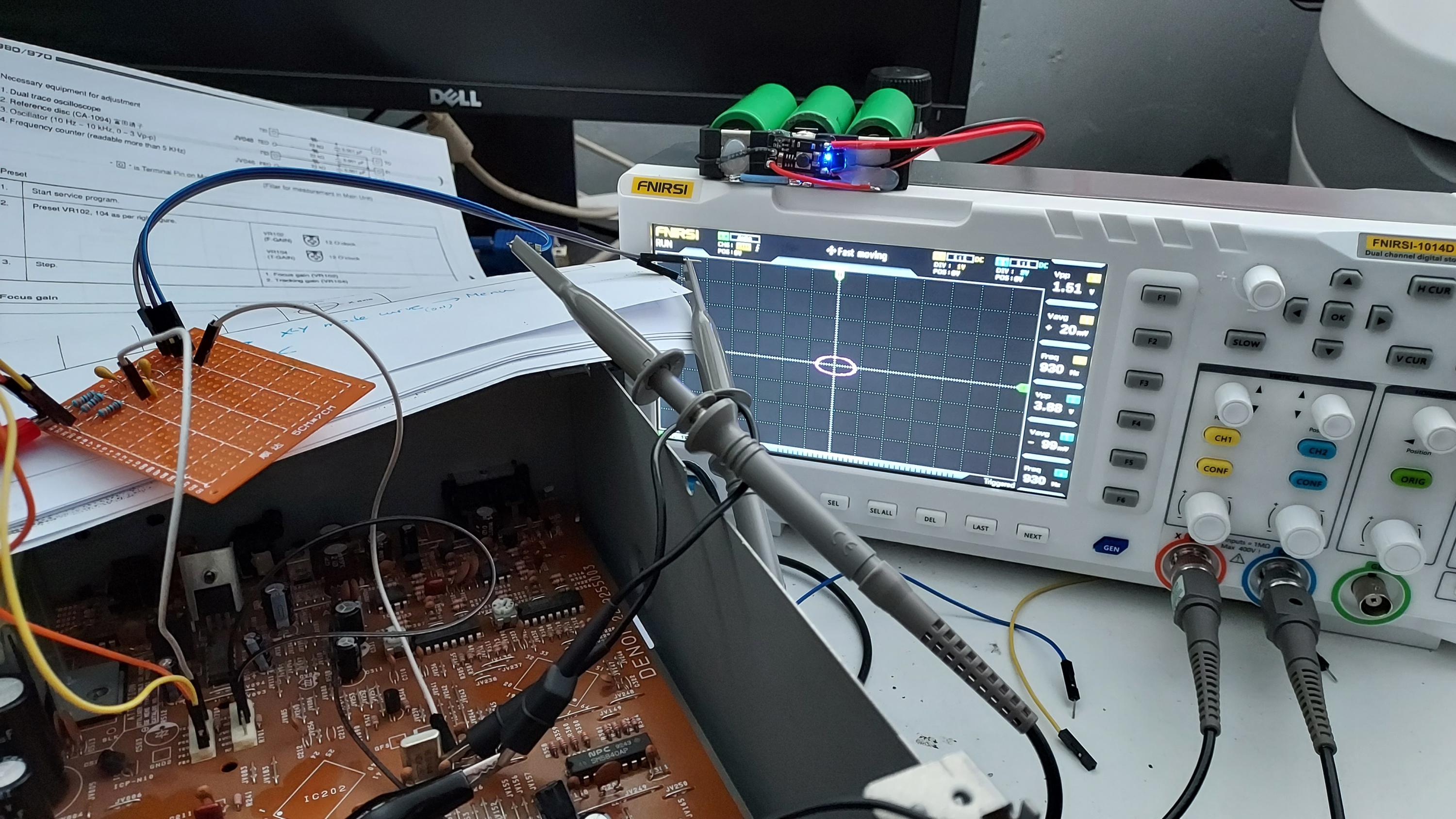

                                    Hi:
                                    Using a close service manual (DCD-980), I've tried to calibrate it using the oscilloscope.
                                    Focus gain hasn't been a problem.
                                    Tracking gain, however............I am not getting the right circle.......just an ellipse. :-(
                                    What do you think about changing the CXA1372S chip (servo control)
                                        Service manual don't say anything about circle just symmetry on both axes. Did you tried upside down test? Because skipping often can be caused by worn spindle motor.
