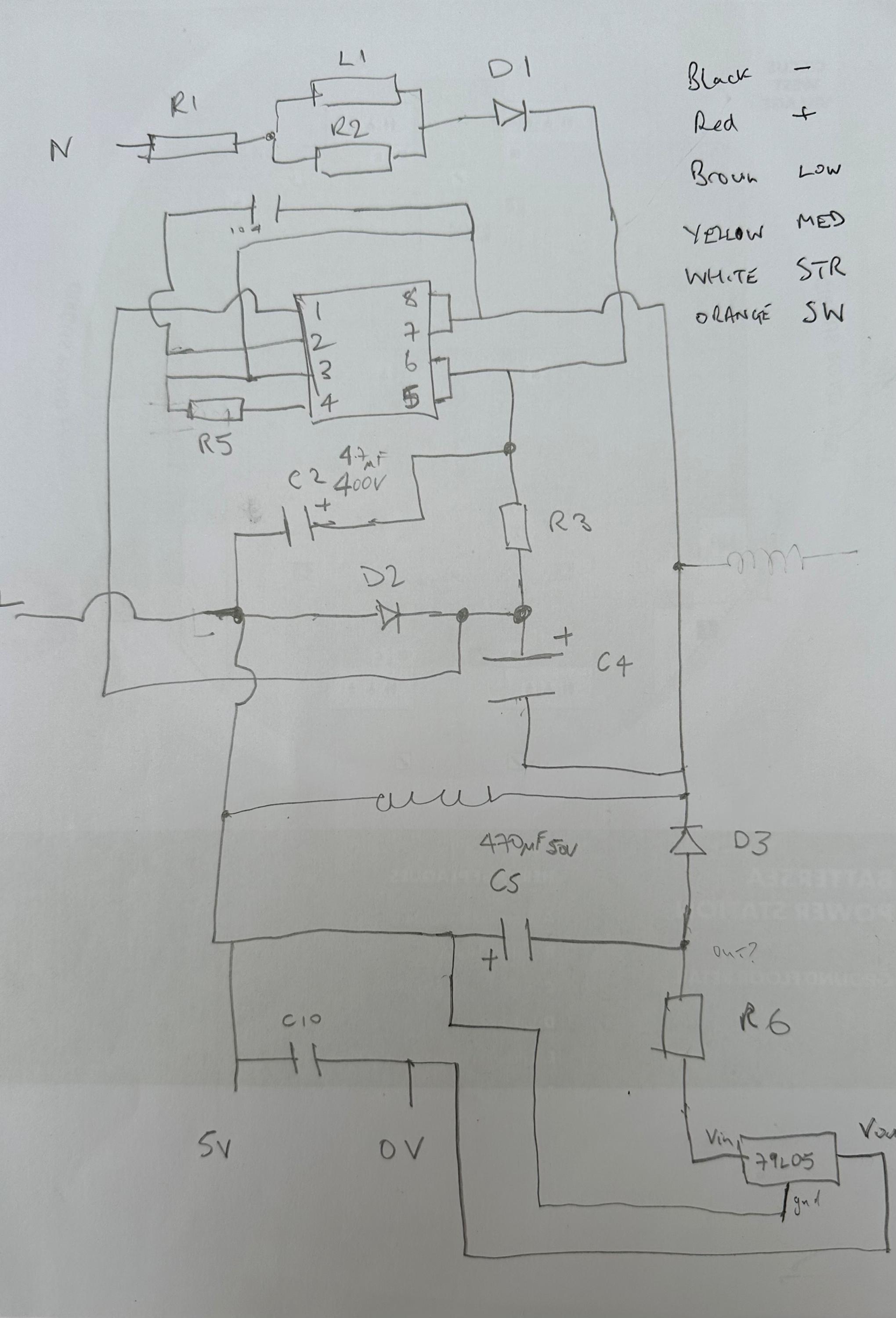

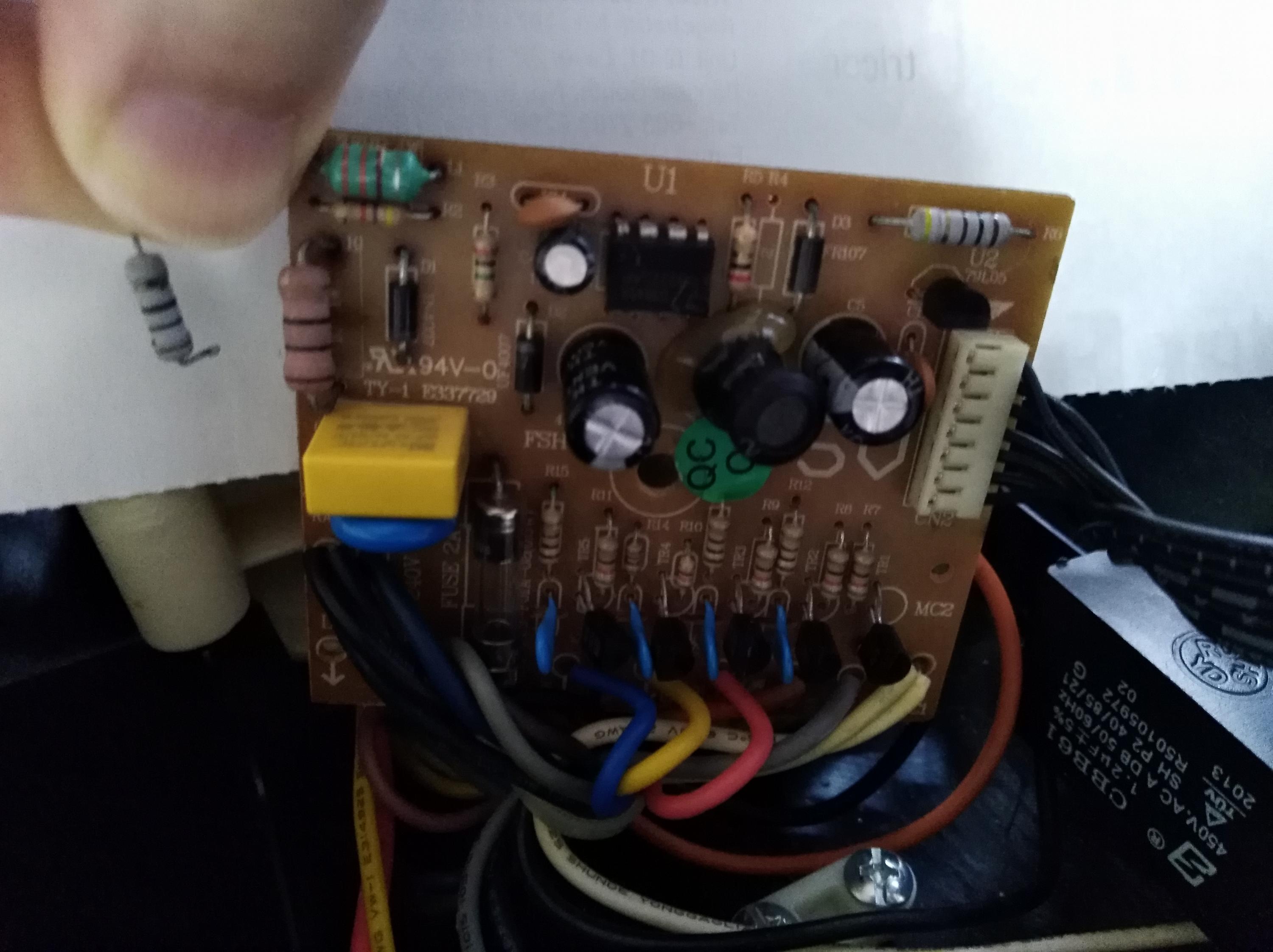

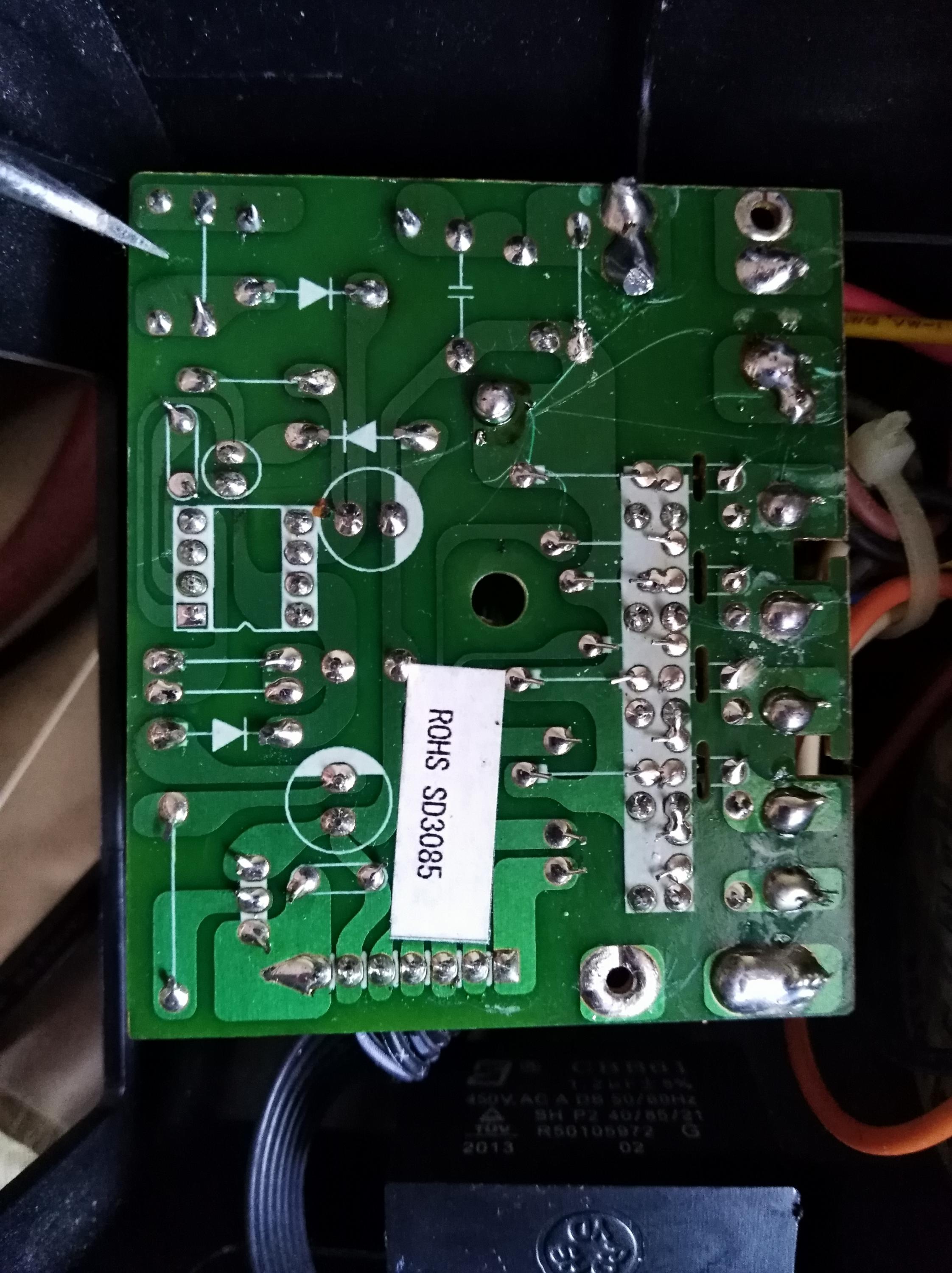

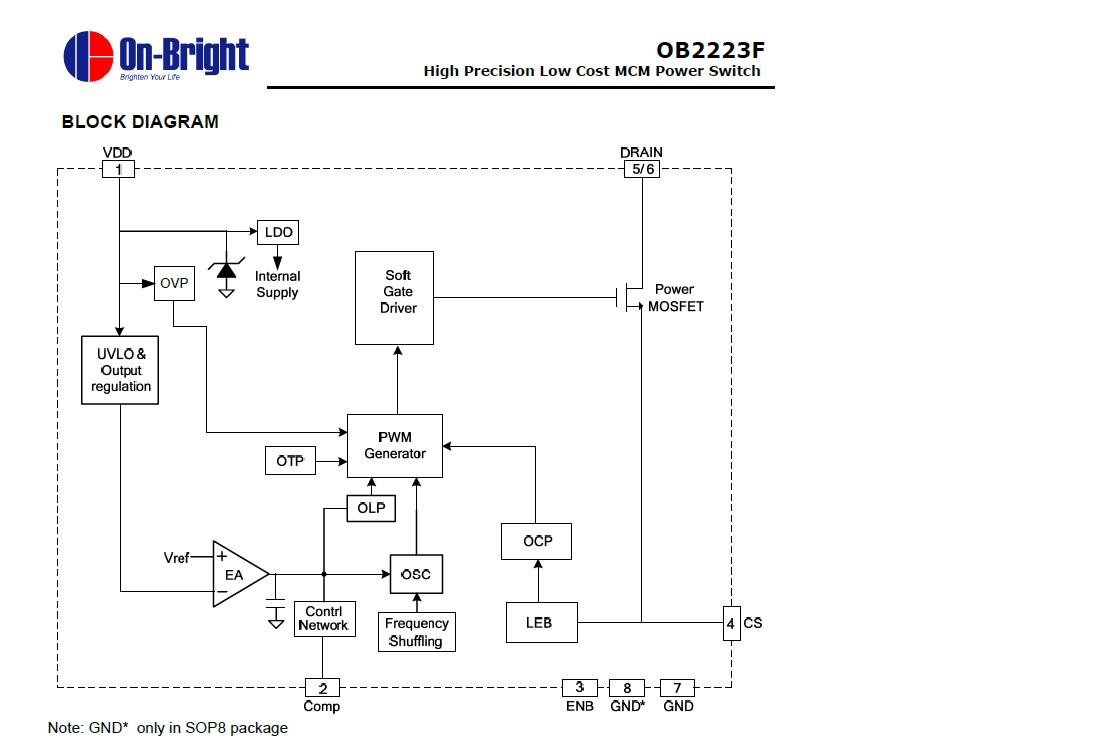

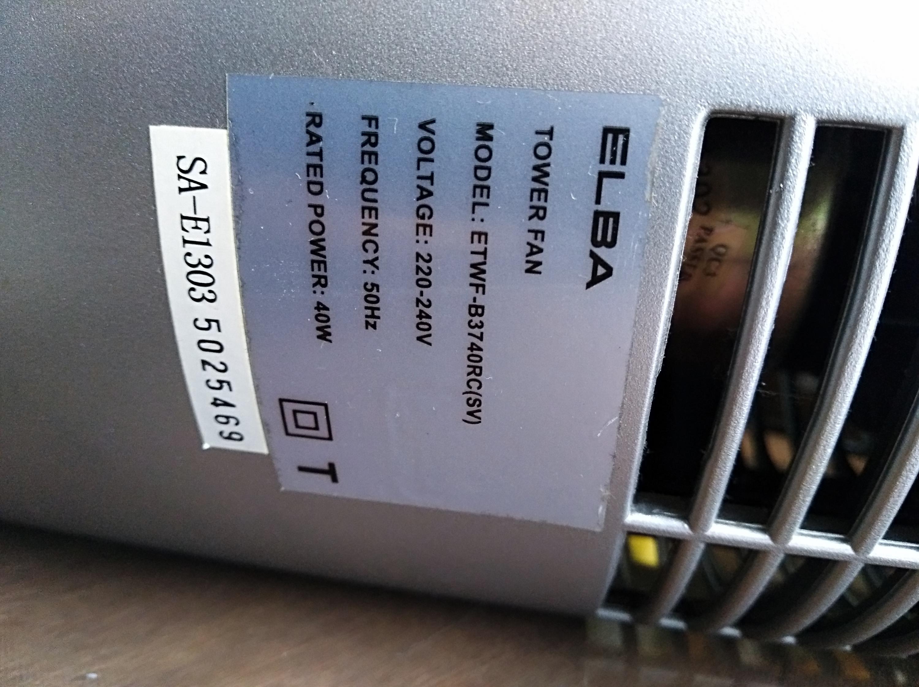

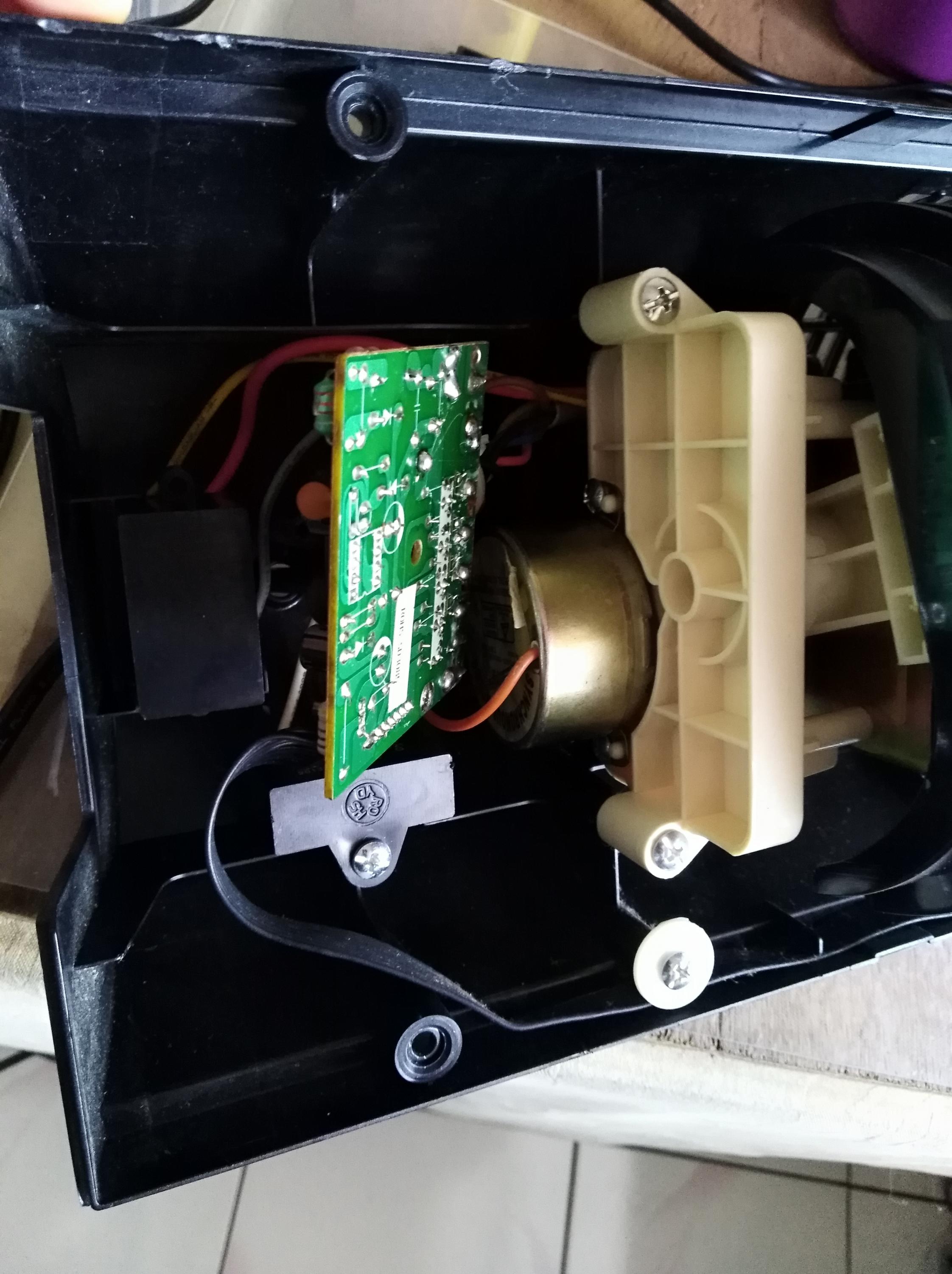

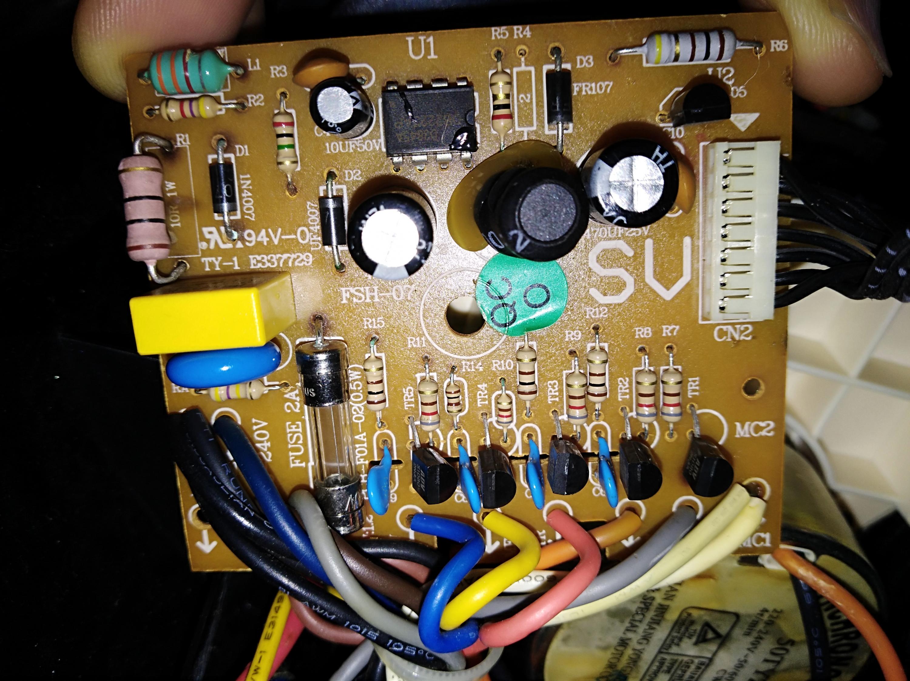

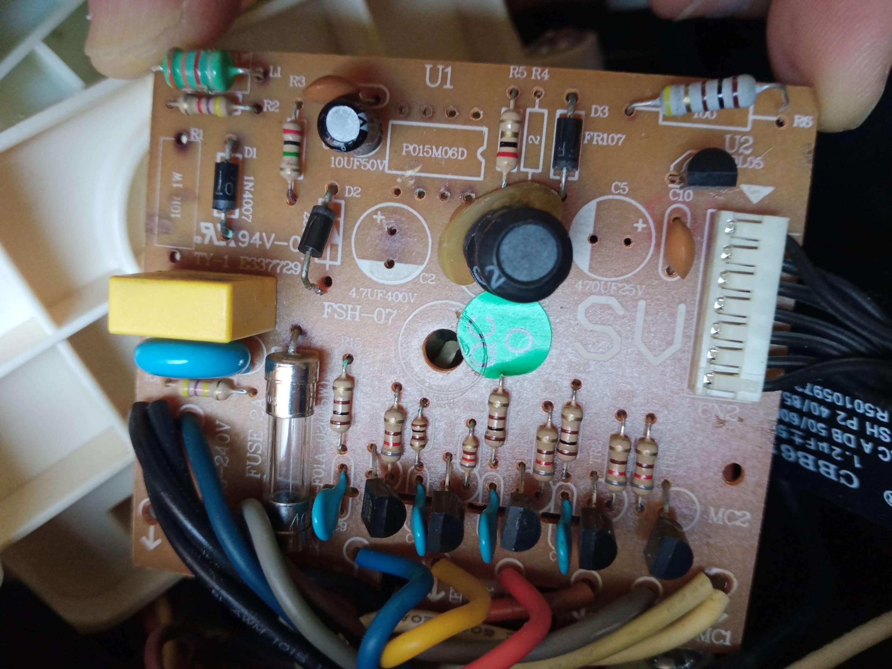

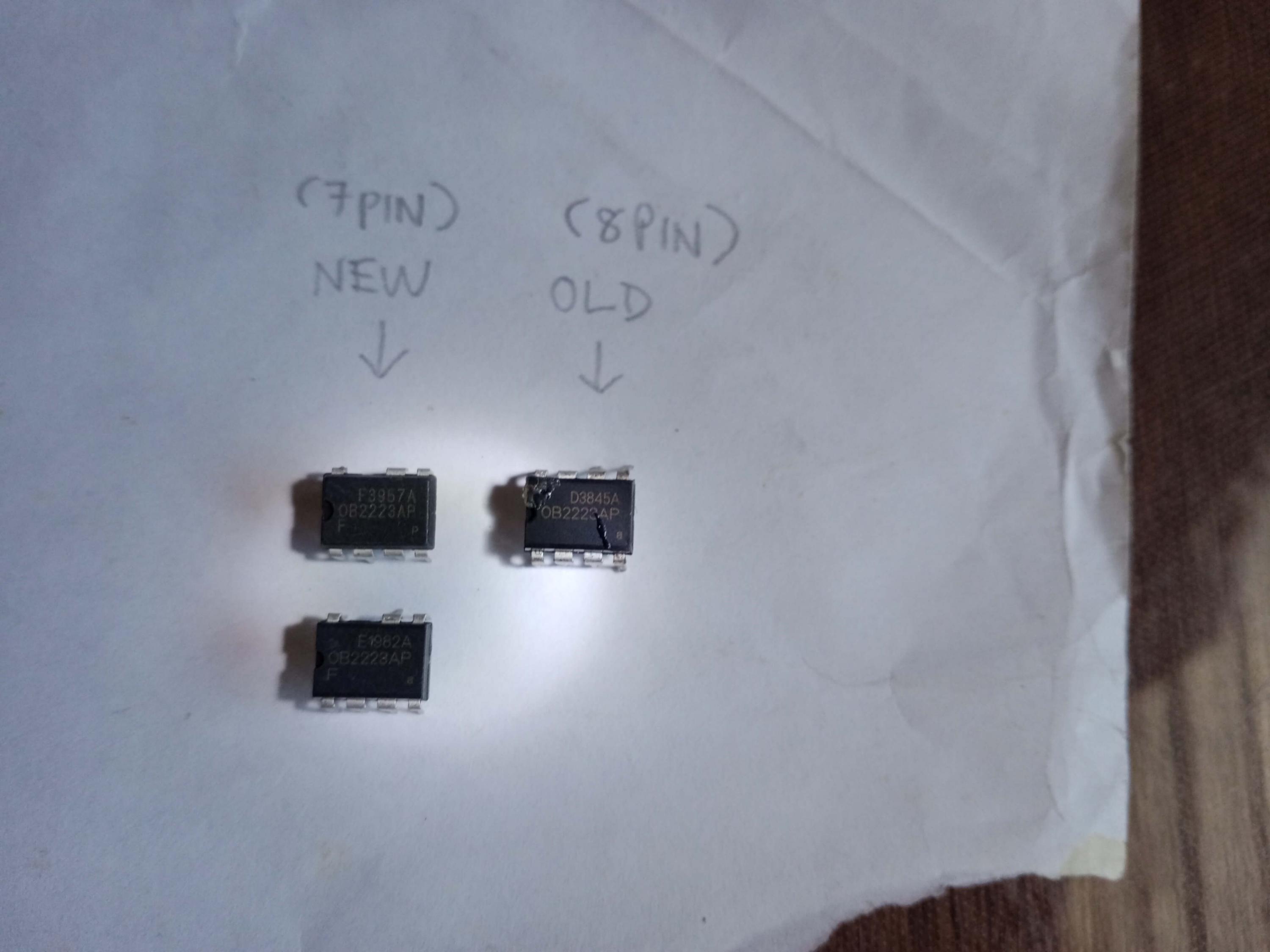

ELBA tower fan keeps blowing resistor
  • mikey5791
    • Dec 2014
    • 504
    • Malaysia
    ELBA tower fan keeps blowing resistor
    Got this ELBA tower fan model ETWF-B3740RC from my sister saying her technician could not repair it.
    Upon opening the plastic case, I found one resistor(brown,black,black,gold)at R1 slightly charred. On the pcb, R1 has 10R 1W silk printed. I tested the original resistor using a digital multimeter and it showed nothing and conclude it must be faulty. So, I replaced with a 10ohm metal film resistor of a bigger size. Upon power on, I heard a spark and the new replaced resistor is blown.
    The 2A glass fuse still has continuity and I do not see any other burned component beside the 10 ohm resistor.
    Can someone experience to assist and guide me where else to check for any short or fault causing the resistor to blow. Appreciate your help and patience to reduce electrical aplliance being thrown to dumpster.
  • R_J
    • Jun 2012
    • 9532
    Re: ELBA tower fan keeps blowing resistor
    U1 is likely blown, Check resistance between 5or6 and 7or8
    I would also replace C4 and maybe the other 2 electrolytic's as well
    Last edited by R_J; 09-26-2022, 08:44 PM.
    • mikey5791
      • Dec 2014
      • 504
      • Malaysia
      Re: ELBA tower fan keeps blowing resistor
      Hi R J,
      U1 is marked D3845A OB2223AP which is a 8 pin pwm power switch. I used digital multimeter (scale 200 ohm resistance) black probe on pin 5 drain and red probe on pin 6 drain, then black probe on pin 7 ground and red probe on pin 8. Both showed reading of 0.9 ohm. Is the reading mean U1 is blown and need replacement? Kindly advise.
        • 30951
        Re: ELBA tower fan keeps blowing resistor
        sounds bad, but test again off the board.
        also, replace the 10uf cap with 22uf 50v
        • petehall347
          • Jan 2015
          • 4425
          • United Kingdom
          Re: ELBA tower fan keeps blowing resistor
          L1 looks a bit iffy
          • mikey5791
            • Dec 2014
            • 504
            • Malaysia
            Re: ELBA tower fan keeps blowing resistor
            Hi stj,
            Noted. Will test U1 off the board to be sure.
            Will try replace the 10uf 50v cap with 22uf or higher.
            Petehall347,
            L1 is a 3.3MH 1W (orange, orange,red,grey)axial inductor. It has a crack on the body. I tested it using digital multimeter on 200 ohm resistance and got reading of 1.5 ohm on board.
            Is this low reading considered bad?
            • R_J
              • Jun 2012
              • 9532
              Re: ELBA tower fan keeps blowing resistor
              Originally posted by mikey5791
              Hi R J,
              U1 is marked D3845A OB2223AP which is a 8 pin pwm power switch. I used digital multimeter (scale 200 ohm resistance) black probe on pin 5 drain and red probe on pin 6 drain, then black probe on pin 7 ground and red probe on pin 8. Both showed reading of 0.9 ohm. Is the reading mean U1 is blown and need replacement? Kindly advise.
              Pins 5&6 are connected together, pins 7&8 are also connected together, so just check the resistance between the two pins 5&7
              If C4 is the 10µf cap I would stick with that value, if you go higher you may have startup issues.
              Last edited by R_J; 09-27-2022, 10:40 AM.
                • 30951
                Re: ELBA tower fan keeps blowing resistor
                the 3845 can have a startup cap as high as 47uf and still start up without noticeable delay - 10uf is going to dry out faster.
                • R_J
                  • Jun 2012
                  • 9532
                  Re: ELBA tower fan keeps blowing resistor
                  Originally posted by stj
                  the 3845 can have a startup cap as high as 47uf and still start up without noticeable delay - 10uf is going to dry out faster.
                  It's not a 3845 it is a OB2223AP, d3845 is a date code
                  • mikey5791
                    • Dec 2014
                    • 504
                    • Malaysia
                    Re: ELBA tower fan keeps blowing resistor
                    Hi R J,
                    Checked the resistance between pins 5&7 at U1 and got reading 14.1 ohm.
                    Then i checked the resistance between pins 6&8 at U1 and got same reading of 14.1 ohm. Is the 8 pin pwm OB2223AP confirmed bad?
                    Btw i will stick with the 10uf50v cap at C4.
                    • R_J
                      • Jun 2012
                      • 9532
                      Re: ELBA tower fan keeps blowing resistor
                      It sure looks like it is bad, the internal mosfet has 14Ω across drain and source, it should be basically open. It could also be something else that is bad so start by removing the ic and checking the resistance again.
                      • kaboom
                        "Oh, Grouchy!"
                        • Jan 2011
                        • 2507
                        Re: ELBA tower fan keeps blowing resistor
                        You don't need any of that.
                        Superfluous stuff to lights some LEDs, and give pushbutton speed/oscillate control.
                        Replace with a rotary switch to change speeds of the main motor, and an SPST switch to control the oscillate motor.
                        No need for any "confirmation;" the OB2223 has burn marks.
                        And do not replace an MOX resistor with a film one, especially when used as a "fuse-istor."
                        That OnBright IC is a non-isolated buck converter. The 2 larger electros should be replaced, and the 3 diodes checked/replaced.
                        Last edited by kaboom; 09-27-2022, 09:09 PM.
                        "pokemon go... to hell!"
                        EOL it...
                        All style and no substance.
                        guilty,guilty,guilty,guilty!
                        guilty of being cheap-made!
                        • mikey5791
                          • Dec 2014
                          • 504
                          • Malaysia
                          Re: ELBA tower fan keeps blowing resistor
                          Originally posted by R_J
                          It sure looks like it is bad, the internal mosfet has 14Ω across drain and source, it should be basically open. It could also be something else that is bad so start by removing the ic and checking the resistance again.
                          Checked U1 off board for resistance and between pin 5&7 and 6&8 both reads 100.9 ohm.
                          I bought some new pwm of OB2223AP but it has only 7 pins, strange since the old one has 8 pins. The resistance on the new pwm on pin 6&8 is "1" but i can't test pin 5&7 since there is no pin 7. Should i replace the old pwm with the new one?
                          Btw, i will replace the electrolytics at C2 &C5 respectively. The resistor at R6 (100 ohm) reads 68.6 ohm off board. Can i continue to use it?
                          • R_J
                            • Jun 2012
                            • 9532
                            Re: ELBA tower fan keeps blowing resistor
                            What do you mean by: The resistance on the new pwm on pin 6&8 is "1" ? 1 what? 1Ω? if that is correct the ic is defective because pin 8 is ground and pin 6 is the drain. What kind of meter are you using? maybe it needs a new battery.
                            Download the datasheet.
                            Pin 7 is not used on some versions (likely On-bright OB2223FAP) Note the F in the lower left of the ic
                            Last edited by R_J; 10-08-2022, 01:03 PM.
                            • mikey5791
                              • Dec 2014
                              • 504
                              • Malaysia
                              Re: ELBA tower fan keeps blowing resistor
                              Originally posted by R_J
                              What do you mean by: The resistance on the new pwm on pin 6&8 is "1" ? 1 what? 1Ω? if that is correct the ic is defective because pin 8 is ground and pin 6 is the drain. What kind of meter are you using? maybe it needs a new battery.
                              Download the datasheet.
                              Pin 7 is not used on some versions (likely On-bright OB2223FAP) Note the F in the lower left of the ic
                              Fyi, "1" on my digital multimeter means infinite or over the range. I selected 200 ohm resistance scale when touching probes on pin 6&8. But when i probe on the old pwm pin 6&8, it gives resistance 100.9 ohm. Is this old pwm still good?
                              • R_J
                                • Jun 2012
                                • 9532
                                Re: ELBA tower fan keeps blowing resistor
                                The old pwm is likely bad, that is why it why it opened R1 resistor. Try checking the resistance between pin 4 and 5
                                Last edited by R_J; 10-08-2022, 07:10 PM.
                                • CapLeaker
                                  Leaking Member
                                  • Dec 2014
                                  • 8035
                                  Re: ELBA tower fan keeps blowing resistor
                                  Originally posted by mikey5791
                                  Fyi, "1" on my digital multimeter means infinite or over the range. I selected 200 ohm resistance scale when touching probes on pin 6&8. But when i probe on the old pwm pin 6&8, it gives resistance 100.9 ohm. Is this old pwm still good?
                                  One word: nope.
                                  • mikey5791
                                    • Dec 2014
                                    • 504
                                    • Malaysia
                                    Re: ELBA tower fan keeps blowing resistor
                                    Originally posted by R_J
                                    The old pwm is likely bad, that is why it why it opened R1 resistor. Try checking the resistance between pin 4 and 5
                                    The resistance between pin 4 &5 is 8.7 ohm on the old pwm measured off board. The old pwm is bad and that is why it keeps blowing the R1 10 ohm resistor. I will replace it with a new one and see if it works.
                                    • mikey5791
                                      • Dec 2014
                                      • 504
                                      • Malaysia
                                      Re: ELBA tower fan keeps blowing resistor
                                      Just now i replaced a new pwm at U1, 10 ohm resistor at R1, 3.3MH 1W axial inductor at L1, 4.7uf400v elct. cap at C2 and 470uf25v at C5.
                                      Total 5 components. Now the tower fan is working good.
                                      Thank you so much for all the help and guidance.
                                      This forum has been very helpful.
                                      • Mark_Stewart
                                        • Sep 2023
                                        Re: ELBA tower fan keeps blowing resistor
                                        My tower fan is a Honeywell HO 5500RE but has the excat same circuit board. Symptoms for the fault was no power, no lights but no obvious defects to any components. There was power to the board, but nothing at the 5V supply which supplies the logic board at the top of the fan. Checked C5 and D3 ok. U1 outputs were not shorted so assumed ok. Eventually found R3 a 2Mohm resistor had failed open circuit. Replaced with two 1Mohm in series and 5V was restored and the fan works! Interesting circuit as the 5V output seems to have live mains to it and the 0V is supplied via a 79L05, so there is 5V difference DC, but mains on something that is marked 5V. Image shows my poorly drawn circuit diagram of the power supply side.
                                        Also was initially puzzled by the fan wiring a Shanhu SHM-40 seven wire three speed fan. Some details here https://electronics.stackexchange.co...om-a-tower-fan
                                        What puzzled me is that the live (brown wire) goes to the motor and returns to the board via the grey wire. Presumably there is a thermal fuse in the motor which would kill the supply to the board and would show the same no power, no lights failure.
                                        • jinu_j
                                          Dell 2209WA - power supply - Fusible Resistor replacement
                                          by jinu_j
                                          Hi
                                          I am trying to repair an ancient Dell 2209WA Monitor which suddenly shut off with a pop sound. On investigation found that one of the fusible resistors had blown. Further investigation identified multiple components as faulty because of which the fusible resistor blew. Please refer the attached circuit diagram showing the components that were found to be damaged.
                                          1. FR950 - blown fusible resistor - 0.2 Ohm 1W
                                          2. Q950 - shorted Q950 MOSFET - 650V 10A N Channel Mosfet
                                          3. R835 - Blown Resistor - 20KOhm SMD resistor
                                          4. D930 - Shorted Schottkey Diode...
                                          05-03-2025, 10:51 PM
                                        • mikey5791
                                          Need help to replace burned resistor in 350w atx psu
                                          by mikey5791
                                          Hi to all forum members,
                                          Got this faulty 350 watt atx psu dirt cheap from a local online seller as i am keen to use it as a learning tool to repair faulty power supply.
                                          The faulty part is quite obvious from the burn area near the 16pin KA7500 BD pwm. The fuse is still intact with good continuity.
                                          Upon power on ac, there is 5vdc standby power on cathode of diode D14 and about 10vdc on cathode of diode D13.(This should be the aux power to generate the 12v and 5v rail.)
                                          Initially i replace the two burned resistors near my marked red arrow to 200 ohm resistor...
                                          12-26-2024, 04:55 AM
                                        • agent0bean
                                          Acer Aspire a715 - no power, 10ohm resistor keeps blowing on VCC
                                          by agent0bean
                                          I got Acer Aspire A715-42G, no 19v going through the DC-IN mosfet. I also checked the components/power rails downstream and no short detected (gpu and cpu rails are at 2-10 ohms)
                                          I have checked that there's no gate voltage on the DC-IN mosfet, so I checked if PUB1 has power.
                                          Turns out there's no 19v going into PUB1 VCC caused by a burnt 10 ohm resistor (PRB12 - 19v stops here).
                                          Replaced the part but it burned when I plugged in the charger - telling me there's something pulling high current.
                                          I checked the resistance of PCB16 and it was fine.
                                          I measured the resistance...
                                          09-20-2024, 02:18 AM
                                          HP Z240 Tower Workstation i7-7700K Specification for Upgrade or Repair
                                          This specification for the HP Z240 Tower Workstation can be useful for upgrading or repairing a desktop PC that is not working. As a community we are working through our specifications to add valuable data like the Z240 Tower Workstation boardview and Z240 Tower Workstation schematic. Our users have donated over 1 million documents which are being added to the site. This page will be updated soon with additional information. Alternatively you can request additional help from our users directly on the relevant badcaps forum. Please note that we offer no warranties that any specification, datasheet,...
                                          09-12-2024, 03:44 PM
                                          HP Z240 Tower Workstation i7-7700 Specification for Upgrade or Repair
                                          This specification for the HP Z240 Tower Workstation can be useful for upgrading or repairing a desktop PC that is not working. As a community we are working through our specifications to add valuable data like the Z240 Tower Workstation boardview and Z240 Tower Workstation schematic. Our users have donated over 1 million documents which are being added to the site. This page will be updated soon with additional information. Alternatively you can request additional help from our users directly on the relevant badcaps forum. Please note that we offer no warranties that any specification, datasheet,...
                                          09-12-2024, 03:44 PM
