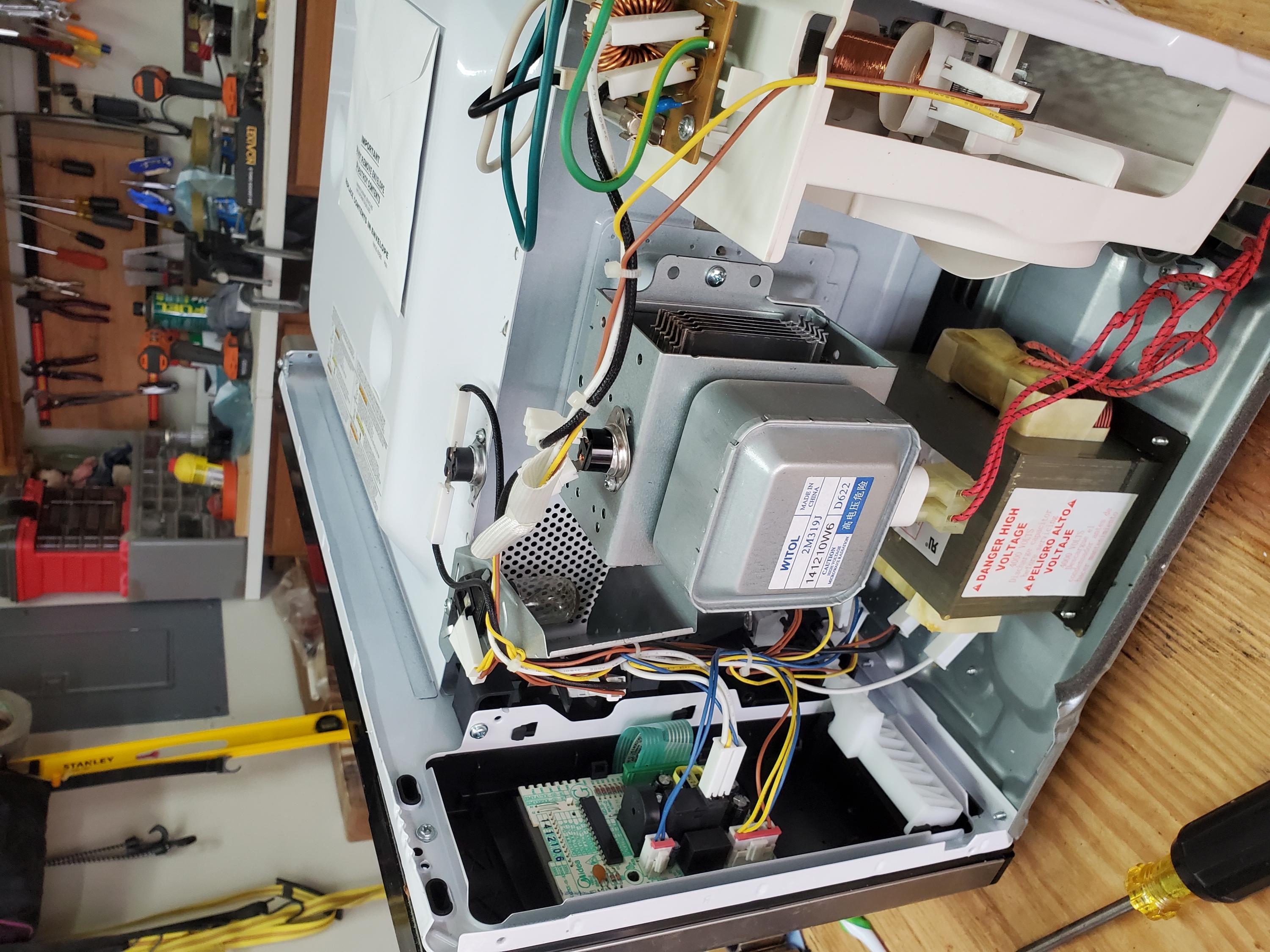

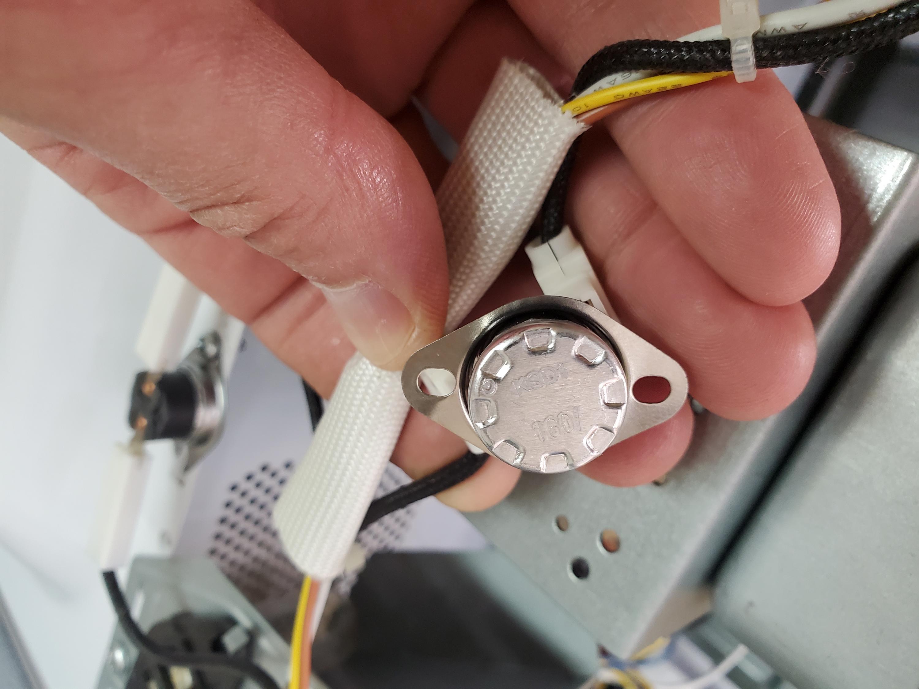

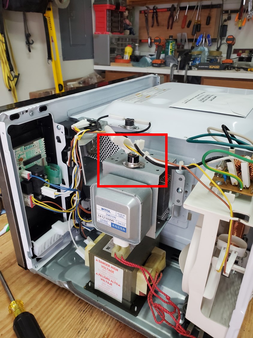

    Hi, my microwave quit working today after my daughter made something and i think i found the problem. i am enclosing a few pics of what i "THINK" is a thermal fuse.......it has "KSD1" .....and "160/" on the front of it....but i am not sure what this means or where to buy it.
    when i measure across this device it measures an "open" so i and i think it should be a short......
    thoughts on where i can get a replacement device?
    thoughts on if this is thermal fuse and should measure a short?

    It's a bimetal thermal switch. It should open up if what it's mounted on gets too hot. It should close again when what it's mounted on cools.

      Bimetal thermostat type KSD
      Response temperature: 160 +/- 5 °С
      Temperature : release -130 +/- 15 °С
      Switching scheme : SPST NC - normally closed contact
      Working voltage : 250V
      Rated current : 10 A

        You should be able to find one at an appliance repair shop, or on line KSD1-160
        It should reset but is likely defective, for a temporary fix, try taping the silver part with a screwdriver handle or similar, then check if it reset, this might get it going until you get a new part.

                  ok so i shorted the thermal switch and power returned to microwave........so thats the good news.

                    i finally found the actual part number and its WB27X11210
                    https://www.geapplianceparts.com/sto...pec/WB27X11210
                    if you go on ge's web site and sure enough this part , which is kinda expensive relative to how much a new machine costs, has the "/" .......so i am just wondering if the parts that have 160 but no "/" if they will really work or not

                      The / is not important, KSD1 is the series 160 is the temperature rating. Do you really want to pay $50.00 + s&h for it?
                      Some are listed kds1.160, kds1/160, kds1-160
