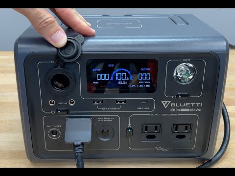

    My charging station stopped working. It charges and the flashlight works, but if I turn on the DC output, it stops working! Does anyone have any diagrams and what could it be?

    Open it up… maybe there is a fuse somewhere inside?

      nothing unusual. the problem comes from the board on the front side. what to look for?

        The display complains about a short on the DC side. Verify it with your DMM. Maybe a diode went bust. Make a straight shot, high resolution picture of the board with the display. I wonder if there is a DC to DC converter or something. Start measuring at the DC output terminals and work your way towards the input and look for a short or open.
        You probably have multiple DC outputs, so you have to look at each one to see which one it is. Once you remove the short, all other DC outputs should be working ok again. The lamp is a separate DC circuit.

                    Later I will disassemble the station for a photo in high resolution. And now a video and photo of the error.

                      before you do that, measure each DC output with your DMM for voltage output and a short. Going to be annoying because you have to restart the unit every time so it doesn't know yet it has a short.

                        BLUETTI sent me updates and I updated the station and now it charges and everything works except AC. There are no errors. AC just does not turn on either from the button or from the app!
                        the judge from all problems with the inverter which BLUETTI blocked in the transferred firmware.​

                            I don't think it's worth changing the station. After watching a lot of video services, it turned out that this is a banal problem of battery imbalance due to a weak BMS. If the station is not used constantly, then there should be no problems. With frequent use of the station, the lithiumferum elements are charged unevenly, which is why this error appears! The treatment turned out to be simple! After updating to the latest BMS firmware, the DS port immediately started working! But for the AC, I had to wait 12 hours for the charge to evenly charge all the elements!

                                  advice if you have problems with the BLUETTI station write to them by email. The BLUETTI team was always in touch and responded very quickly. I did not have updates for the station. They asked for my serial number and said that they would add it to the list for an emergency update. After which 2 updates immediately appeared in my application. Which led to a complete cure of the station and it is now fully functional. THANKS TO THE BLUETTI TEAM!

                                    Interesting. So the BMS cut off the batteries for the DC section. At least you were able to fix it.

                                      BMS protection board do function this way but most of them when you reapply power to charge them if you do not have the over current or short condition anymore it reset this might have been done purposely to prevent it self from being destroyed by self destruction
                                      One note about the video that was showing that the battery cells were unbalanced yes you can try to rebalance them but if they are suffering from self discharging sin drum there is nothing you can do about that you just have to replace the battery cells with new ones then use a battery balancing device that was shown in that video
                                      One other note about the other video about the inverted locking out the controller board and not being able to resetting the controller unless you disconnect the controller cable between the inverter and controller board I am not sure what to make of this situation unless it is for the reason I mentioned above in the beginning of this post
