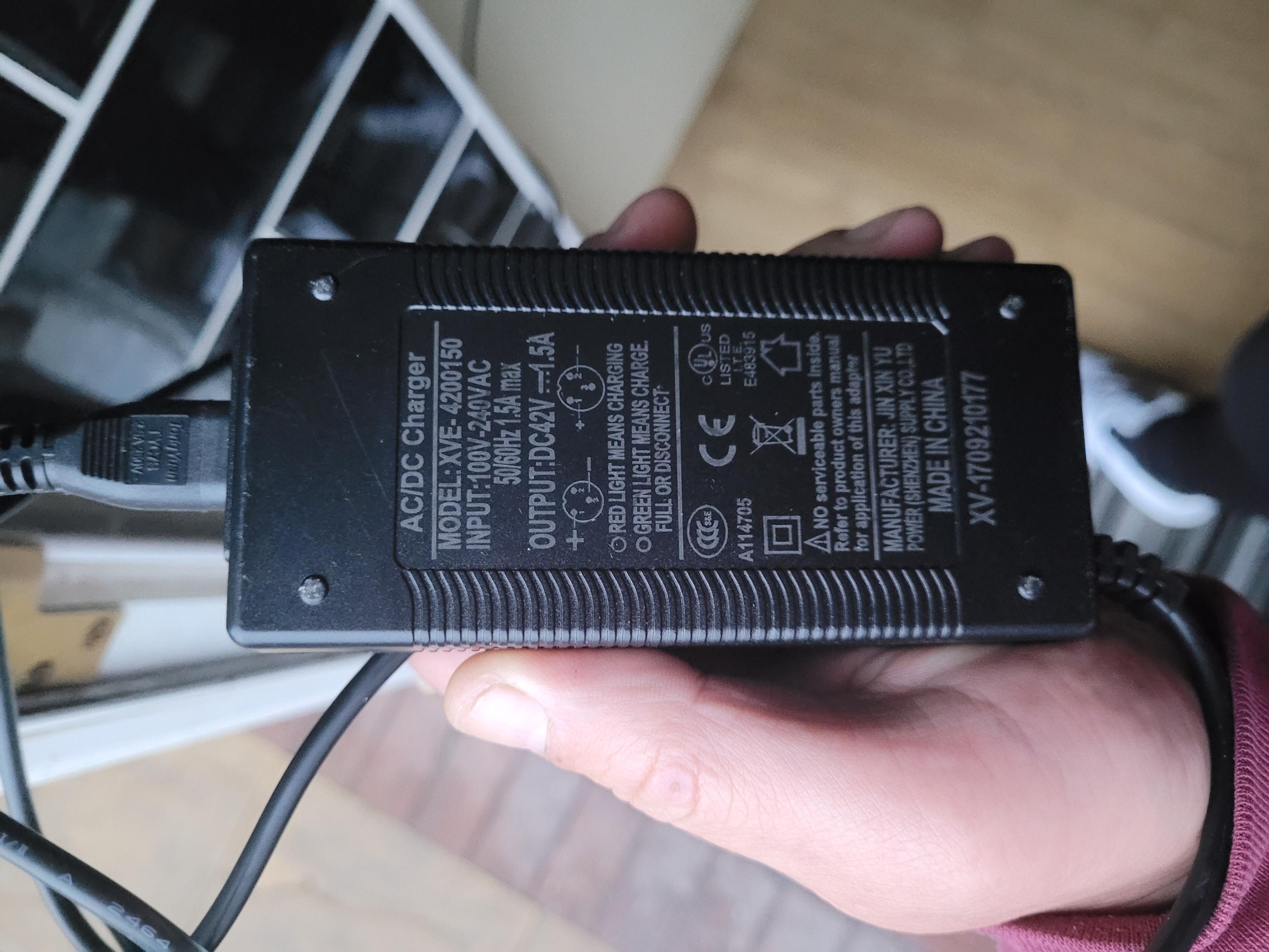

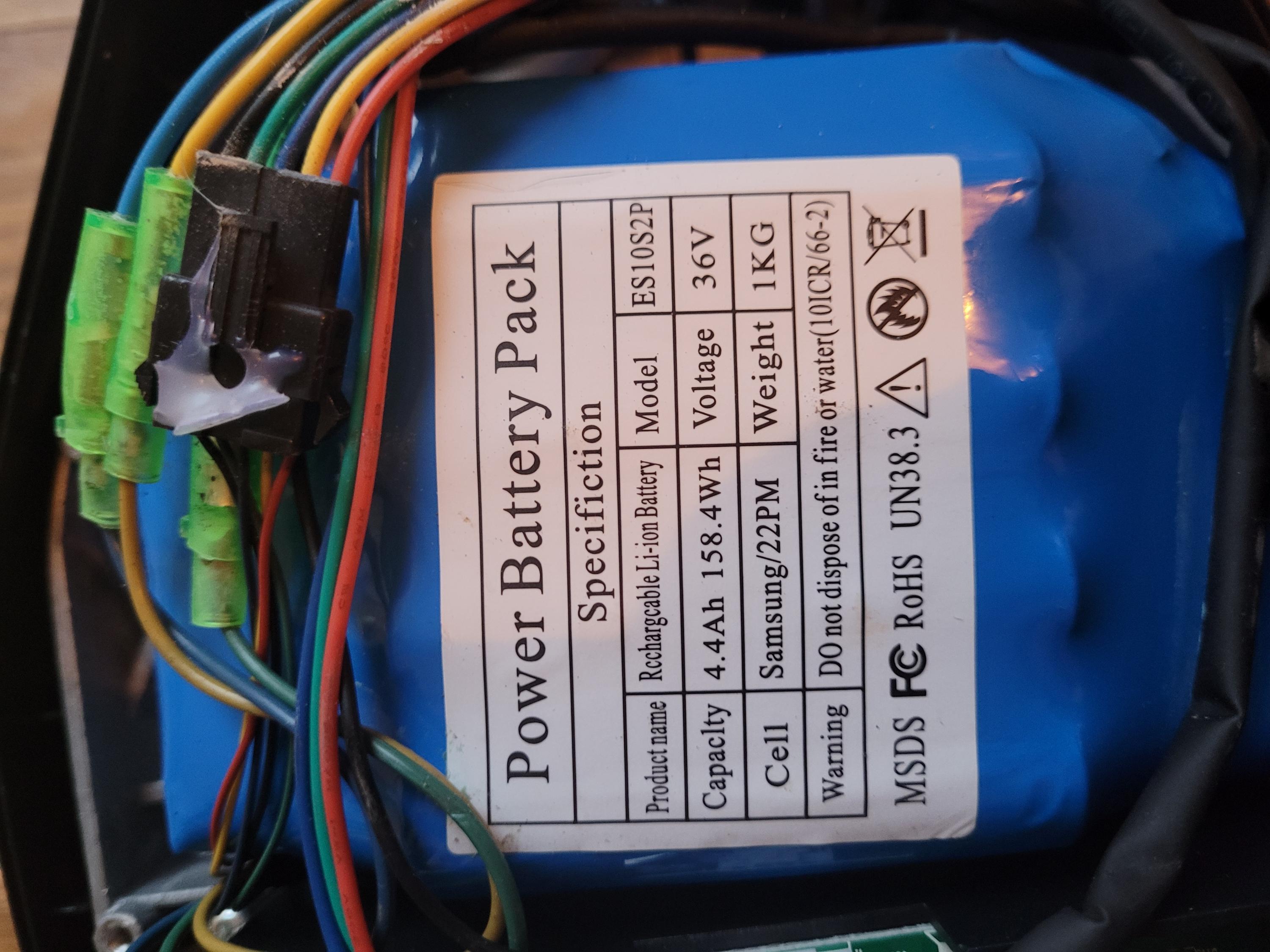

    Sorry if this is a silly question, but my son has a ride on hoverboard.
    It needs a new battery pack (current one fitted shown in pic)
    My question is, can I fit one with a higher Ah rating? As long as it is 36v? And if so how high Ah can I go??
    Would these be any good? £9.61 50%OFF | 100% Original 36v 30Ah lithium battery 10s2p 36v Battery 30000mAh lithium ion pack 42V 30000mah scooter twist car battery
    https://a.aliexpress.com/_EGTafDN
    Picture of charger also included.
    Any help grately appreciated

    Well you need to find out what type of BMS protection board if it is just a protection board or is it a balancing protection board and what appropriate amperage is the BMS board rating
    And what type of batteries they are as well
    You can not get 30 amp hours out of battery pack that small unless it is some special type battery that has high amperage in high density type battery and it going to be a much bigger battery
    18650 batteries are at most are 3.5 amp hour 21700 batteries I am not sure exactly what the highest amps these batteries can be
    So to be 30 amp hours who knows maybe made up
    Here is what I would do is carefully take apart the heat shrink tubing on the battery pack wooden or plastic tools should only be used to avoid shorting out the battery pack and show some pictures of the inside of this battery pack
    I might be able to help you with some replacement options for the BMS protection that is in this battery pack

      I just ended up getting a battery with the same information on as the old one.
      All sorted now thanka
