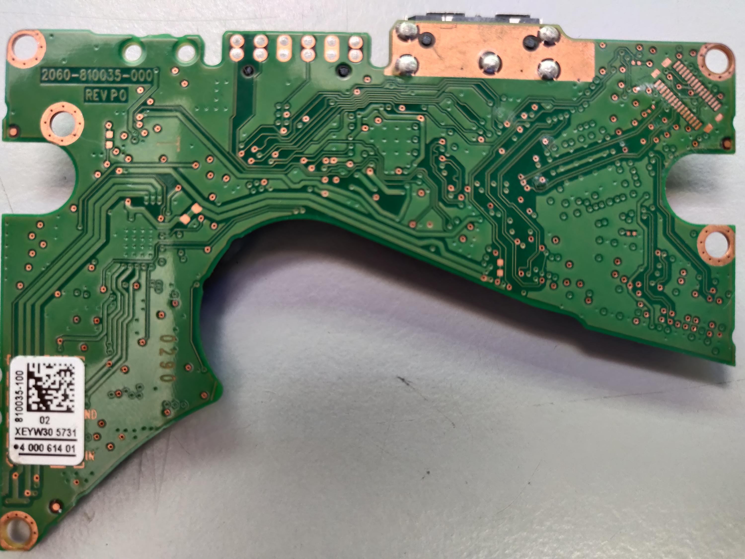

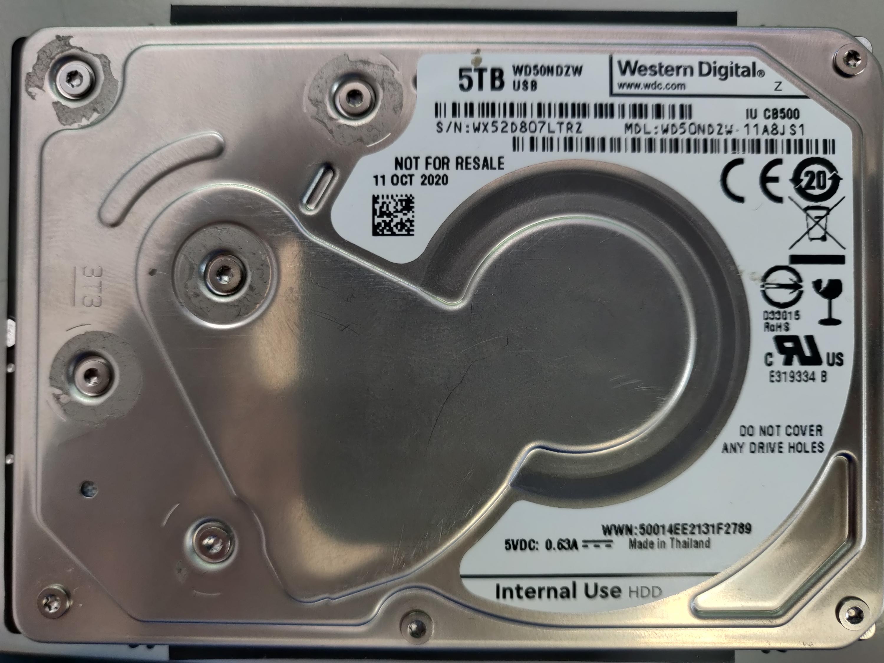

    Hi everyone
    I need help with a Western Digital
    MDL:WD50NDZW-11A8JS1
    S/N: WX52D807LTRZ
    PCB 2060-810035-000 REV P0

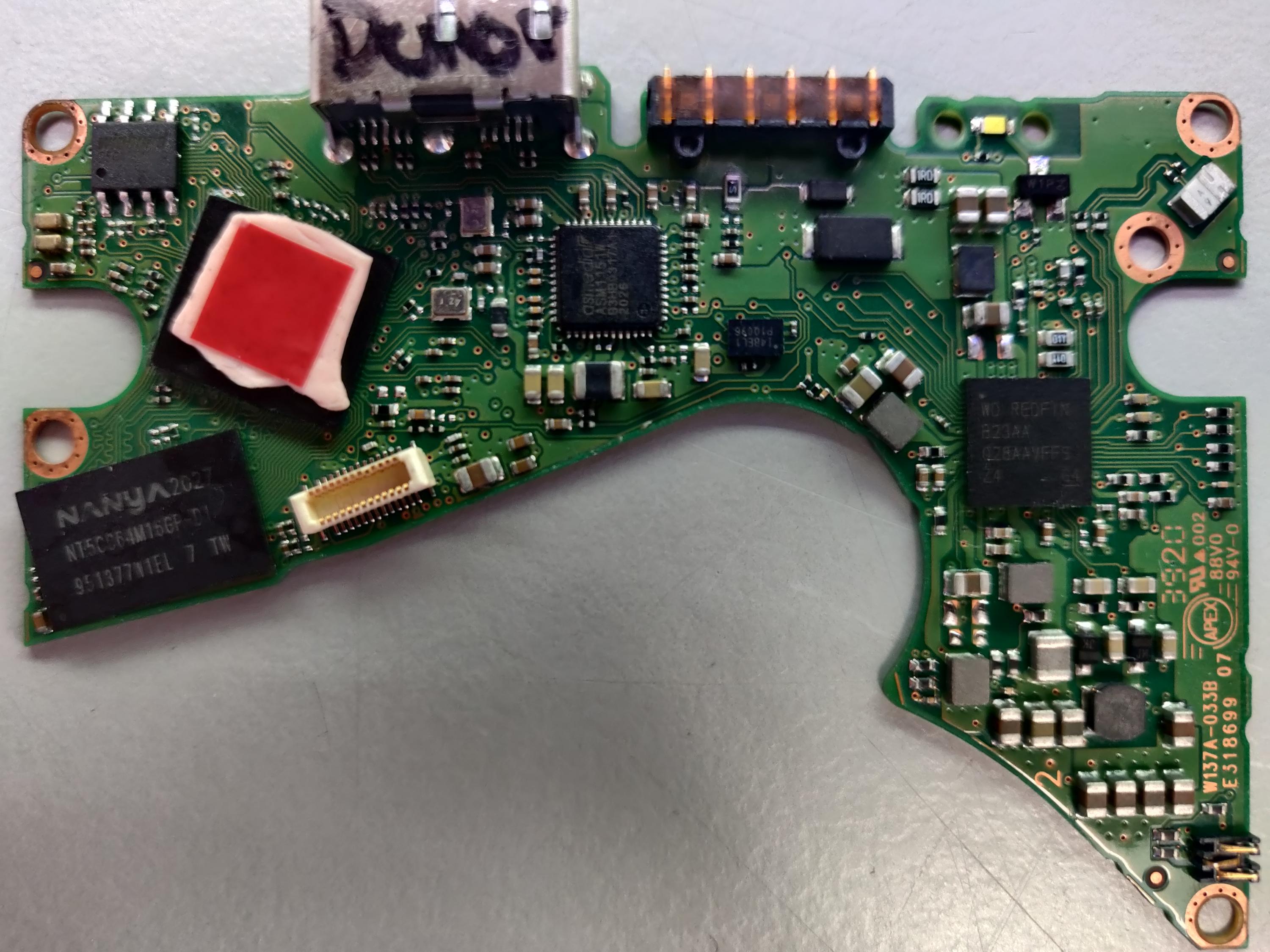

    I need to convert this USB connection to SATA. So looks like I need to solder a SATA connection but I can't find any schematics for this one. Anyone know where to solder the connections to the PCB or the schematics for this?
    • 31250
    Re: PCB USB to SATA
    get a datasheet for the asmedia convertor chip
    then trace the output pins to the resistors or testpads around the controller with the thermal pad on it
