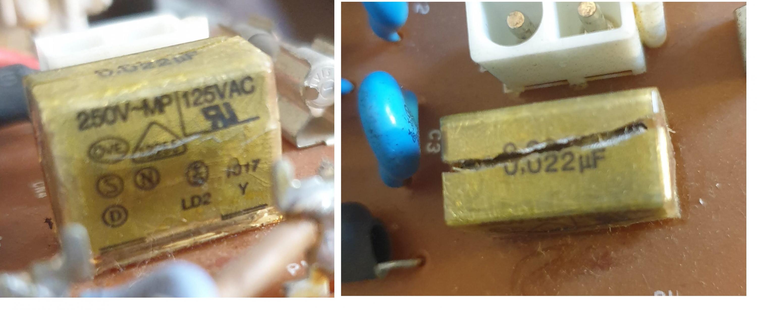

    What is this cracked component please? Thanks in advance.

    Re: Component identification
    looks like a rifa safety capacitor to me
        OP you are lucky it did not arc and make a big black mess. Those Rifa safety capacitors crack and short out with age, causing equipment damage and bonfires. Never use them, I don't know why Kemet keeps selling the PME271 series etc. The paper insulation inside is unique but nothing special.
        Replace it with any other safety cap that fits.
          Thanks Per - is this one "safe"?
                  I'm partial to them since they were actually manufactured in Sweden in the past
                  I would do as redwire said: replace with any safety agency approved X2 capacitor.
                    Is it an X capacitor or a Y capacitor. IIRC, Rifa made a .022uF Y capacitor in the PME271 series.
                      it looks like it's across the feed, but we need more pictures to be sure
