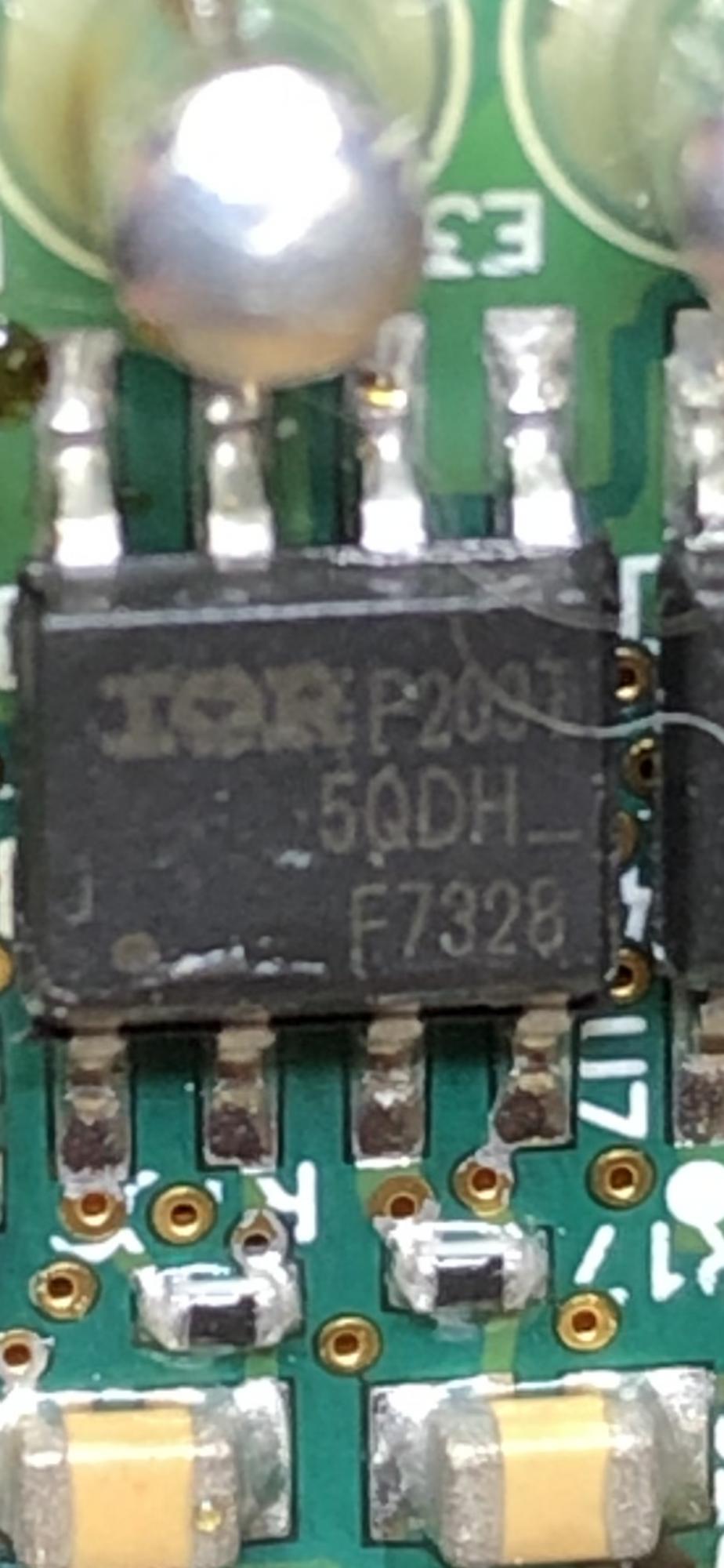

    Hi Folks,
    Having some issues tracking down the spec sheet on the following, and wondering if someone might know what company stamps "IOR" (If I'm reading it correctly) IOR P209T....
    Many thanks.
    • 20596
    Re: Identify Mosfet?
    International rectifier ,owned by infineon. irf7328pbf
      https://cdn.badcaps-static.com/pdfs/...628c324e4d.pdf
      Much appreciated!
