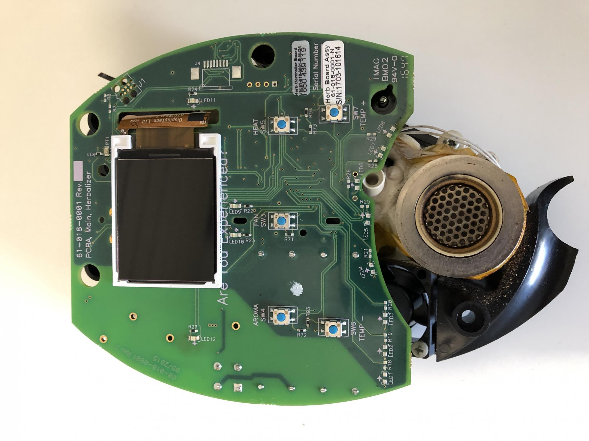

    Friend asked me to check this out for him. Says that the temp doesn’t regulate and just keeps increasing. Confirmed with melting plastic under the heating element.
    Does power on and let’s you adjust the temp etc but just keeps increasing regardless.

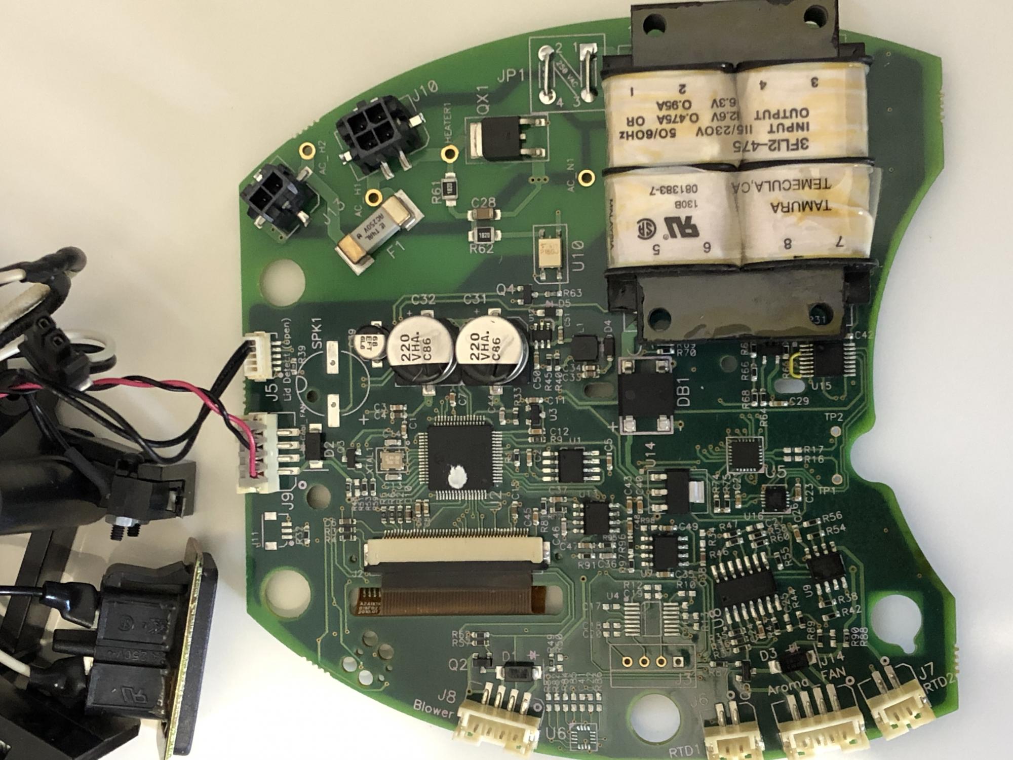

    Right away I noticed the front two legs of triac QX1 204S8E were lifted off the board (barely connected looked like solder maybe desoldered by heat)
    If I measure from T1 to T2 I get 21 Mohms and from T1 to Gate I get .700 kohms. In diode mode from T1 to G I measure .323 both directions. Does that mean it’s good or bad?
    No clue about these, wondering if someone has seen it before and/or could guide me where to look for a possible repair.

    Can't see any damage to the legs of QX1. But since you do have a low resistance between T1 and T2 (21) Ohms on this Triac, I suggest to remove it from the board and check it again. If you still get that low resistance, it's bad.
    It's not uncommon for cheaper devices like that to burn their TRIACs. Sometimes it's due to the TRIAC being undersized for the load, and other times it's just a "random" occurrence. In any case, if it does come down to a replacement, see if you can find a slightly higher rated part. That should hopefully prevent this from happening in the future.
    Also, is there a relay anywhere installed between the heater and the TRIAC? At least I couldn't see on.
    If not, I'd say this is quite poor design, because then the heater can remain on when the TRIAC is shorted, and that can certainly be a fire hazard. On better-designed devices, the relay is simply used for connecting and disconnecting power to the heater, and the TRIAC only does the line voltage/pulse modulation to give variable power output at the heater (and hence temperature regulation.)

        What's it using for the one (or two?) temperature sensors? I assume thermistors. You can measure their resistance and the voltage across J6, J7 when plugged in.
        I would measure voltage at the opto-coupler U10 LED and see if the controller is commanding the heater to be on. Careful mains is on the other side of the opto. That big X-cap can also bite.
        There's very little solder on the JST connectors on the PCB, not enough paste was used on the pcb.
        Everything looks melted so I'm not sure how repairable this is.

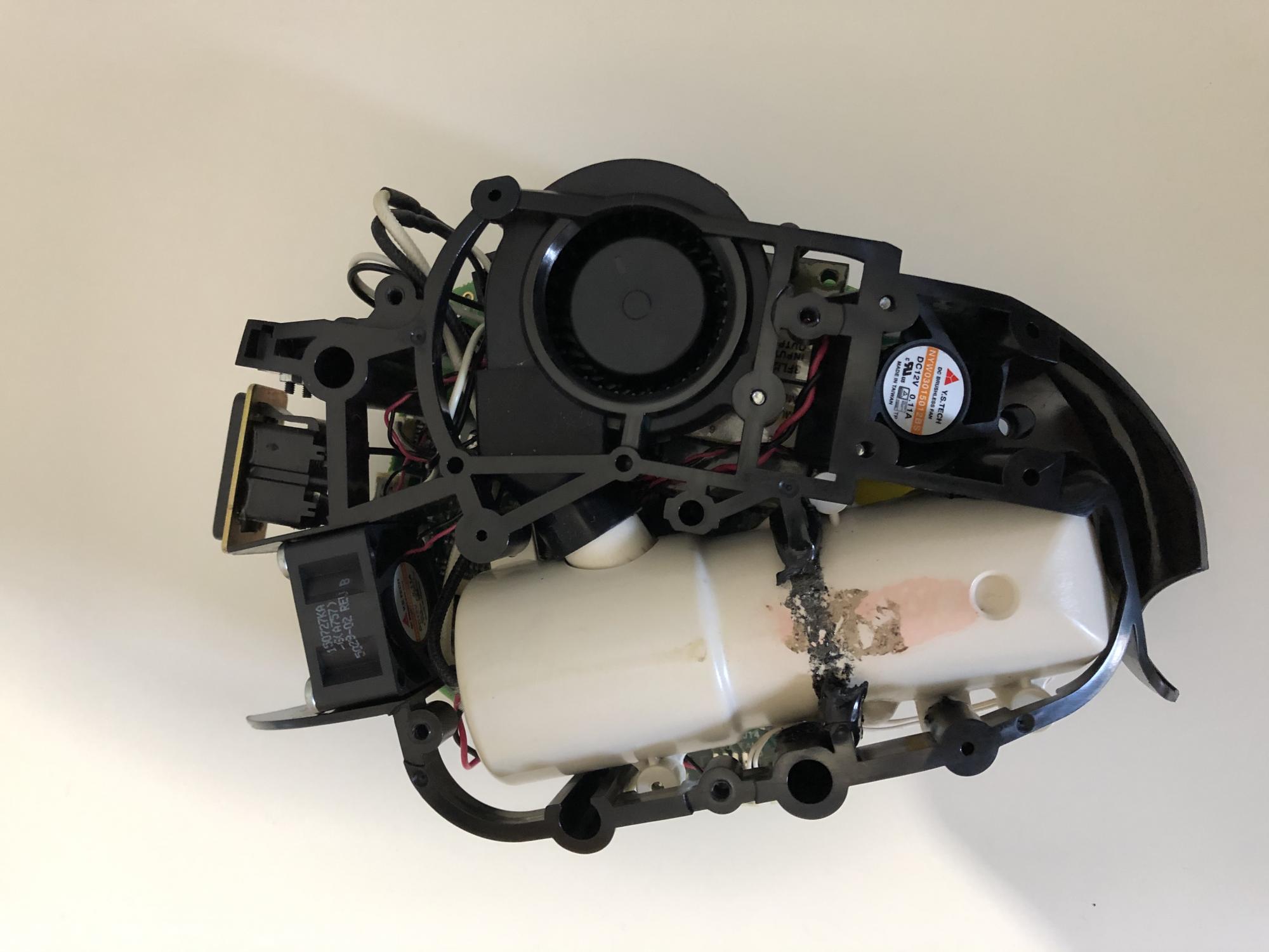

          It gets very hot quick and the plastic starts to smoke. Does the heater need to be plugged in while making these measurements?

                In that case, I suggest to check the Gate drive circuitry directly connected to QX1. So that would be R61, R62, C28, U10, R63, Q4, and whatever other components you trace connecting between U10 and the MCU that drives U10/QX1.

                        While testing some things it almost caught on fire and now the display doesn't work and some plastic under the heater is melted beyond repair. I think for safety reasons I'm abandoning this repair, doesn't seem worth it. My house still smells like burnt plastic.
                        Yes the display would show the set temp but there would be bars showing it's well past that point towards the red region.
