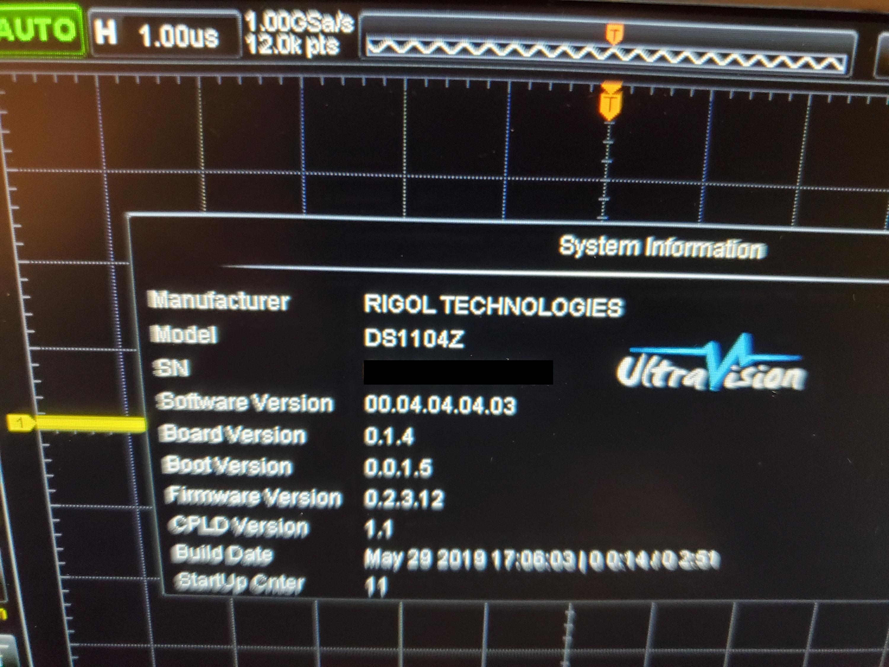

              Re: Oscilloscope Advice....
              well get it on your network.
              here's some stuff from my notes:
              To see the full info you need to press these buttons (fairly quickly or it doesn't work):
              Menu -> Menu -> Force -> Menu -> Utility -> System -> System Info
              Connect to your router by ethernet cable, then select
              Utility>IO Setting>LAN Conf.>Configure> select DHCP, then "Apply" and "Initialize"
              The scope should fetch an IP address from the router and put it in the box in the LXI window. Write down this IP address.
                btw, latest firmware is: v00.04.04.04.03
                  STJ,

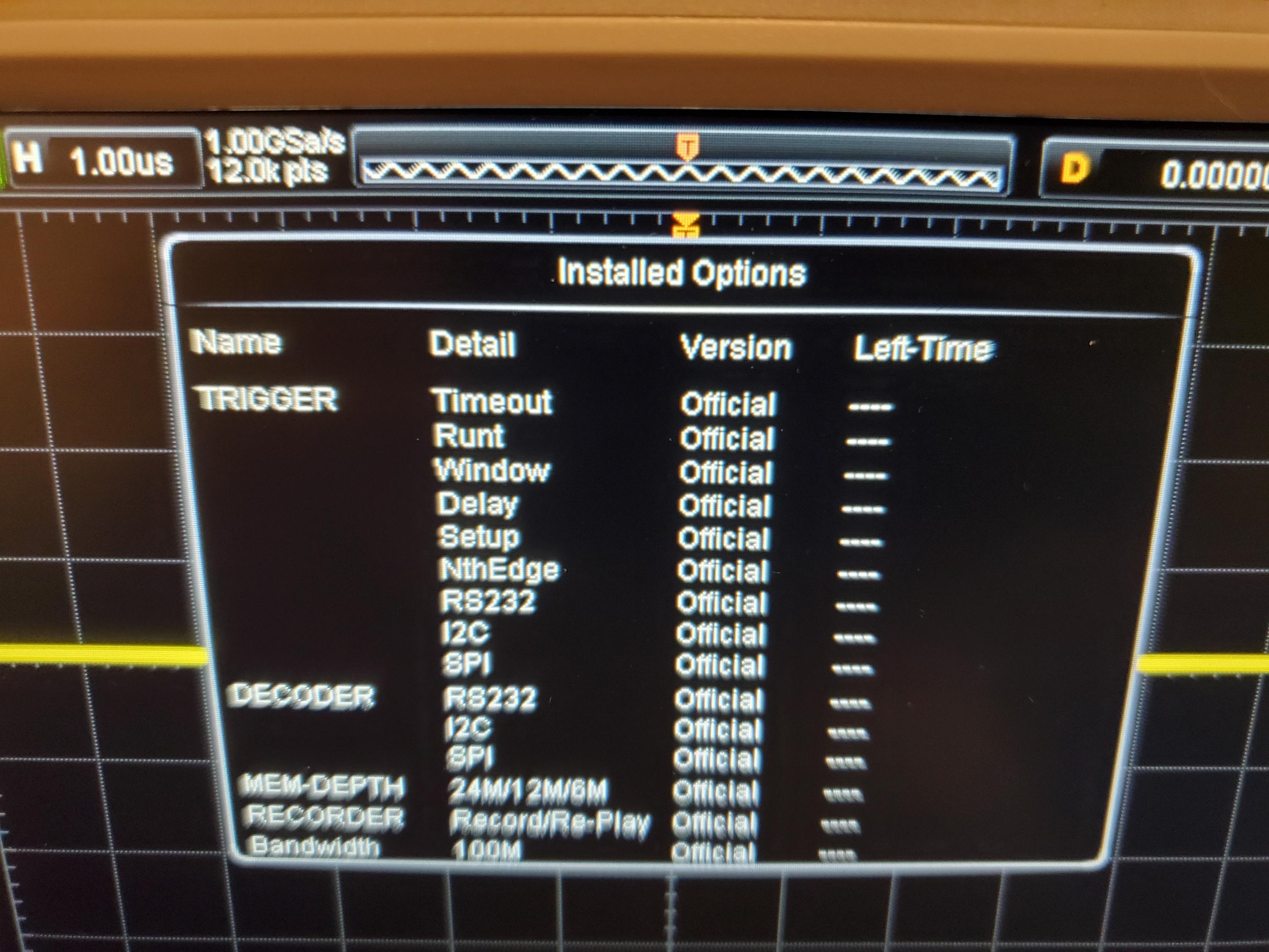

                  So I updated the firmware....From Rigols Site.
                  Had some issue getting telnet to work...not sure if it was my network or not...I am a Adhoc Wireless setup...I have used telnet and ftp daily for almost 5 years in my college years to get code to the proper servers....but I had to tie directly into my router and I am wondering if its limited/secured.
                  Anyways, found a recent youtube video using Google Advance Search.
                  https://www.youtube.com/watch?list=P...le&app=desktop
                  Then used the site to get Key;
                  http://gotroot.ca/rigol/riglol/
                  I had a little issue originally as I left the "...." in the end of my Serial.
                  Used the DSER Option as it seemed suggested everywhere.
                  Then entered the Private Key and below is what I see now....I believe I am all set?
                  Thanks STJ and all for the help with this purchase etc.
                  Chris
                    • 30978
                    #29
                    that's it - your all set now.
