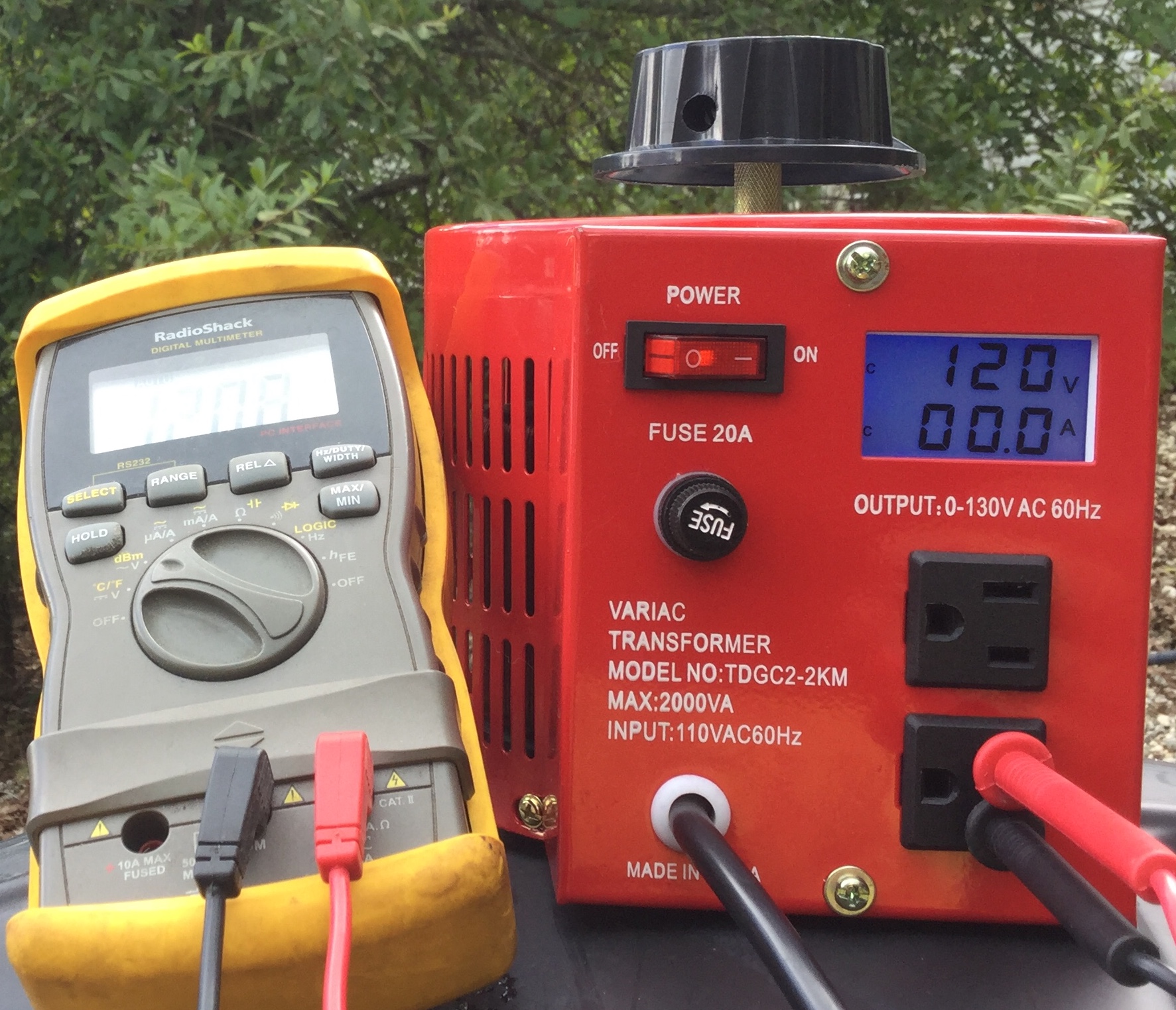

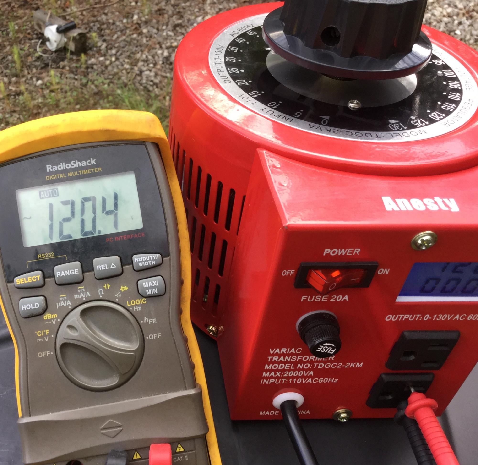

    I've been looking online for a 20amp variac and I see Amazon has them for about $100 and Ebay has them for about $70. They all look the same but I'm wondering if there is any real difference between them? They all list brand names that are odd like vevor and others. Any advice would be appreciated. Thanks.
    • Jul 2011
    • 6070

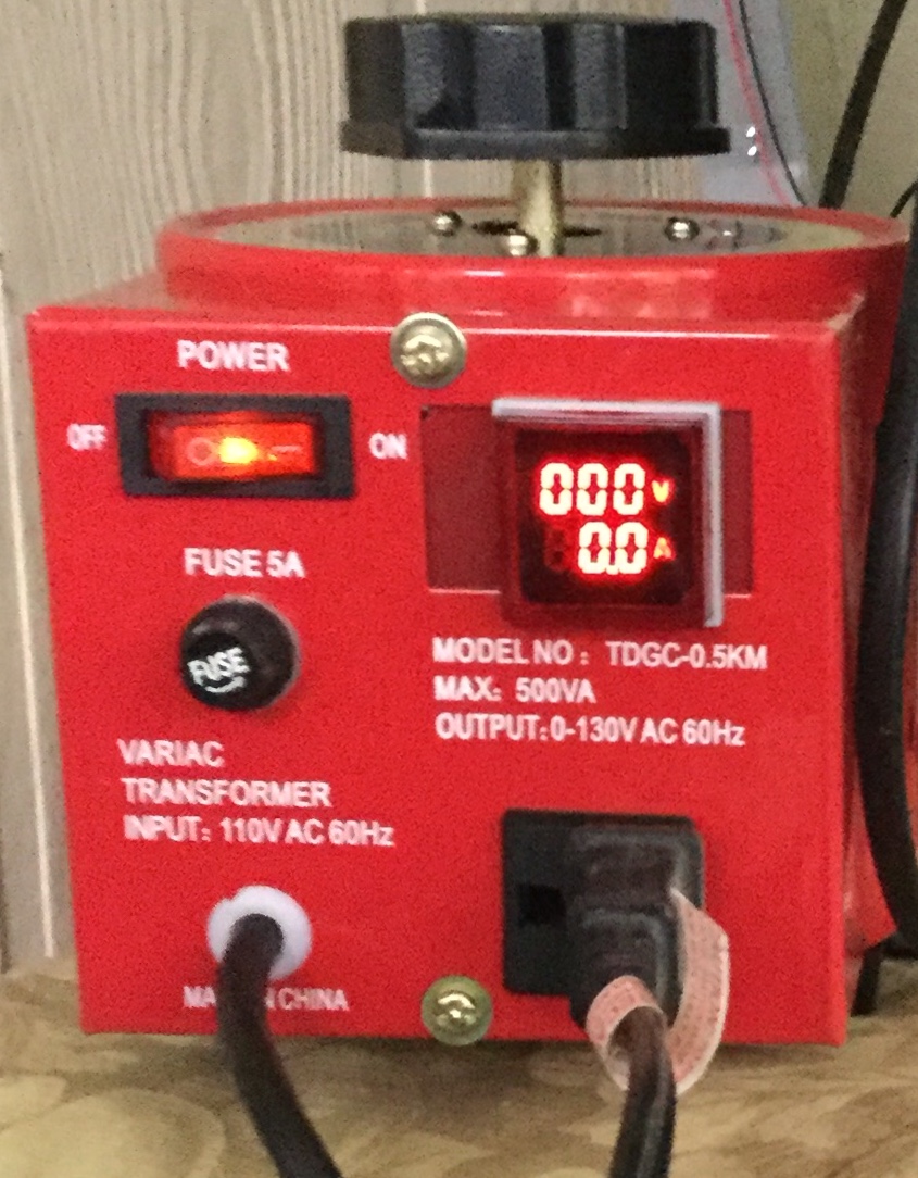

    Re: Variac 20 amp advice?
    No there is no real difference in the ones that have a red outer case
    The voltage meters are crap but you can do a modification to it and have a very good setup the meter that fit it also needs a modification for it be very useful
    If you buy one and you want to do a modification to meter just let me know and will find the post where I did the modification to it and what type of meter that will fit
    When I have some money to spend I going to this same setup on a 5 amp version of to be able to power LED strips to figure out what voltage the strips are ( wish list )

                I fitted mine with a self-powered digital AC voltmeter which starts to display at 60V and above - any AC product would typically not work at such a low voltage.

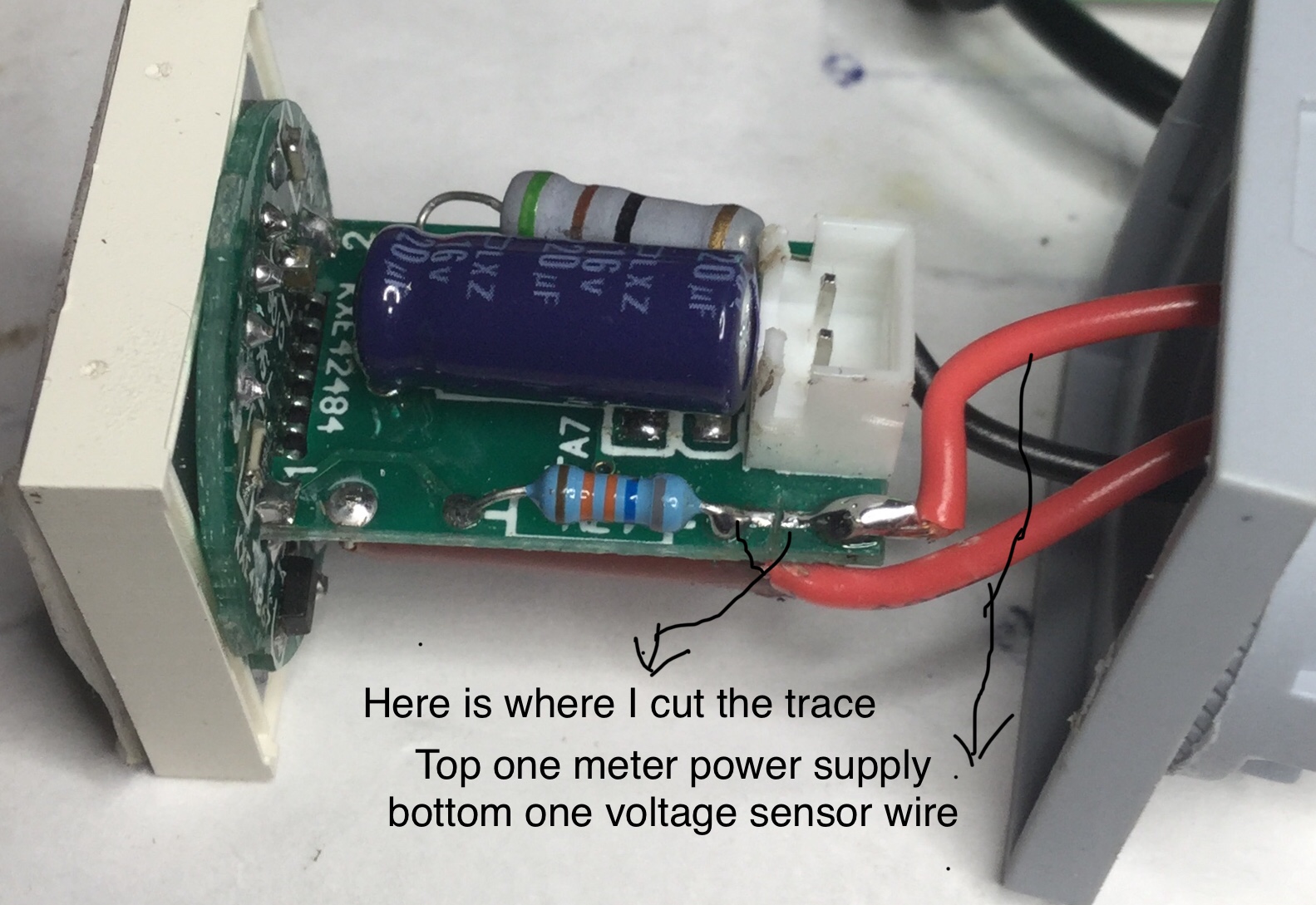

                  When you do the modification that I am talking about you can read the voltage down 1.0 volts
                  The reason they can not read voltage down that low has do with the voltage divider to read voltage
                  You also have voltage reducer for the meter controller
                  In order for you to read voltage down that low you need to separate the meter power supply from the meter reading voltage divider circuit when you do this then the meter can read voltages that low
                  The meter that I have a link to can easily done you just have to —>
                  ( remove one diode )
                  or
                  ( cut the trace where this diode connects to the voltage input terminal block *** you have remove the top board of the meter controller in order to cut the trace you can also recap the board while you have it separated ***)
                  —> reroute the meter voltage divider circuit and hook it up to the outlet on the Variac
                  The meter power supply is hook to ON / OFF switch which now the meter is not powered by output of the Variac supply
                  One note
                  You do need to have a meter that can read its own power supply in order for this to work
                  Line / Netural you breaking the line side of the meter power supply / meter voltage divider circuit

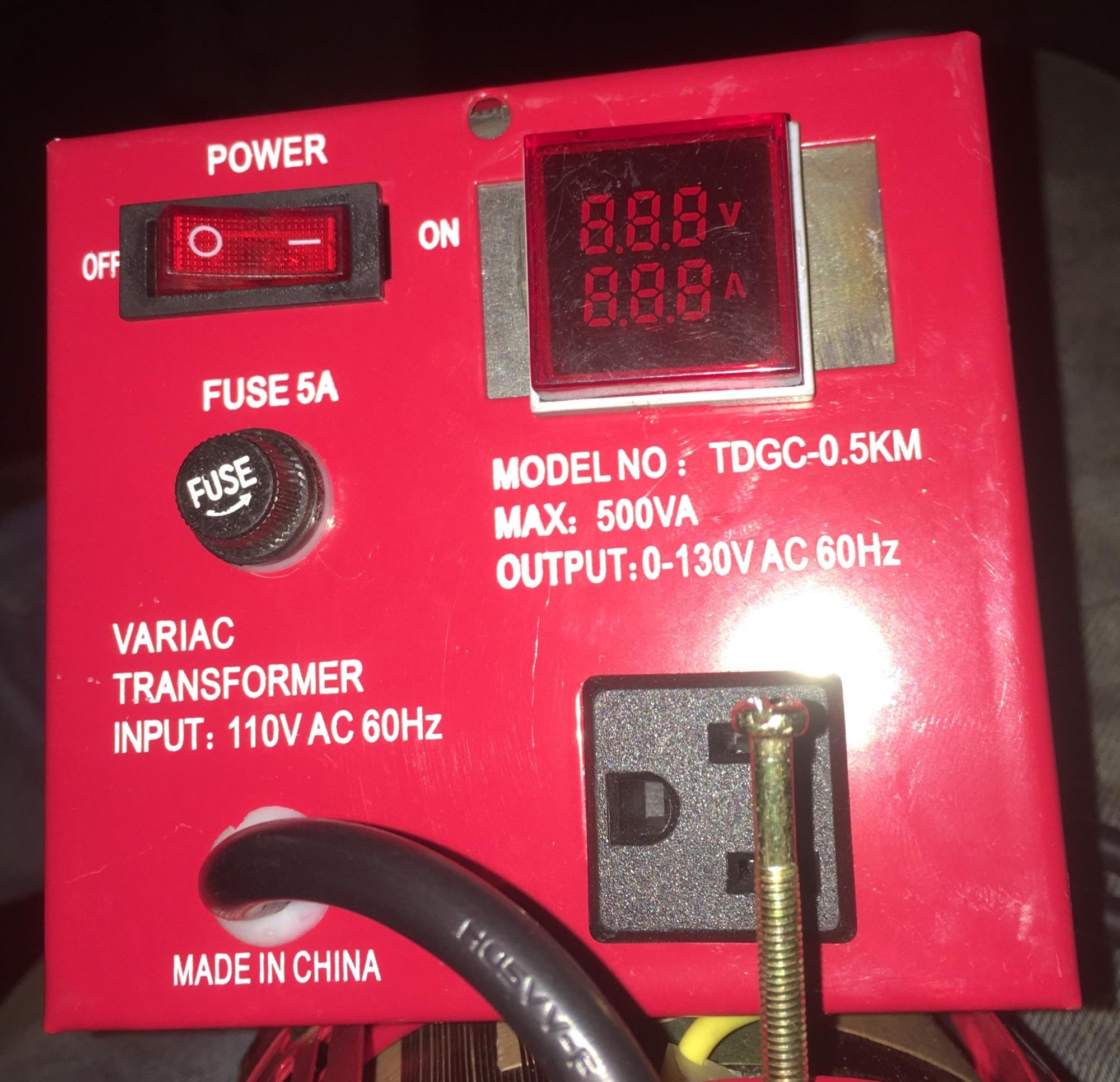

                    Here is where I got the meter for the 5 amp version that I bought the one that I used in the 20 amp version would not fit in the same space
                    POWER GRID volt & amp monitoring GAUGE - Digital ampmeter / voltmeter combo 2in1
                    https://www.ebay.com/itm/POWER-GRID-...53.m2749.l2649
                    I will in next few days I show how I modified this meter module this was so easy to do
                    The modification to this board —> it shows where the 5 volt section for powering the meter so it can read down to ( [0] volts )
                    The modification is not finished and that is why I not showing it yet

                          For my variac project, I took apart that mini voltmeter and brought out the Vsense wire, so it's three wires now. It's powered off the input mains but measures the variac output, so I can dial down to a few volts AC. No <60VAC dropout of the voltmeter.

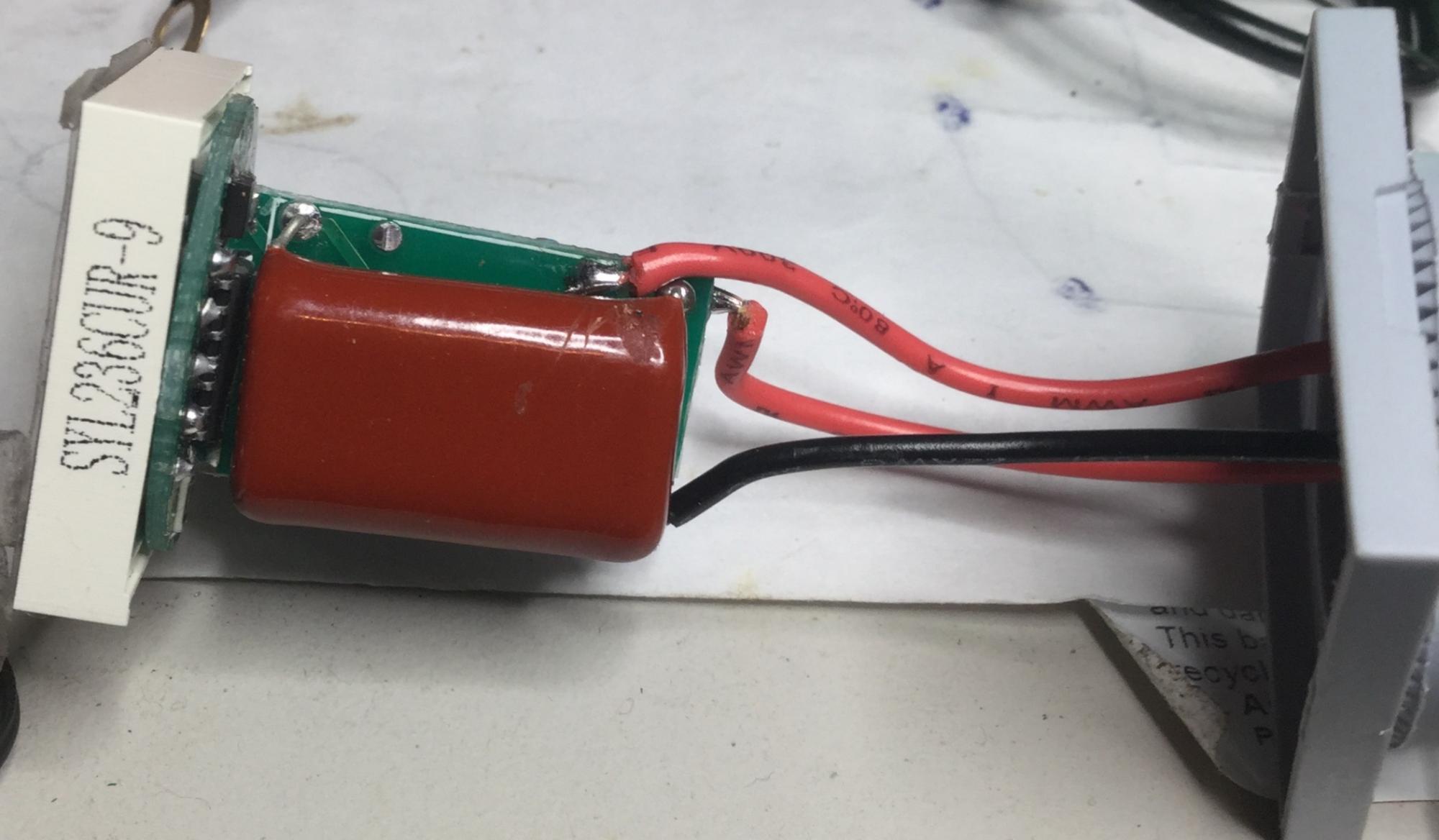

                            Here is the modification on this meter module that I was talking about
                            In the photo I show where I cut the trace so it can measure down to ( 0 ) volts
                            I replaced the only capacitor that is in this unit
                            It had a 330uf@16 volt capacitor but the same valve capacitor was to fat to fit in there that I had on hand so I use a 220uf@16 volt capacitor instead and seems to work okay with it
                              • Jul 2011
                              • 6070
                              One note about this modification is that you have to cut the trace on both sides of board in the same position which I forgot to mention
                                • 31281
                                you should create a bigger gap too.
                                specially people in europe with 230v - maybe even cut a slot in the pcb.
                                  • Jul 2011
                                  • 6070
                                  You are probably right about this however there is not really a lot of trace to work with if you are putting wires to the board
                                  I did cut a deep slot in board on both sides

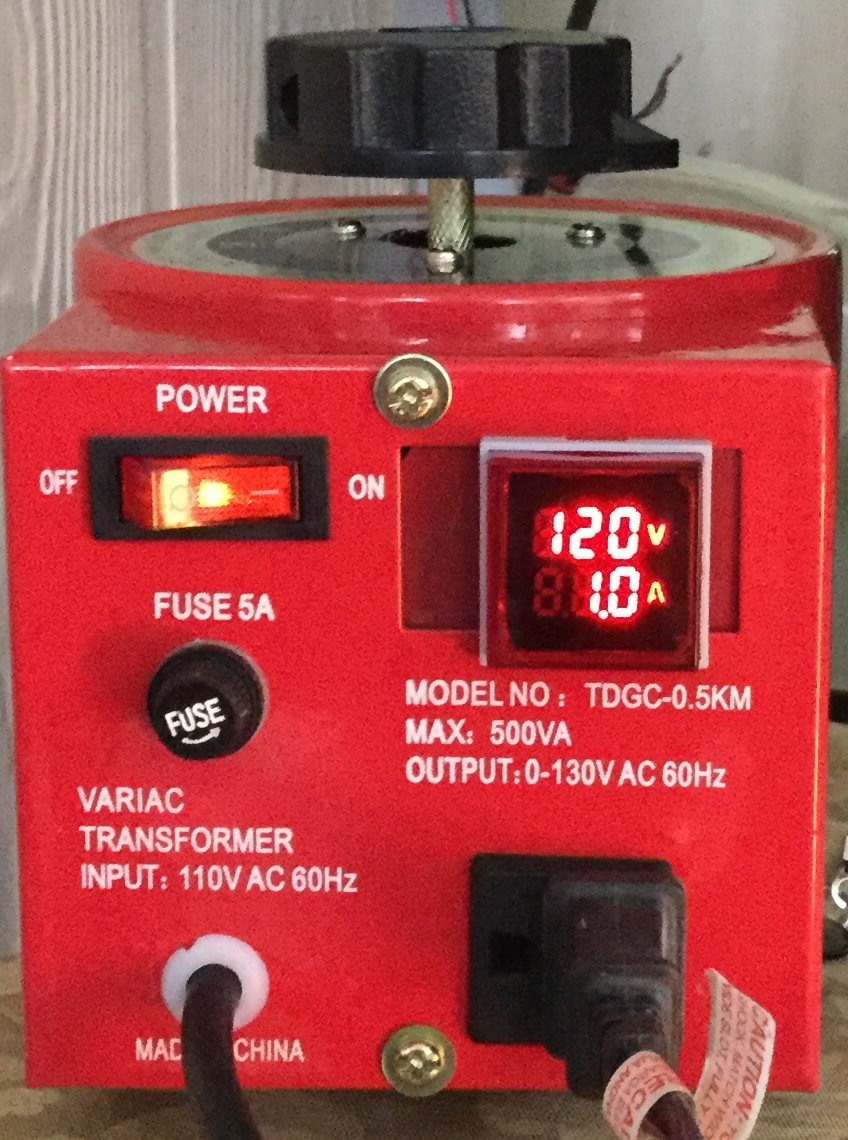

                                    Here is a picture of the meter installed I just have to cut one corner off of the metal plate so the bolt at the top will work to put back on the cover
                                      • Jul 2011
                                      • 6070
                                      Here is the finished project here are some pictures of it
                                        • Jul 2011
                                        • 6070
                                        I used this for the first time on an old style rectifier module which I found out was working correctly
