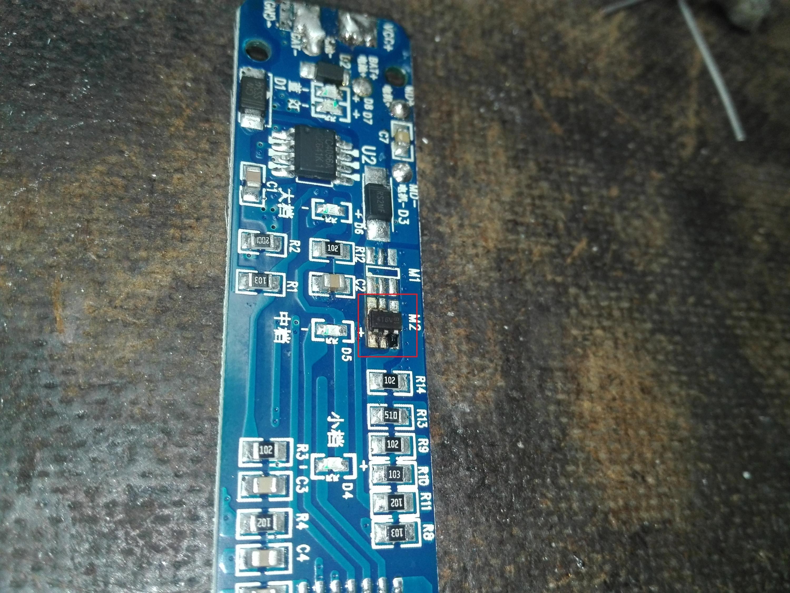

    i hope someone can help me with this component found on my mouth hydrocleaner. it's china style gadget and coulnd't find what this IC is..
    Device is working with a lithium battery 3.7v and can be charged with usb 5v.
    any hint is really appreciated..

    It might be a dual mosfet like a Alpha & Omega AO6402A
      Re: help indentifying component please
      It might be a single mosfet, are pins 1,2,5,6 connected together?
      Is that number 4T6V ? is there a dash above the V ?

        hi, thanks for your answer
        YES 1,2,5,6 are connected together on the pcb.
        YES i read 4T6V but coulnd'nt find nothing with this code.
        NO, i can't see any dash above the V.. but on the side there is what seems "1B"

          AFAIK AO6402A single N-channel
          Seem AO6424A:
            That should be the one, AO6424A, What seems to be wrong with it?

                mosfet does not switch on when 3v are applied to gate. so i have no ground to my motor.

                  Mostly 99% work on laptop repair, from there i knowing alpha omega's mosfet. Also have several time see mark with "dash" and number/letter with orientation anticlockwise 90 degree on the end body package. BUT totally newbie at all, that's way reading many threads for learn.
