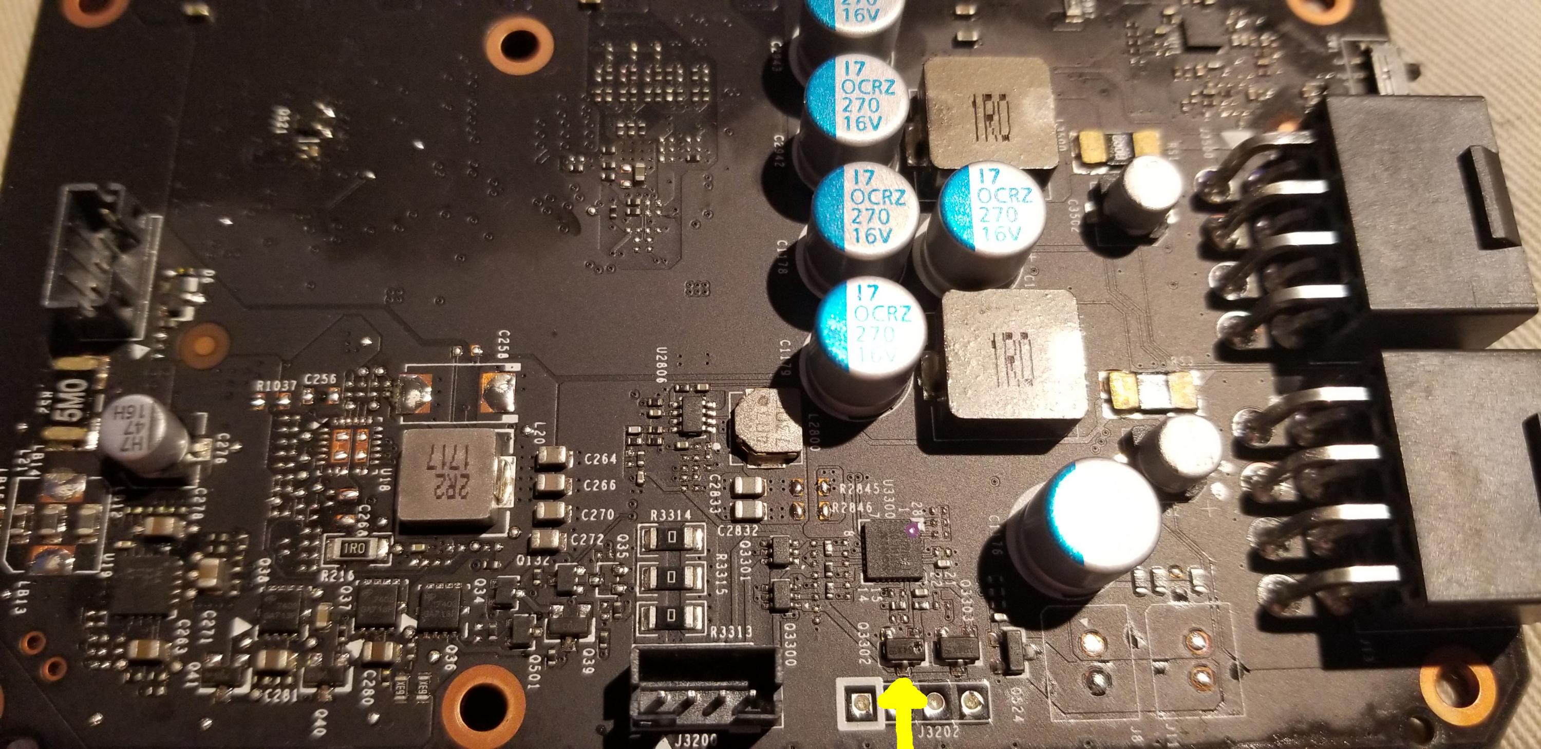

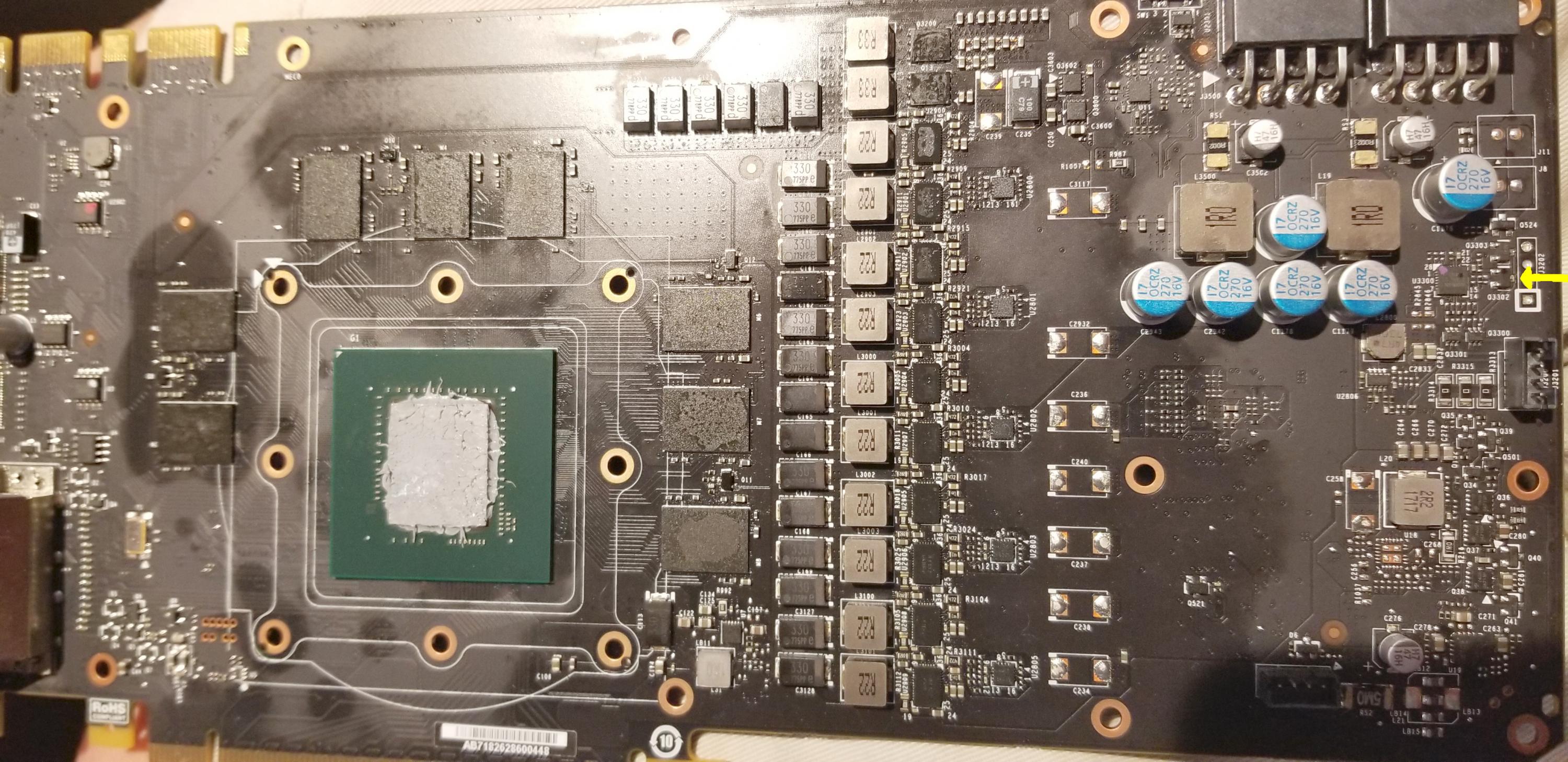

    Hello, I am repairing an EVGA 1080 that appears to run fine with the stadard VGA drivers in windows 10 but when you load the Nvidia drivers there are artifacts.

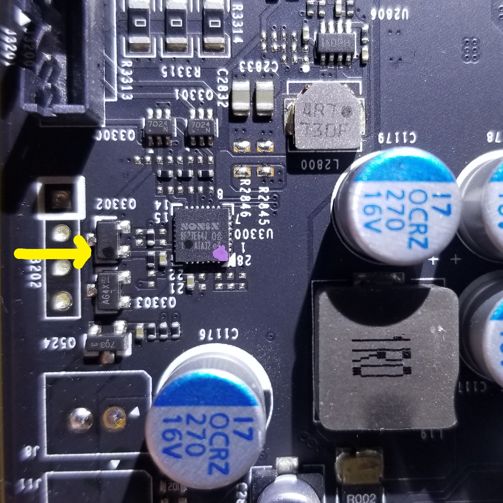

    I think I have narrowed the problem down to a component that is located at Q3302 (There are a # of schematics here https://www.gadget-manual.com/nvidia-geforce/ for similar 1080's but not specifically the EVGA ones)
    But everyone I've asked is not 100% certain what the part in question is located at Q3302 and is marked with "AG4X"
    So I am including some photos.
    I have possibly narrowed it down to 1 of two components the BCX70G or the AO3416 but I am not 100% sure so any help with this would be appreciated!
