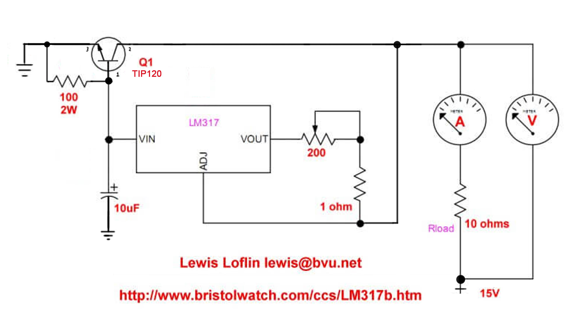

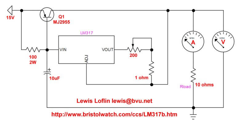

    I wanted to build this circuit:

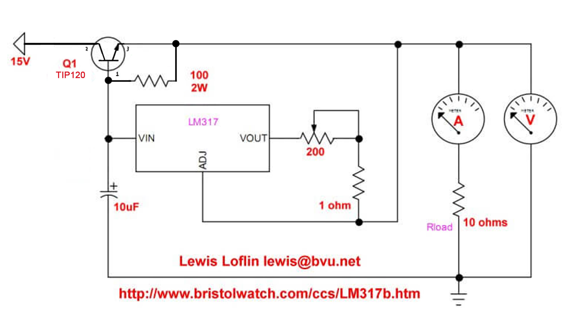

    But I didn't have a high power PNP transistor. What I do have is a TIP 120 darlington NPN, so I re did the schematic to look like this:
    thinking it should work, but I get nothing when I build the circuit.
    Did I do this right? Or did I make a mistake?

    Re: Replacing a PNO with NPN
    I also tried it this way and still no love:
      The conjugate of the original circuit is to have VIN of the LM317 hooked up to collector and the CC-wired LM317 output hooked up to the base. If you had a regular NPN it should work as-is, minus the temperature sensitivity as it depends on the characteristics of the transistor. So the circuit in #2 should work except you need to flip the LM317 subcircuit...
      However you will have to seriously modify the CC LM317's current sourcing capability to deal with the gain of the TIP120. Only took a quick look at the circuit but I suspect you will need to multiply the 200 ohm and 1 ohm resistors by around 80-100 or so (gain of the first transistor), and there is risk for oscillation due to the gain. Can you do it without using a LM317 in CC mode by using the standard current mirror circuit? The LM317 or some other voltage reference is still needed. There was a thread about this somewhere on BCN, I should have bookmarked it.
          what are trying to do ? its just these are test circuits initially .
          I think the intent is to create a constant current source of current greater than the capability of the LM317. The LM317 provides a constant base current, so the resulting output constant current will be (β)(Ib). A Darlington complicates that because it is two transistors, so the current will be (β1)(β2)(Ib).

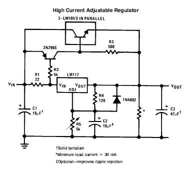

                  You can get an NPN power transistor for the booster to work.
                  But you still need a PNP to sense when the LM317 needs help. The circuit has about a minimum 30mA output.
                  The configuration is called a compound Darlington or Sziklai named after the Hungarian EE inventor.
                    Have to be careful when applying a darlington/sziklai pair in a position previously occupied by a simple transistor, you can see the base drive is 5KΩ which significantly reduces base current flow to offset the gain. (Note that this sample circuit is running in CV mode, so you'll have to adapt to CC.)
                    But if you have a darlington TIP120 PLUS szilkai pair up another PNP, you'll get even more gain....
                    Is the description of the modifications I suggested to make post 2 work clear, or do you need a drawing?
