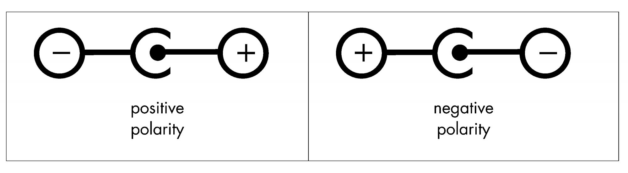

                                    Re: Center Pin Polarity Check?
                                    The polarity is usually printed on the label or engraved in the plastic near the dc jack
                                    you should see a logo similar to this near the connector:
                                    majority of connectors these days have the negative on the outside and positive in the center. In older machines, sometimes the positive was on the outside because this was made it easier to disconnect internal batteries when the adapter was plugged in ...
                                    in your particular case, I'm not sure that universal adapter would be suitable. The thing uses D batteries, which are designed to be able to output a significant amount of current, more than what regular AA batteries can provide. So either the machine used D batteries for very long life (unlikely) or the machine really does require that 2A of current (or gets close to that ammount)
                                    So your 1.3A max adapter may not be enough to run the machine properly - at some points, if the machine pulls more than 1.3A , the adapter may reset or turn itself off, or the voltage could drop below some threshold.
                                    On the other hand, you have 4 D batteries, and this means the product has to account for batteries going low... new batteries would be 1.5v..1.65v for alkaline batteries while empty batteries would probably go down to around 1.35v..1.4v ... so the product may actually work with around 4 x 1.3v.. 1.35v = 5.2v .. 5.5v
                                    if your choice isn't good enough, you should test with a usb charger designed for max 2a, it may be able to power your machine even if the voltage is less than 6v
                                      That would certainly make it brain dead simple, but there is no such diagram to be found. That's why I'm asking how to test the polarity without that diagram to guide me.
