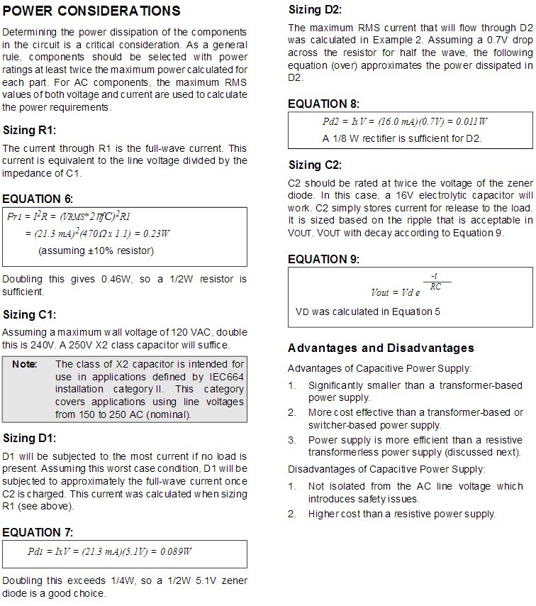

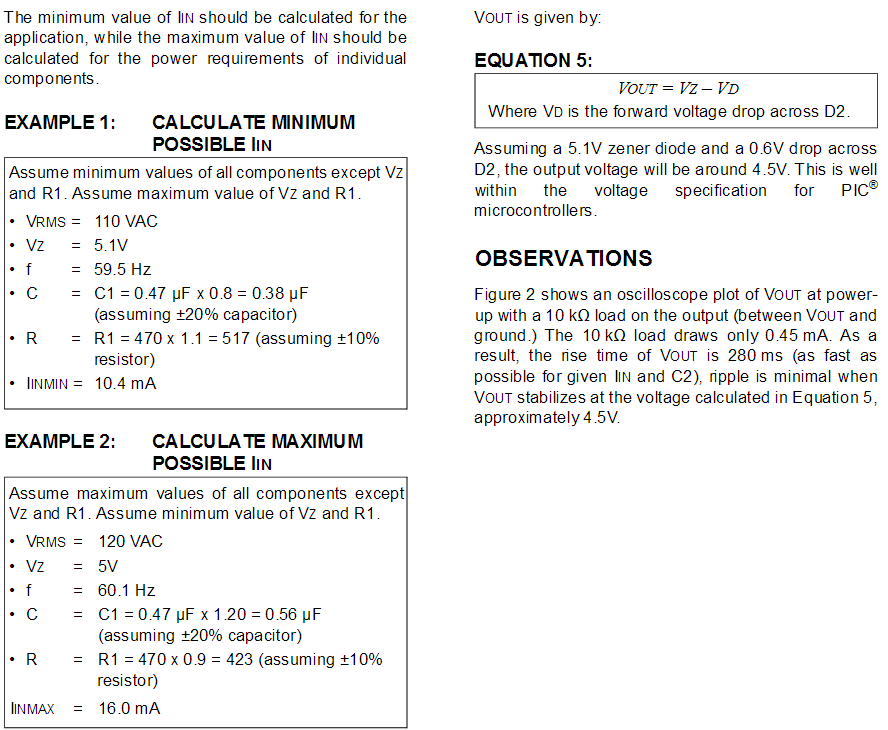

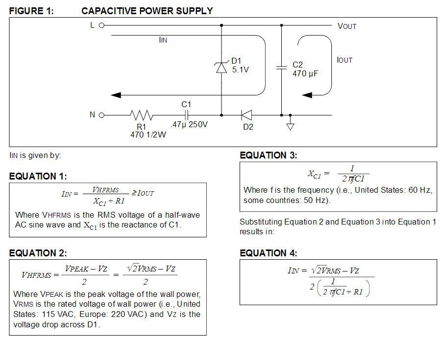

            • mariushm
              • May 2011
              • 3799
              Re: Capacitive dropper question
              0.1 A is 100 mA
              Fans need slightly more current when they turn on and then they can work with lower current.
              For all the formulas you need, you can read AN954 Transformerless Power Supplies: Resistive and Capacitive : https://cdn.badcaps-static.com/pdfs/...5df14516be.pdf
              If you're too lazy to read the pdf:
              Keep in mind that those cheap 50w leds from China will have a forward voltage that will vary quite a bit with temperature.
              You should use a current limited power supply to figure out at what voltage the led uses about 45w (or whatever the led is actually capable of outputting, minus around 5%) and aim for that voltage with your power supply.
              For example, the led may have a forward voltage of 40v at 50w (1.25A) but once it gets to normal high temperature of let's say 60c, its forward voltage could drop to 38v and now you're pushing ~ 1.32A through the leds and you could damage it.
              So it would make sense to set the voltage to around 38v and configure the peak current to around 1.25A and initially the led would be dimmer but within minutes as the led heats up it will reach the full brightness.
                        I went over this before, but by my calculations based on this formula, the value of the resistor before the zener (assuming the voltage of the dropper is 15v) should be about 13ohms, as follows: Vs-Vz is 15-12 = 3 so we get that out of the way. Iz is what always puzzles me, as I don't know what it should be: the maximum current allowed by the diode, or the minimum one required to keep the diode conducting ? What I did was go to the datasheet for the 1n4742a and choose the 20mA used for the "test current", as the datasheet calls it. So on the bottom side of the fraction we now get 0.02+0.2 (assuming the fan requires 200mA during startup so we have some headroom). That gives me 3 divided by 0.22 = 13.63, so let's just say 13ohms...damn...should open up a series like "monday math with Danny"
