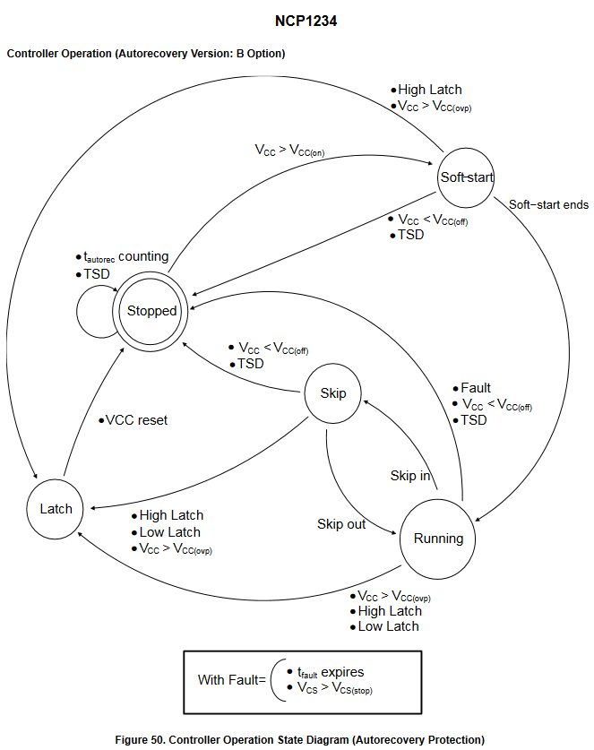

          The series lightbulb trick works for me if only if you have a primary-side dead short. For other problems, I have damaged gear using it.
          100W lamp measures 10ohms so 12A inrush current and anything in between down to the 0.83A hot after 500msec or so. Lightbulb does limit current but how much you can't really tell and it's sluggish with negative resistance too.
          Lightbulb trick can also make a mess for troubleshooting.
          SMPS IC's have a complex state-machine in them. Example NCP1234 which gets lost in soft-start, undervoltage lockout and over-current cycles when you have a lightbulb in series.
          For better current-limiting, I'm going to make an electronic circuit-breaker like capwizard's post - a small CT and op-amp/comparator, and maybe add in a ground-fault CT- although that is a useless feature with an isolation transformer which is a second need for bench work.
