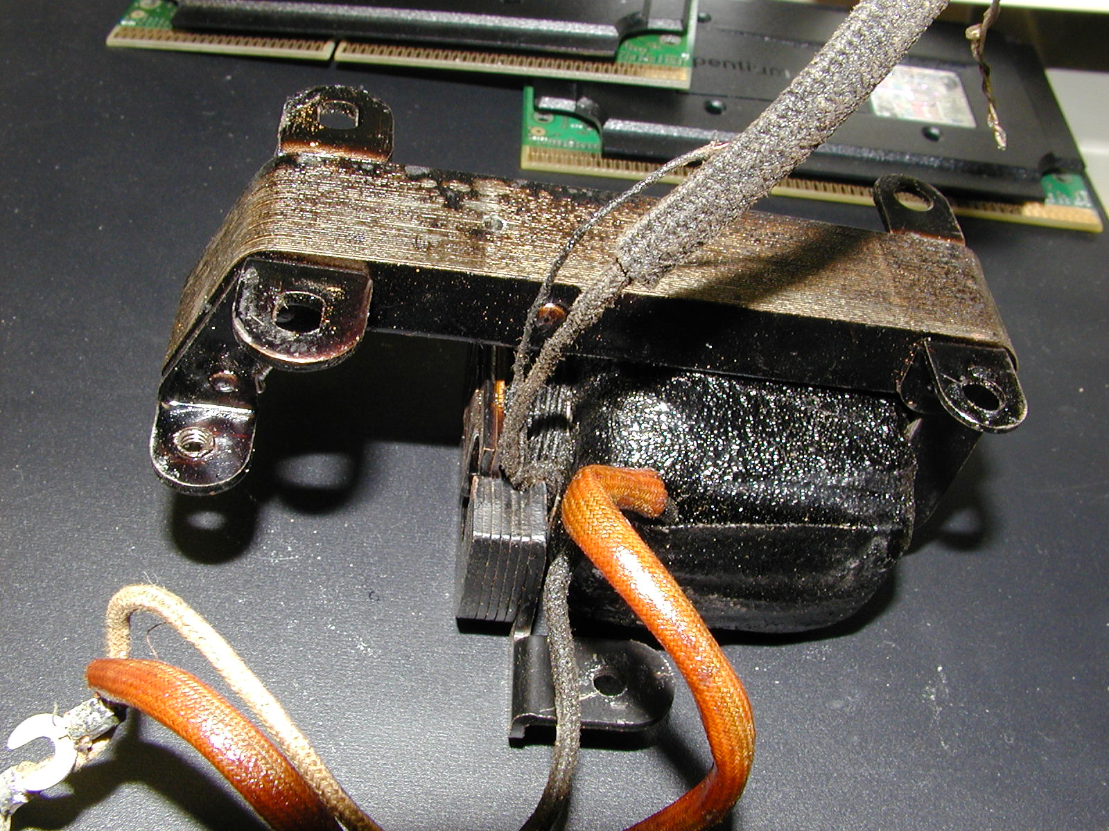

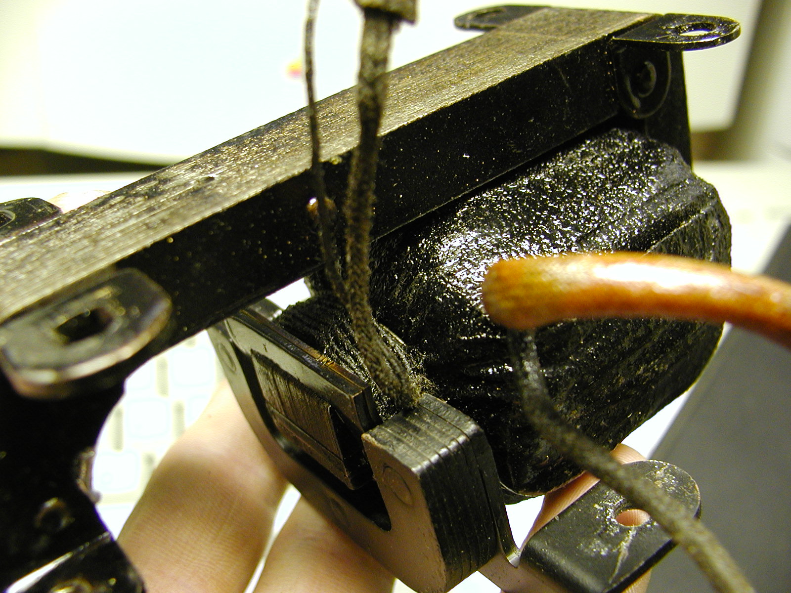

                  Okay, I have gone and disassembled the meter and I have found out where that random wire goes to.
                  It turns out that along with the main top coil there is also a much smaller coil underneath it. I have no clue what it was used for. (see the attached photos)
                  Are we positive there is no way to isolate the two circuits and still let the meter run? Would diodes work? Anything?
