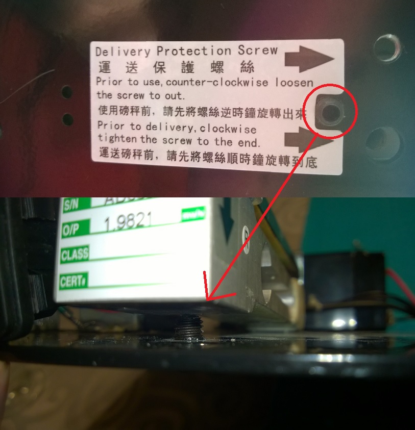

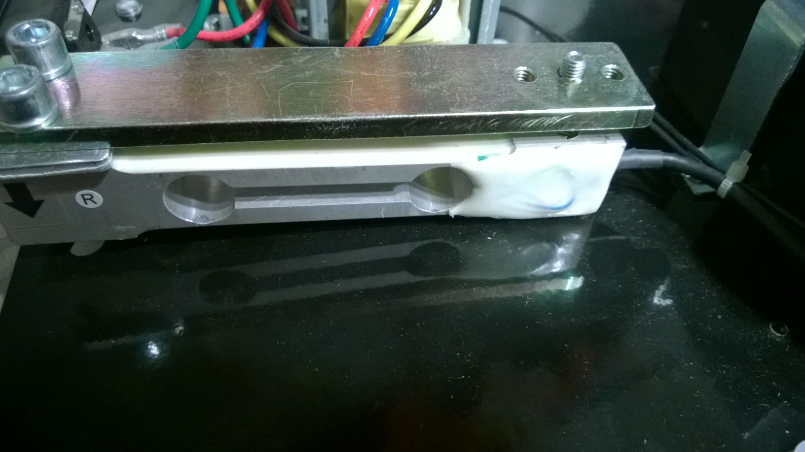

    The main problem is that the plate is very crooked and I cannot understand why.
    It also displays an error when powered up:
    Initial zero point over ±10% (take 10% as the benchmark)
    Check and remove any objectfrom weighing pan or malfunction of LOAD CELL
    I believe this is caused by the crooked plate.
    Some pictures from the insides as attachments.

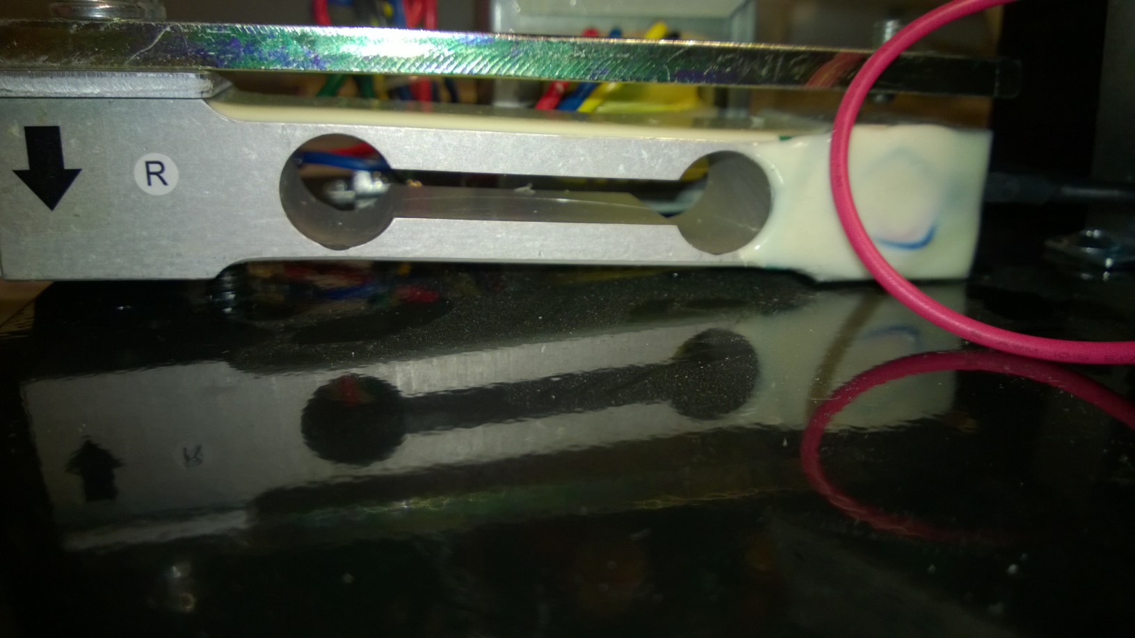

    Picture 4: Is that screw supposed to be there? I think that has something to do with the problem. The mechanism is bolted in at the other end.
    I would be glad to receive any ideas. The model is Jadever LPWN-1530

    Re: Postage scale repair.
    looks like a transit bolt to keep stuff still, remove it
