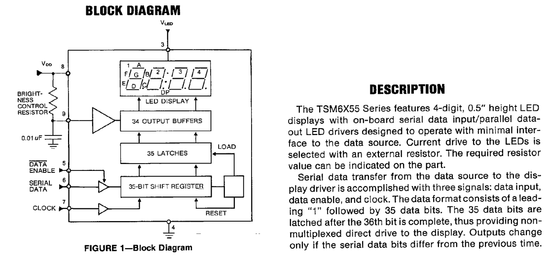

    It turns out that the new displays are custom fabricated by the company that makes the boards.
    I wasn't about to let that stop me, so I created an exact replica of the new display using the ole' iron and toner method, transferred the components onto my board and viola! I now have a functioning board of my own.

              The RevA LED display uses a 35-bit shift register to shift the segment data into the 4 digits whereas the RevC display utilises an "intelligent" 16-bit shift register. The firmware in each of the microcontrollers would be matched to a particular display type, so you couldn't possibly get a RevA display to work with a RevC microcontroller or vice versa.
              If you can read the EPROM/OTPROM in your microcontroller, then you should be able to program a replacement, assuming you can find one. However, I suspect that the security bits will be set.
              Alternatively you could build your own RevA display using discrete shift registers, latches, and LED drivers. The TSM6755 datasheet has a map that correlates each data bit with a particular digit and segment. ISTM that it shouldn't be too hard to replicate it in principle, but the circuit would be bulky.
              I personally would use a cheap micro (eg PICAXE, programmable in BASIC) to capture the bit stream and then drive my own display. In this way you could adapt a single design to handle both RevA and RevC boards. You could use a jumper to select the LED protocol (35-bit versus 16-bit).

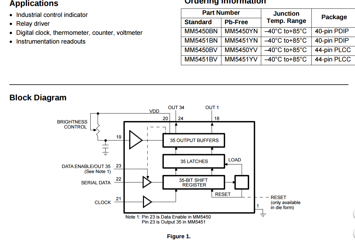

                          Others have way more knowledge in this area than I, but assuming you are making your own rev A display board from scratch (pcb, layout, pin headers, 7 segment display), perhaps the MM5450 led display driver is a compatible choice with the old TMS6055?
                          http://www.digikey.com/product-detai...1341-ND/771810
                          The TMS6055 has a 7 pin interface: Vled, Vdd, brightness control, data enable, serial data, clock and ground. The MM5450 has the same 6 (vled is not on the MM5450), but numbered differently on their chip. It would just be a matter of laying out the traces to the 7 pin header.
                          Vled would have to go directly to the 7 segment leds as per MM5450 datasheet figure 13.

                            The text in the MM5450 datasheet is very nearly the same as in the TSM6x55 datasheet. It does look like the MM5450 might be a suitable candidate.

                                So in theory all I would have to do is create a pcb board with the LED display pins and header pins traced to the MM5450?
                                "You can only learn so much doing simple recapping and fixes. Ideally you want a really hard one to fix where you end up with a lot of dead ends and frustration. Then, and only then, do you learn how things really work."
                                -retiredcaps
                                • fzabkar
                                  • Mar 2009
                                  • 772
                                  Re: Custom LED project, can anyone help?
                                  Yes, that's how I see it. But this would only work for the RevA board, obviously.
