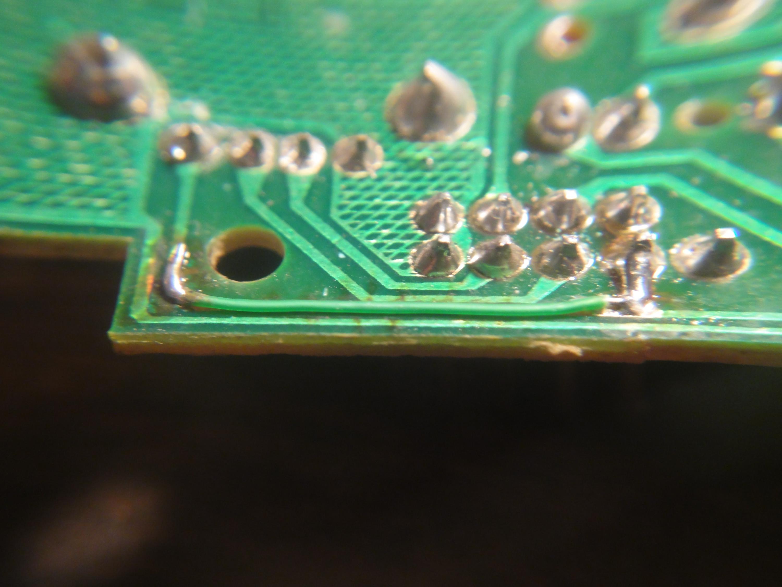

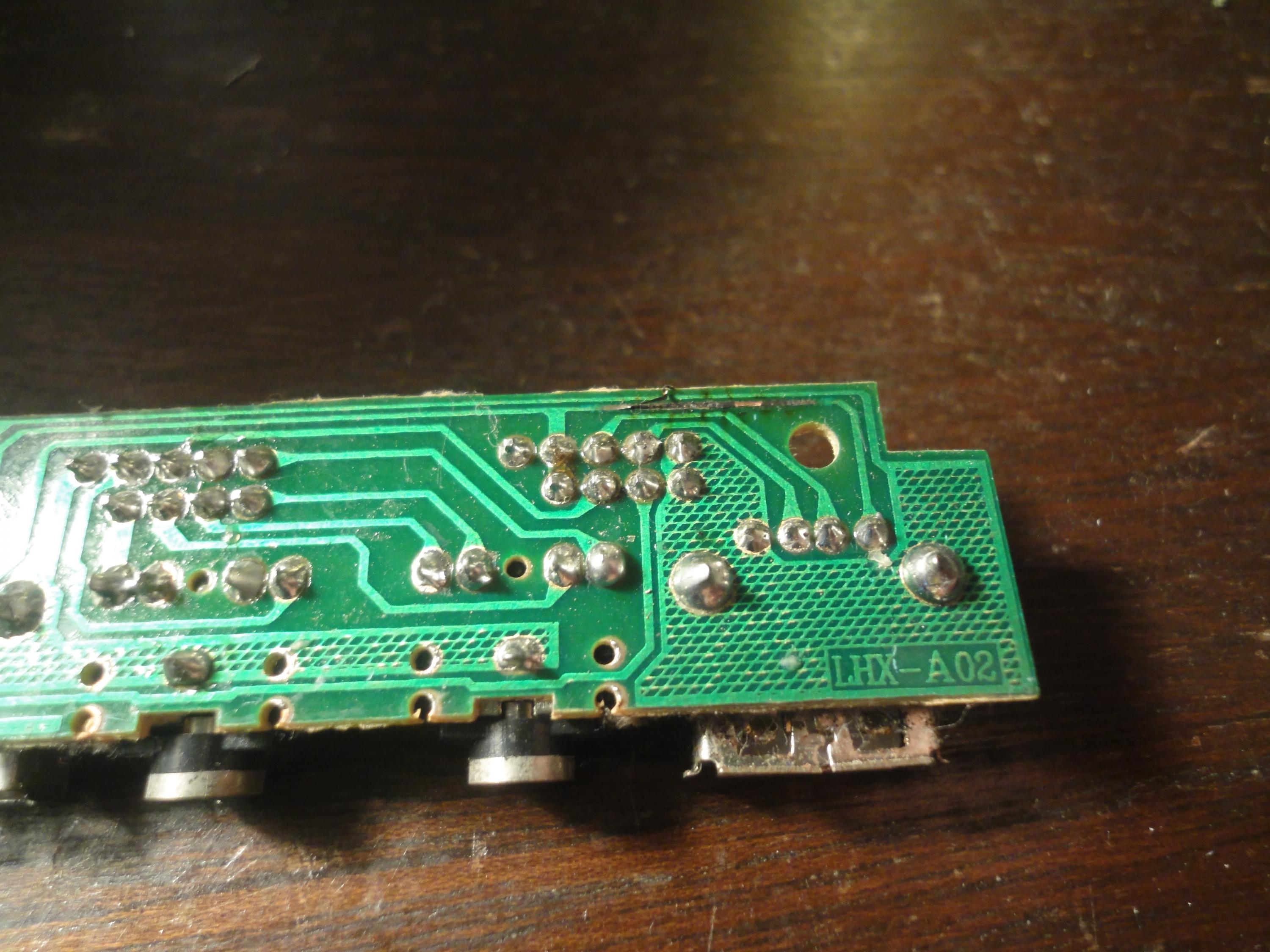

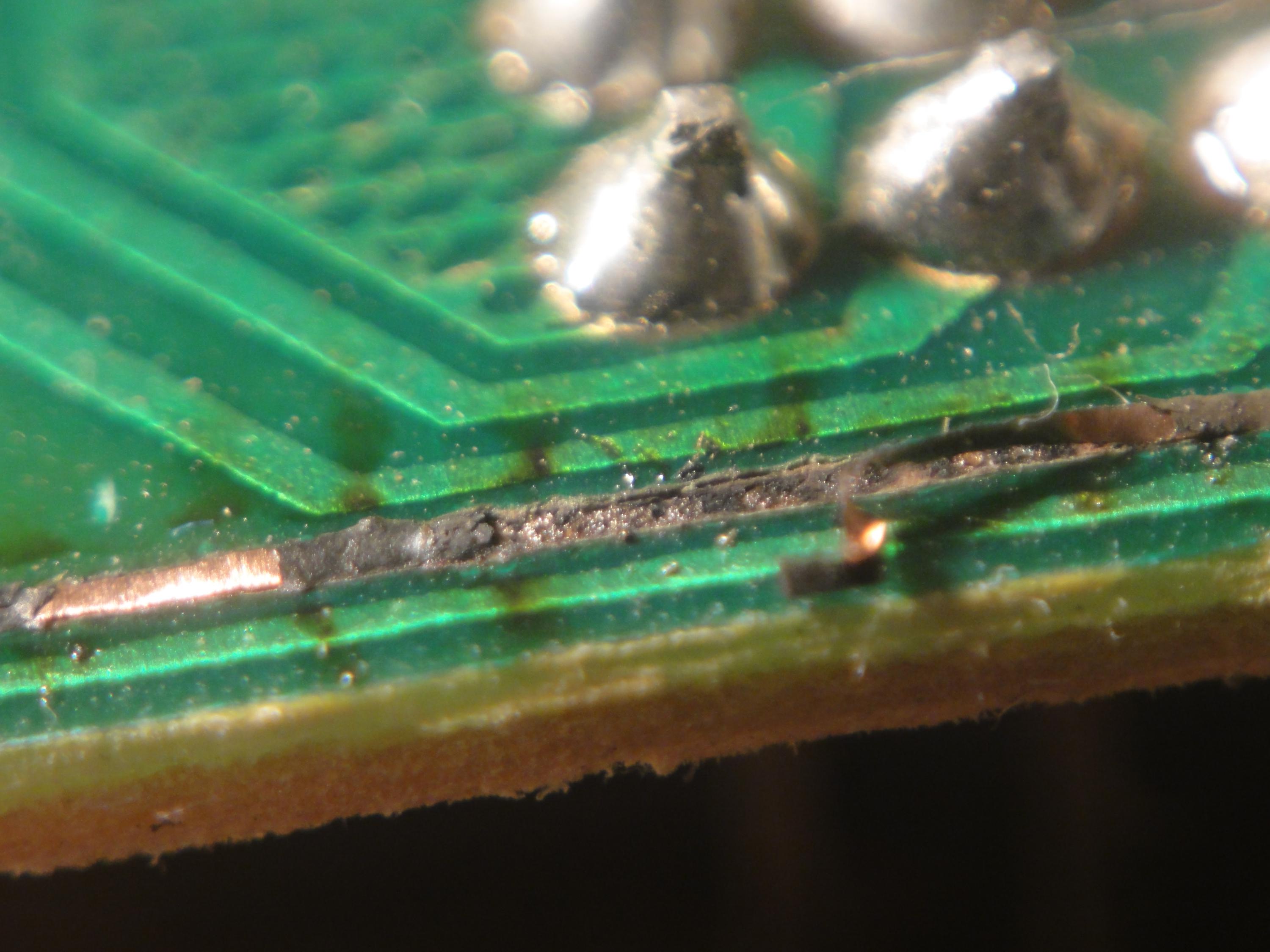

Revolutionary PCB-integrated USB fuse technology!
  • Agent24
    I see dead caps
    • Oct 2007
    • 5008
    • New Zealand
    Cheap Chinese PCBs are so cheap they blow before the fuse does!
    -David VanHorn

          Re: Revolutionary PCB-integrated USB fuse technology!
          Originally posted by stj
          i have actually seen fuse-tracks.
          they look like a pair of triangles pointing at each other.
          Well that's something I didn't know before! The only triangles on PCBs I know of are the ones in spark gaps.
          Originally posted by fzabkar
          Maybe the fuse was the cheapest part. ;-)
          Heh. Joking aside, the motherboard uses PTC polyfuses on the USB ports, and it probably just didn't trip fast enough. The USB port works fine with the trace repaired.
