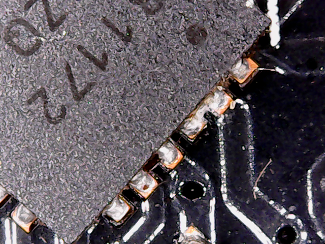

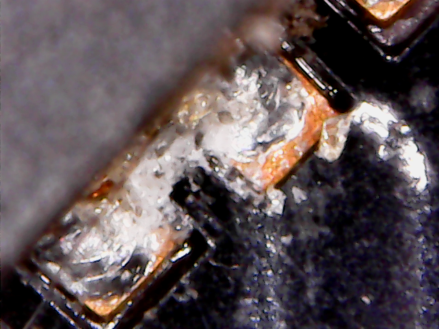

                              #34
                              Re: PC Graphics card
                              Thought I would nosey round under the microscope... Looky at what I found.
                                • 31283
                                #35
                                nice foto's
                                time to lift it - what is it, a smart fet?
                                • newtothis
                                  • Mar 2013
                                  • 1556
                                  • england
                                  #36
                                  Found another, Fluxed them up and flowed to remove the bridges, No difference to readings
                                  I think its a Smart Fet yes, Havent looked it up yet as getting late now

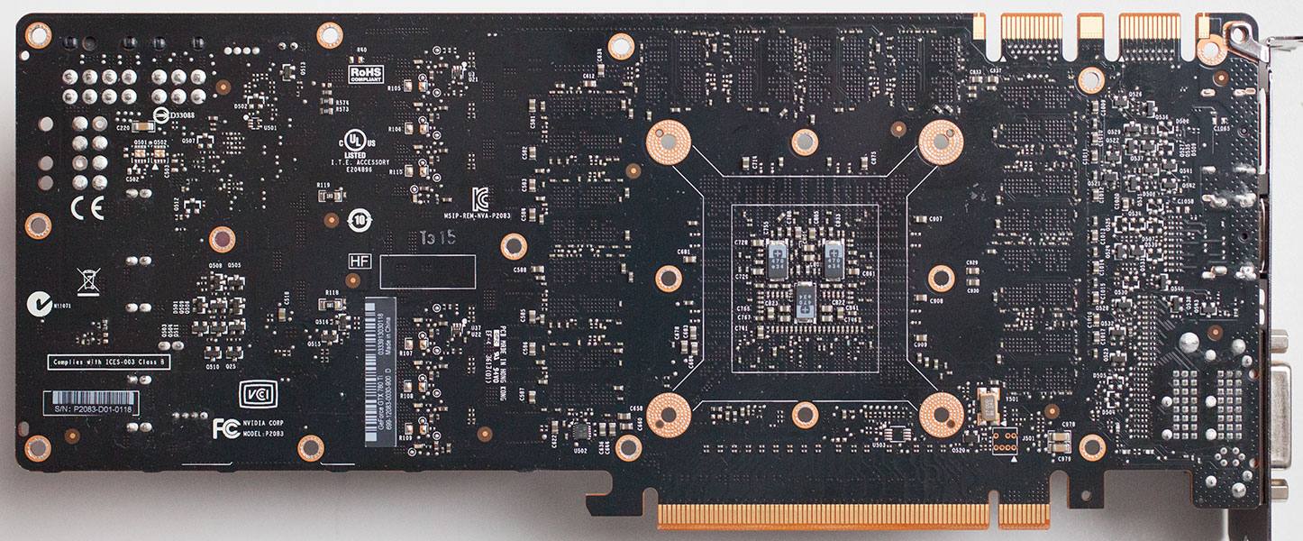

                                        #39
                                        got a foto of the other side?
                                        • newtothis
                                          • Mar 2013
                                          • 1556
                                          • england
                                          #40
                                          here
