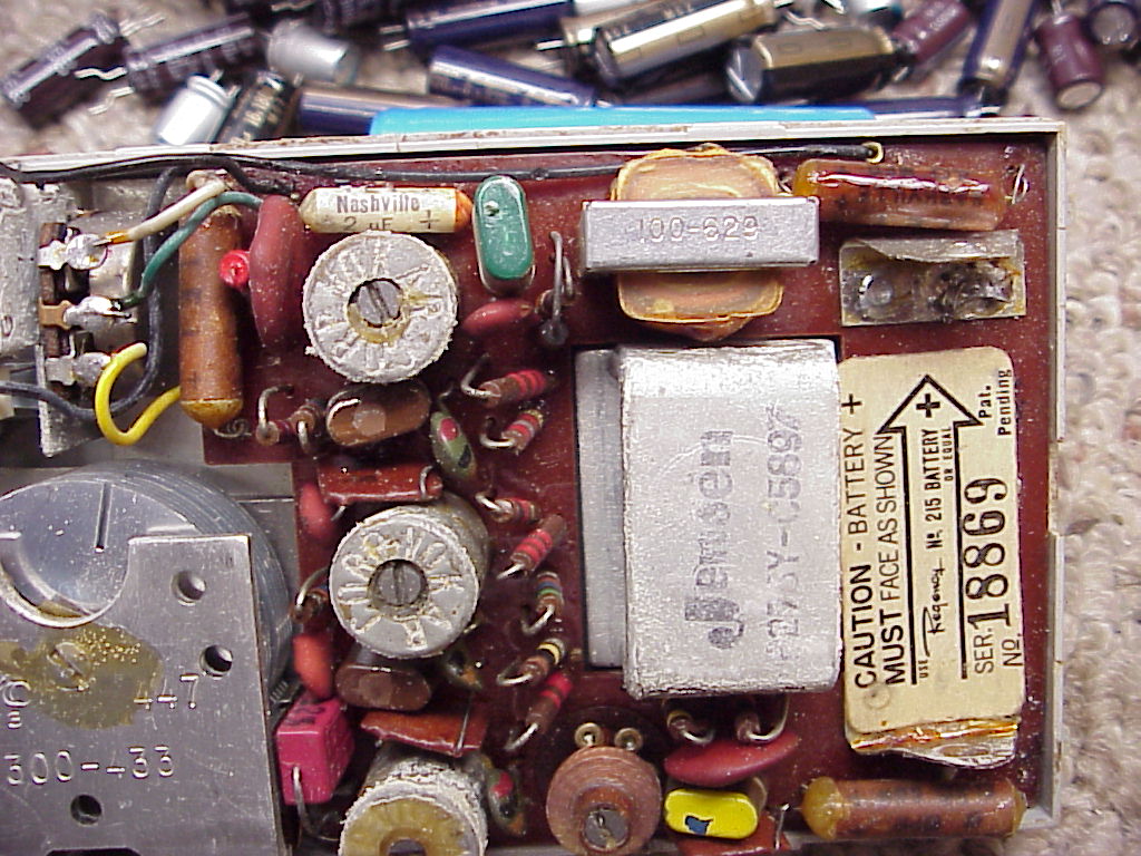

these are electrolytics in one of my many regency tr-1 radios.
if wax wont keep moisture out of a paper cap it sure wont keep it in a lytic!
most early miniature lytics are bakelite tubes sealed with epoxy.
i remember these nashville lytics being 100% bad in the early 70's when i started fixing stuff.
