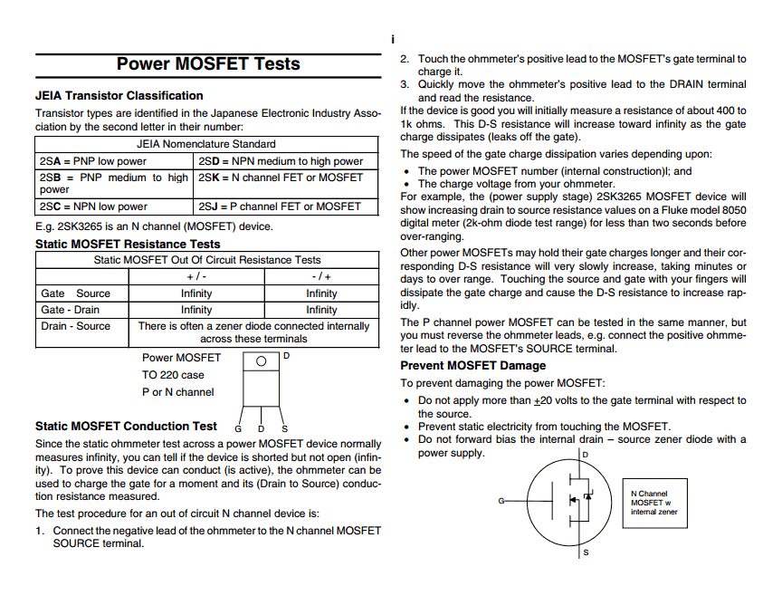

        Sony procedure to test MOSFET (see attachment).
        But do not trust the value: you'll not read 400 ohms to 1kohm.
        That's a generic value for some old power mosfet.
        I have some BUZ90 and IRFS630 and they give me 1500 Mohm and higher value.
        Sometimes the BUZ90 required second or minutes to dissipate the charge applied between G ans S so if I test'em between D and S it gives me infinite resistance.
