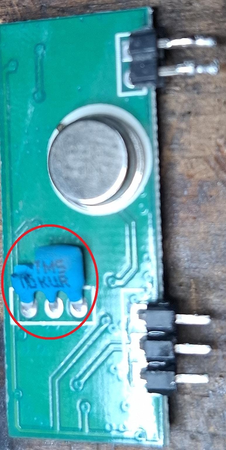

    Hi to all!
    I want to know, if somebdy know the value of this osc/resonator.
    In another receiver, it uses a 6.7468
    Thx in advice!

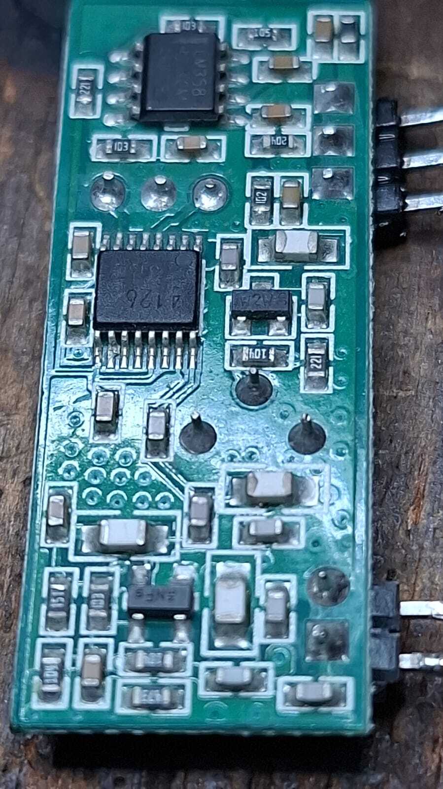

    What are the markings on the 4126 IC?
    Is there an FCC ID for this receiver?

      4126 - BH4126FV

        Thanks lotas. The datasheet says it's a ceramic filter, but it doesn't tell us much more.

          Here I found a photo of this board
          https://aliexpress.com/item/1005004121948313.html
          FFE1070NA10HFL
          FFE1070MS

            To to all for answer!
            So, it´s a CERAMIC FILTERS 10.7MHz, i´ll check for it, if i put a 6.7468 MHz, will work? i´ll try it

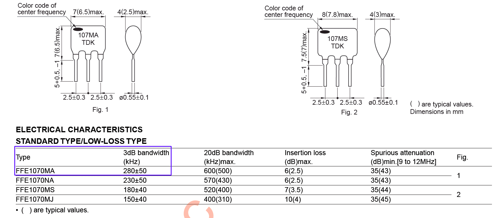

              The ceramic filter is a bandpass type with a relatively narrow bandwidth. A 6.7MHz filter will not work.
              http://datasheet.iiic.cc/datasheets-1/tdk/FFE1070MS.pdf

                  Better datasheet:
                  https://www.lcsc.com/datasheet/lcsc_..._C19470389.pdf
