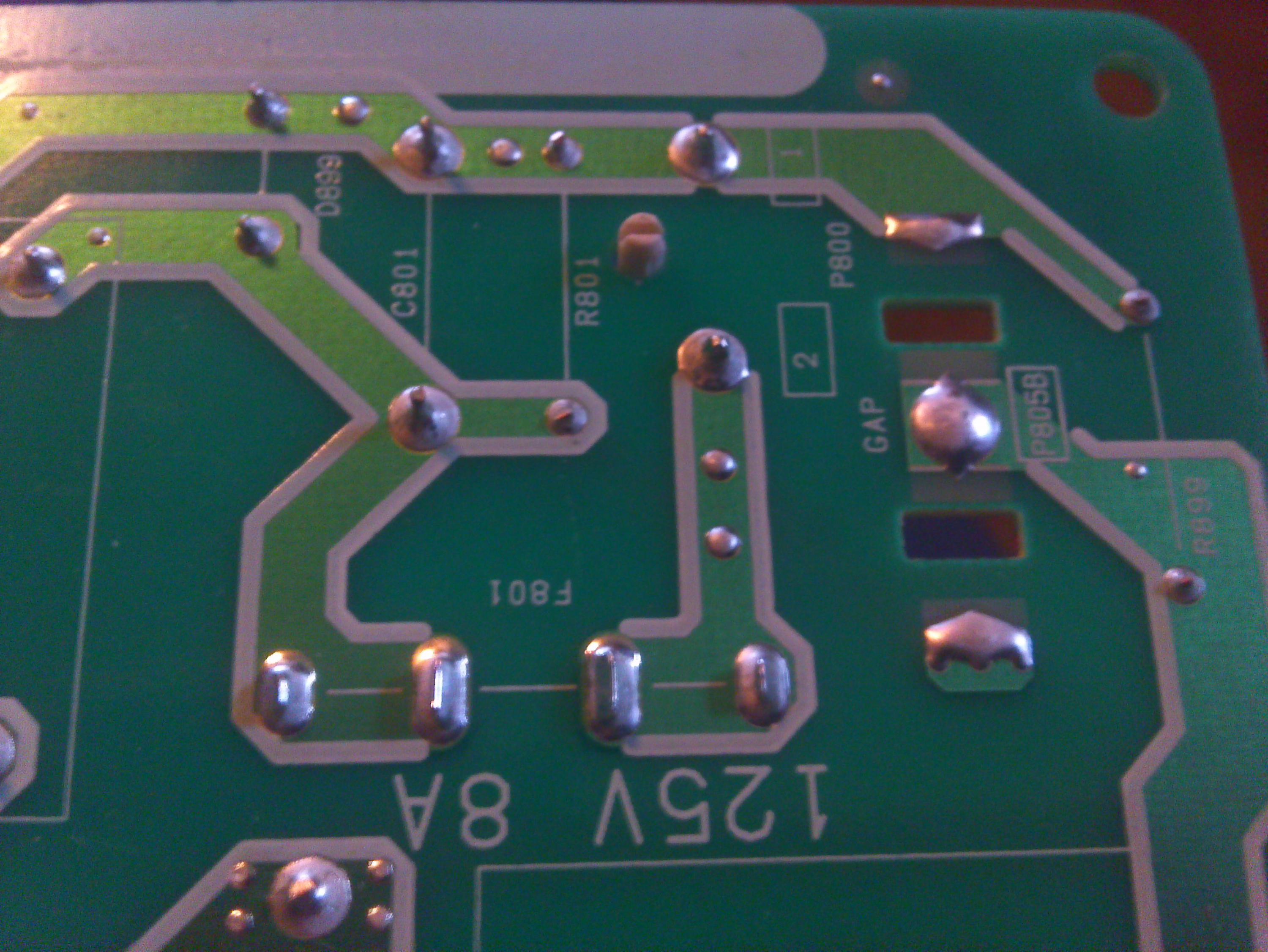

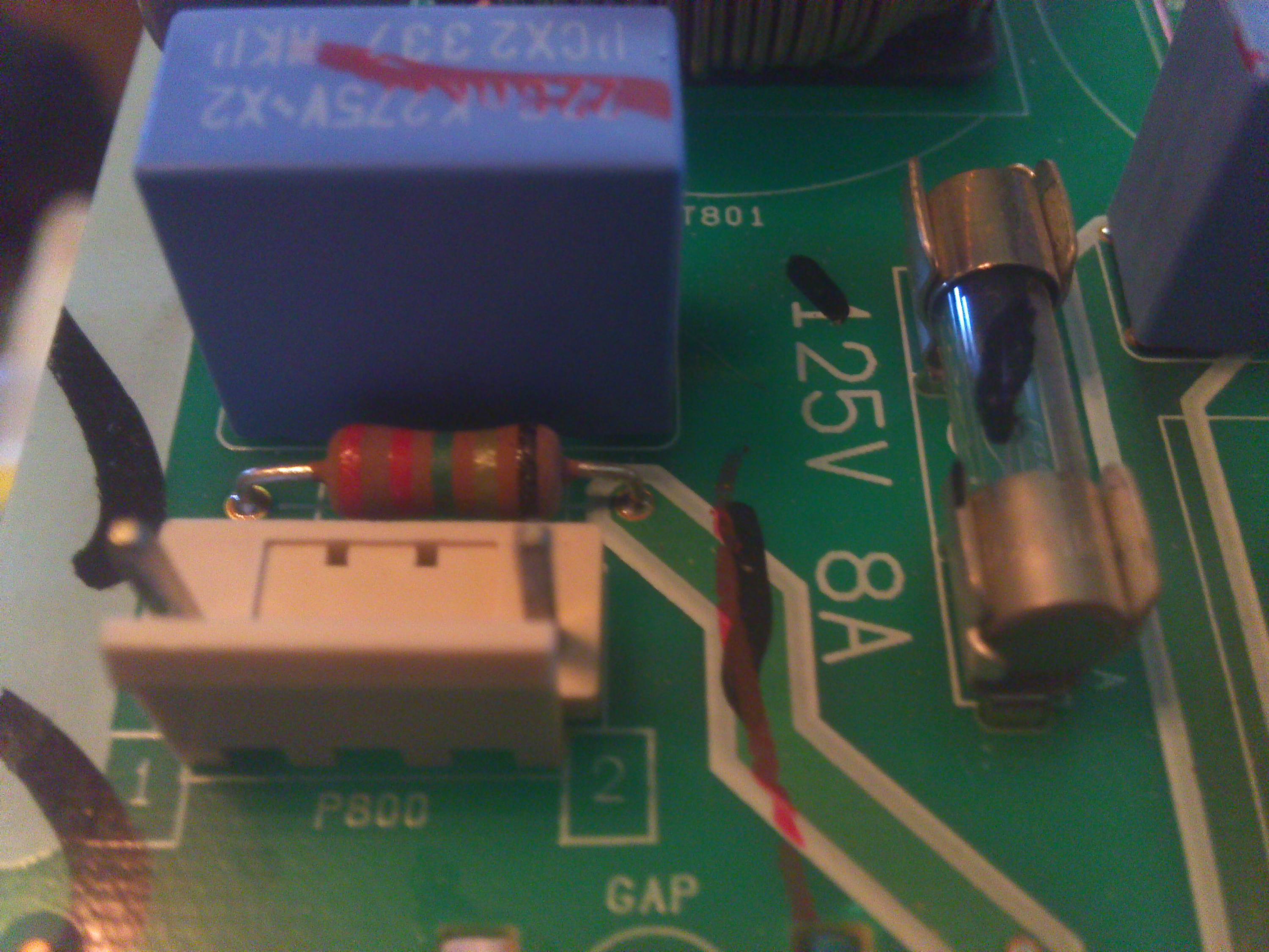

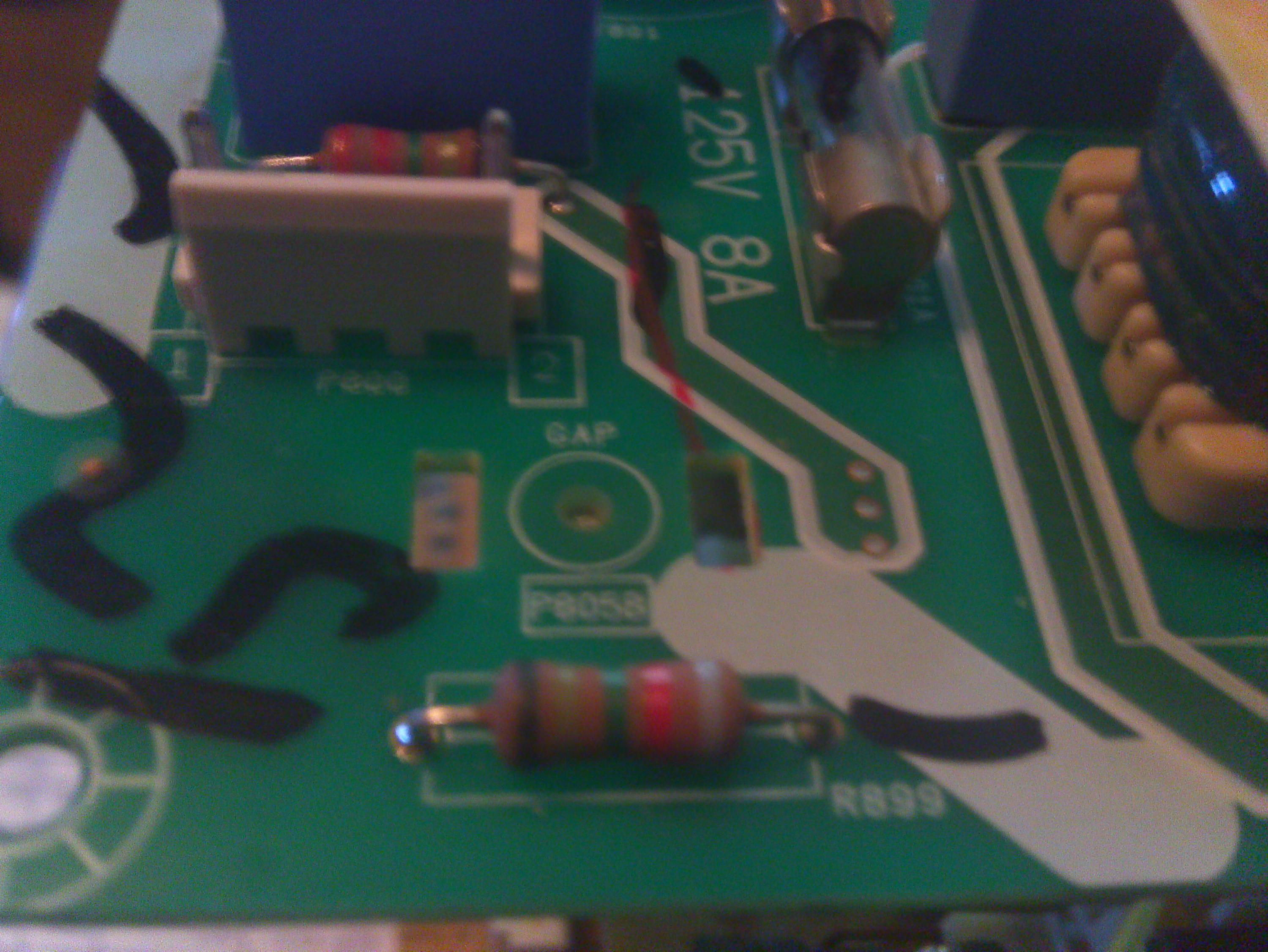

i can't seem to tell what colors are what. normally i don't have a problem using the color bands to figure them on but these 2 have me baffled. they are on a toshiba power board right by the ac input. any and all help is appreciated. i keep coming up with a megaohm resistor of different values when reversed etc. but i don't think they are that high but i might be wrong. they read ol when tested in circuit but if they are high megaohm resistors then that is possible because my meter only goes to 2megaohm aka 2000k ohms. the pics aren't the best but 1 from what i see is red,red,green,gray,black and the other looks kinda like gray,red,green,gray,black they both are identical except for the 1 band.

82.5 Ohms . an 22.5 http://www.digikey.com/us/en/mkt/cal...resistors.htmlLast edited by t.j.; 04-20-2014, 01:46 PM. -

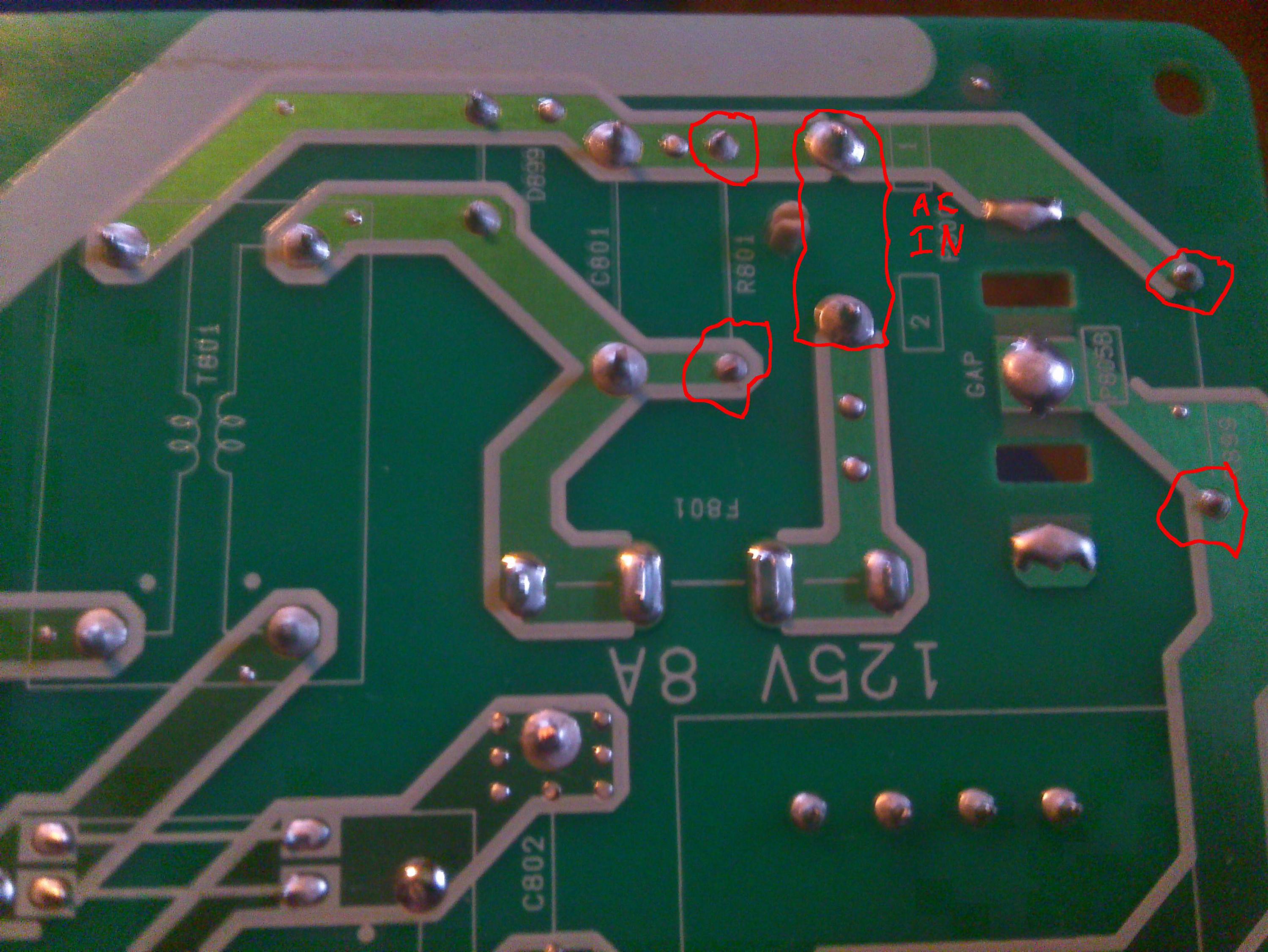

That looks like the high value resistors (M Ohms range) for the Hot and Neutral to the safety ground. Look and see if one end of the resistor is connected to safety ground, and if one of the resistor is connected between HOT and NEUTRAL. They are part of line filter circuit.
Can we see the bottom side of the board?Last edited by budm; 04-20-2014, 02:03 PM.Never stop learning

yeah thats where they are located give me a few minutes and i'll post pics. megaohms sounds right cause i don't get any reading on my dmm on the highest setting. anyway to check to make sure they are ok? or if they went bad would it blow the fuse?Comment

can not really tell by your first picture, but was wondering if that fourth band was silver, if so it may be a 4 band resistor ignore the fifth band, and that would make it a 2.2M ohm, just a thought
second picture that is, red red green silver.Comment

R801 is connected across L and N, another one is between N and Safety ground. They can be left out off the circuit, the TV will still work without them in place. Seems to me you have other problem some where else.Never stop learning

ok thanks i just wanted to rule them out. will open a thread for the tv later on. thanks for the help. you are right it probably is silver and a 2.2mohm but that isn't my problem now that i got that cleared up.Comment
