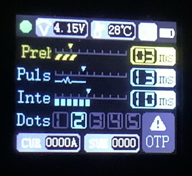

      I bought one of these about a months ago or so and I had time to test it today I am very impressed with the results of the quality of the tab welding I should have bought one a lot sooner but the real question how long will it last with heavy use this is the question
      It some really nice features one being it monitors the battery voltage and it tells you what current was used when you do a weld you can adjust the
      Preheat time = 03 milliseconds
      Pulse time = 13 millisecond s
      The time when you have the welding tips steady then it fires intermittent time 10 milliseconds
      One function that is marked Dots = 2
      One note the preheat is very important function because I have several different battery operated battery stud welder and they do not have this feature or function and they just fire when you have the probes steady and then fires but the tab welding looks like crap and it does not penetrate the tabbing metal which this one does have this feature and function and you can see the difference in the quality of tab welding
      I use just enough preheat time to see it glow for a fraction of a second then it pluses it and you are done and wait for the next time you hold still the probes
      Plus you do not have to hold the probes that close together to get good results which is also a plus
